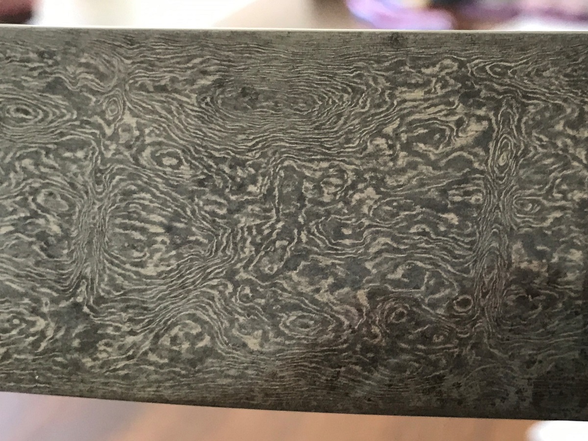

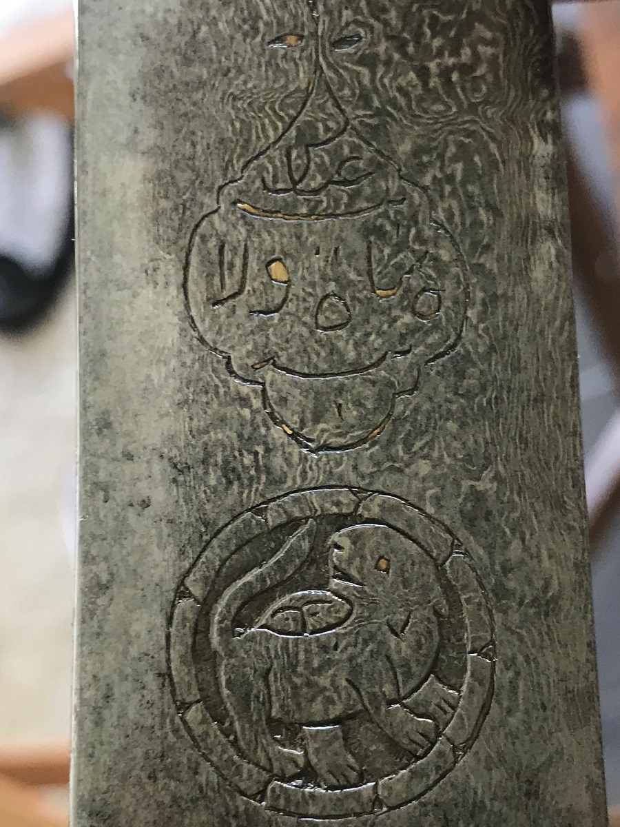

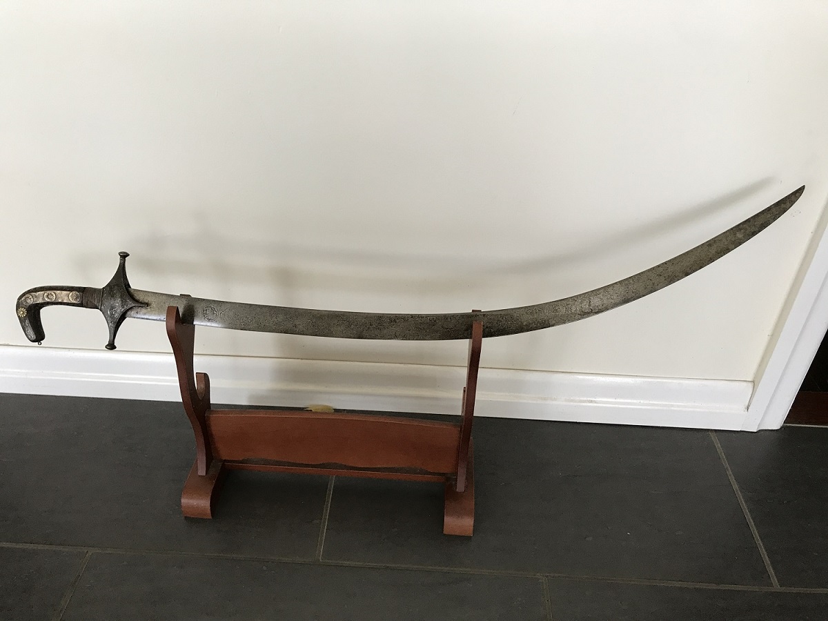

G'day Guys,
I have recently acquired my first shamshir. It has a large heavy blade of kirk narduban wootz which is 36mm wide at the hilt and 840mm long and weighs 1050g. It has engraved "Shah Abbas" and "Lion" cartouches.
Can anyone tell me what the "face" peering over the lion's back represents? Is it something to do with the sun?

Congratulations for the wonderful shamshir.The second cartouches contains an image of a Lion and Sun and and is typically a Persian sealing mark placed by the master in the middle of the 19th century.

To me it does look like the sun, which is a Persian motif.
The blade looks like a ladder pattern wootz. Very nice.

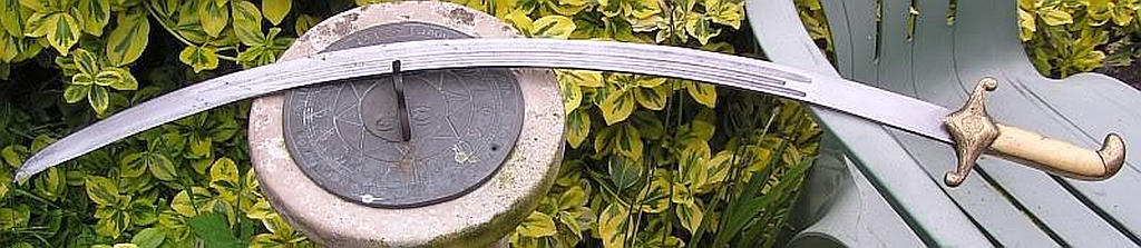

OMG I had to look if I have still mine, yours is so similar!
It's what they call a Syrian/Badawi sayf with a very nice Persian blade.

The lion pictogram is a stylized version of the Sun and Lion (Shir O Khorshid)which is an early symbol of Iran from about 12th century. It derives from old Babylonian astrology, the sun in the house of Leo, and became representative of Shia Islam. I am not theologically versed to explain the further dynamics, however, the Sun and Lion became the national emblem of the Qajar Dynasty (1794-1925). The attached image is the Pahlavi version of the symbol.
As I previously mentioned, Oliver Pinchot describes the use of this stylized lion pictograph well in his most important article, " ON THE PERSIAN SHAMSHIR AND THE SIGNATURE OF ASSAD ALLAH", ("Arms Collecting", Vol. 40, #1, Feb, 2002):
"....the remarkable popularity of Assad Allah blades during the Qajar era, throughout Persia, the Near East and Central Asia, then was the result of careful exploitation of an established name.
Despite the reduced quality of the product, clear marketing in a form which was readily recognizable ( i.e. THROUGH THE USE OF THE LION PICTOGRAM) proved especially effective, particularly among the illiterate.
The quality of Assad Allah blades produced during the Qajar era also reflected the supplanting of edged weapons by repeating firearms, and the dissipation of the quasi-mystical reverence in which swords had been formerly held.
In regions where the sword remained an important spiritual device and primary weapon, as among the Bedouin Arab discussed above, the demand for Persian blades remained consistently high".
The fact that this blade is heavier, and the apparent high quality of the Kirk Narduban steel, seems to suggest an earlier example using this well known pictogram, if what I am considering is correct. This does not mean that the blade has to correspond to the beginning of the Qajar dynasty (1794) as this was simply the era in which the use of this device became popular. The pictogram itself was a stylized version of the symbol long used in Iran, and may well have predated the Qajar adoption of the sun and lion.
The examples of blades I have seen with this pictogram usually have multiple channels , and though heavy, do not have the sweeping radius of the shamshir form as seen here. I have considered them probably first quarter of 19th century+.
Again, very nice example which may reflect earlier use of the Qajar pictogram with the Assad Allah signature, which in effect, seems to have become a kind of brand which paralleled the running wolf and name of Andrea Ferara in the European parlance.

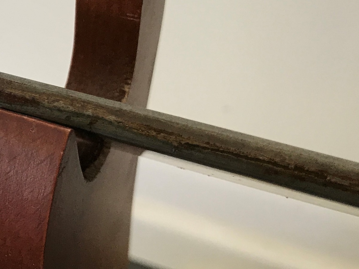

The spine of the blade at the hilt is about 7mm wide and appears to have a forging flaw that has been filled with another metal. From what I have read on other posts, this seems common with these blades. If the smith was skilled enough to ensure there were no flaws in the face of the blade, why did they leave open forge lines on the spine? Was it because it doesn't effect the structural integrity of the blade, so wasn't considered a problem?

I just had another thought regarding the open forging line on the blade spine. The smith obviously wasn't happy with it and that is why he filled it in. If most/all? nicely patterned shamshirs of this period have this feature, then the only reasonable explanation is that it is an unavoidable result of the low temperature forging technique used to make blades with this wootz pattern?
Can anyone answer this for me?

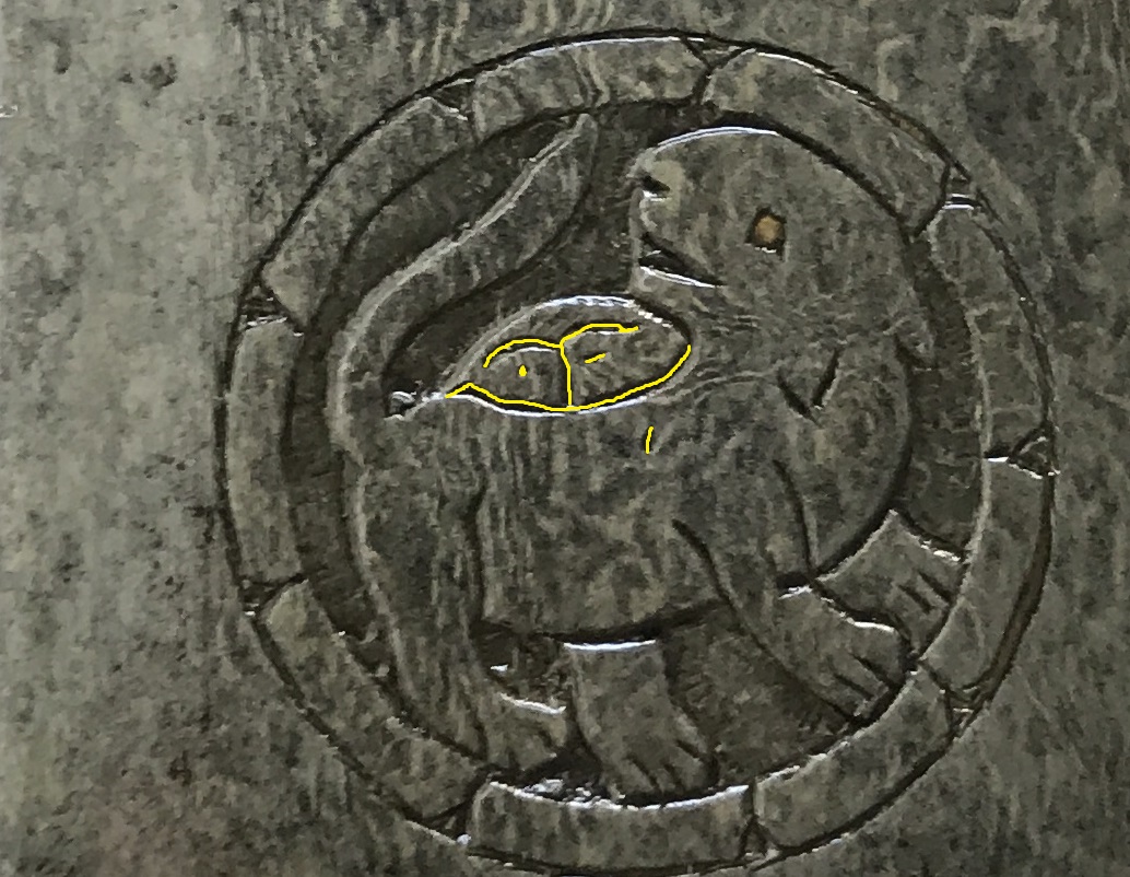

I am still trying to decipher the lion pictogram. I understand that the "face-like" object over the lion's back most likely represents the sun, but does it also contain a stylized and partially inverted rendering of "Assad allah"?

The cleanest wootz was at the bottom part of the ingot, the dirtiest with a lot of slag- at the top. The smith partially cut and bent the ingot to use the clean part for the edge and the sides, with the lower quality part of it forming the inner core of the blade. The long “crack” on the spine is the seam of that bending. It is usually filled with brass or silver wire. It is not a forging flaw, it is a hallmark of a wootz blade.

Folding and hammering a piece of monosteel over itself serves the purpose of eliminating impurities and homogenizing the carbon content. It was a process widely used in the sword making in Persia and India. That's precisely why so many Tulwars ansd Shamshirs show clear signs of delamination these days.
In fact, the crack in the spine of Bryce's sword is a clear example of delamination.

And yes, the seam on the spine might look like delamination. But not quite. The edges of the ingot with most impurities, slag and variable composition just could not be fused when forged under low temperatures needed for wootz. More precisely, it is not a delamination ( which implies past good lamination ), but an almost inavoidable defect of forging. They can be barely noticeable or ugly as hell. I have several wootz blades with them.
