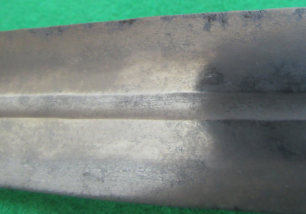

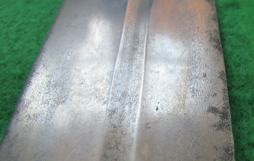

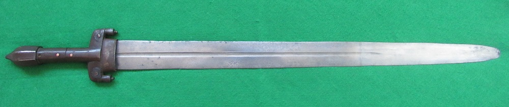

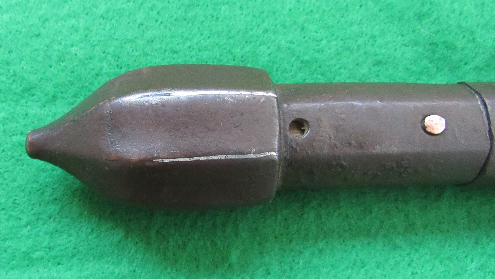

I am really excited to share this old Omani saif, as one of these has been on my wish list forever. Here are the measurements:
Entire length: 36 inches (91.44 cm)
Blade length: 25 inches (63.50 cm)
Blade width at base: 2 inches (5.08 cm)
Weight: 1 lb 11.5 oz (780 grams)
The hilt is the typical old style hilt, with three rivets. The grip is hexagonal, and so is the pommel, with silver decoration along the edges. Whatever other covering and decoration may have been there is long gone.

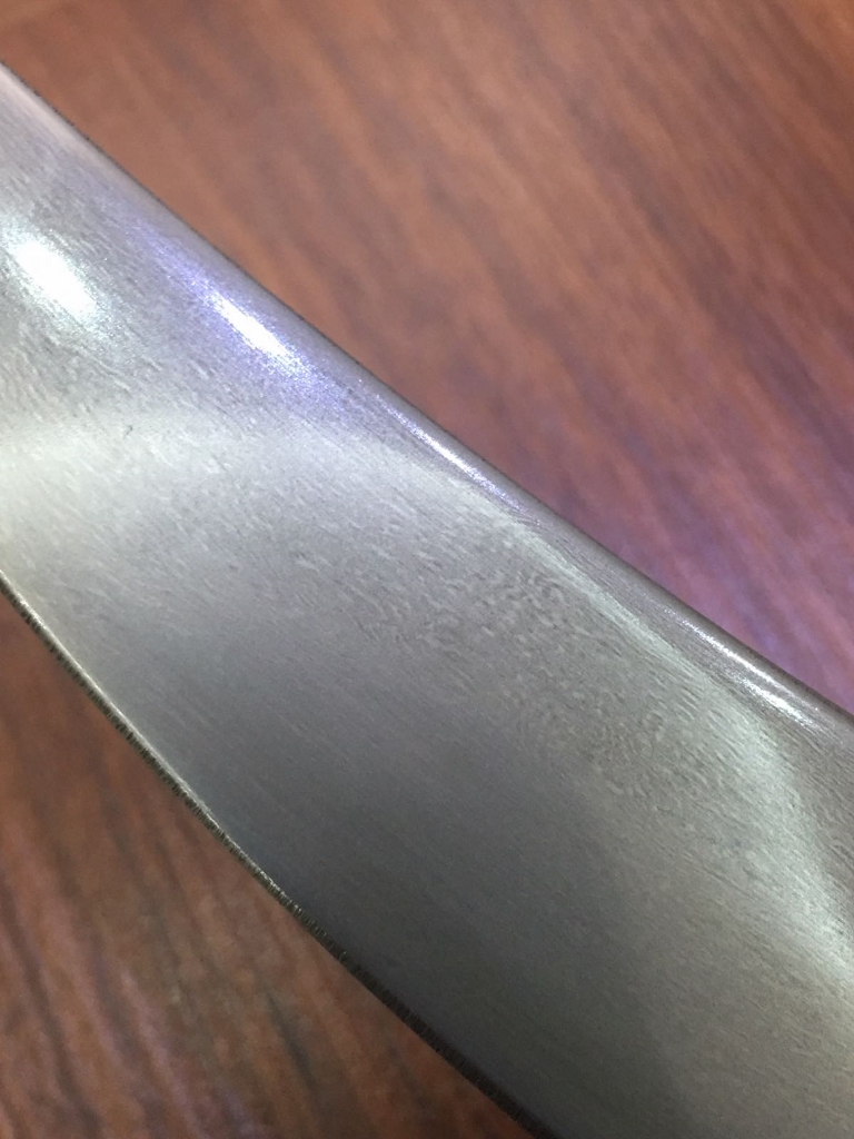

The blade has a single central fuller, with a distal taper and surprisingly thin. It is in great polish, and perhaps most importantly, entirely made of wootz. I did not do a great job of bringing the pattern out and wootz is always hard to photograph for me, but I believe it is clearly visible in the pictures.
This is not the only old Omani saif with a wootz blade, as there is at least one such sword in the sold section of Oriental Arms. Indian blades were of course popular since the early years of Muslim conquest all through the entire Middle Ages, as mentioned by Nicolle in "Early Islamic Arms". I suspect that Indian wootz blades remained valued in Oman and the Omani holdings on the East African Coast up until Solingen's prolific production offered a cheaper alternative without compromising the quality, ultimately leading to the adoption of the longer style blade and hilt.
What are your thoughts on this sword's age and origin?

A lovely piece, I too have always liked the form of these and the wootz blade is quite clearly visible. I'm surprised it is fullered, other wootz blades I have seen in these mounts have been without fullers.

Thank you for your responses.
Iain,

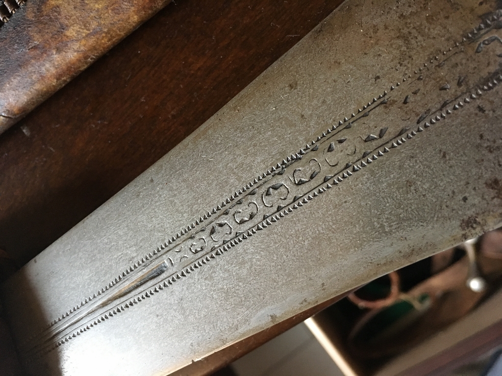

Yes, the fuller is unusual, not sure what that would signify though.

What I suspect you have here is something like a 16th C /17thC Hilt with a recent replacement blade. Examination of the material holding the blade firm is extremely difficult to guage when the blade was fitted...Actually these swords have no glue or tar as the blade is held in place by two rivets through a hexagonal two piece metal tube and a wooden core and through the tang...unlike Khanjars blades which are glued/tar fixed.
These blades are not usually thin... They are normally thicker and stiff ...There is normally about an inch of flexibility only as these were chopping weapons. If you can disclose where you got the sword I will be closer to knowing who did the blade fit up. That can be done by PM or stick it on the thread.

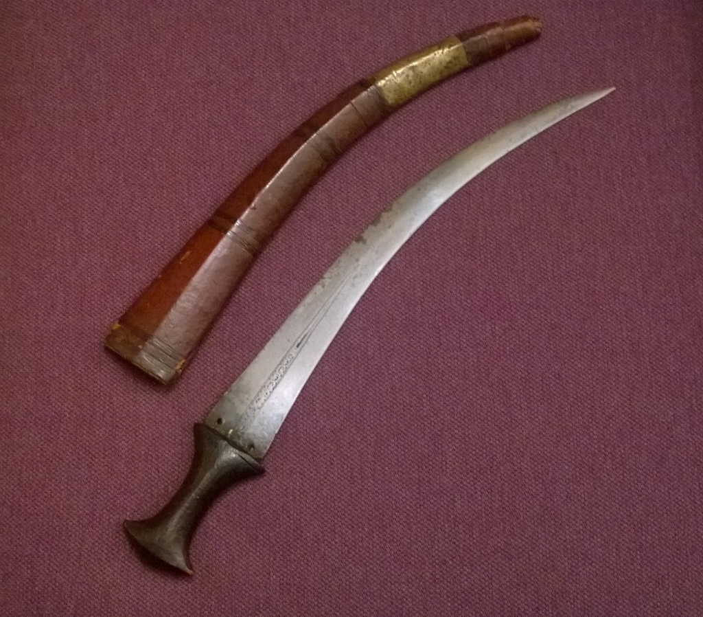

Sorry Ibrahim, but I support Teodor. He absolutely right and I myself stopped to read these posts on Omani and nimcha things since a long time.

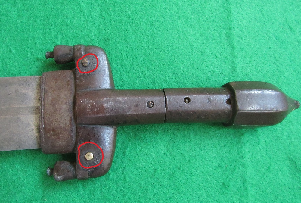

The handle sports new rivets. The implications are obvious.
Re- use of parts is virtually expected in case of old “Oriental” swords: they utilized parts of organic nature. But wood shrinks or rots, mastique dries and crumbles, bone cracks and breaks.
I do not think it might be possible to pinpoint the age of restoration of this sword short of full disassembling it . But the good thing is that all components look very old.

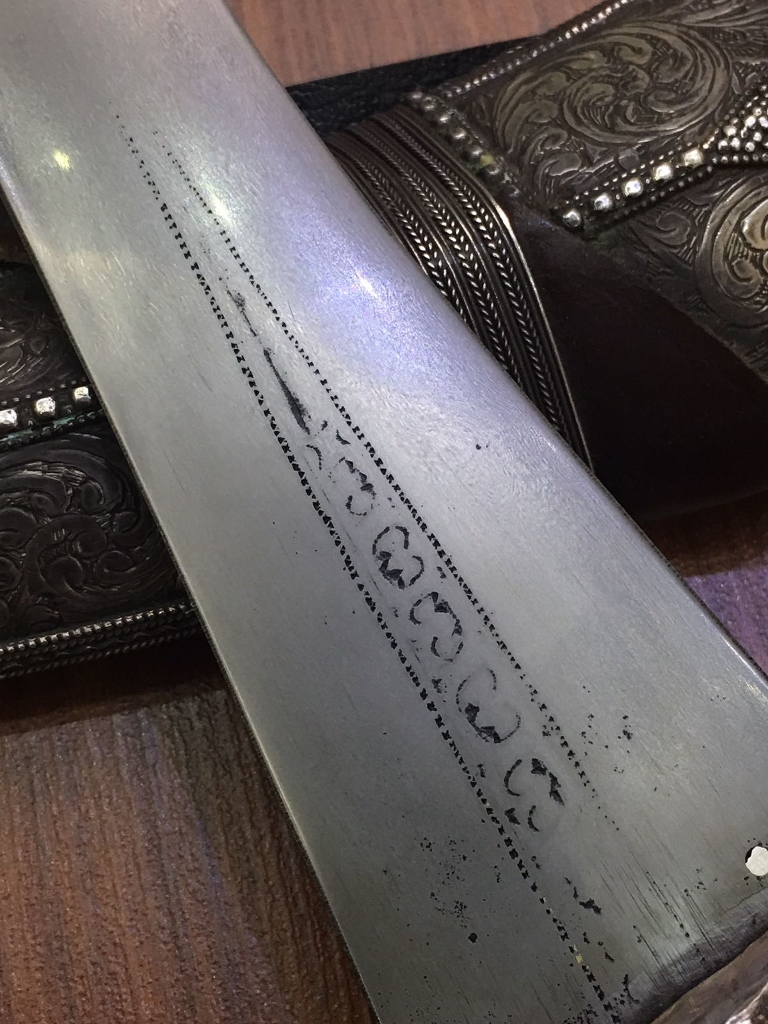

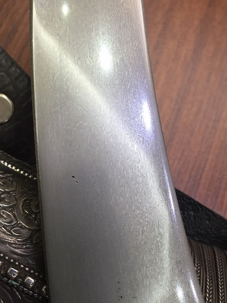

As mentioned, these are still valued in Oman and go through many restorations and even are fitted with new silver parts to sort of make them presentation worthy. The rivets while in appearance seem 'new' are not negative indications.
I have no information about how old is the blade, the wootz is clear and the condition does not suggest a newly made blade. Nor does a mismatched patina between handle and blade suggest much... how many shamshirs are there with excellent polished blades and pitted quillons? we all know why.
Teodor, nice sword! it is called saif Yamani and saif Ya'rubi as well by Omanis in an effort to try to pinpoint its origin.

As Ariel has pointed out, obviously this blade is newly mounted, and the hilt clearly has age. As he also well notes, weapons were often remounted through generations, not just to replenish non durable components such as hilts and coverings etc.

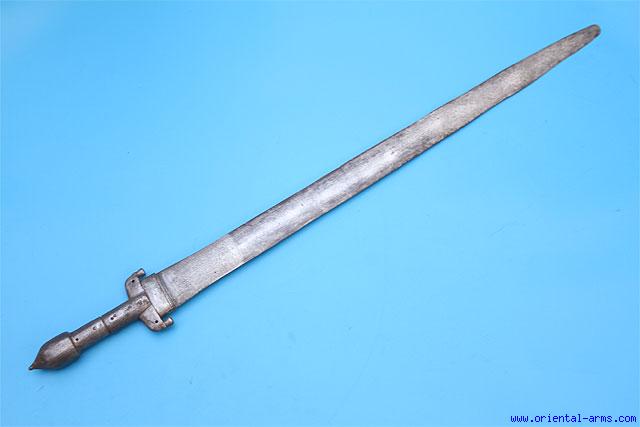

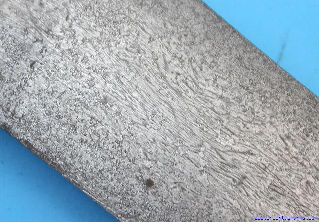

To address your statement above that a wootz blade would be expected to have more elaborate dress, I am posting a couple of pictures from Oriental Arms sold archive of another Saif Yamani (or Saif Ya'Rubi) with a wootz blade and a fairly simple and similar hilt. Of course, nothing precludes both hilts from having had some silver decoration at one point, but it has been lost due to age (or for reuse in jewelry) and the only traces that remain are the silver wire inlay on the pommel of the sword I posted.
http://oriental-arms.com/photos.php?id=5903
Teodor

Yes. And by pattern I meant the wootz pattern, not the shape of the blade! any Persian or Indian (or Ottoman) example with such a blade? I only found them with Arab fittings, so local production?

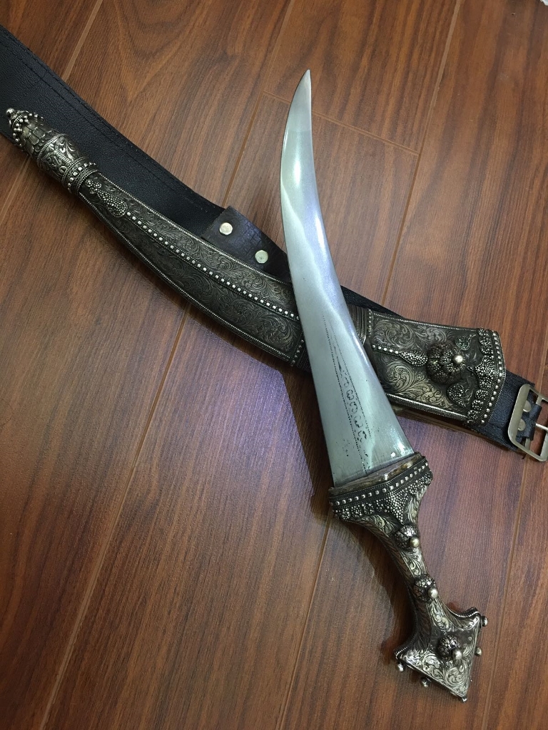

First example, crystalline wootz.
Old 3rd October 2017, 12:17 PM   #25
A.alnakkas
A.alnakkas's Avatar
Join Date: Nov 2010
Location: Kuwait
Posts: 1,340

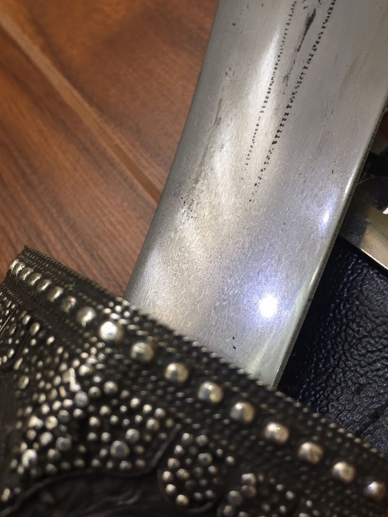

2nd example, a more open pattern. Belongs to my friend, who polished and etched it. Obviously the mounts are later, and these rhomboidal nafi'i blades are highly sought after and wootz is not as common as once thought. Some even have black wootz similar to one found on Persian blades.

So, knowing that the Omani sword is not a one of a kind since there are multiple examples of ones with wootz blades and the existence of other Arab ( I do not see otherwise) made wootz blades that makes sense of such Omani swords having wootz blades.
In my eyes, Teodor's sword looks 100% right for what it is. Can the handle be older? could be, similar to how tulwars often get rehilted using older handles. This offers no sense of suspicion.

BTW have you seen the circular marks around the new rivets?
Is it possible that some sort of coins were used to fix the guard and then removed?
Because the two circular marks are very similar in diameter...
