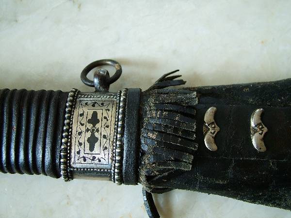

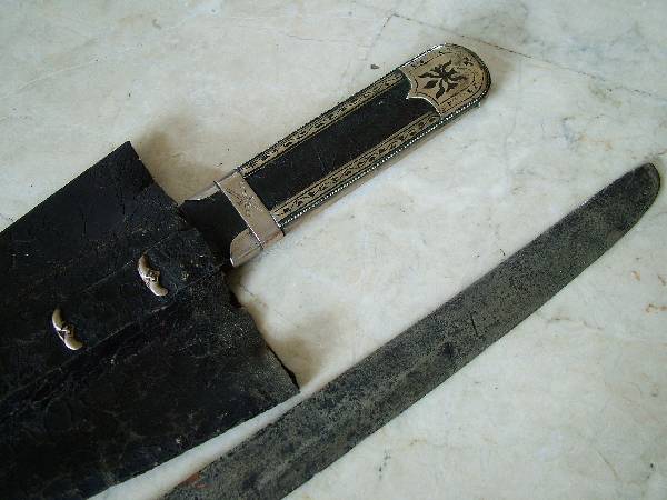

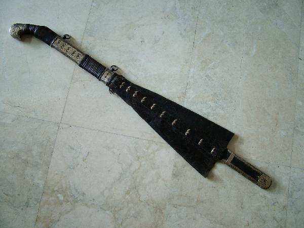

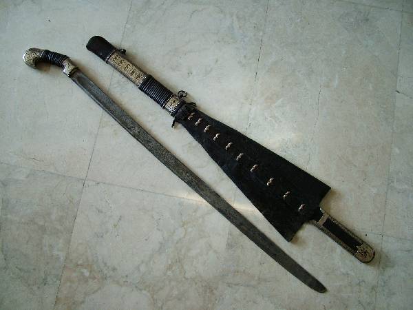

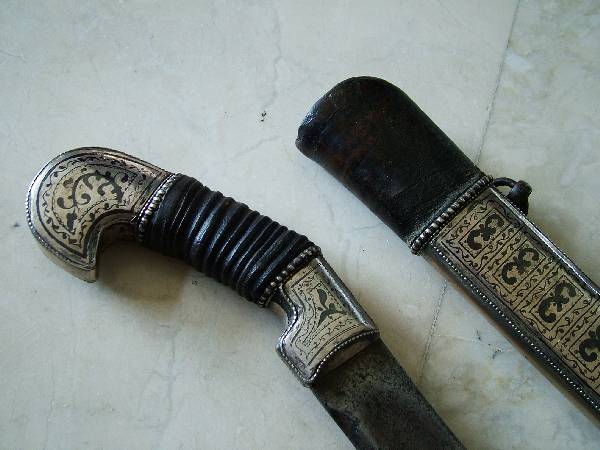

I think it is the first time we see an exampe in this forum. It is a shasqua with skirt. I need comments about it. I have seen it in russian books but unfortunatly I cannot read the language. I just know that it is a rare weapon. I hope that Jim, Rivkin and Ham or anyone else will have something to say.
A lot of care used to soften the leather of this baby and it is still in a very fragile contition.
