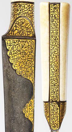

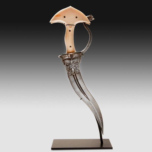

I suggest along with Ariel that these two threads which are clearly the same family ...be joined. I note that the design treatment at the throat is similar to Yatagan although this may simply be coincidental since Khanda, Kard, Pesh Kabz and Yatagan are very close...in design style. May the two threads be joined together?... Below I place for comparison weaponry displaying similar work at the throat and some with similar hand guards to the project style... Last edited by Ibrahiim al Balooshi; 14th July 2016 at 02:01 PM. |

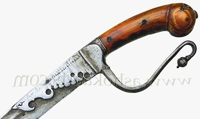

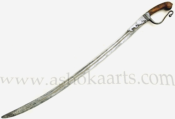

Here's a close-up showing the wootz blade of the sword starting this thread. Am I correct to see some surface manipulation during forging of the ingot to achieve a (possibly ladder-like) pattern?
Regards, Kai |

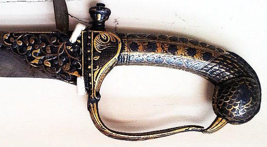

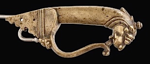

#56 |
A bronze hilt of similar construction with a sinha (or yali?) pommel. This seems to corroborate a connection with Hindu regions of southern India.

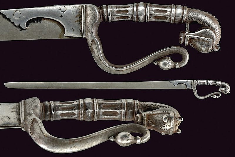

#57 |

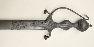

This sword with a horse head pommel has a different kind of blade.
#58 |

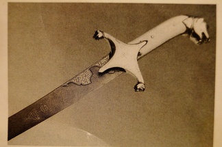

Another zoomorphic pommel. However, the hilt exhibiting some differences from the standard configuration discussed here: a vestigial crossbar at the back of the blade and more floral decorations, especially at the base of the blade. Arguably, it may be questionable whether this is really of the same pattern and origin as the other examples discussed here.

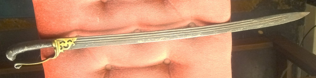

#59 |
And last not least another variant with a more stylized pommel (still close enough to the bird examples shown above).
With the grip and pommel scales made from ivory, this one was also a status piece. Thus, one might argue that all these examples were mid (to high in post #58) status swords from somewhere in southern India; all seem to be well earlier than late 19th century. Regards, Kai Last edited by kai; 18th October 2016 at 02:52 PM. Reason: adding full-size pic |
