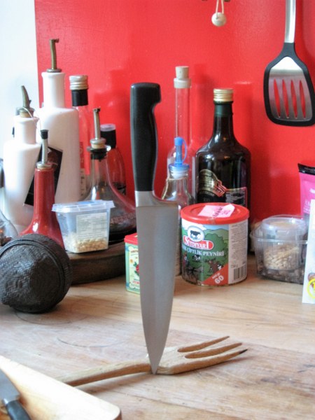

Originally Posted by asomotif
- GOOD FORGING proven by balance of the keris :
No relation between balance and good forging. it is more about center of gravity. (PS, I tried to balance my Zwilling kitchenknife. it was very difficult, altough it really does the job in the kitchen)
Sorry, can not resist to post this one.
Old 21st August 2016, 02:22 AM   #46
Posts: 7,303
Well, it does look like a good knife...
Old 21st August 2016, 03:34 AM   #47
Posts: 6,441
Default Can't Have One
Without the other.
It's the fork that is the unsung hero.

Originally Posted by Rick
Without the other.
Yep, same as the scabbard in the sellers pictures
Without the fork I did not manage, probably due to bad forging

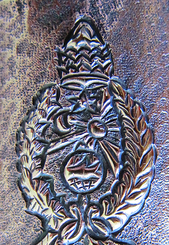

Post #17 is a very good and clear picture of the lambang Karaton Surakarta, however, when this gets put on to a pendok its looks a little bit different.
Here is a pic of the Lambang Karaton Surakarta as we would expect to see it on a pendok.
