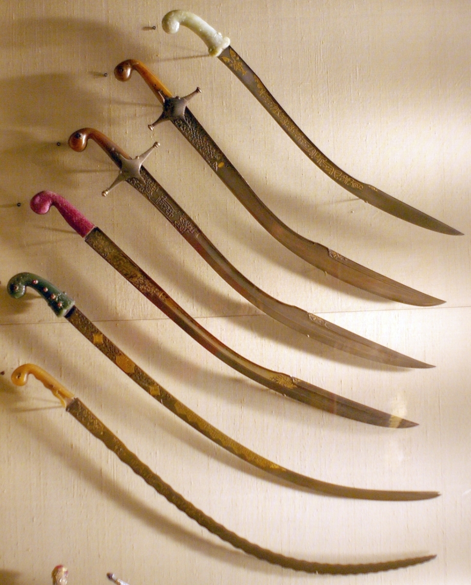

With these Ottoman scabbards it seems I once knew the terms describing them (the distinct little 'springs' in the gap) but darned if I can find the notes.
Jim, I seem to remember a particular term as well, but "with characteristic Ottoman metal spiral stitched scabbard" works. This shashka appears to be another example.

Nice photos Estcrh! While they may not be a lot of Ottoman Shashkas surviving today, they were actually being made in Ottoman Turkey at some point. And considering the fame and usefullnes of shashkas it is no surprise that Ottomans were considering them for their own use. (As Russians did, and eventually ended up replacing all their bladed weapons with modified shashkas) So I think your examples and this sword also are the result of those experiments. But for some reason or another (the main one being the German military influence) the Ottoman army started using the Western European sword types instead.

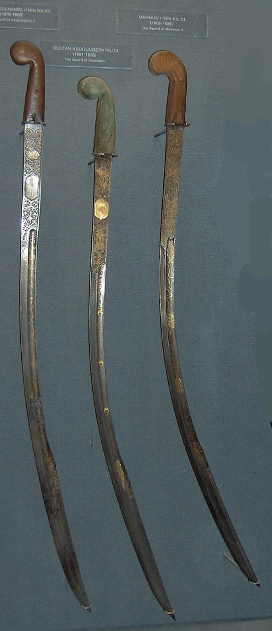

Harry, sometimes blades were around a lot longer than the hilt. For example, a blade may have first been used in a Persian shamshir and later in an Ottoman kilij, in my opinion you have to look at what the person who put the blade and hilt togther intended the sword to be.
Your sword is an unusual example, the maker could have easily made it to look like a kilij but instead used a shashka hilt which suggests to me that it could have been intended for use by a Circassian of the Ottoman/Turkish forces, maybe a later period military sword much like the later period military kilij, one of several possibilities.

Conversely, in this conundrum, are the number of kilij (pistol grip Ottoman style) swords which have the crossguard removed, and seem to have been worn or used in this way. I cannot offhand recall the dates, but we have discussed them here, and I think some have been seen in references.
Old 6th March 2016, 08:17 AM   #25
estcrh
estcrh's Avatar
Join Date: Jun 2012
Location: USA
Posts: 1,492
Jim, is this what you were referring to?
Old 6th March 2016, 04:25 PM   #26
Posts: 10,848
Yes!!! ) Well done!
While some of these are the intended form as in the Indian short sword and dagger hilts, some of these seem to be Ottoman hilts sans guard, and left that way by intention.
Thank you so much.
Your skills at finding these illustrations are uncanny, and superb
