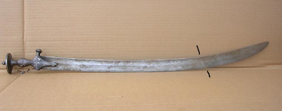

I'm posting on behalf of a friend who bought this tulwar recently. The tulwar blade looks like it could either be wootz or sham, but the tip is made from a different steel and shows signs of being heat tempered.
Is this a known construction method for tulwars, and is there a reason for making the tulwar in this manner? Also, is this construction method native to a specific geographic region? Thanks.

The riveted handle with brass washer suggests NW India or ( more likely) Afghanistan.
The blade seems to be wootz.

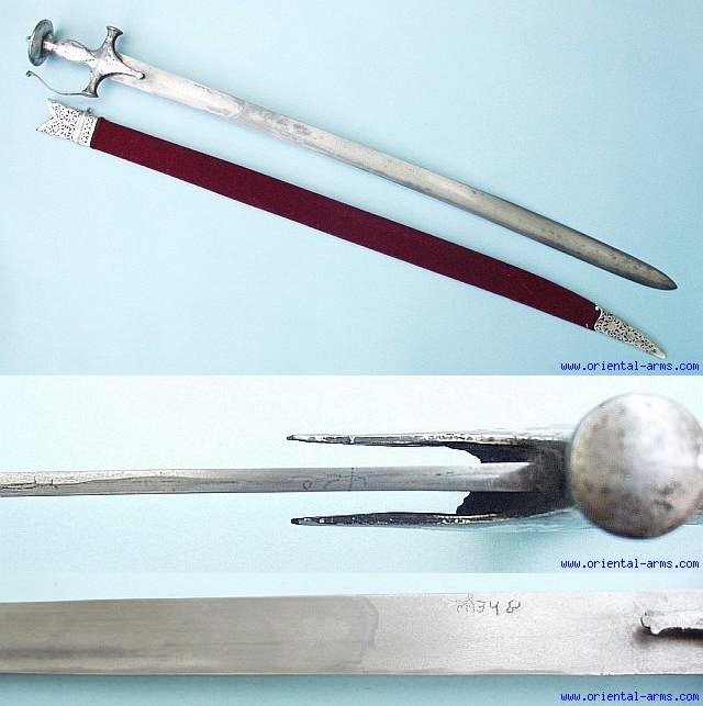

The reinforced point is for stabbing : rather unusual on tulwars. I have shown a similar one ( also potentially NW India or Afghani) in the topic "Indian short sabers"

Unlike reinforced point on Ariel's tulwar, this one is not designed as such. The blade was broken and the tip was welded as in scarf-welding technique. it is good quality repair and likely an old one.

You are absolutely right re. re-welding. The shadows in Pics 1 and 5 fooled me: they gave an impression of a swollen tip. Need new glasses....

Yes, as Alex says, though I feel it may be a more modern mend.
The pin with washer looks fairly new to me, as it shows no sign of wear,
and the edges of the washer still look very square. Also the peened over pin looks half -peened, not like it would be done originally.
Not looking for fault, but this is as it appears.

I think the mend is too good to be modern. I do not know of anyone who can make anything like this, unless someone is willing to give 10 tulwars to repair one Also, what's interesting is that there is no loss of wootz pattern near weld line, so someone knew how to control the heat not to destroy the pattern, and that is far above any modern skill IMHO.

I have seen many katar with scarf welded homogeneous steel tips that were heat treated. In those cases it added strength to this area. Haven't seen this on tulwar which makes this one likely a repair. However, the smith was knowledgeable of wootz as they managed the repair carefully, because you don't see much faded pattern at the join which would have required careful control of the heat.

Sorry to not agree with everybody but--- Unlikely to be a scarf joint. A scarf joint is when both ends are cut at an long angle and one side then slides over the other. This method is good for silver braze lead joints and if done neatly is nearly invisible. If you try to weld a scarf it is impossible to get full penetration and only the ends get welded. The blade in question has I think been joined by cutting each side into a v then welding. Pity that the welder has not found a better tip so now there is three different shades on one blade. If I do a weld I try to find a close match and use strips of steel from the replacement bit to use as the welding material Ok, never perfect, it is a repair but much better way than the sad blade being discussed.

A very good bladesmith mended one for me, (pattern -welded blade), and afterwards I could hardly find the join. This was done just a few years ago.
I would like to give the man credit, but he does not want to get inundated with this type of work, so asked me to keep it quiet.
I must respect that, but yes, it Is possible to have someone weld a blade and make an excellent job still.
What made me think the repair above was new-ish is the way the light catches the added piece;
It Appears to have multiple facets (or a bit wavey) on each side, not dead true as the rest of the blade seems to be.
It Is a good join though!!
Richard.
