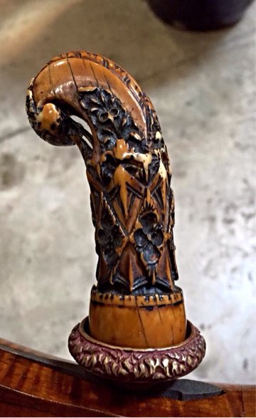

I am new to Keris and this hobby is very interesting and addictive as there are so much to learn.
I have come across an interesting Keris in Thailand with a Madura hilt/ Hulu but style Thai for the blade and the shield.
Any comment?

Hello Max,
Welcome to the forum!
Close-ups of the blade would be good. From this pic I'd guess this blade to hail from Madura, too.
Just one more comment: While collected in Thailand, there doesn't seem to have ever been any kind of keris culture among the ethnic Thai. Granted, quite a few keris are on display in the Bangkok palaces and occasionally one might have been worn at court but apparently more as a curio item (most were likely diplomatic gifts or war booties).
Thus, I'd avoid to refer to a keris as being "Thai" (as in "style Thai" or "Thai influences"). If anything, these keris are (northern) Malay, ethnically. Keris from southern Thailand seems like a reasonable/neutral description; however, Pattani/etc. would be much more informative IMVHO. We all know that modern state boundaries usually are a result of accumulated historic "accidents" - OTOH we're discussing cultural artefacts here and, thus, focusing on the originating culture does help. Sorry for the rant...

Hi!
Thanks for the clarification.
When I compare the scabbord with those of Indonesia, it looked different, which is why I see that perhaps this Keris has the Madura hilt but Southern Thai styled scabbord?

Hello Max,
What exactly did you compare it with?
To me this looks like a fairly typical example of a scabbard with crescent crosspiece. Quite commonly seen throughout Sumatra, the Straits area, and the Malay peninsula.
Since wood doesn't last terribly long in a tropical climate, this may have been a local replacement (looks old and good quality wood); or it may have been an attempt to acculturate an imported keris to local tastes.

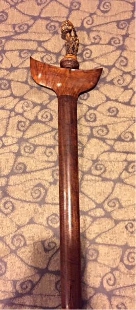

Old 11th June 2015, 09:25 AM   #6
maxbliss888
Join Date: May 2015
Location: Bangkok
Posts: 150
Default Keris
Thanks!
I am thinking of getting this and just wanted to make sure that the Keris with the Madura hilt fits with the Cerita blade are all correct..

Of course there are a lot of older Keris with parts from different locations, and even more newer "marriages".
If you go for the blade (which is a peninsular one) - even if its fit with the sheath is ok, it is quite worn, Greneng completely disappeared, Wadidang disturbed. You surely would come across a better Cherita blade someday.

Hi Max...i am afraid that there is nothing Thai about that hilt. Again i believe we are looking at a hilt from Madura, or possibly Northern Jawa. The pendokok at the base of this hilt i am not as certain about, but it is a mismatch with this particular hilt for sure and doesn't fit either by sizing or style.
I cannot comment on the blade since you have not posted a photo of it. I have seen variations of this scabbard form used with keris from both Sumatra and the Peninsula. Is there some reasoning you are using to identify this keris a Thai that you can share for a better understanding of what you are talking about?

Old 3rd November 2015, 01:50 AM   #19
Originally Posted by David
No worries Max, but we still can't comment unless you are willing to post this particular blade.
Hello David,
when i don't get something completely wrong speak/ask Max about the shown Cherita blade in post #1 and 4.
To answer Max's query, IMVHO is the blade with the scabbard very good fitting, only the hilt from Madura look "strange", i.e. not suitable for the combination.

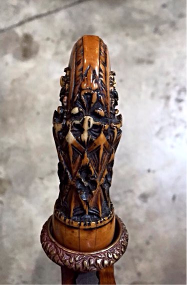

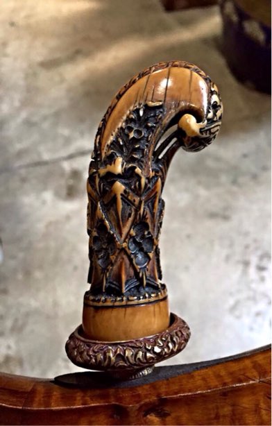

Default Hilt
The Hulu ..

Posts: 7,297
Yes Max, your keris does indeed have what some call a tumenggungan hilt that undoubtably originated in Madura. The oversized brass pendokok is a Bugis style AFAIK and inappropriate for this hilt both size-wise and culturally. The sheath form can be found on keris from both Sumatra and the Peninsula. I'll leave the origin of this blade to others. In it's current condition i am just not sure. Many times when we see keris ensembles that are a mishmash of cultures and styles to this degree they are mixes that have been slapped together my dealers in order to sell an ensemble that appears more complete. While this keris may well have been bought in Thailand it seems unlikely that calling it a Thai keris or even a keris with Thai influence is a valid or accurate descriptor.

Posts: 7,228
Max, I don't know what book you've presented a photo from, but I rather feel that the person who named that hilt form "temenggungan" is a little out of his depth.
The correct name is actually "tumenggungan", this name does not come from any flower of anything, rather it comes from the word "tumenggung", which is a part of a bupati's title. A bupati is a regent, who is responsible for the administration of a kabupaten, which is a semi-autonomous administrative district. In the old days the position of a bupati tended to pass from father to son, so the family became something like minor nobility.
The spelling "temenggungan" is a corruption which follows a local pronunciation.
The name "tumenggungan" indicates that this form of hilt would be suitable for wear by a tumenggung. The way in which the title is used is, for example, "Bupati Tumenggung Surodiningrat".
Incidentally, I probably should not be so positive as to say that this is the correct name, I probably should say that some people believe it to be the correct name.
