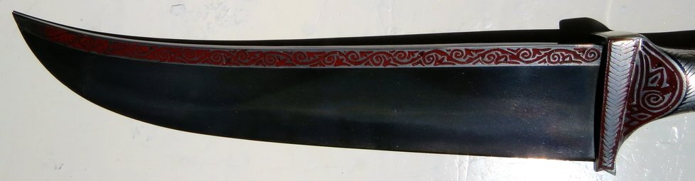

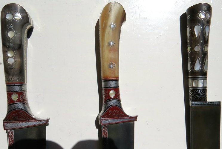

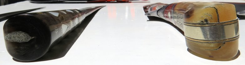

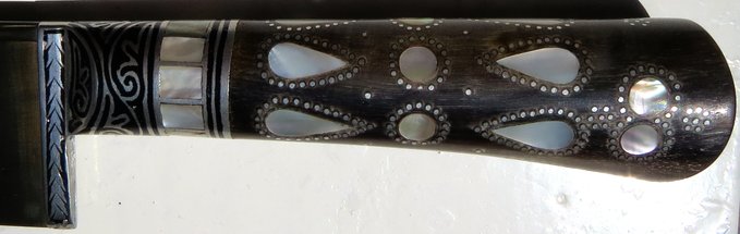

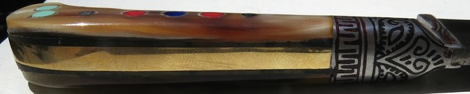

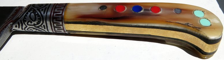

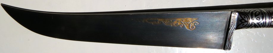

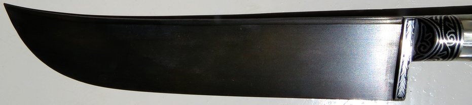

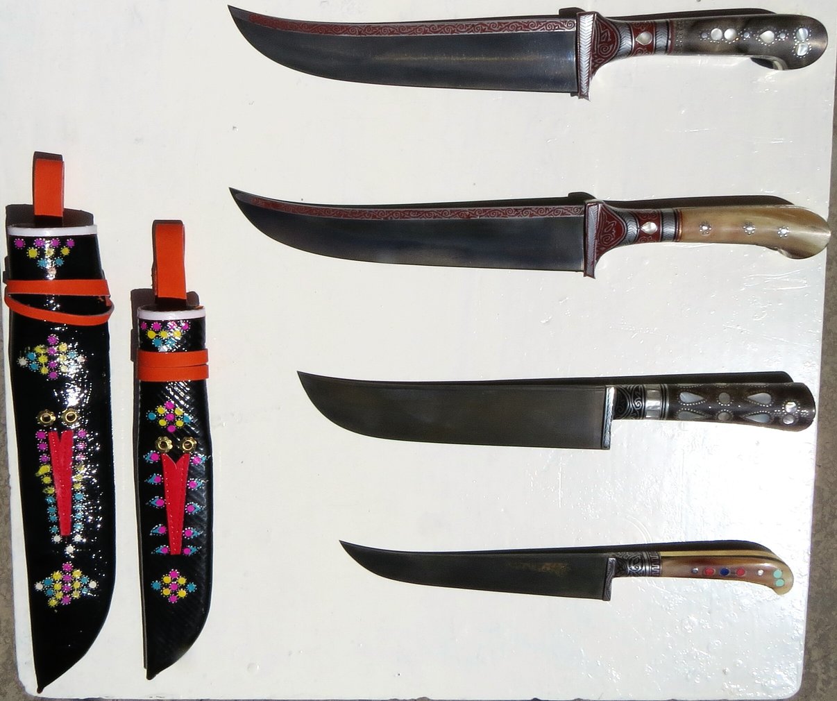

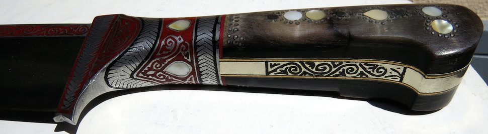

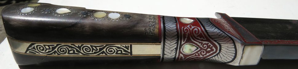

Well, since we're deep into this, here are some pictures of my latest acquisitions from Uzbekistan. Any thoughts on the quality, and how close or far from my goal I am? Unfortunately, some of them only had some pretty horrible sheathes (plastic?!) available, but what else could I do?

I cannot give any opinion on this, because I do not know what is considered to be acceptable quality where these were made, however, if we compare this work to modern custom knife work --- which would be a patently ridiculous thing to do --- the fit and finish is very, very ordinary.
Look at the very best first, then get experience in the specific field.

Okay, that's exactly what I was trying to figure out, and I was worried that it might be something like you said. I'll definitely be looking for opportunities to do what you said about seeing the very best. In the meantime, what exactly are you looking at in terms of fit and finish on these?

Drfiftwould, it has been brought to my attention that I have not answered your question satisfactorily, and you yourself have pursued a further clarification of my inadequate answer. Please accept my apologies. Let me try again.
Any fabricated item is made of a number of pieces, and often of a number of different materials, materials that can differ in nature, character, colour, texture, and so on.
In the case of a knife, or any other type of edged weapon, these pieces should be brought together so that the places where they meet, that is, their joining edges and/or surfaces, come together as closely as possible. All joints should ideally be a part of a circle or a part of a straight line. The only reason that one should be able to detect the joint is because of the different nature of the materials, not because the actual joint itself can be seen. This is what is meant by fit.
All materials used in the fabrication of a knife or other edged weapon do not usually come in the form required for construction of that knife or weapon, the material needs to be shaped and reduced in size so that it fulfills the purpose for which it is intended, once shaped it needs to be smoothed and often polished. These processes of shaping, smoothing, polishing require that the surface of the material be subjected to cutting, grinding, moulding, and abrasive processes. In the completed knife or other edged weapon traces of the processes used to produce the finished product should not be visible.
What I have outlined is a description of perfection, and this is very seldom achieved, however, the closer to perfection an item comes, the better is the fit and finish.
I was a member of the Australian Knifemakers Guild for a number of years, and I displayed my work at a number of knife shows. The fit and finish that I could achieve in a complete knife was not even remotely close to the fit and finish that was achieved by many other makers. The principal reason for this was that I used only very primitive hand tools, my ethic was that I attempted to make in the ways that were available to artisans prior to the coming of the Modern Age.
At a knife show the buyers of custom and handmade knives carry jewellers loupes and magnifying glasses, and they examine the work of the makers very closely before they part with the purchase price. It is never only a matter of the overall appearance of a knife, nor of design, it is a matter of seeking total perfection in the construction of the knife, the type of perfection that is found in finely crafted jewellery.
Clearly we cannot apply these same standards to the construction of ethnic weaponry, but the closer we get to these standards, the better is the fit and finish of the item under consideration.

Savage.. but true & correct!
Also the butterscotch horn hilt was clearly cracked while still on the animal, but was still used for the hilt.
So despite good colour clearly a defective & imperfect material, so presumably not top quality.

Thank you for your detailed and precise response, it was extremely helpful for me. I really wasn't kidding when I said 101! While as a collector I feel like a minow swimming among whales here, as a teacher I know that it's my duty as a learner to ask clarifying questions or I simply won't be able to learn. Please forgive my lack of basic knowledge, and be patient if I ask things that seem painfully obvious from the perspective of your many years of experience. Believe me, your answers are very much appreciated!
I'd love to see some of the handwork you did, if you don't mind posting it. If you've posted already, which I'd guess you probably must have, then the link would be great! The fact that you chose to use traditional techniques and tools in the modern age, and that you also attended shows where people were judging based on modern standards, gives you a really great perspective and I'd love to know more about it.

Savage I don't mind. Clear and concise? Now that's useful! Your comment about the horn being cracked while still on the animal, and the significance of that, was also a useful and much appreciated observation, thanks. As a novice, I'm quite aware that there is a lot that I don't know that I need to know. As an educator, I know it's my duty as a learner to ask clarifying questions and to learn from unsuccessful attempts. It was suggested above that I count mistakes like this as tuition on my education, but if I'm to do so I need to know why and how they are mistakes. Only experienced people such as yourselves can clarify this. I'm also hoping that this thread can help other people in my position to learn more before making purchases. So please, be brutal and tell me everything you see that's, shall we say, less then perfect on these pieces! I'm not afraid of embarrassing myself- I said this was 101 right in the title. I AM afraid of making similar and/or easily avoidable mistakes in the future.
