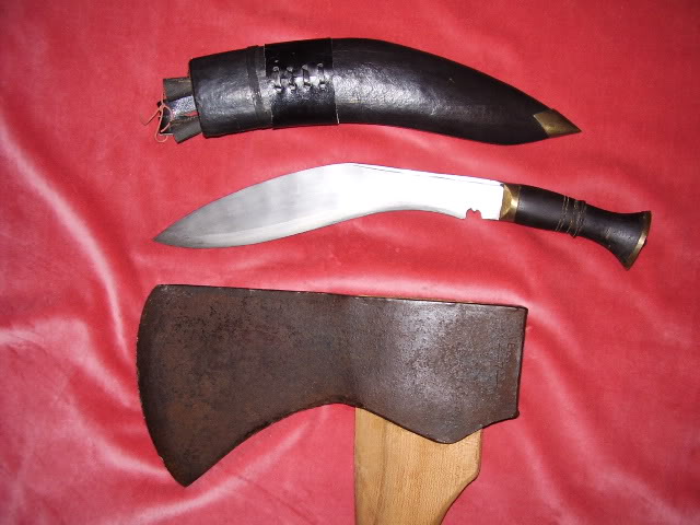

When I was a kid I used to use an old khuk --- probably 19th century --- to hunt feral pigs --- we'd run the pigs down with dogs through the lignum and then finish them with knives or spears.
I never really found the khuk to be a lot of use as pig knife, mainly because you need to swing it, rather than thrust.
I finally stopped using it and went back to the Lee Enfield bayonet that I had previously used.
However, I did continue to use the khuk as a general purpose bush knife, and it was pretty good for this.
A few years ago the blade came unstuck from the hilt, and I was very surprised to find that the tang was only a short stub tang held with natural resin. This seemingly ineffective tang had stood up to a lot of pretty heavy work, and when I got the knife the grip was already well worn, indicating that it had had a lifetime of work before I got it.

Yes, valid comments, but the khuk I'm talking about was a tool. meant to be used.
I used it.
The blade came loose.
So what?
I fixed it, and I'm still using that khuk as a camp knife/garden knife.
However, I would not recommend that a jade hilted Mughal court khanjar be used as a modern personal protection device.
Incidentally, my tool kit, that I use every time I have something to repair or make, has my father's tools from the 1920's, and my father's uncle's tools from the 1880's in it. To my mind it is no different using an old khuk to do a job, than it is to use old carpenter's and cabinet maker's tools --- or any other tools or household implements that are still functional, no matter how old they might happen to be.
Simple fact of the matter is that a lot of old stuff just works better, is more reliable, and less subject to breakage than the crap that is currently marketed. Plus you get the pleasure from using something nice. I can assure you that porridge eaten with a hallmarked English silver spoon made in 1825 tastes better than porridge eaten with a piece of Chinese stainless steel.

Heres an old photo of it next to a standard Gurkha issue kukri. {11 inch blade.} The handle is wytch elm, I find it better than ash , hickory is great but slaps the hands a bit sometimes?
It was virtually unused when I found it years ago, so I guess someone else thought it to heavy to use as well! It was the most expensive axe Elwell used to make.
I must make it a new handle.... just hard to find a piece that's not kiln dried & has the right grain shape.

To my eye, that's a very strange looking axe. I really don't know what use it would be where I live. Actually it is pretty close in shape to the imported things they sell as block splitters, but its sure not anything like our axes here. Its a bit hard to see what sort of grind it had, and that's really what tells you what the axe was meant to do and to what.

Sure its primarily designed for high moisture content softwoods, not that many of those in Oz. in the old days! & the modern rubbish radiata pine on plantations is all done by heavy machinery Id guess? {replacing even chainsaws.}
It was the standard English pattern felling axe for 200 plus years, but yep for me its just a splitter! Ive added a photo of its other profile.

Thanks for the view of the grind Spiral. Looks like it never has been ground to do anything, the grind looks like how it left the factory. Its close to what you can see on just about any generic axe, works just OK for most things, but its essentially a backyard axe, not a specialist tool.
That convex grind would probably work OK on hardwoods as well as softwoods. The way an axe like this bites into timber is that middle of the cutting edge bites first, after that the convex sides of the grind (like on your axe) push the timber apart as the curved cutting edge opens the penetration wider. So after that first penetration the edge doesn't really touch the timber, the convex sides of the grind separate the wood. This sort of grind protects the edge and an axe ground like this doesn't need to be sharpened every time you use it, which makes it a good general purpose thing to throw in the back of the truck. This convex grind is what we call a "rolled edge", different to the "turned edge" that some call a rolled edge that happens when you hit a nail . I've also heard this edge called an "apple seed edge".
But if it were a specialist tool, the grind would be tuned to the type of timber to be cut, the grind may or may not be rolled in a convex profile to the point, and the face of the blade behind the grind would probably be relieved to a hollow grind, which helps to prevent the axe from binding in the cut.
The grind could be convex, or flat, or combinations and the grind that was used would be perfect for the timber to be cut. When I was a kid a lot of bush workers were still using axes as specialist tools, and my memory is that they used to have different axes for different jobs, and they would normally grind and sharpen their axes themselves.
The big difference between a specialist axe and a generic axe is that your ordinary heavy edge grind splits off the chips, the specialist tool slices off the chips, mostly on a 45 degree angle.

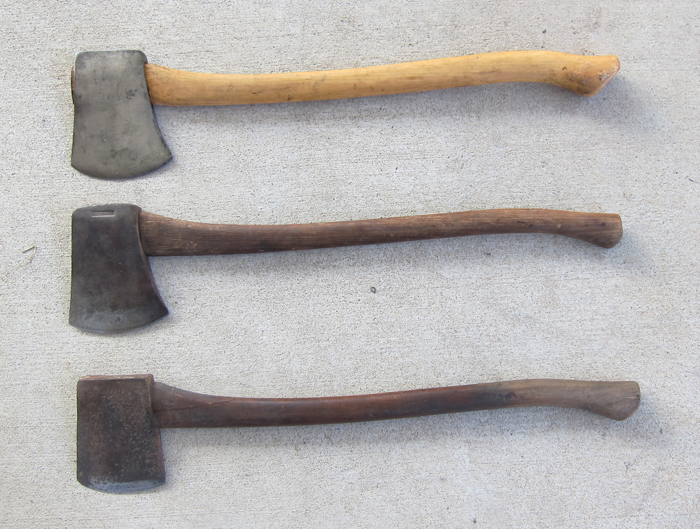

Here's a pic of three axes.
The top one is my 5 pound Plumb. It has been ground to an edge that will handle green hardwoods. Compare the difference between a professional handle and a hardware store handle, such as is on the other two lower axes. This axe went through a bushfire in 1954 and was heat treated again by a local blacksmith in Nowra.
The middle axe is a Keesteel, 4 ½ pound. This is a good axe and if properly ground would perform as well as the Plumb.
The bottom axe is a Kelly Dandenong pattern. This was a favourite farm axe and general purpose work axe for many years in Australia, this is a 4 pound axe. The design would never permit regrinding to make it a specialist tool, it’s a GP axe and must remain so.
During the 1950's the axe pictured here was used by a bloke working for my uncle to trim out felled trees. It got lost in the bush. Around about 1982 I was kicking around one of my uncle's old work sites in the bush, and I found it again.

This axe was the standard felling pattern in the UK Alan, nothing customised or special about it, It does what I ask of it though, better than modern axes sold for splitting.
In the UK we don't come across many axes that weight 7lb but are only a quarter inch thick 2 inches back from the edge. Here general purpose axes are thicker than that, {still concave of course.}Strangely in England being a 7lb Elwell it value is similar to your old bayonet! There sought after here! By both collectors & users!
I must admit the old American axes you mention & the custom Ozzie ones Ive never seen in the UK. Ill keep my eyes open for them! I guess Id have to search them out though... & any felling I do nowadays I only do with a chainsaw, so that's probably not much use to me, they look nice though & the custom handle looks usefull.
So when re.handled, Ill carry on using my 118 year old 7lb English pattern generic felling axe, {for splitting!}
Yes it does get tricky Driftwood, I have a couple of 200 year old plus rather exotic kukri that I haven't tested, but there of the reach out & touch someone with the sharpness rather than chopping weapons. But I don't intend to use them, I have others I can use.
