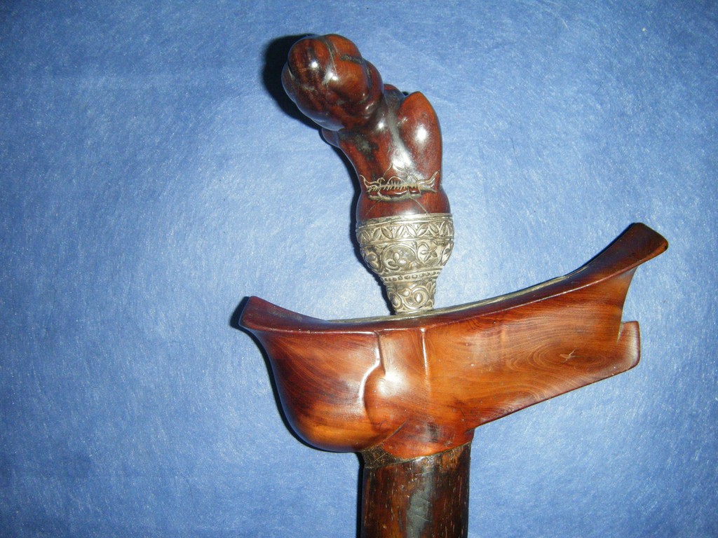

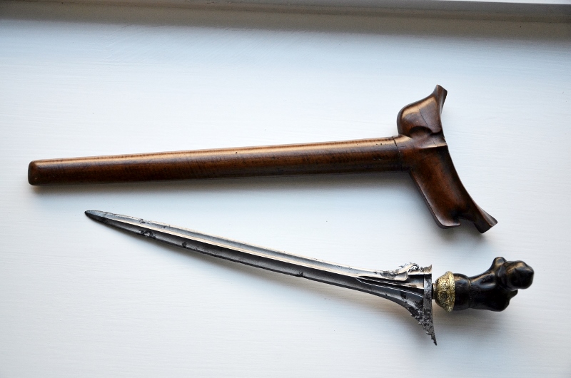

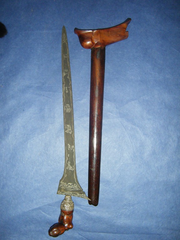

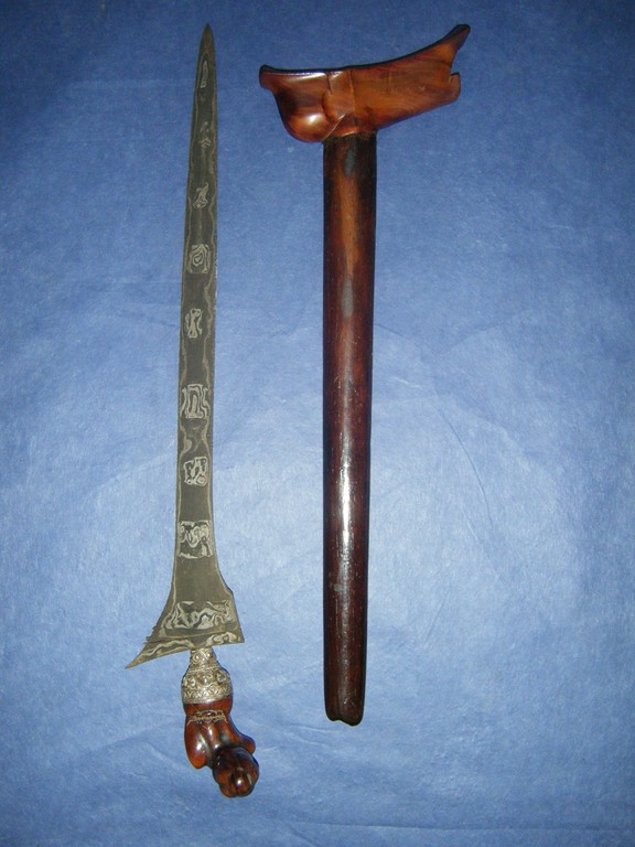

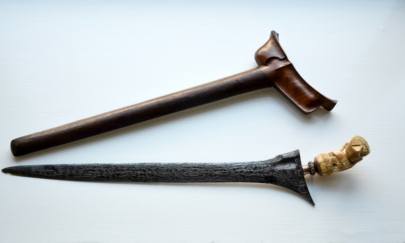

Happy Wednesday! After a brief technical glitch (thanks Lee, Rick and David for resolving this) I am back! Several members have made the suggestion to break up the keris in the post "Recent Additions" by type/area...honestly I needed help with this...so thanks to Kai and David we will begin with the first offering... Two Palembang keris.
The first features an ivory ukiran (absolutely marvelously carved), a medak/selut of suassa(?). The length is 15" (all measurements from the gandik side of the blade from the top of the ganja).
The second offering has a ukiran of horn, medak/selut also a suassa (?). 12" in length.
As I post these over the coming days, I'd humbly as that you'd please help me to understand more about these wonderful blades. Example; are these called Palembang due to the type of sheath/wrangka they are housed (one of the only commonalities I see)? Is Palembang the area they are found?
I appreaciate all of your patience, assistance and expertise...but enough of that...lets see some keris!

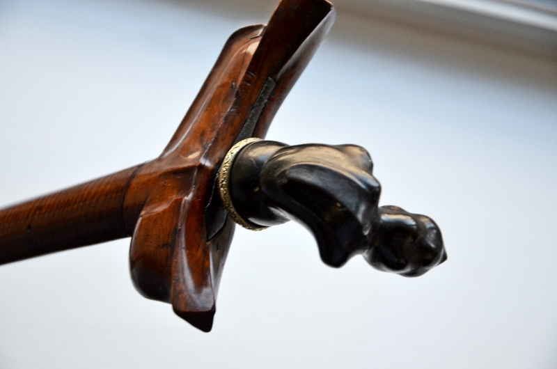

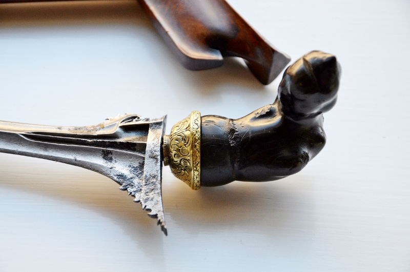

John, I think you might find that the hilt cup on the second keris is brass, possibly gold plated or gilded.
Palembang is in South Sumatra, it had and has long time political and cultural ties with the House of Mataram in Central Jawa, and was also influenced by Banten. Because of these associations the keris that come from Palembang very often have features that resemble either Banten keris, or Central Jawa keris.
"suwasa" (ngoko) or "suwaos"" ( krama) is low content gold alloy, supposedly anything under 14 carat. There are a lot of ways to spell this word, and there are other words for the same alloy. There is another alloy that is also called suwasa, and that is what we call in English "pinchbeck", the only way to tell the difference between pinchbeck and low carat gold is to get it tested by a jeweller.

John,

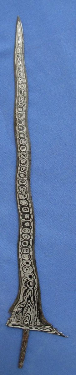

Your first kris has a blade with ganja iras (integrated with the blade) which is very common in South Sumatra. The ivory hilt is in one of the specific Jawa deman styles from Palembang and a masterpiece indeed.

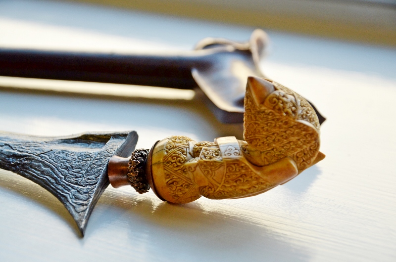

The second kris has a rare hilt in gana style which apparently originates from South Sumatra also although I saw some specimens fitted on Javanese krisses.
Both blades would benefit from cleaning and staining.
Best regards

[QUOTE=A. G. Maisey]John, I think you might find that the hilt cup on the second keris is brass, possibly gold plated or gilded.
Thanks Alan for the information...my first instinct on the second keris hilt cup was brass, but I truly wonder if it is plated...no tarnish, no evidence of tarnishing.
"Both blades would benefit from cleaning and staining."
Jean, thank you for your comments as well. I have read several things on this board about cleaning/staining keris blades...where does one get this done? Surely no place in the States? As far as the cleaning (nontraditional) once I received them they where all cleaned to stop/remove any active rust, wood and ivory all hydrated. They weren't horrible, but they hadn't been given any "love" for a while.
Thanks again for the information!

I don't see any need to clean/stain the ivory hilted one.
I could stain the the other one for you John, but you might not get it back.
Both are lovely BTW.

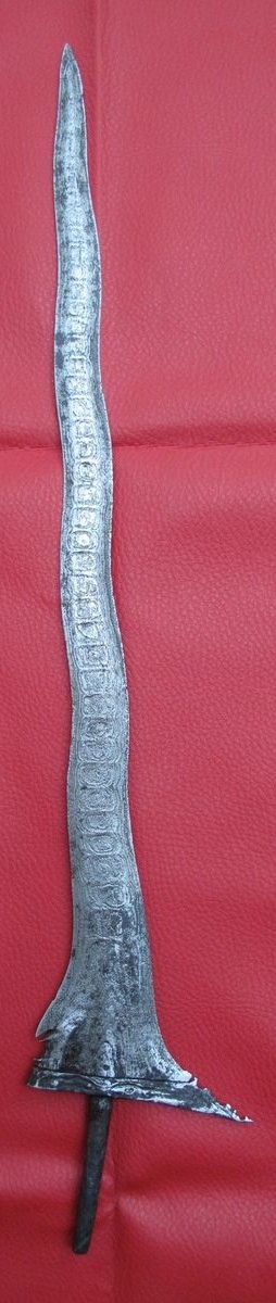

Well, the pictures are not very sharp but I seem to distinguish some black rust spots on the sorsoran and at the tip especially?
Old 20th November 2013, 06:21 PM   #7
Posts: 7,289
Your eyes are sharper than mine Jean.
Even so, if some residual rust remains on this blade rust removal does not necessary mean restraining.
Jean, the original shots of these are super sharp but I had to resize them all to upload them.
Each blade that had any rust on them have been worked with steel wool and oil in those spots. I have seen several times folks post about "picking" rust...I even tried that...this black rust seems solid and stable...should the blades be soaked in WD-40 for a time?
I'll do just about anything to preserve these things!
David, I may take you up on the staining...up to the part of the blade not coming back!
Keep the info coming guys...I am learning a lot!

Hi John,
two very nice keris you have there, agree with the others about the origin. But like David I don't see any need to stain both blades. The second blade you can try to stain it with hot vinegar but I doubt that there will be seen a similar pamor like by the first one. The blade is very very nice, just stunning. I have a Palembang keris with a similar handle like yours, at weekend I will post some pictures. But yours is much better.
Hi John,
You can fully get rid of the black rust spots by soaking the blade in pure vinegar or 10% citric acid for 24h or slightly more with regular scrubbings (see example) but then the pamor contrast will mostly disappear and you would need to treat the blade with warangan or arsenic oxide.... Personally and from the pictures I would opt for the full treating process.

Posts: 7,217
To stain or not to stain?
These days just about every keris we see, from anywhere, is stained.
Buyers expect it. Try selling a keris that is unstained and you very quickly find out that the price a buyer is willing to pay drops through the floor.
Collectors, especially collectors in the western world do want the pamor pattern to jump out of the blade and blind them.
However.
My personal opinion, and it is an opinion, not a widely held piece of knowledge, is that this staining thing is pretty recent and might be able to be attributed to human laziness, or perhaps more kindly, a new direction in taste.
Last year I handled a lot of very old blades in European museums. None had any evidence of ever having been stained, the surfaces were smooth and polished, where a blade did have a pamor you needed to get it under angled light to see it.
Similarly, I have seen and handled blades in the Surakarta Karaton store rooms. Many old blades bear no evidence of stain. From memory,there is an old blade that has never been in use , on display in the Karaton museum, and that has a Bali-like finish and a very light stain.
Sometimes in carvings from the classical era we see weapons with rays of light emanating from them; I do not know if we can interpret this as a depiction of the blade having a spiritual quality, or if it is simply depiction of reflected light.
Until the regeneration of interest in keris that has occurred since about 1980, if I bought a Peninsula or Bugis keris from outside point of origin, say from Britain, or USA or here in Australia, these keris were usually polished, or at least, they bore evidence of an unstained finish --- not always so, but usually.
So, if I look at these keris that John has shown us, my inclination would be to do almost nothing.
The ivory hilted one I would probably give a good soak with WD40 or some other penetrating oil, then gentle selective cleaning with picks, a hard toothbrush and maybe a little bit of steel wool wound around the end of a sate stick. Wash with mineral turps and toothbrush, dry with hairdryer, drench again with WD40, allow to dry, then apply a long term protective oil and store in plastic film.
I find it advisable to use a 2X or 3X jeweler's loupe when doing this sort of work.

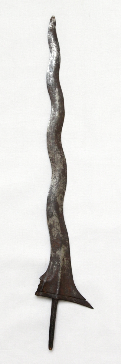

The horn hilted one I'd probably use a small acid brush and just apply the acid to the corroded areas. I'd probably use hydrochloric and I would not leave it to work and walk away, I'd be watching it while it worked. Then I'd pick the loose corrosion out of the pits and repeat and repeat until I got down to hard metal. When the corrosion was 99% gone it would get a light cleaning with vinegar or citric acid, get rinsed well, WD40 over night and protective oil and plastic film. I would not stain this second blade. Not if it was going into my own collection I wouldn't.
I've used a few "probably's" here. I've done that because if I handled these keris my opinions might change, but from what I can see the above is how I would proceed.
Old, dry wood, ivory, bone, horn, all respond well to repeated application of hand rubbed baby oil.
Naturally I would demount the blades before doing anything at all.

I do not see any evidence of the second blade having ever been stained (to my knowledge...which is growing thanks to ya'll).
I think I may try a good long soak in WD 40 (can't hurt anyway) to start. I do not have any experience with suing acid for this...I think I'll stick with the less evasive...Alan, what about the EvapoRust you posted about? Thanks again for all the info and advice...it is greatly appreciated!

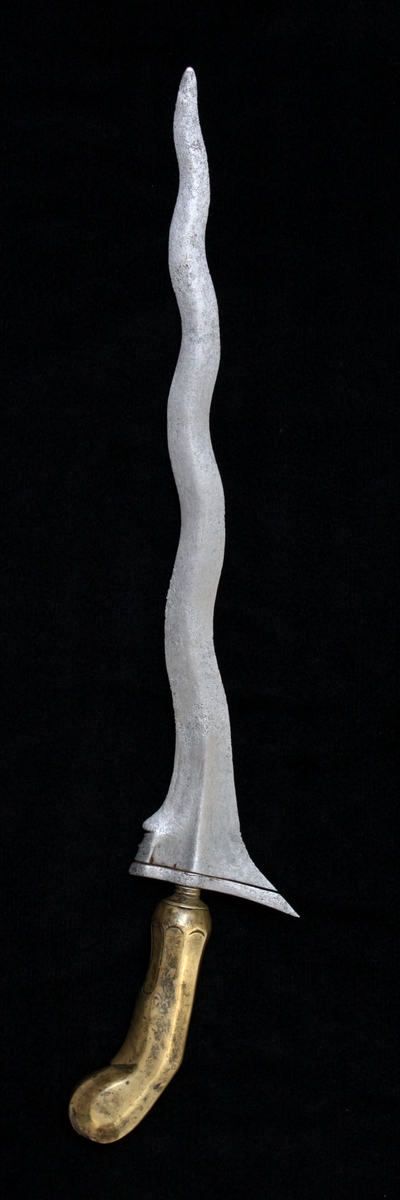

John, I attach the pictures of a Sumatrese blade before and after cleaning & staining so you can better appreciate my position.
Best regards

I've never experienced this problem Jean --- the brighter areas I mean. I have no idea why you have, and why I haven't. This spotting thing is something I've done for as long as I can remember, where the occasion demanded it.
EDIT
Jean, I've just gone back and had a close look at your blade. How was this stain job done? My guess is that it is probably a stain done either by the soak method or by the brush method that I myself recommend for beginners to use. When I've spotted a blade it would have been one that I stained myself, and I do not use either of these methods to do a stain.
My recommendation for John's keris was to use the spotting, then follow on with picking the rust away, by doing it this way you are using the acid to loosen the rust, but not dissolve it, that's why you watch the job, you don't want the acid to start eating away too much of the hard metal, you just want it to fizz a little bit, when the fizz dies down you leave it there a bit longer, wash it and go to work with the pick, its not a matter of leave it there and forget, you use it just like you'd use any tool.
I also recommended only a light vinegar clean when the rust was gone, and the purpose of this would be to get rid of any other dirt and possibly allow the metal grain to be seen.

I'd like to hear other members opinion on the origin of the horn hilted blade. It has no pamor as far as I can tell. Is it attributed to Palembang as well?

The horn hilted blade bears many features that would permit it to be classified as Surakarta, however, it is impossible to give it this classification from a photograph, bearing in mind the long term association of Palembang with Central Jawa, it is more likely that this keris is a Palembang copy of a Surakarta keris.

Jean, as far as I can see the horn hilted keris has no pamor at all...seems to be mono steel (or skin over a core)...very uniform all the way around. The black/stable-now rust really bothers me on this piece but I want to take the less evasive route possible as I have not done this before (and I am guessing this blade is at least 19th century). I have others in my collection that you can tell were stained at one time...this one doesn't ever appear to have been stained...I could very well be wrong. BTW Jean, beautiful keris!
There are a lot of processes and ways to approach a blade clean.
Hello Alan,
As I said I was too hurry and rough with the stain removal procedure.
The staining was done by the warangan master Herman in Solo, he uses the soaking method as far as I know. One may find that the pamor contrast is too high but I like it like that and it can be attenuated if required and with time.
I appreciate what you recommend and agree that a light vinegar soak will correct any difference in brightness and colour of the blade.
Thank you Sajen as well...looking forward to seeing your keris.

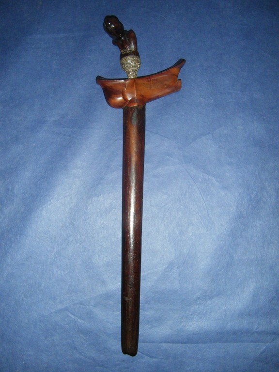

Hello John,
here some pictures of my Palembang keris with wooden gana hilt.
Sajen is online now   Reply With Quote

Old 23rd November 2013, 05:33 PM   #30
jwkiernan
jwkiernan's Avatar
Join Date: Nov 2006
Posts: 37
Detlef, thanks for posting the pictures...very nice keris indeed! The hilts are very similar indeed! Again thank you for the look! Have a great weekend (to all)!
All my best,
John
