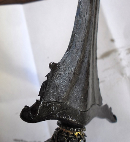

hello here my keris please help me to tell me about it wat kind of keris it is
its in oil becauce it was rusty ,
hope the picture,s will help
greetings auk

Thanks for the additional photos Auk. A very interesting keris. All i can add to what Alan has stated, even with the additional images, is that the dhapur appears to be some form of damar murub, with the three luks appearing at the very end of the blade as they do, but i have never seen one with quite these same features and can only assume that the dhapur here requires some other names to fully describe it. I would still like to see some clear close-ups of the gandik as i am having a hard time figuring out just what the form is here. If it is not simply that the form is eroded by time i do not quite recognize what is supposed to be from the photos. I can't tell if i am looking at a sekar kacang that has been eroded or pushed flat against the blade or if this is meant to represent a human figure as in a keris putut. Also interesting is the deep central fuller of the blade that blade that extends almost to the tip. These are features i have not seen on other damar murub blades. Perhaps Alan has some better ideas with these new photos.

Could you make a picture frontal of the sekar kacang?

Auk, I mean the right side of your last picture but frontal on the edge.

Hi Henk thanks fore the reply hope this picture wil do

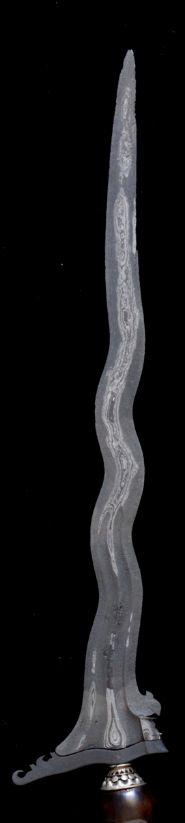

There are many possibilities but based upon what I can see I'm in the opinion that your keris has been repaired/altered--or even made to look unusual from day one, I'll call it dapur kreasi baru/owah-owahan or the like --contemporary/non standard dapur (might be once sepang-urubung damar combo which is okay, anything in that direction), tangguh kamardikan--modern/vintage, pamor wos wutah, origin Java-Madura somewhere, I don't have any opinion on tuah/isi. I could be wrong. Nice material but rather lacking on garap I would say, sorry. I wish better condition keris coming your way soon

hmmm....can can you tell us why you think this is a contemporary keris?
I am also confused by you opinion that "your keris has been repaired/altered--or even made to look unusual from day one." These seem to be two diametrically opposed opinions in one sentence. Which do you believe, that it has been altered or that it was made this way from day one? I am not sure that i see where it has been altered from the photos provided.
Personally i don't think the workmanship (garap) is that bad. This is not a masterpiece keris by any means but i am in agreement with Alan that it is an nice, old and unusual keris that aside from what appears to be some damage in the gandik area is in pretty good shape (sheath not withstanding). Frankly, i like keris that don't fit clearly into the mold. It seems senseless to me to create some kind of composite name simply to have a dhapur to tag onto this piece.

Actually Auk, i think that a 3/4th viewpoint might be more helpful here than the straight on shot Henk requested.

Hello Chandra,
Thank you for your interesting opinion and personally I would not discard it too quickly as I also see some signs that this may be a recent or altered piece. I know your experience and as you live in Jakarta you are more familiar with the tricks of the trade than most of us. Personally I find this question of distinguishing between a genuine old blade from a recent and altered one as very difficult and primordial for a collector and any input on tis subject is welcome. So please elaborate more about the observations and findings which make you believe that this is not an old blade, we are listening!
Best regards
Yes, this is not a standard Central Javanese dhapur although as said by Chandra it could be called Sepang/ Damar Murub. The ganja sepang is not standard. Additionally the strange kembang kacang and grooves seem reminiscent of the Megantara dapur (see pictures). The maker should have been (or be) a very imaginative guy!

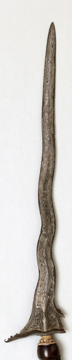

is it helpfull if i post a picture from the peksi
also i was reading some older article of keris and found this on vikingsword
about the keris megantara like jean mentioned i see a little risemble in the blade specialy over the deep central fuller of the blade that blade that extends almost to the tip see the fifth picture on http://www.vikingsword.com/vb/showthread.php?p=99755
greetings auk

I've tried my best to enlarge and enhance this image. Still hard to know anything without this blade in hand.
Jean, perhaps you could share with us where you see signs of this being a recent or altered blade. Frankly i just can't tell what's up in that gandik area.

Yes. David was right. It was too frontal. With these pictures we are quit sure there is no figure of what kind in the gandik.
Hard to classify this keris. I'm with David and Alan. I cann't either subscribe the meaning of tunggulametung. What I see is a very nice old keris. Not a masterpiece, but I love it.
Dhapur has a Damar Murub appearance and the pamor is wos wutah or beras wutah. I have an old dutch book that says when the dhapur cann't be named all different names of the individual parts should be mentioned. In the way tunggulametung did.
Anyway imho a very attractive older keris.

aditional i wil put some foto,s of the peksi and the gonjo,
Here you can see the peksi is twisted at the end not clear becuse of some rust but its twisted also in th egonjo you see a little hole next to the big hole its square verry tiny i think you can put a little peace of scuare metal in it so the gonjo stays at his place and wont move i just try it wit a verry little peace of wood and yes the gonjo cant move anymore so it seemt to serve as a kind of lock.
Also the gonjo fits perfectly and the blade have a core i can here
hope this wil be helpful in our further quest about this keris.

Old 12th September 2013, 08:44 AM   #27
Posts: 7,256
Yes, cutting a keyway in the pesi hole of the gonjo is one of the more common ways of fixing a gonjo in place, in fact, its the method I myself have always used on the kerises which I have made. Sometimes we find that a pesi hole will be made a very neat fit to the pesi, and then fixed by using a punch to squeeze the metal in around the pesi. Bugis keris seem to use this method fairly often.
I feel that perhaps these pics of the pesi may give a useful indication of the age of the wilah.

The point I wish to make is this:- it is simply not possible for any person who is not an insider in the keris trade of Central Jawa to know with any degree of certainty what is likely to be a forgery and what is not likely to be a forgery. I use the word "likely" because the only way to be certain is if the forgery was observed whilst in production. It is not possible for any collector, and most second or third level dealers to have any certainty at all in what is and is not a forgery.
The gonjo is unlikely to be original to the wilah. The material is different to the wilah and the degree of erosion to the underside of the gonjo is not consistent with overall blade erosion.
This keris could have been re-manufactured from a much larger keris, that possibility exists, but the only type of keris that I know of that could give sufficient material to create what we see in this keris is the very large old Tuban keris, and the material in this keris is nothing like old Tuban material.
Hi Alan,
Thank you for you very interesting and detailed reply and I fully agree with you.
Actually the possible gonjo replacement was the first observation which I made (fancy shape, different metal, and impeccable interface line with the blade) and this seems confirmed by the additional pictures from Auk (rebuilt peksi base, perfect peksi hole, lock).
And I also suspected that the blade may have been re-shaped from a larger one because of the strange gandik and the pamor which fully extends to the edges of the blade.
Is there a way to assess if the luks at the tip are original or not?
Best regards
Hi Alan,
Could you please elaborate more?

Hi jean thank fore the reply i think the luks at the top are original because the pamor goes with the waves.
i wil send a picture of it hope its clear enough because of some rust
