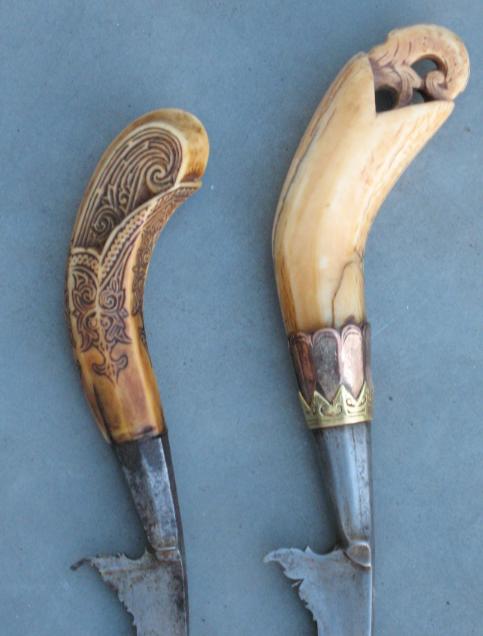

I had always suspected that the scabbard was a later addition. Yes it is small: 8 3/4 inches overall, blade a fraction over 5 inches. Here are additional images as requested. |

ivory rentjong in Atjeh, are these the 2 variations you mean
#24 | |
Join Date: Jan 2007
Posts: 1,464
My feeling is that both are Atjeh types. Have you checked Fisher? Maurice |
#25 | |
Join Date: Nov 2006
Posts: 2,238
I did not check Fisher yet, but Imho these are both Atjeh. But as John mentions specifically 2 type of rencong with ivory hilts, I just wanted to check if this is what he means. Best regards, Willem |
#26 |
Join Date: Jul 2009
Posts: 51
Hi Willem,
Yes, this kind. There are a few more variations. Btw, nice pieces. |
