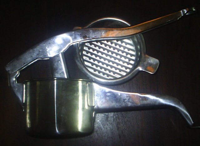

Perhaps the best solution to your predicament is to buy a labour saving device - one of those stainless steel lemon squeezers where you squeeze out the juice using a lever, instead of using the good old fashioned kampung way of squeezing by hand. I used to handle one of these working in a fast food joint to make lime juice.
I've seen wooden squeezers as well, if you prefer something traditional in a craft shop in central market.

Using the lime squeezer would be a good option as it saves much more time and energy but what i would like to suggest is getting those concentrated lime juice that were already squeeze and packed nicely in some supermarkets. BTW where can i obtain those warangan and what does it look like ?
