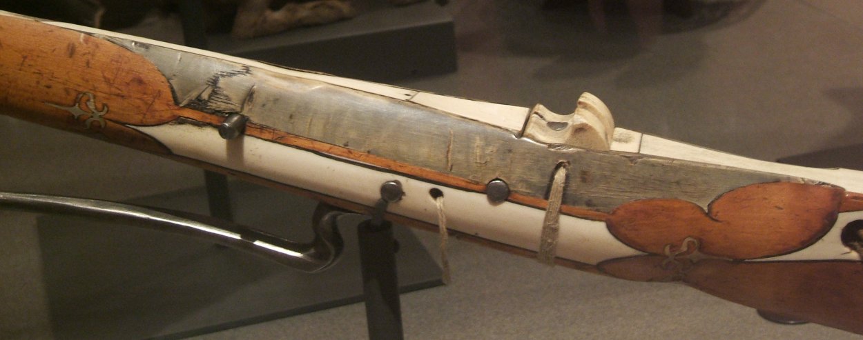

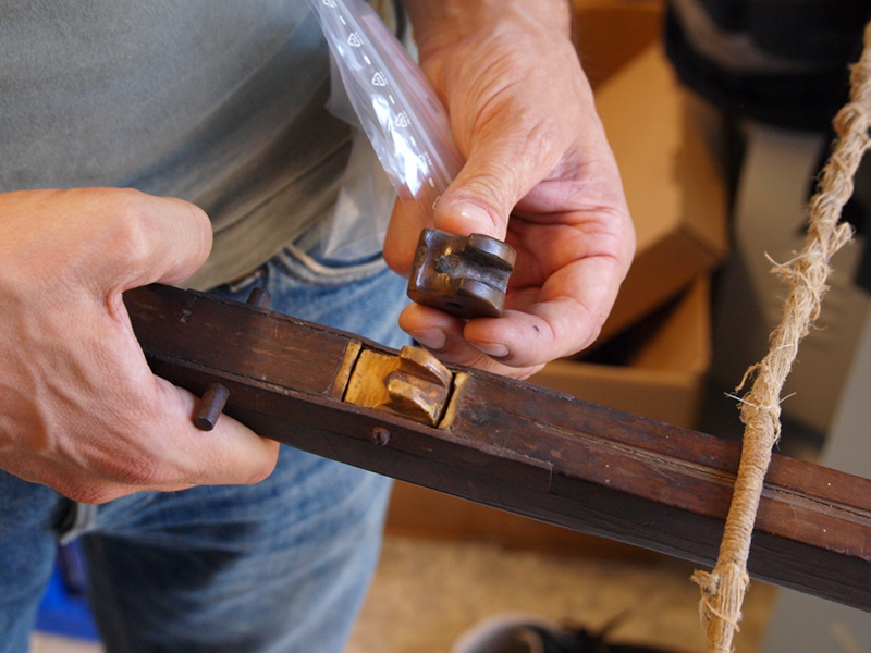

Archaeological Museum Hamburg is actually excavates some medieval housing sites along a street in Hamburg-Harburg which directs to the former main passage via the River Elbe to Hamurg. At one site they found at least 3 chrossbow nuts made from deers horn as well as a lot of crossbow bolts and musquete barrels dating to approx. 15th century. As they found also lots of other bone and horn objects they suppose that it was a bone carvers house, but the extraordinary high amount of other projectiles may also alow an other interpretation of the houses inhabitants profession.
Here is a photo which I made in August 2012 showing one of the corssbow nuts in comparison with such an object in a reconstructed corssbow. Unfortunately the museum has no information about this crossbow, neither its origin nor its dating. It was found in the museums inventory without any information. They believe it is an early modern reconstruction, maybe of the 19th century.

Thank you for posting Andi! Do you have approximate messurements of the nuts? That would be very interesting!

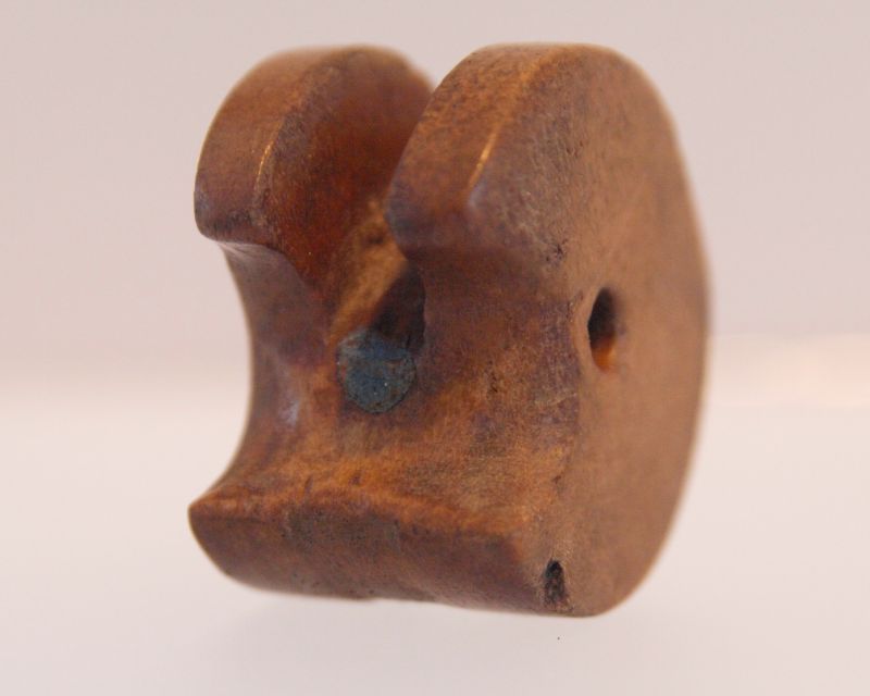

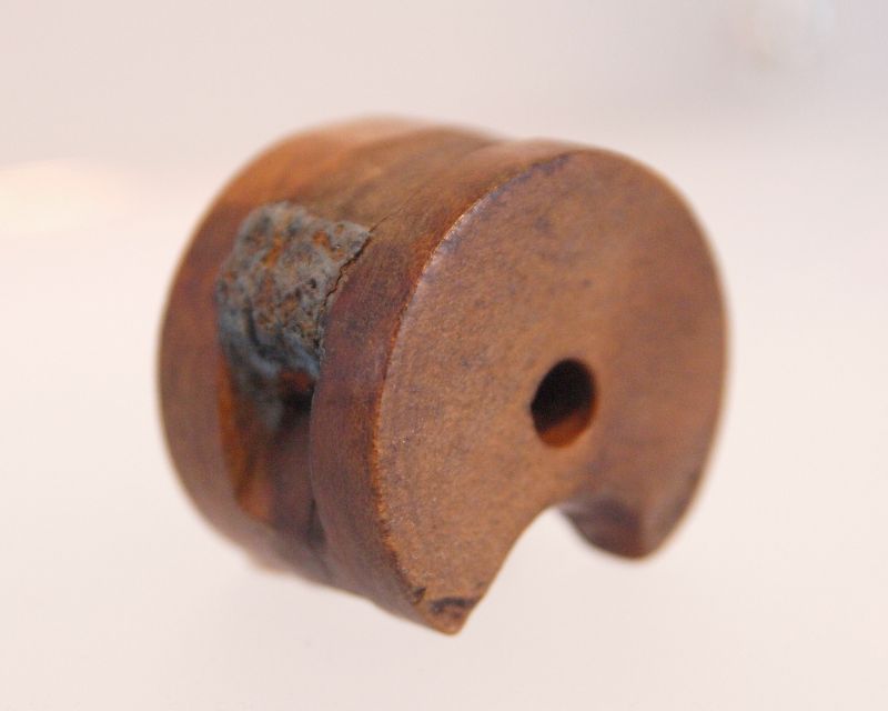

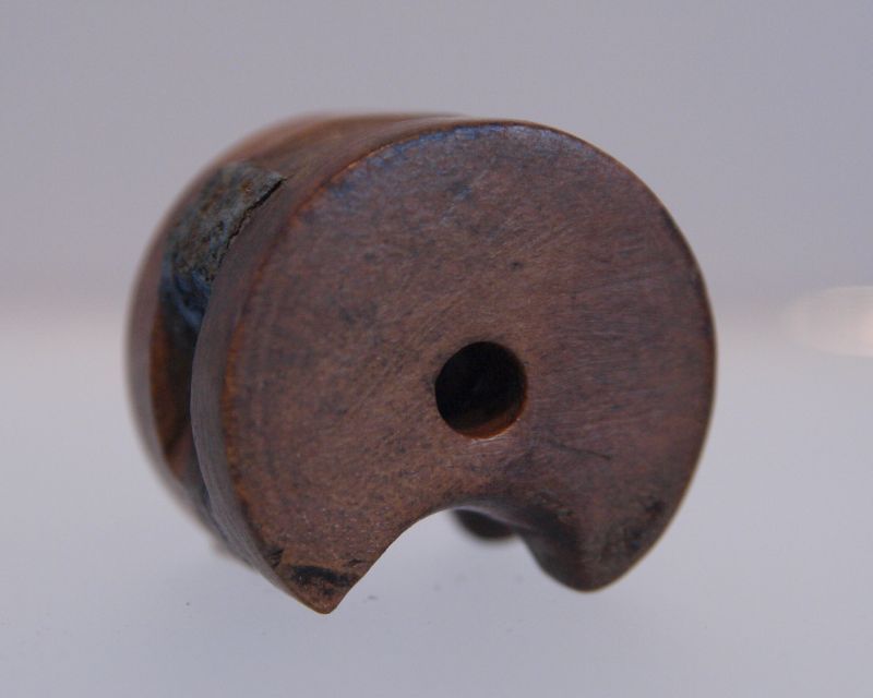

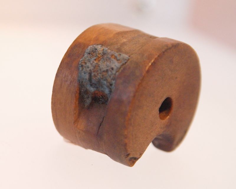

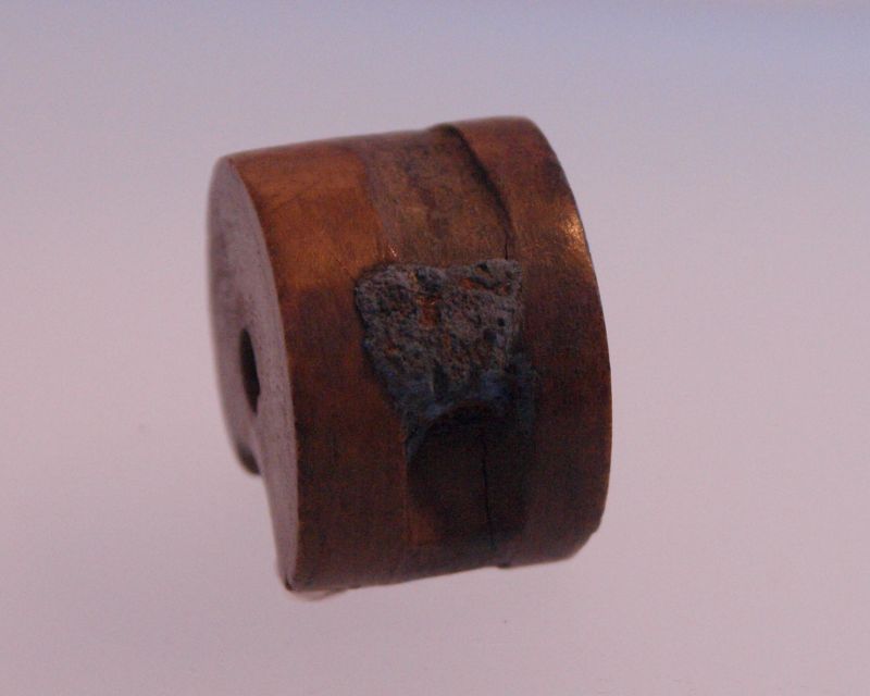

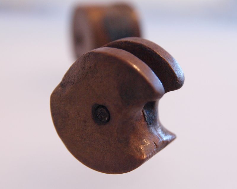

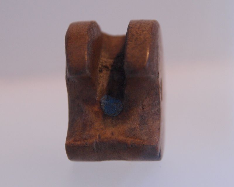

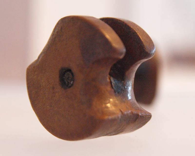

Here you will find some macro photos of a crossbow nut found in the Schlossstraße in Hamburg-Harburg.
I am wondering about the substance which can be seen on the middle of the nuts notch. It seems to be metallic, possible lead or tin? Has anyone an idea of its purpose? I was also not able jet to take the dimensions and have to ask the exavators of the object.
Andi is offline   Reply With Quote
Old 20th March 2013, 08:48 PM   #224
cornelistromp
cornelistromp's Avatar
Join Date: Mar 2009
Posts: 1,071
yes it is lead, or, in the case of a brass nut it is an iron bar.
it ensures as a counterweight that the nut reverses in the ideal position. (After each shot the nut rotates fast around.)
in the neutral position, the nut can be fixed by the bows internal mechanism while the string stretched can be attached behind the nut again.
best,
Old 21st March 2013, 11:59 AM   #225
Micke D
Join Date: Jan 2011
Posts: 41
It’s definitely not lead, it’s a reinforcement piece of iron or steel that’s riveted in the nut. All crossbow nuts have this from at least the 14th century.
Micke D is offline   Reply With Quote
Old 21st March 2013, 02:11 PM   #226
cornelistromp
Join Date: Mar 2009
Posts: 1,071
yes can also be made of iron.
the metal you can easily test with a magnet and the function of the counterweight with a shaft through the hole of the nut.
I believe it is a counterweight, apart from this a hole with metal will weaken the nut and not reinforce it.
the later 18thC brass nuts also have a counterweight, a metal bar placed on the width of the nut , reinforcement is no question here also.
all the 17 and 18thC crossbows I have and had in my collection had a counter weight build in making the nut always turning into the same position.
best,

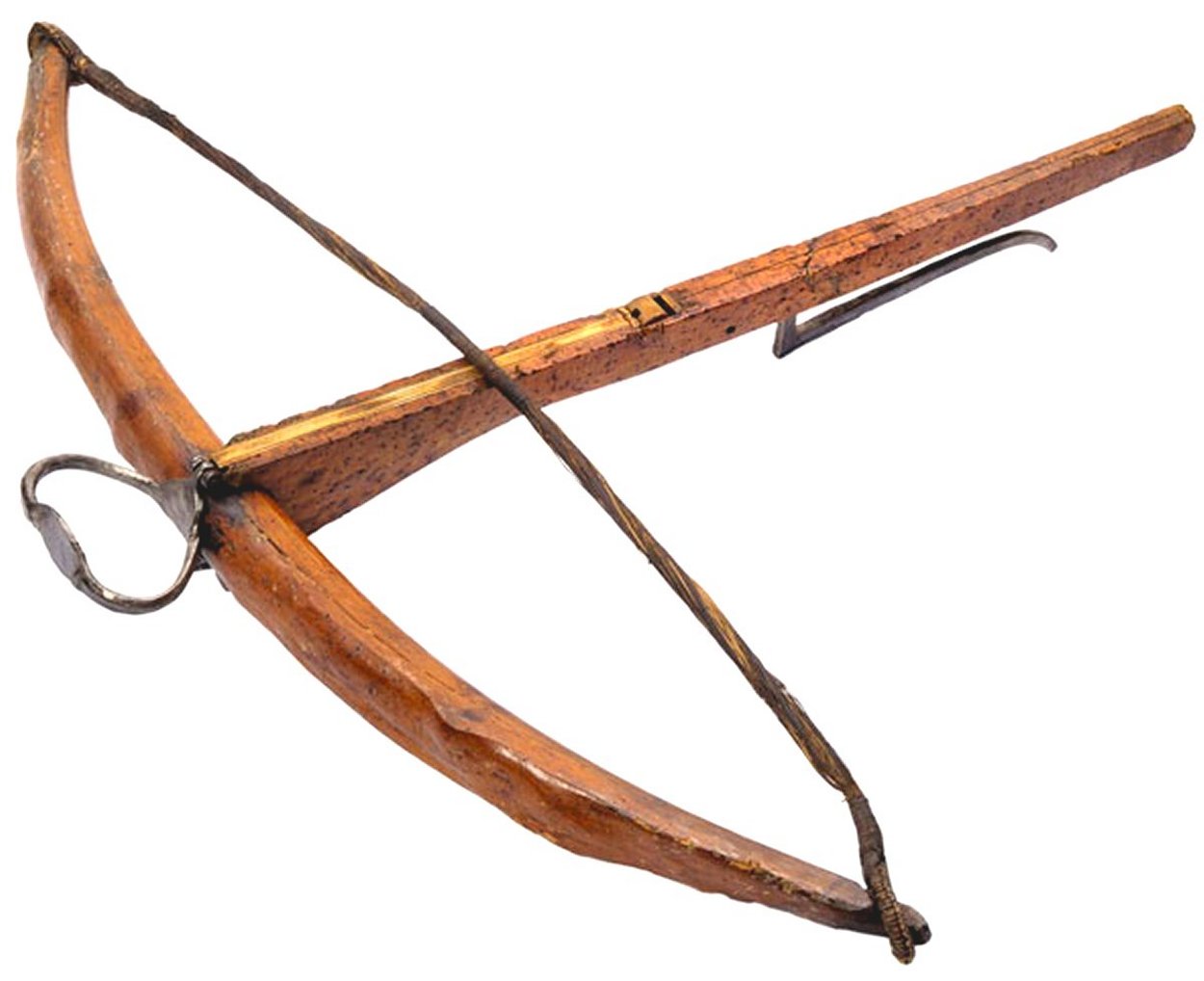

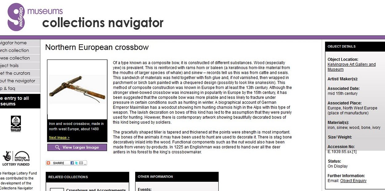

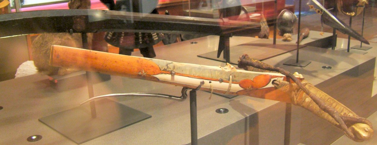

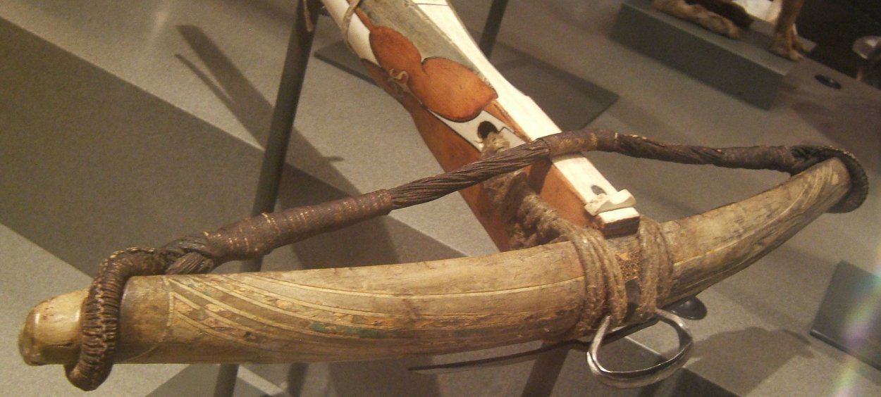

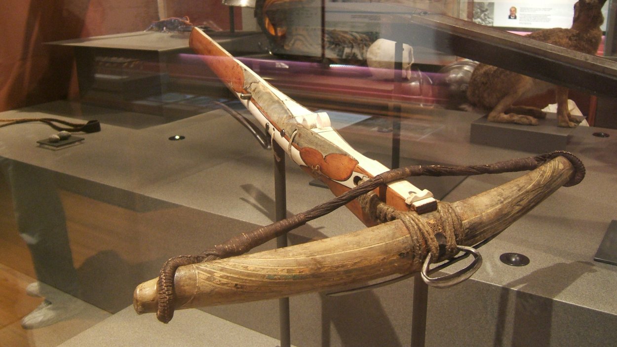

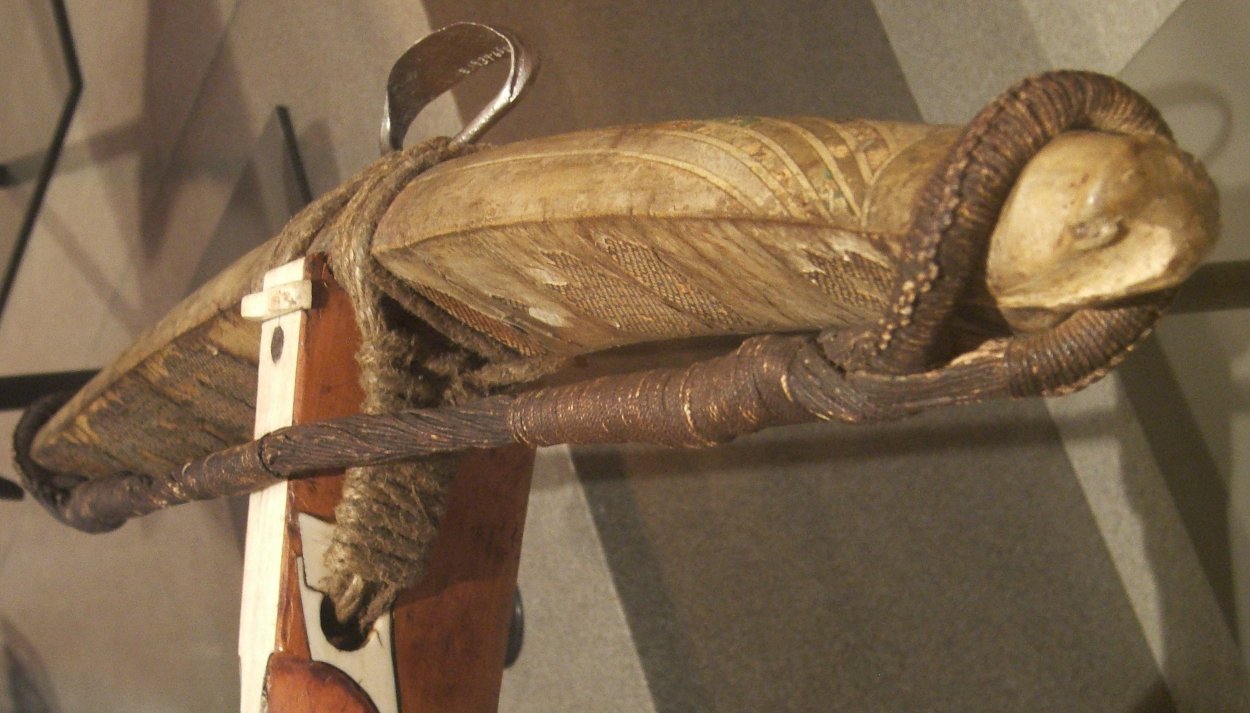

Default Two fine Gothic Crossbows in the Kelvingrove Museum, Glasgow

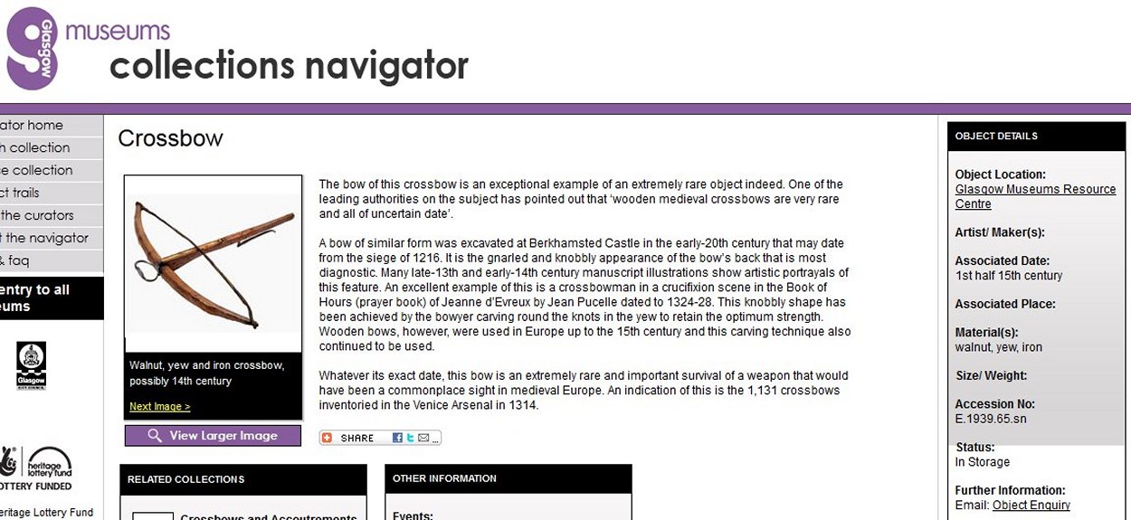

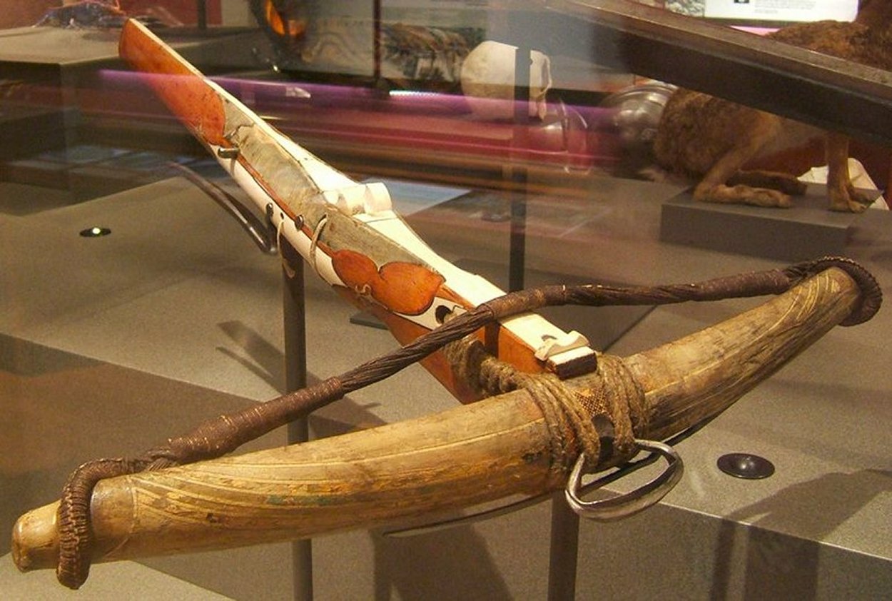

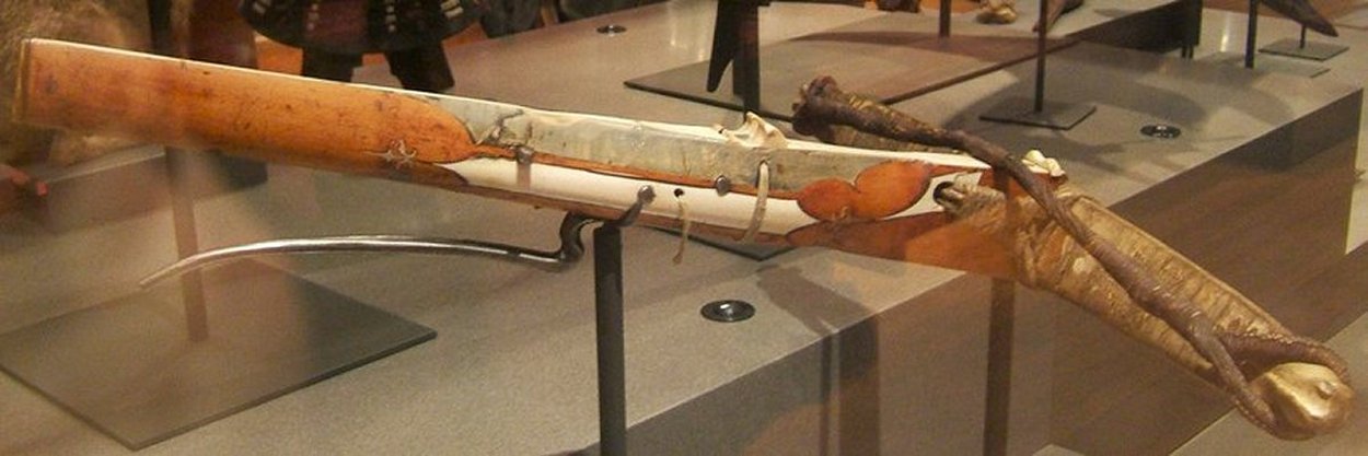

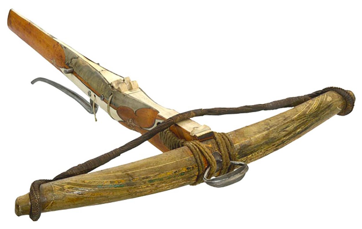

I thought I had posted these here before, and the search button confirmed me, but I cannot find them.
So please enjoy.
The first crossbow is of very early type, 14th c., the second may be dated to the end of the 15th c.
Michael

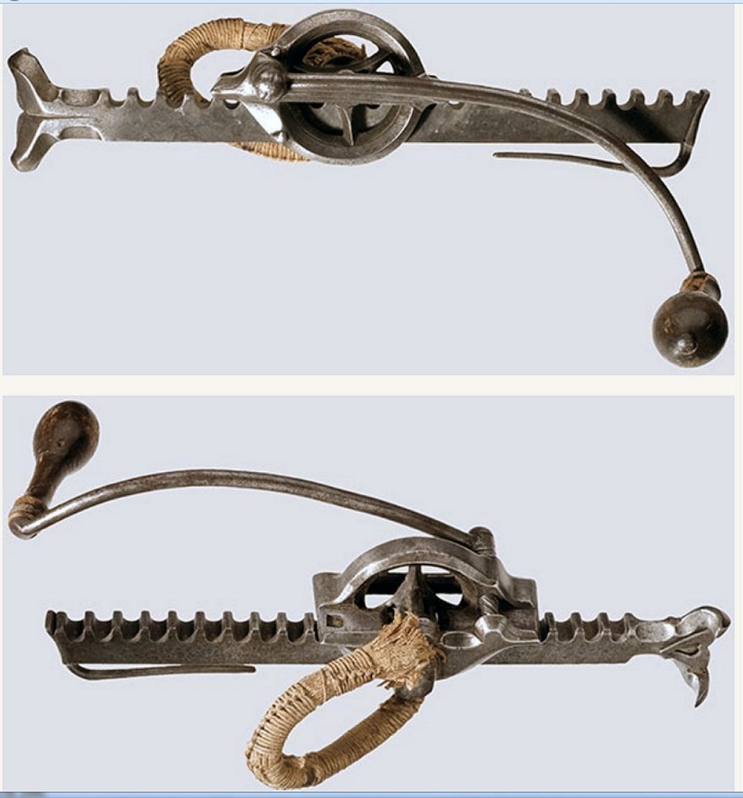

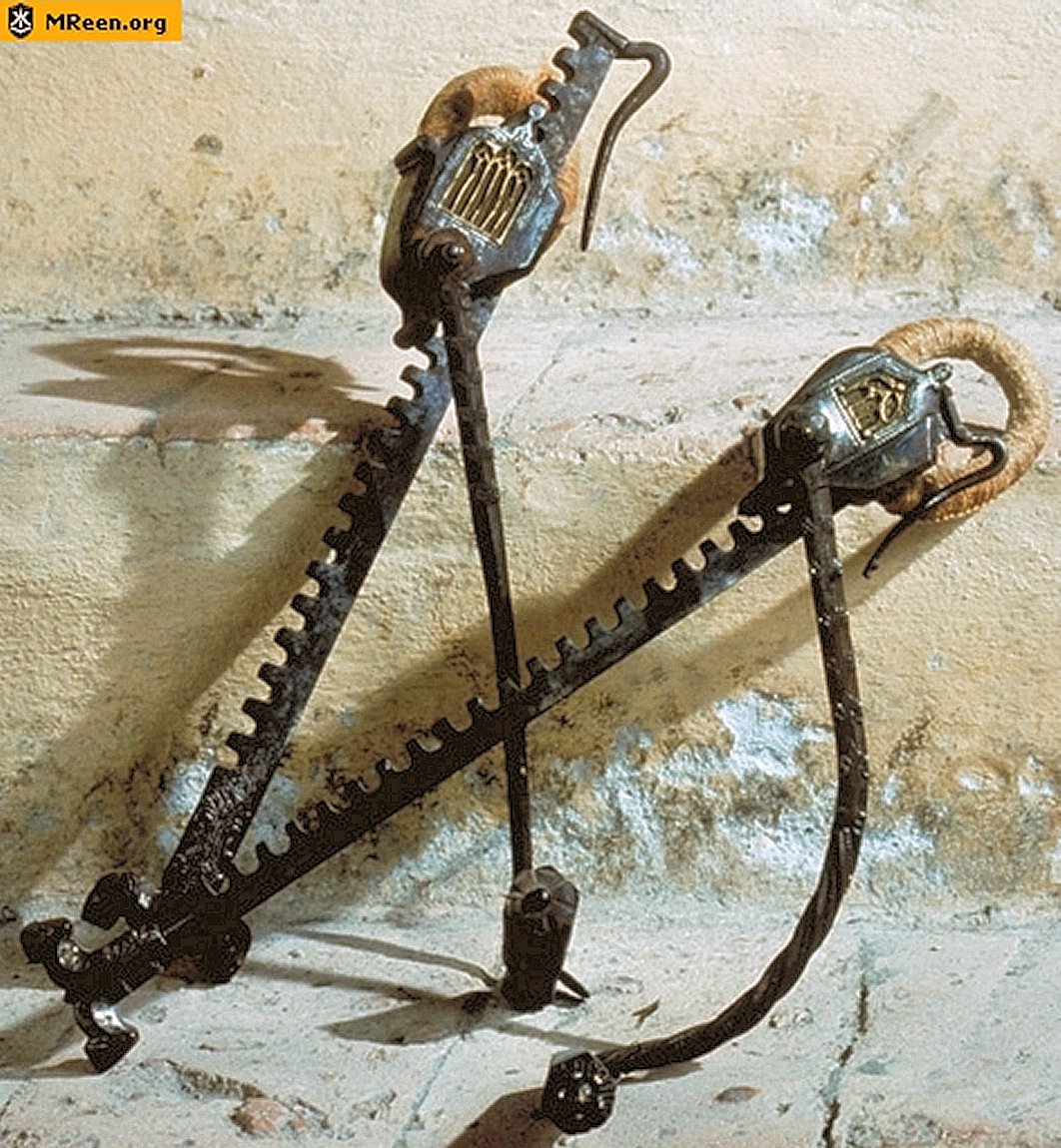

Two fine Gothic cranequins, mid- to late 15th c., in the famous Churburg collection, Schluderns, South Tyrol.

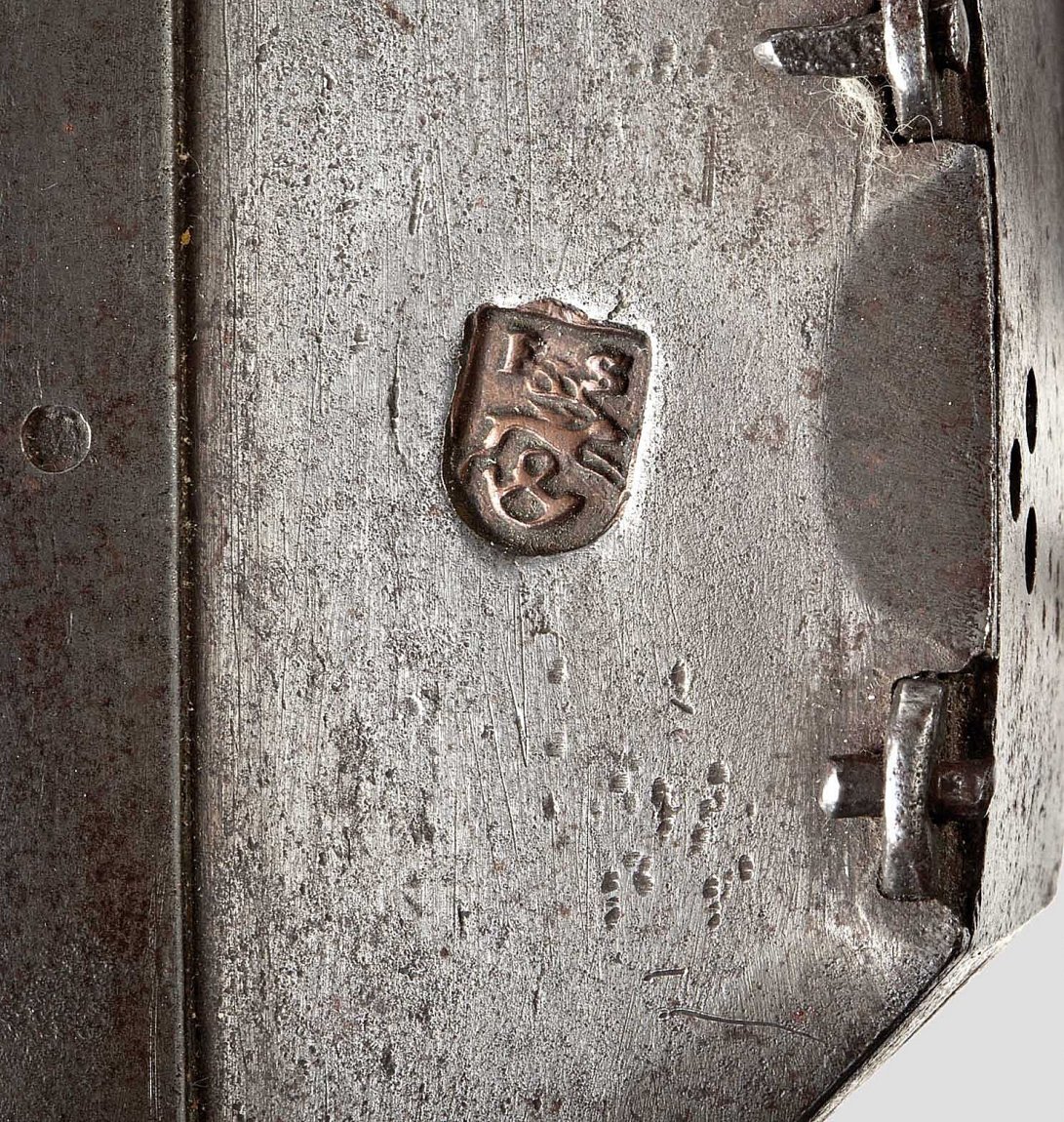

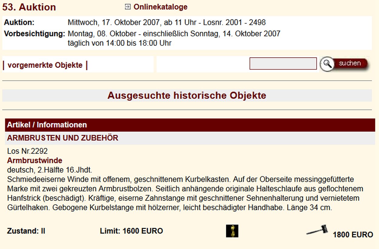

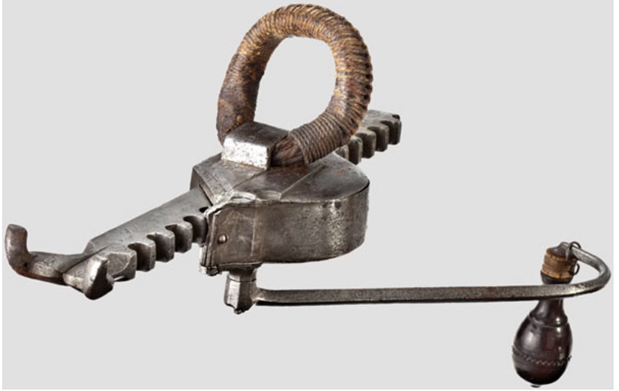

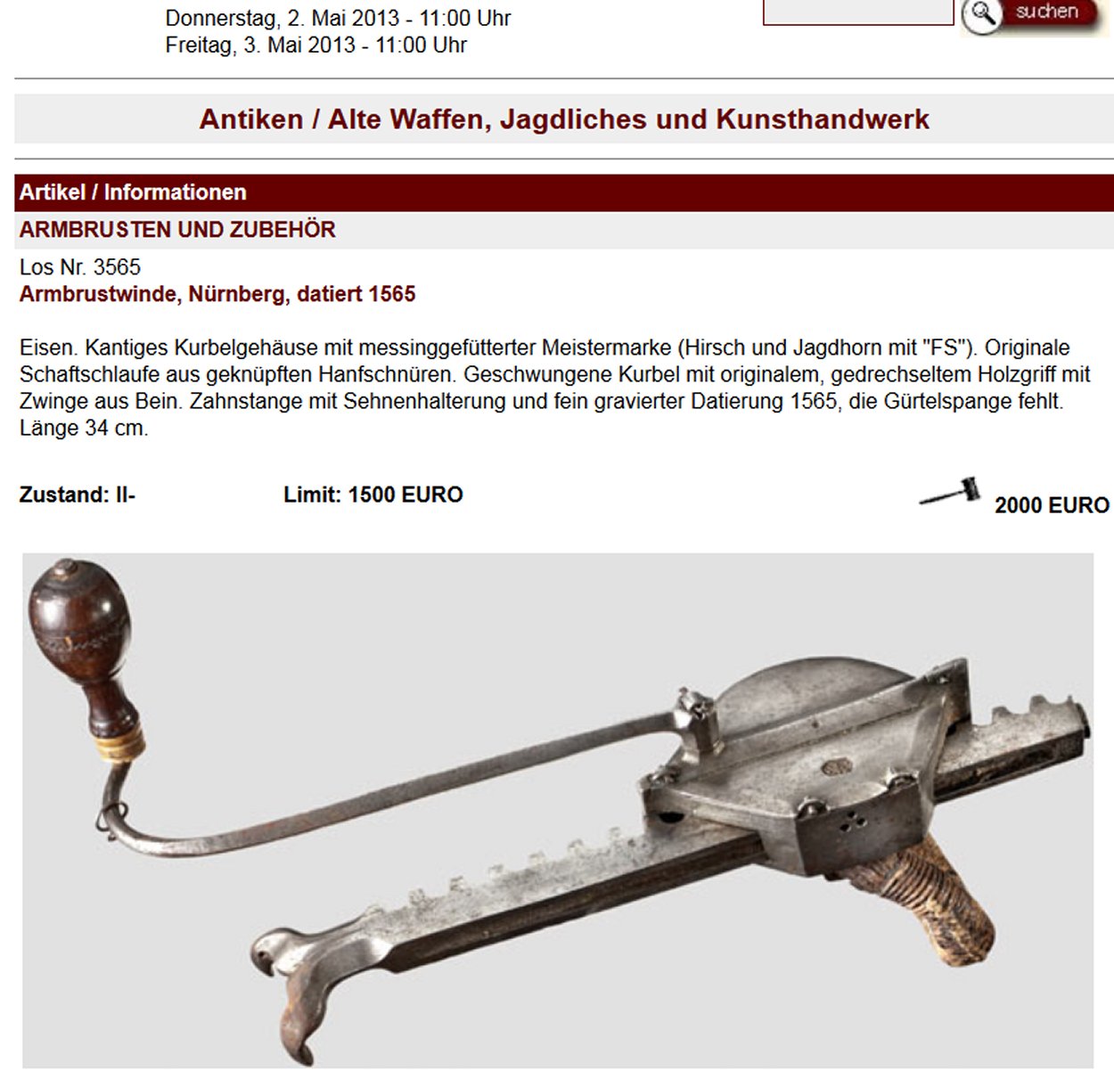

Two cranequins from German auctions at Hermann Historica, Munich.
The first Nuremberg, ca. 1540, by the 'Master of the crossed quarrels', the second dated 1565.
m

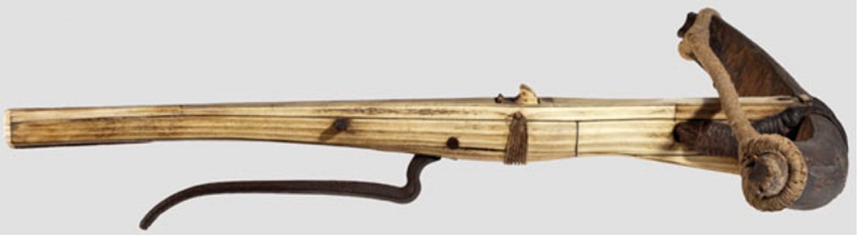

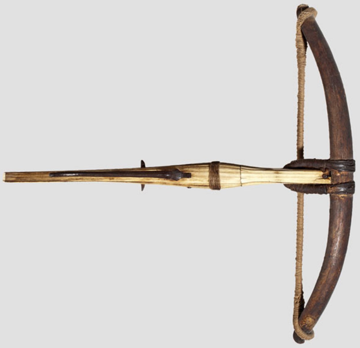

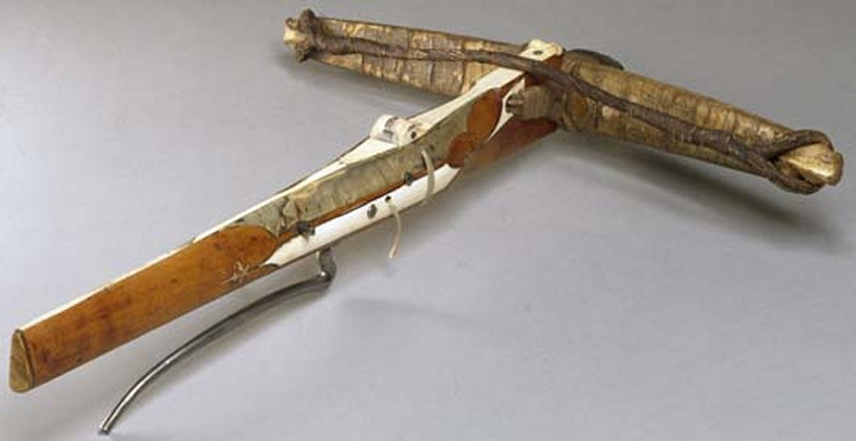

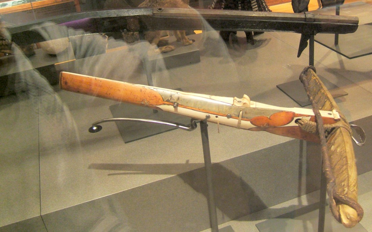

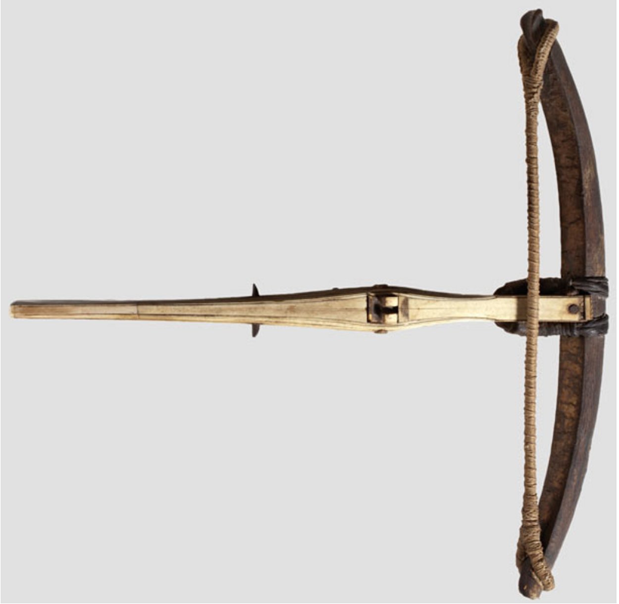

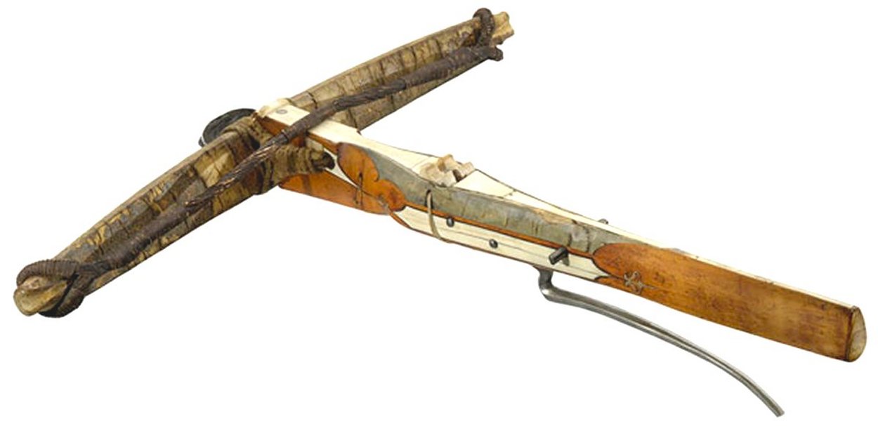

A fine Late Gothic crossbow, the tiller completely veneered in white staghorn. Sold at auction at Hermann Historica's, Munich, 2nd May 2013.
m
