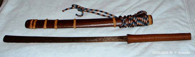

mine has a razor sharp 'spatula'. against an un-armoured opponent, it doesn't have to be pointy. northern thai/burmese like these styles.
it puts a bit more weight forward & is a bit better for slashing cuts. see also our thread on rounded tip swords in general: LINKY
