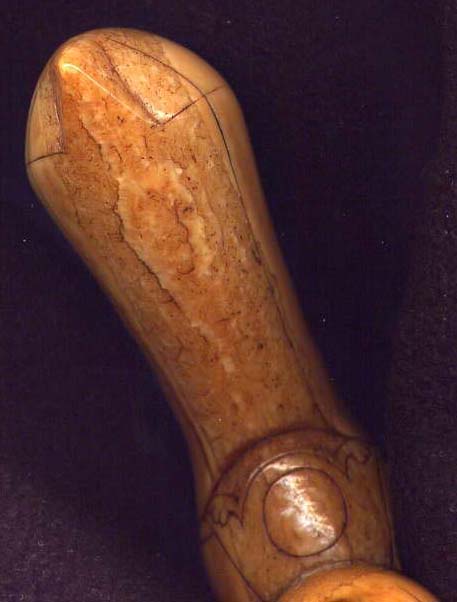

When you say 'sea ivory' which species are you exactly referring to?
The real problem over here is that people are referring to sea ivory as "gigi" (i.e tooth), hence the better understanding and futher classification of sea ivory was somewhat fall short, because of the generalization of terming that has become a common practice around...
Originally Posted by T. Koch

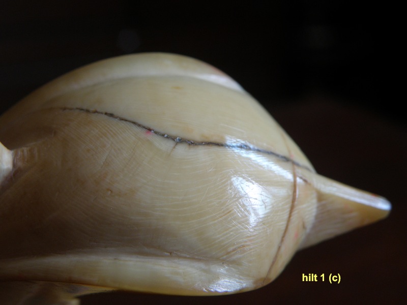

I know that 'dots in a row' in ivory, is sometimes associated with hippo tusks and their inner interstitial zone (TIZ), but the TIZ wouldn't take the direction shown in a cross section like the one above, unless your badik is very small. How long is the hilt btw?
The "dots in a row" was my ultimate indicator of a sea ivory, but again I am not so sure on rhino or hippo horns. The hilt was not big, about 5.8cm long...
From the picture above, I would still bet on blonde horn - unless you are sure that it is definitely tooth. In that case, it would be interesting to see a macro straight on the very end, as well as one perpendicular to the length of the hilt.
Blonde horn? You mean, hippo?

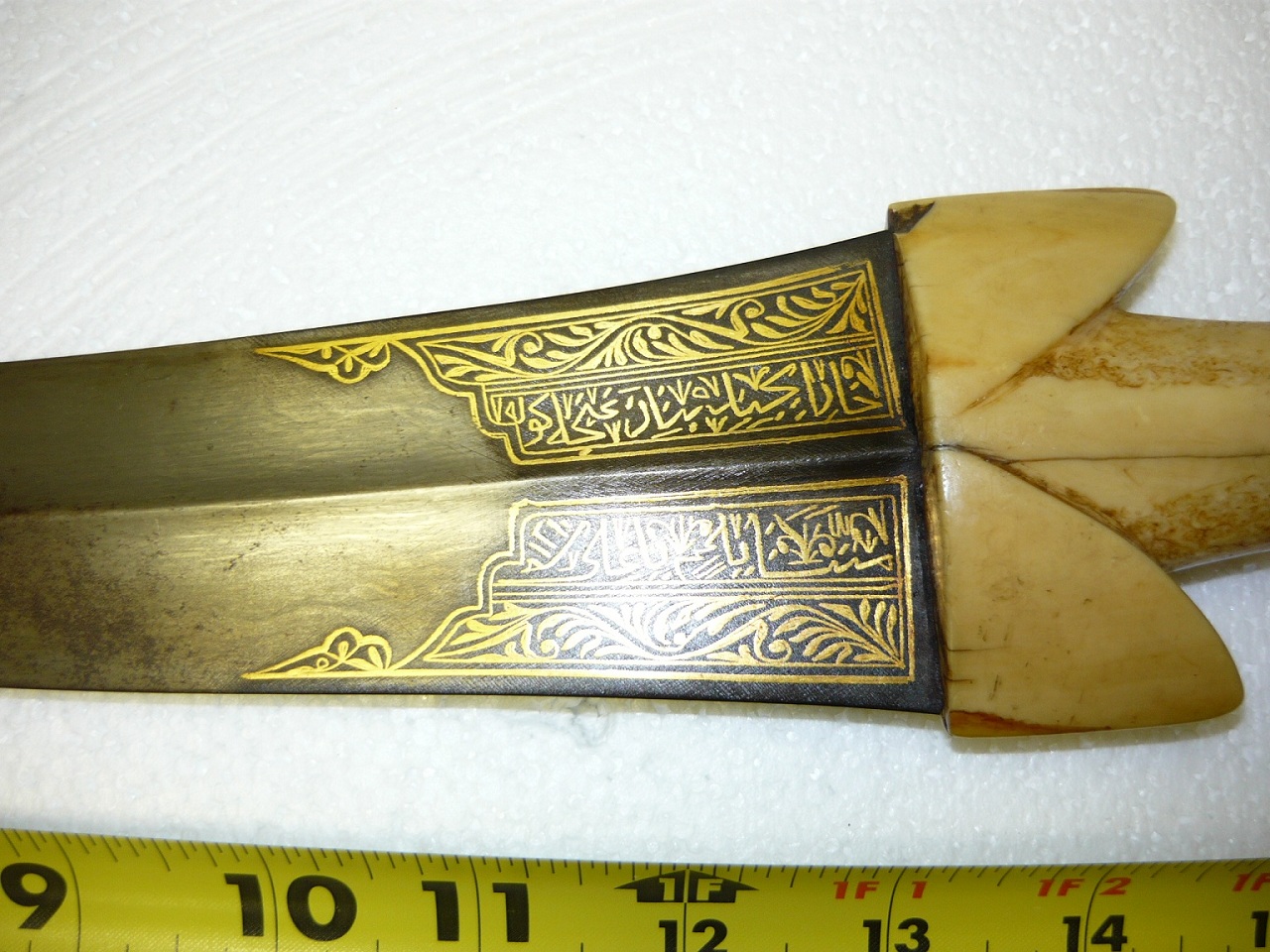

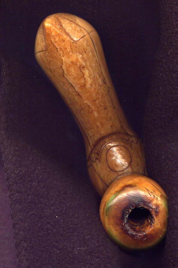

Attached were a series of pictures, where I believe would assist you in the further effort of it's ID. In the first pix I've highlighted the dots on the bottom and on the surface of the hilt, for easier identification.

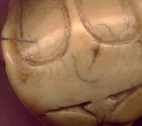

Damn, that's some strange stuff.... With the last photo, I must admit, that I am not able to ID it as being anything other than hippopotamus ivory. Maybe we are indeed looking at the very core of the tusk in cross section, when viewing your hilt from the pommel end. The layers and angle of the line of spots certainly fits...
That would mean that the hollow canal along the tusk core has been completely crushed by the dentine and now totally reduced to these little pin-prick impurities (spots in a row) we see. That's something I've never seen before, but then again freak incidents happen all the time in nature. -perhaps it happens once a hippo grows old enough, as the dentine layers keep packing on...?
Would be interesting to see a series of tusk cross sections lined up according to the age of the source animal.
Mosha, don't worry about what people call it. I deal with it on a regular basis too. Common people rarely know the exact scientific names of what they have. Unfortunately popular names are the scourge of useful investigation.
In regards to your question. Horn is for instance what cattle, antilopes and rhinoceros grow. They are composed of keratin - the same materials that make up hair, claws and nails.
Teeth are made up of dentine and enamel. The males (in most cases) of certain species of animals grow a particular set of large teeth made for combat - actual or ritual/demonstration - to determine their position in the group and predator deterrence (same thing as the above animals use their horn for). For example Elephant, narwhal and hippo. These particular teeth we call tusks.
Getting back to your badik. Do you know if the hilt has attained this color by handling over time (patina) or has it been dyed in tea or another substance? Tea dying of ivory is something I would really like to learn more about. I myself, am a sucker for the warmer, more amber colors of ivory. - your's above is delicious!
Thanks for the extra pics, they were very illuminating!

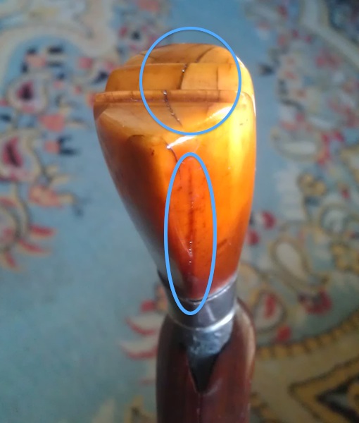

Agree with you, the colour is beautiful. Maybe is was dyed originally but I think it's also with a very good age.
Hi Thor. Is the TIZ only appears on hippo tusk? If it was unique to hippo ivory alone, I think that was one easy determinant, providing that the hilt exposed good side of the cross-sectional plane. On kerises hilt, that could be tricky...

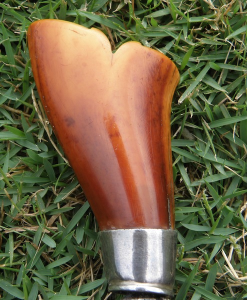

Well I've heard about this practice too. But did it not that tea dyeing would usually turns up with a straight brownish hue on any surface the dipping takes place? Or if the whole hilt was totally submerged, you will get an even dyed tone, all over the hilt?
I think the badik hilt in question here has turned brownish / golden on the area where the finger or palm would be placed. Noted the uneven slight yellowish that appears on some spot, vertically.
I has one keris hilt with a suspected tea-dyeing treatment, where a straight line of golden tone was present, as if the hilt was partially submerged, heads up. Will post the pix later.

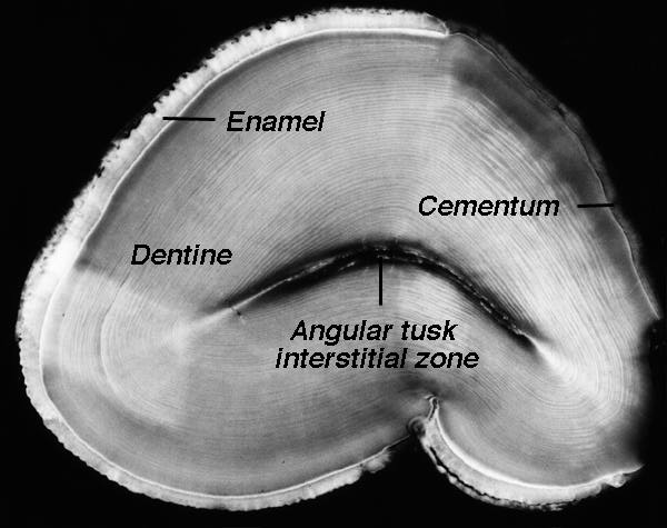

Hi Mosha! Here it is the combination of the visible laminar build-up of dentine in combination with the dots in an angled row. These two combinations lead me to believe that we are dealing with hippo ivory. I will never give a statement in certainty about these things, unless I have the piece in hand. I generally advise anybody being cautious when performing an identification and never to do it based on a sole character trait alone. I've personally seen other ivory species which show either similar dots or similar laminations. With the two characters being present here together, i.e. the laminations and the dots, my belief is strong that it is indeed hippo ivory.
I asked a colleague today btw, if he knew whether hippo tusks grow continually through the life of the animal and even though he wasn't sure, he pointed out a supporting fact that I hadn't considered: When the hippopotamus closes it mouth, the apical surface of the tusks in the lower jaw grind against those of the tusks in the upper jaw, perpetually wearing down the tusks from the distal end. This taken into consideration, it would make highly sense for the tusks to keep on growing and renewing throughout the life of the animal.

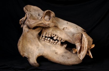

I found a picture of a hippo skull where you can maybe get an idea of the tusks grinding against eachother:

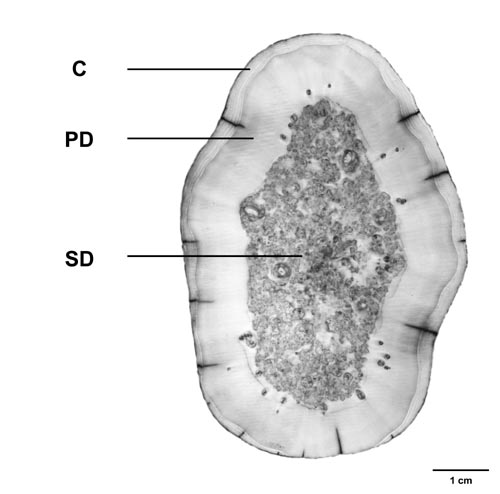

Here is the standard reference picture for a hippo tusk in cross section. Normally you would see a straight line of dots appearing in an ivory piece that has been cut from lengthwise down along the left and right borders of the TIZ.
If hippo tusks indeed grow throughout the life of the animal, my guess is that your piece came from an old hippo where the continuous addition of the lamellar dentine layers over time has completely "crushed" the TIZ and reduced it to the series of dots we see from the pommel end. Notice how the angle of dots in your hilt approximately fits with the shape of the TIZ? The picture also clearly shows the laminations.
It could also just be a freak - a deviation from the norm, where an animal has been born without a prominent TIZ. I don't know - but now I'm certainly dead curious to find out!

...Normally you would see a straight line of dots appearing in an ivory piece that has been cut from lengthwise down along the left and right borders of the TIZ.

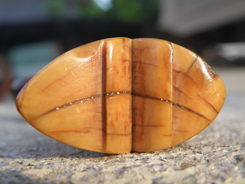

Well Thor I think that when you compared the TIZ pix with the badik's hilt, definitely you've got it right.
However some of my kerises hilts were also producing the similar tiny dots over the TIz. Then would it be a hippo tusks as well? Generally it was touted as "sea ivory" over here, and the main indicator is the tiny dots along the TIZ, if that was ever the TIZ.

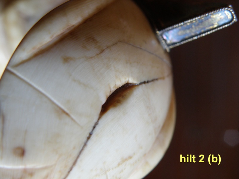

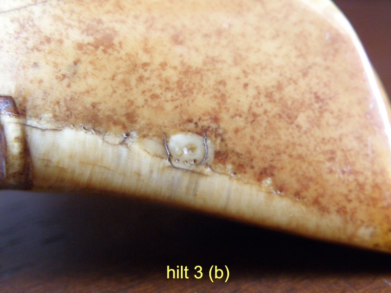

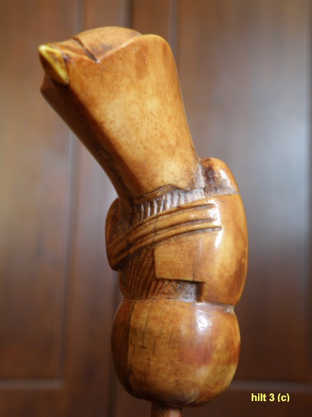

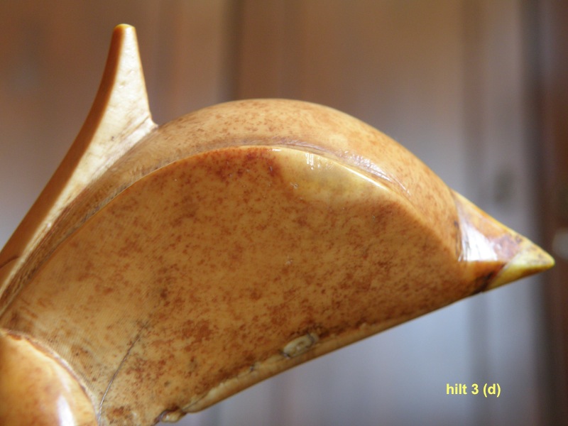

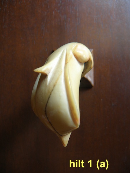

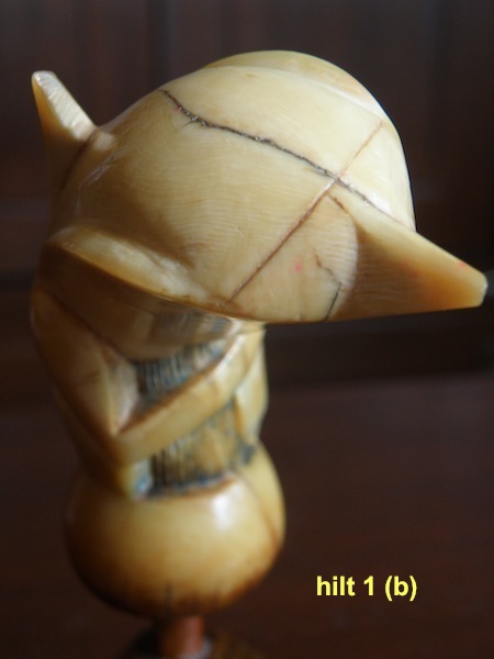

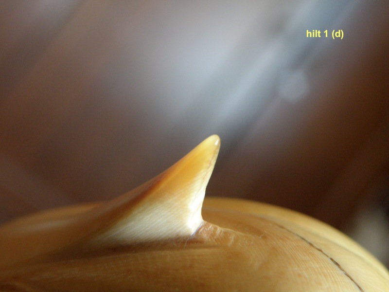

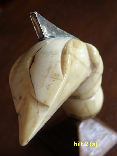

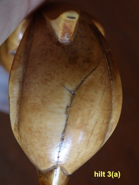

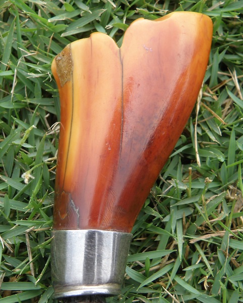

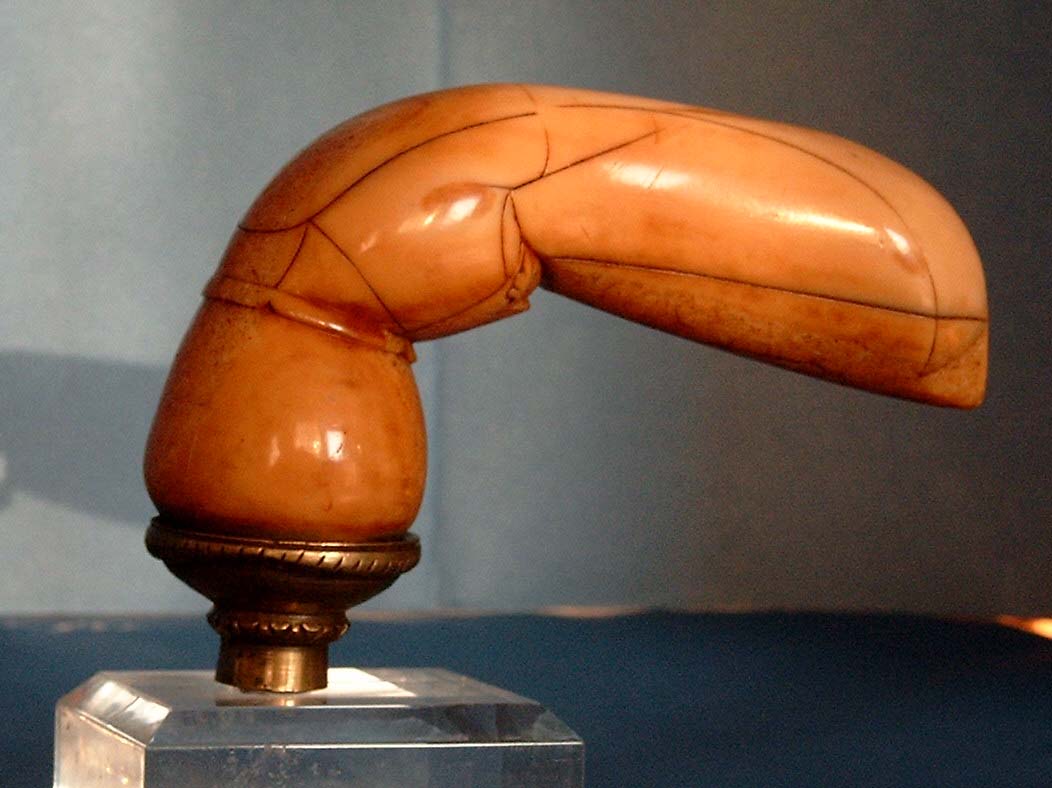

I'm sorry. The pix attachment seems to get haywire a little bit but I've already arrange it in order during the posting process...
It is basically three hilts, with hilt # (b) supposedly closed up on the tiny dots on the TIZ...
Moshah is offline   Reply With Quote

Wow, thanks for the extra pictures! My estimate in all three cases is hippopotamus - again due to the presence of both these concentric laminations as well as the angular dots. - In no. 2 of the interstitial cavity is even visible (still there?) - cool! The hilts are very beautiful - if you ever think of selling no. 1 - let me know.

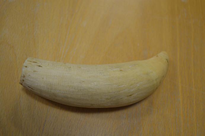

Sperm whale (Physeter macrocephalus) teeth don't have a central cavity like a TIZ but do have concentric laminations. These are formed tighter together than those of hippo however, and the ivory itself is very hard and dense. I enclose a couple of pictures I've taken from the collection of Copenhagen Zoological Museum. The first is of an average sperm whale tooth: about 12-15 cm long and 100 - 150 g. Notice that the overall shape would fit quite well with some keris hilts, although I've never had a confirmed specimen in hand myself. As I recently showed in a thread on Sikin panjang the teeth can grow much bigger: http://www.vikingsword.com/vb/showpo...0&postcount=15
The second picture is of a sperm whale tooth split longitudinally and then treated with acid, so as to better display the laminations. Notice how little space the pulp cavity actually takes up. This is where the nerves and vascular system connects with the tooth.
Note also, that many other whales have teeth. Most of them are however, in spite of the whales themselves growing rather large, only a couple of cm., but there are other species like the killer whale Orcinus orca, which also produce teeth of a significant size.

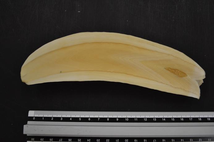

I completely share your skepticism regarding the use of hippopotamus ivory in SEA, especially considering how relatively common they seem to be among ivory hilts. I have no idea... I am just relating to the morphology of the ivory itself and given the characteristics displayed, there are just not really any local options. I too find it absolutely mind-boggling that this trade wouldn't have been described in the literature somewhere.

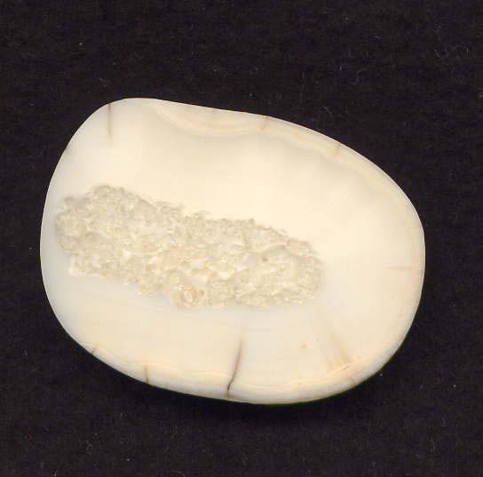

Regarding walrus tusk as a possible source, it is true when kai speaks about the characteristics of the inner core composed of osteodentine. It looks a bit like boiled rice. However, walrus tusks on old bulls grow really large and the diameter huge. -I've seen ones where the thickness of the layers surrounding the core was easily 5 - 7 cm. Also, the core does not extend to the tip. If walrus tusk is carved in such a way that the piece contains no core, we lose this identifying character.
Please see attachment for the standard walrus tusk cross-section photo.
The layers around the core consists mainly of dentine and a - sometimes rather thick - surrounding layer of cementum. Because of the way they are deposited, these can show a laminar structure in cross section, similar to that of the hippo. With age, these layers will tend to crack lengthwise down the tusk and radially in cross-section (as seen in the photo) I've sometimes, although on very few occasions, seen these cracks overgrow again and form small inclusions along them giving the appearance of "dots in a row". However, because of the structure of the walrus tusk, these dots will lie on a straight line as opposed to in an angle and they will appear perpendicular to the concentric laminations, as opposed to wedged in between them, as is apparent in Mosha's hilts above.
I am not disregarding walrus as a possible source for keris hilts - compared to most of you guys I've seen very few hilts in my life. I just don't believe it is the source material in the examples presented above.

Walrus tusks have a prominent inner core that exhibits a distinct mottled pattern upon staining or developing patina.
Agree with Kai and Thor, to my opinion the shown keris hilts are from hippo ivory.

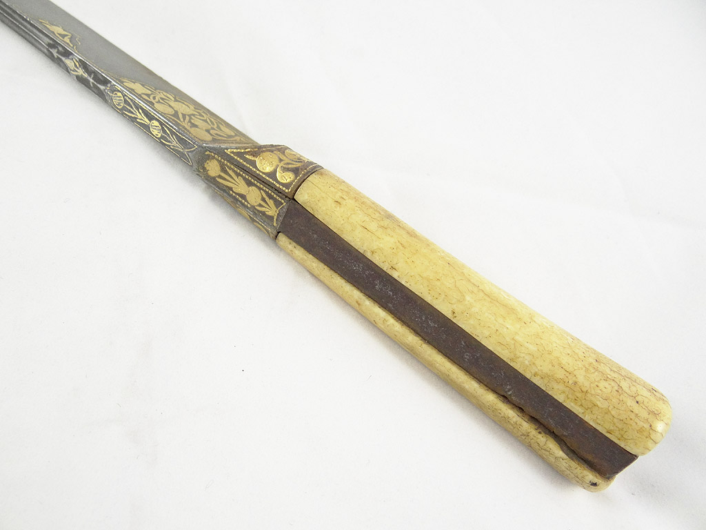

Walrus ivory is like Kai described, here three pictures from walrus ivory taken from other threads. I have seen only very few keris hilts worked from walrus ivory.

Dear Thor,
Yup the cavity is still there in hilt # 2. Previously I have tried to foolishly drop the superglue in it, just for precaution, until it pools in the cavity and dried. I think I've resolves the issue but after a week the residues gone and the cavity is back!
Enclosed were extra pix for hilt # 1. The edges of this particular hilt tend to be quite transparent a bit (see the fin of the pekaka on hilt 1 (d) example & the nose on hilt 1 (a) I've posted beforehand.), unlike any other gigi hilt I have had. Do you have any theory for that?
Thanks for the pix, Detlef.
BTW, do you have the suspected walrus ivory keris hilt's pix? Did it bear resemblances as the material of those hilts you've just posted?
Thanks.
Moshah

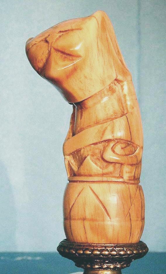

Originally Posted by kai
Hello Moshah,
No, a hulu pekaka from dugong is just not possible - only small hilts could be made from it and I'd really love to see a well-documented example!
Have a look at this recent thread and another one discussing dugong.
Thanks for the link, Kai.
BTW attached were extra pix of hilt # 3, the full built and close up.
I don't know what happen but it looks like he's having a bad measles there
- something I haven't see on my other gigi hilts. Perhaps a different kind of tusk / ivory, as I don't think this measle-thingy can be called patinated, isn't it?
Moshah
Old 26th February 2013, 03:58 PM   #52
T. Koch
T. Koch's Avatar
Join Date: Jul 2012
Location: Mother North
Posts: 189
Hi Mosha,
I'm not sure, but would think it could be because the nose is carved from the outer layer of cementum It also makes sense as it seems to be the most extreme part of the little guy. The transparency of the nose is what makes him so cute!
The "mis"-colored one in the bottom pic is the same material as the others, IMO. Sometimes ivory just ages more beautifully than in other cases. It's the same if you look at the walrus hilts above - some become golden and lustrous with time while others become grey and 'dirty' looking. I guess it depends on what kind of life the material has had and which kind of environment it's been stored in.
For this reason I in some cases personally find pieces of antler or bone more attractive than some pieces of ivory. I really love a warm and golden color and the aesthetic expression is more important to me in a piece, than the type of material.
I've found a new pekaka hilt in walrus ivory for you, but the photo is from a dealers page, so I'll send you the link in a pm.
We're not allowed to publically post pictures of stuff for sale, even if we don't reveal the source of the photo ...right?
Take care, - Thor
T. Koch is offline   Reply With Quote
Thanks.
Moshah
I think a friend of mine has a bugis hilt made from walrus ivory, I will look if he can send me a picture from this hilt. And yes, it look very similar to the posted hilts from this material.

Old 26th February 2013, 10:33 PM   #57
Thanks for the extra pics, Moshah!
I'd love to examine #3 in person: I also believe it is hippo but I can't ascertain from the pics wether the mottled appearance is from uneven staining/corrosion/patina or due to some other cause.
From the pics, the tip of the beak almost looks like a repair while the rest of the TIZ is obviously fine despite the unusual choice of placing it that close to the edge of the piece - looks like the carver was hoping to avoid including it but ran out of material...
Old 28th February 2013, 12:51 PM   #58
Moshah
Moshah's Avatar
Join Date: Oct 2009
Posts: 171
You're most welcome when you are around here! Surely we can discuss more about these hilts and many other things...
That was a spot-on; it is indeed a repair. The tip was an ivory piece glued to the beak.
Since this material was dearly prized back then, I believe the carver's intention was to make the most from the chunk of material he got. Rightfully they were skilled artisan as well, as they wouldn't rush the process for $$$, unlike these days.
Moshah

Old 28th February 2013, 07:06 PM   #59
Posts: 9,650
Thanks.
Moshah
Here the pictures of the Bugis hilt as well a free cross-section through a walrus tooth.

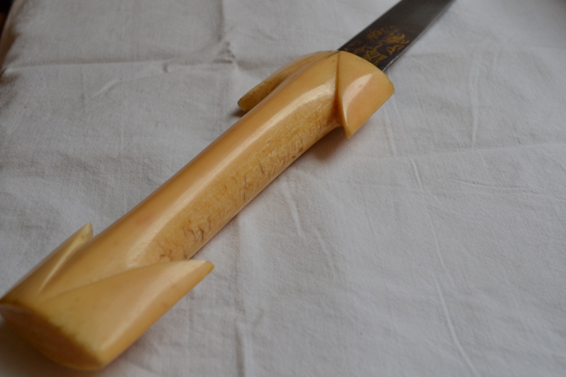

Old 28th February 2013, 07:18 PM   #60
Posts: 9,650
I think I know one example from this material, a small jawa deman from Sumatra. Will look if i can manage to post a picture.
And here the picture from the dugong ivory hilt. Carved from a tusk those who can reach a length from 20 until 25 cm. The ivory look similar like elephant ivory but have a concentric structure and by this you can recognize dugong ivory.
