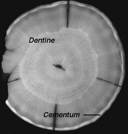

Here is the standard reference picture for a hippo tusk in cross section. Normally you would see a straight line of dots appearing in an ivory piece that has been cut from lengthwise down along the left and right borders of the TIZ.
If hippo tusks indeed grow throughout the life of the animal, my guess is that your piece came from an old hippo where the continuous addition of the lamellar dentine layers over time has completely "crushed" the TIZ and reduced it to the series of dots we see from the pommel end. Notice how the angle of dots in your hilt approximately fits with the shape of the TIZ? The picture also clearly shows the laminations.
It could also just be a freak - a deviation from the norm, where an animal has been born without a prominent TIZ. I don't know - but now I'm certainly dead curious to find out!

Please see attachment for the standard walrus tusk cross-section photo.
The layers around the core consists mainly of dentine and a - sometimes rather thick - surrounding layer of cementum. Because of the way they are deposited, these can show a laminar structure in cross section, similar to that of the hippo. With age, these layers will tend to crack lengthwise down the tusk and radially in cross-section (as seen in the photo) I've sometimes, although on very few occasions, seen these cracks overgrow again and form small inclusions along them giving the appearance of "dots in a row". However, because of the structure of the walrus tusk, these dots will lie on a straight line as opposed to in an angle and they will appear perpendicular to the concentric laminations, as opposed to wedged in between them, as is apparent in Mosha's hilts above.
I am not disregarding walrus as a possible source for keris hilts - compared to most of you guys I've seen very few hilts in my life. I just don't believe it is the source material in the examples presented above.

Walrus tusks have a prominent inner core that exhibits a distinct mottled pattern upon staining or developing patina.
Agree with Kai and Thor, to my opinion the shown keris hilts are from hippo ivory.
Walrus ivory is like Kai described, here three pictures from walrus ivory taken from other threads. I have seen only very few keris hilts worked from walrus ivory.

Here the pictures of the Bugis hilt as well a free cross-section through a walrus tooth.

And here the picture from the dugong ivory hilt. Carved from a tusk those who can reach a length from 20 until 25 cm. The ivory look similar like elephant ivory but have a concentric structure and by this you can recognize dugong ivory.
