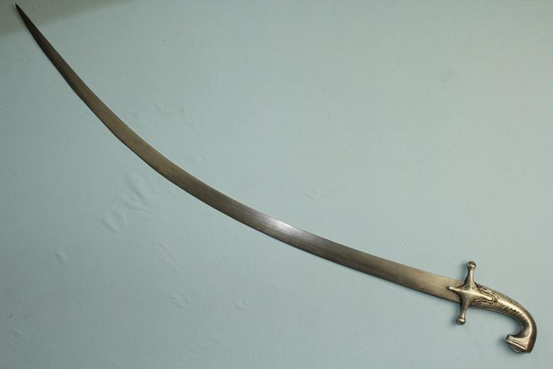

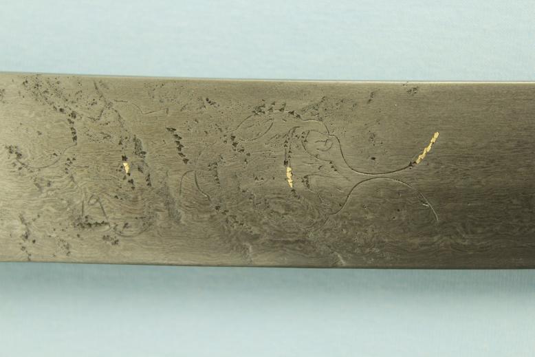

So I got this shamshir from down under (thanks Gav, excellent packaging!) I am very happy with it especially after having a closer look on the inscription (looks better then photos) and found out its Assadullah alAsfahani and the top inscription says "Bandeh Welayat Shah Abbas"

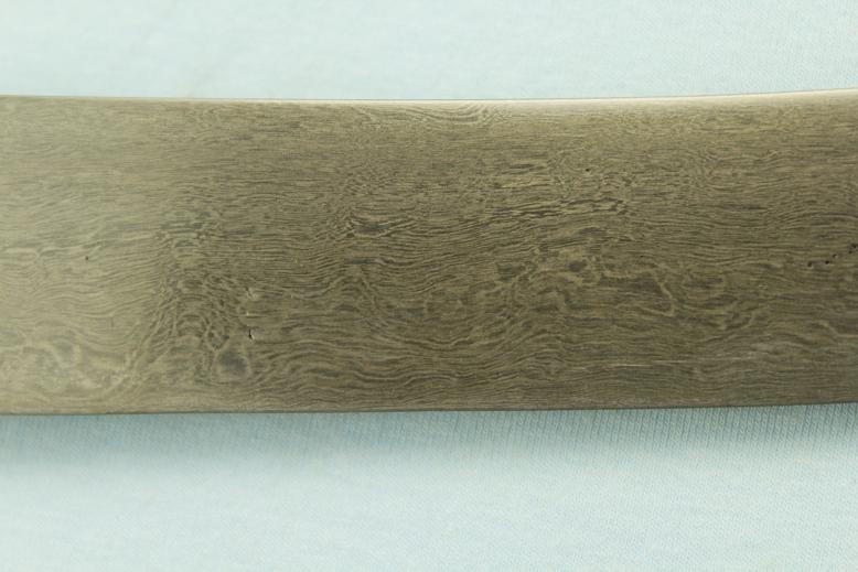

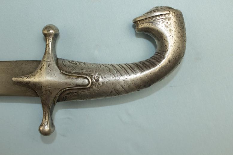

The blade is obviously Persian with a nice wootz pattern. But what about the hilt? its worn out but very comfortable. One side of the hilt has a worn-out cartouche I cannot read it so far :-(
Using Gav's photos they are way better then mine.

It's a fine sword Lotfy.
Lots of even wear from many cleanings is pleasant to the eye. The Wootz pattern is attractive.
My first thought was that the 'pistol grip' hilt was in fact Indian in Persian style... But now..... I wonder.....

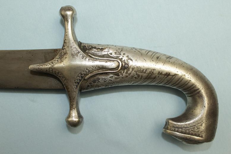

Old 27th January 2013, 08:33 PM   #3
Posts: 7,407
Nice wootz and silver hilt. Shame the cartooch is gone.

Posts: 2,928
That's a steel hilt isn't it?
Old 27th January 2013, 09:23 PM   #6
A.alnakkas
A.alnakkas's Avatar
Join Date: Nov 2010
Location: Kuwait
Posts: 1,340
I thought silver aswell
Old 27th January 2013, 09:27 PM   #7
Atlantia
Atlantia's Avatar
Join Date: Jun 2008
Location: The Sharp end
Posts: 2,928
It's silver is it?
It looks steel grey in the pictures.
I wouldn't have guessed silver. You're sure, non-magnetic?
I'm suprised to see a silver hilt pinned like a steel hilt as well.
Well silver! That's even better!
The decoration reminds me of the cap on a shamshir that I have (which is worn steel).

Hey Gene,
Tried a magnet on it, it didnt stick so its not steel. I dont mind what material the hilt is, I am more interested from where it came from! Could be the same place that produced Indo-Arabian saifs? Hyderabad? The hilt must have looked very special back in its glorious times, there is a cartouche on the quillons but cannot read it.

Hi Lotfy
Very nice! Has lots of character and you can still see a distinctive wootz pattern. The hilt is silver so at some time it must have belonged to someone of wealth .

Salaams A.alnakkas ~ How do you see the history on this item? I understand that the concept was initially Syrian (Damascus ) and the great master was taken from there to Persia and worked in their workshops(Royal) and this cartouche like many other masterstamps or engravings was repeated down the centuries as a mark of respect and or a prestige mark for a good blade. It would be interesting to see how you read the catrouche as it is all but obliterated though I see gold inlay in places. I have a picture somewhere of an intact cartouche and will dig it out later. See http://www.swordforum.com/forums/sho...hashka-or-what for a link on cartouche style.

Post some close ups of the cartouche on the quillions if possible.

Hey Gene,
Forgot to take a photo! will do soon. My guess because of the hlt decoration it is a Persian type? maybe older then the 'usual' form or a one off.
