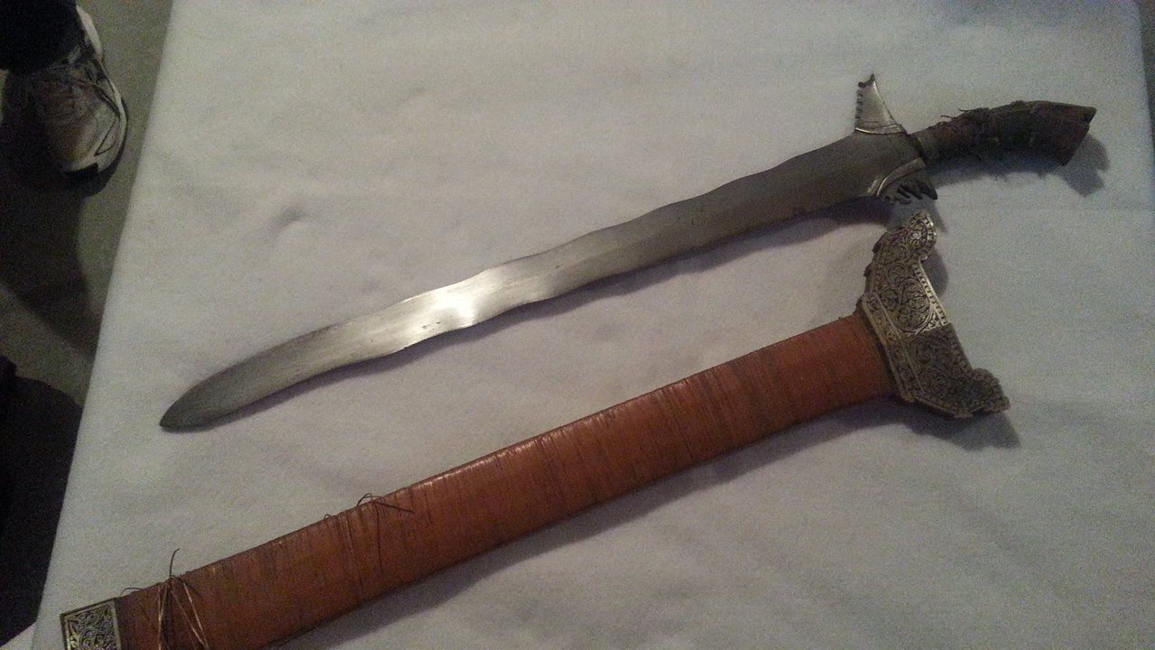

This is an attractive Moro kriss with some unusual characteristics, including the comparatively extreme curvature of the pommel. The quality of the wood is fine in both the handle and scabbard. Surprisingly the blade is rather poorly forged with many flaws and a far from perfect surface, though apparently older as the blade's ganja is separate.
The most intriguing aspect of the kriss is its carving on the scabbard and hilt, all very delicate work and filled with what I believe is lime. The carving is still largely intact, though clearly worn with age.
Above all, the eagle carved into the scabbard is most interesting, and I am curious if this is an insurrection era insigna or something later???
Battara and Spunjer...please chime in!!
Thanks in advance for any input.

What an unusual piece! I am leaning towards Maranao blade, but the bird is not what I was expecting for an American influenced piece.
The bird might be still during the American period, though I think it stands on it's own. The thing is the Moros had nothing to do with the Philippine Revolution so the connections with that movement in the north didn't truly exist. I think the bird is independent. Not unheard of since the bird motif is in Maranao work like the sarimanok and others.
Carving on the scabbard does throw me a bit. The okir looks Maranao but the outer profile of the wranga looks like later Sulu influence (perhaps Maguindanao work?).
With the hilt wrap (and everything else) I would hesitantly place this in the first quarter of the 20th century.

charles, do you think the kris is original with the scabbard? not 100% foolproof, but i tend to check if the groove/grooves line up with the asang2x (that's if everything else looks like it matches. sorta like my "just to make sure" measure).
with that said, if you look at the overall outline of the scabbard, it's exactly similar to this Sulu piece. only difference on yours is, it's not wrapped with rattan bands and it doesn't have MOP:
