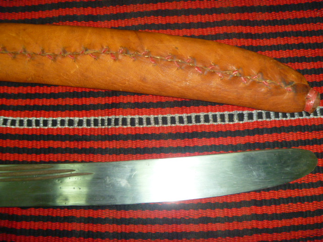

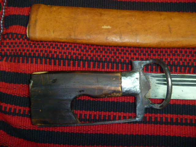

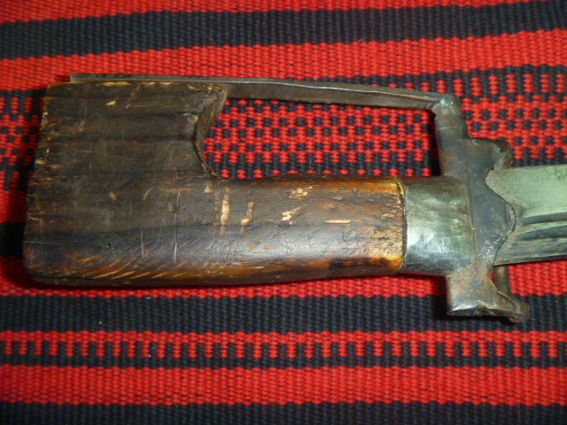

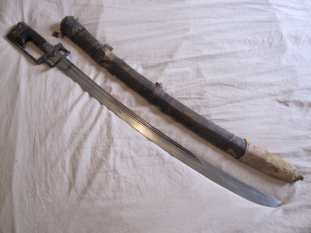

Just received this lovely old tribal Bedouin sword. European blade which no marks, and scabbard with ORIGINAL leather covering, with some very minor loss. The drag is shrunk on and is what looks to be green goat skin, with most of the hair still there. Makes a VERY sturdy drag as it is extremely hard. Reverse side of scabbard shows the lacing used to secure the leather.
The hilt is an obvious Nimcha copy, and has a very large "Zanzibari type" ring guard.
What do we think Gentlemen?

Are we 100% sure that those crude hilts with ringed crossguards are Bedouin, and not say, a Yemeni interpretation of the Zanzibari guard for example? Has someone with local knowledge been able to confirm the Bedouin attribution?

Great looking sword.
Looks like a real fighter! Love the broad wide blade.

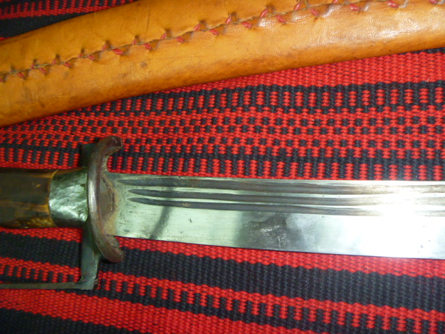

Any marks on the blade? Can we see some close-ups of the fullers?

Perhaps if these are as common as you say, you could provide some pics of them actually in the Souks.
This is NOT a tourist piece, unlike some of the Replicas/Rebuilds coming out of Oman. This piece is too old and very functional.

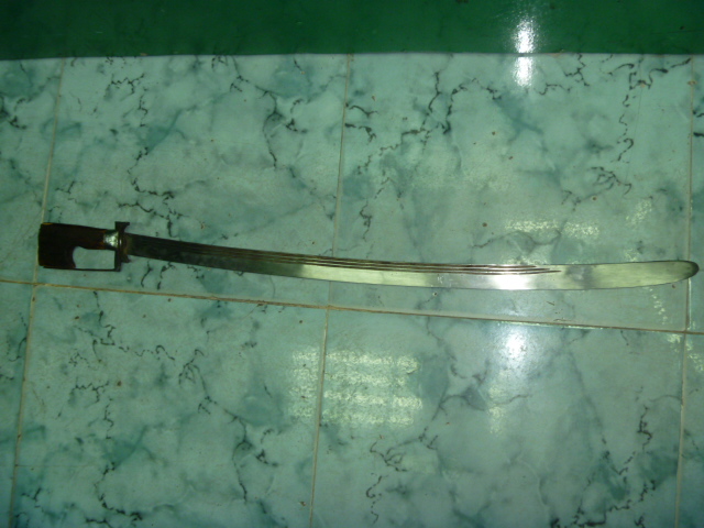

Yes of course in a few minutes... the souks are awash with them...on the other hand I wouldnt want to make a presentation which could be misconstrued as commercially biased since that could hurt the sensibilities of certain individuals... not that I would do that..of course. That is not to discourage people going to the souk... its great fun and full of weird stuff; some real, some not. I find it irresistable and reccommend it to all visitors.
Anyway these fakes...they sometimes have a good blade.. its just pot luck...
Its just what sells..The tourists scoop them up all over the place. I can show scores of them all stacked up in the souk in Mutrah and I know theres a load in Sharjah they haul in box loads from India and Yemen. I saw bundles of Tulwar in Sharjah the other day...same situation with those...they look alright but they aren't. Theres a complete back street industry been knocking these out for tourists for donkeys years in Sanaa and India etc.
Im just off to Buraimi Souk theres some over there. I know the shop owner ... I will ask him where he gets them. He is Yemeni... so I guess... Sanaa? Thats where Muscat gets their bulk of junk. There aren't (well maybe about 3 a month) any tourists in Yemen so swords are pouring out ~exporting to surrounding souks. I just rang up the Muscat boys and when they could stop laughing they said its just "bread and butter"...they sell loads of them... they are in the right price range to be carted off by tourists off cruise ships who often dont even ask if they are genuine..
I imagine they also exist in just about every souk from here to Morocco, Egypt, Yemen UAE and in India etc... serious buyers beware. The proper Nimchas are a cut above these.
I shall include later an article in the "Souks of Oman" thread on how to spot fakes.
They are souvenirs for tourists.
Photo.
( See below Yemeni sword put up for tourists to buy...typefied by a not bad looking blade(new) Picture taken by me tonight at about 9pm. 31 Dec 2012. Buraimi Souk. According to the store owner who is Yemeni ~Hilt knocked up in a backyard workshop in Sanaa, Scabbard made to order..same souk. Same applies to Mutrah and other souks in that traders in this case from the Habaabi region in Saudia adjacent Yemen and offloaded this. Apparently these weapons can be further aged by being dropped in car battery acid and then buried in the ground. The same can be done to scabbards..Looks like it came out of a similar workshop to the project sword at #1.)
Ibrahiim al Balooshi.

I understand and share your disappointment, but ultimately find it better to accept the facts. And in the case of these swords with varying blades and crude hilts imitating the hilts of seifs from Zanzibar, the facts point to a modern production, likely coming from Yemen and not intended for battle, but for the souvenir trade.
If it is of any consolation, I am the (not so) proud owner of one of these, except it is in much worse shape than yours:

Very well put Teodor, and I very much agree. I personally am not in favor of the 'fake' term despite the fact that there are certainly obvious cases that deserve that description, however sometimes it may be inadvertantly used. I think Ibrahiim does well in helping us become more aware of the variations and types of weapons offered in many of the circumstances he has experienced, and it is not easy to be explicit or candid in explaining these things without sounding harsh. Sometimes the poor standards present in commercial traffic in many examples can be frustrating, especially for those of us working to study the history of weapons forms, and that can sometimes creep into comments.
Actually these ringed hilts do appear to be Yemeni versions or at least seem believed to be from Zanzibar from around the 1960s from one I acquired and information from its source. Some earlier research notes these from Zanzibar (Cavalierre; Jacob) and Buttin considers the examples he shows (1933) as 17th-18th century, so the form seems quite old.Actually these rings were a feature seen on Italian sword forms from 16th century which influenced others as more complex guards developed.
While many of these, as noted, have substantial blades and likely were for actual use, it does seem that the more current markets are indeed producing examples more to satisfy souvenier demands (as seen by the examples Ibrahiim has posted with poorly defined fullers).
I think the Bedouin classification is pretty broadly used, and certainly could refer to any of the tribal groups over most of the Peninsula and other areas.
I have always felt that many of these weapons were intended for actual tribal wear/use but with the knowledge that they would be sold as required to tourists or others. Some with clearly inadequate blades would be the exception.

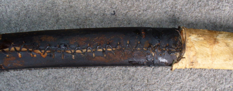

Thanks Jim. I agree that the goatskin is unlikely to have been used in tourist pieces. The entire scabbard here is definitely OLD and not of modern making. The leather is very thin and brittle, and the goat skin is uncured (green) and shrunk on. It is VERY hard. I am prepared to accept that the hilt is likely more recent, but the blade could be old or more recent....hard to be sure but of good quality either way. There are no marks.
As far as this piece being a "user", the weight is "blade down" when held in the hand, and balance appears very good....not what I would have expected in a tourist piece.
Stu

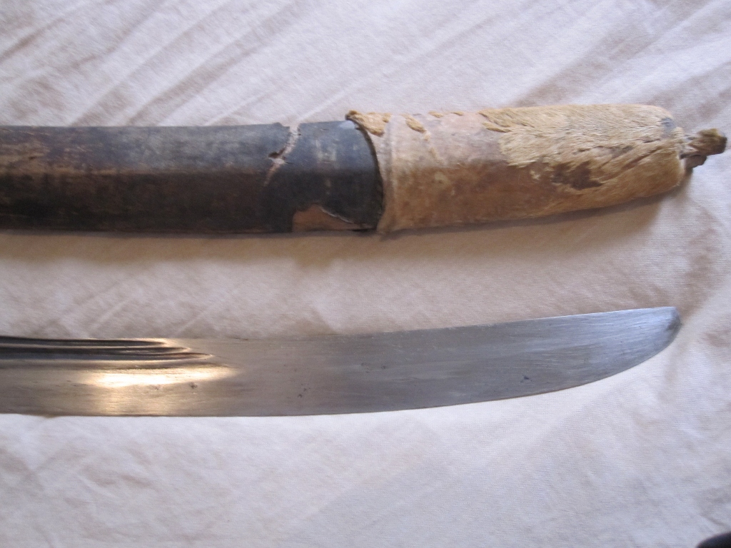

Stu,
What's the blade like on yours? Is it sharp? What's the steel like?
The blade on Ibrahiims example looks completely flat with simple fullers, almost like a long machete blade.
Now that's not to say that the machete isn't a formidable weapon! Hell, it was probobly the most widely used 'sword' in Africa in the 20thC!
Although they are clearly the same type, Ibrahiims looks new and yours looks to have some age.
I have to say that as a tourist souvenir these would seem on the face of it to be somewhat impractical.
Often an item made to attract the eye of the traveller is 'pretty' on the outside with a blade that ranges from 'just usable' to completely unusable and purely decorative.
Your sword seems to flip this trend.
I can't see these being popular with todays travellers.

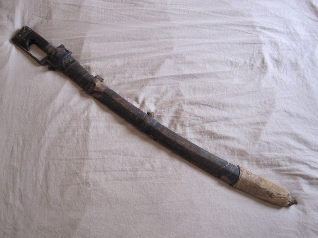

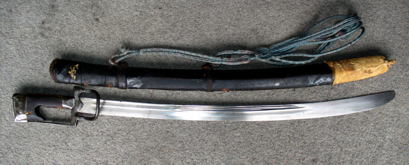

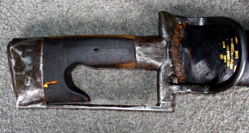

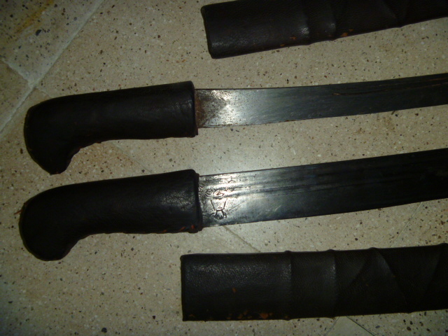

aaaand thats wrong :-) the saif is well used by bedouin communities (well not as much as spears..) but they are there and there are particular styles but one thing noticed is that they rarely make any blades and most of the fittings are actually done in cities. This has to do with the bedouin tradition and mentality which looks upon physical work as some sort of insult.
As for the sword with Stu. I originally owned this one and there are honest sign of wear on the fittings of the blade. Things that are very difficult (and pointless to make) to do so it doesnt seem right that these were made to sell to tourists. The blade is nice, thick and I remember it was sharpened. The blade was thicker then any of my wootz shamshirs and was alittle less thick then a European blade on a nimcha (which I sold along with this one) so its a serious blade and the mounts were holding strong on it. The wood of the scabbard had signs of wear near the throat so is the leather there. as you can see, the bronze (?) lines on the top of the scabbard have losses that are done due to loss with time I doubt people selling to tourist will have so much interest in details or a need to actually do such damage.
Stuff made for tourists generally contain lots of 'flash' and go for the cheapest and quickest material available and rarely have signs of wear. Keep in mind that the said Yemenis who supposedly produce these are also producing the jambiyas we see in the tourist market, how many do you see which are deliberately made to look older? rarely if ever done purposefully.
Ibrahim is correct on one thing which I ignored as a variation before, while I find some of these with the one similar to Stu's I also find ones with slim blades and scabbards that look very new. One of the interesting things about those is that they are often precieved as ugly and rarely ever sell to anyone so am not sure how they classify as tourist items.

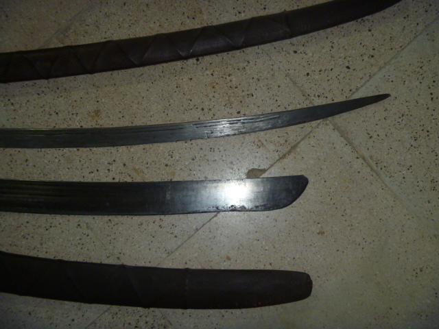

included are photos of the saif pre restoration.

Pictures show two blades, the wider with a very meaty feel, European, inscribed at the throat with the sword in tunic arm/hand and the other probably local Arabian, both imported from Yemen, disassembled and remounted on falcon head Omani styles and described as Dhow swords... and given fresh Omani scabbards.
