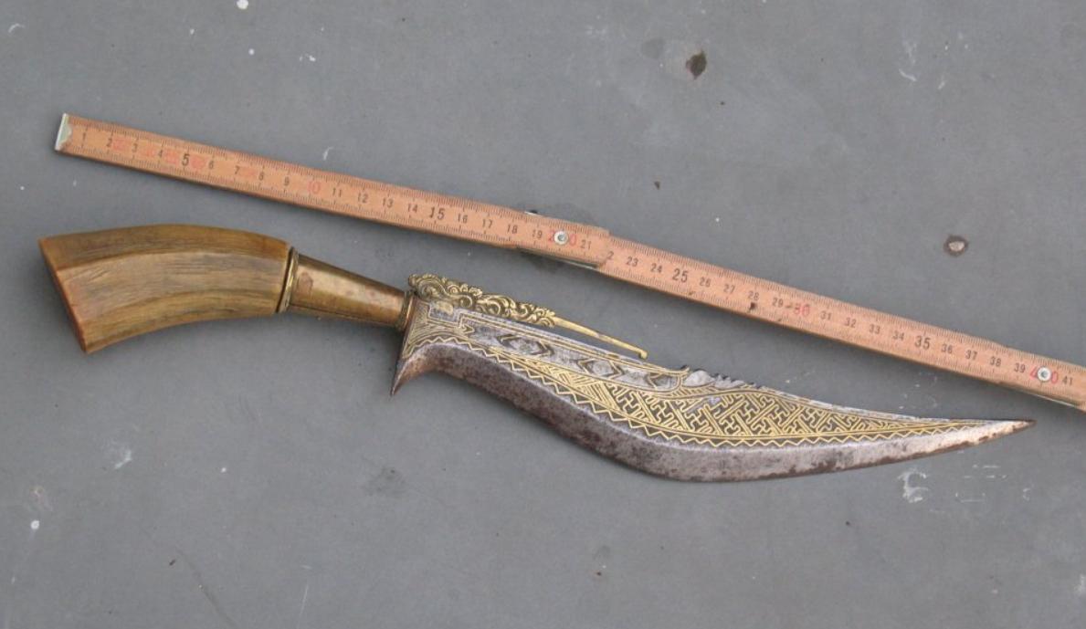

Old 25th October 2015, 10:02 PM   #46
asomotif
asomotif's Avatar
Join Date: Nov 2006
Posts: 2,238
Ps. here is my example.
