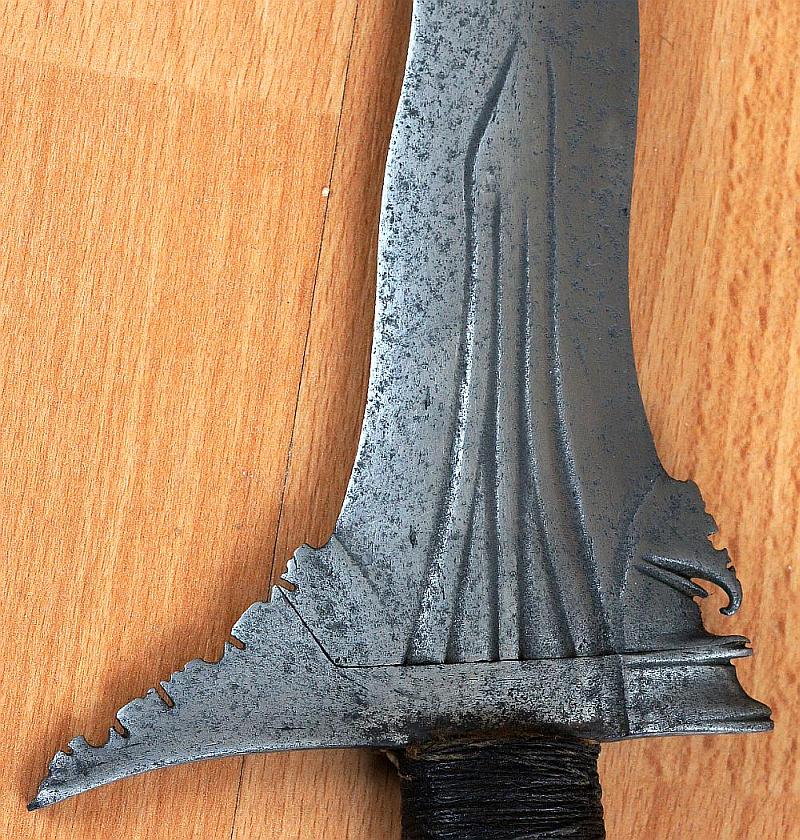

Recently i rescued this moro kris.
For my untrained eye it looks like Maguindanao and (because the ganja seem to be seperate) before 1900. The hilt is not original to the blade as i can see traces of previously attached baca-baca in the black rust on the blade. The hilt is wrapped with cotton thread and covered with a kind of natural gum. Not pretty but very functional in my opinion. As the cotton is still white, i believe the blade has never been used after it got its latest outfit. Compared to my WW2 kris the blade is very light and narrow and it seems to be far better balanced. When i got it the blade was covered with a layer of active red rust. I carefully removed most the red rust and oiled the blade but as you can see on the photos there is still red rust left in some cavities. For further cleaning i intend to take chemical measures (pineapple juice or diluted vinegar). A problem is the hilt. The options as far as i can see is to either remove the hilt or to put the sword in an upstanding tube, so that the hilt is not covered by the solution. What are your opinions on this matter? Best Regards, Thilo |

Hello Thilo,
you are also infected? I use for cleaning a standing tube (a drain pipe from plastic, sheap to get in a do-it-youself-store, together with a fitting closing) and attach in up a wire. So you are able to hang the blade inside without the liquid have contact with the handle. As cleaning liquid I use lemon acid from the supermarket (it's here in Germany cheaper than pineapple juice and do the same job). When you control it good there is no risk for the blade and it works fast and good. Take it time by time out and pick away the rust with a hard needle. Like this I have cleaned a lot of blades with very good effort. I agree with you that this isn't the original hilt and there have been two baca-baca. I can't say something to the origin but I am sure that Jose or Kai will be able to determine the derivation. Regards, Detlef |

Nice piece! I think the blade is older, say, early 1800s. I agree that it originally had 2 baka-baka and that the scabbard is Maguindanao. The blade could be, but it could also be Sulu (they did a lot of trade). The hilt, there was something around the top, perhaps a band of metal. It also may have originally had metal ferrul too, but this is now covered by the later wrap.

Thanks for the pictures and detailed instructions. I will definitely build a test-setup ( I have more than enough rusty stuff lying around). If i will use it for the moro kris i will decide later. ![]() @Battara Thanks for dating the kris. After looking at some picture it may indeed be a sulu blade. I see no evidence of former metal applications on the hilt (nails, rifts, holes, etc.) If there were any, the must have either been glued or the hilt must have been recarved after their removal. I will keep you informed about the further progess. ![]() Best Regards, Thilo |

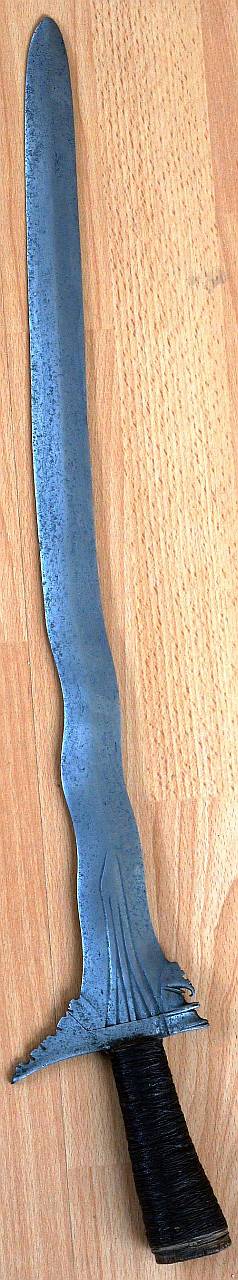

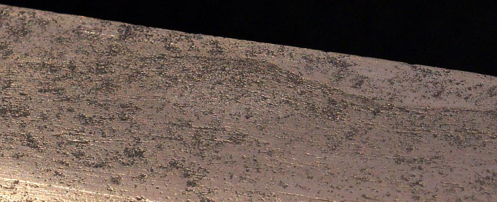

I built a test-setup large enough to contain a rusty crow-bar. As power-supply i used a computer power supply that is able to deliver 5A @12V. The counter electrode was a steel-band roughly the same length of the crow-bar and placed parallel to the crow-bar. The electrolyte used was sodium carbonate. And this is what happened: The power supply immediately switched off. I guess it detected a short. So i started pulling the setup out to see at what length of crow-bar could be cleaned with my setup (don't try this at home!). Turns out 40cm of crow-bar can be cleaned with this rather primitive setup. Putting in a high-power resistor that limits the current to 5A (2.4Ohms) would probably allow larger items at the cost of speed and isotropy. However, i didn't follow that path because i didn't manage get the hilt off and i didn't want to stain the hilt with the rather nasty electrolitic solution. So i went to the classic approach with low concentration citric acid... The results can be seen in the attached photos. The blade lamination that is not really visible on the photos shows a small edge around a uniform core. |

Good result!

are you going to give it an etch also? Although actually I do not see any 'activity' of lamination it might anyway improve the metal shine/appearance of the blade, and who knows . . . .

Hello Indianajones,
As i wrote i gave it very long etch during cleaning about a year ago. The lamination was easily visible back then... sadly i didn't make any photos. Then i scrubbed it with steel wool and oiled it. Now the lamination is barely visible with the eye and very difficult to capture in photo. But i will etch it again when i have time. Quote:
