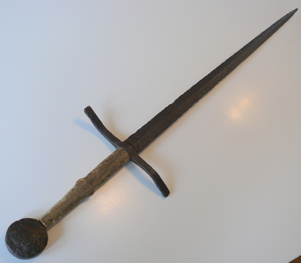

I always have found one of the nicest types of sword the long stabbing 2 hands sword, with recurved arms of the cross, Oakeshott type XVIIIb.

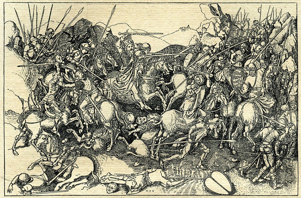

These swords were found in the literature and drawings from 1425 to about 1520, for example drawn by Albrecht Dürer and Martin Schoengrauer, see drawing Schoengrauer from 1475.
Historical examples of this type of sword are Wallace A467, nr 11829 Cluny, and the famous sword from the Bavarian National Museum, Munich (XVIIIa.5 ROMs).
Also some pictures from a true fighting sword in my collection, ex Gottlob Herbert Bidermann collection.
The sword length is 124cm, water discovery with the original handle intact.
best,

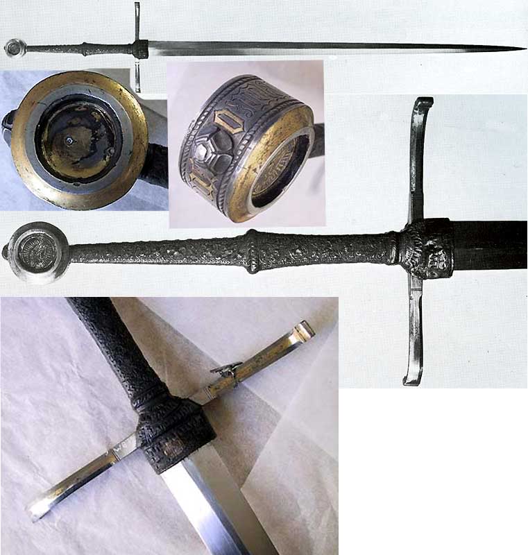

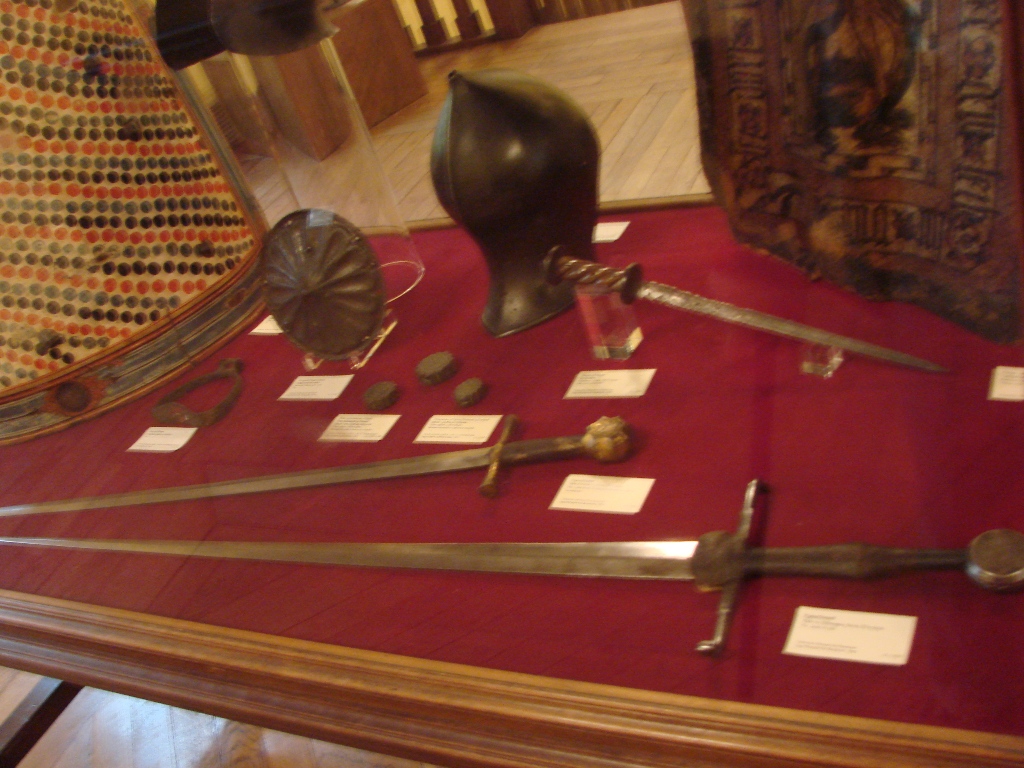

The sword in the Musee Cluny.
best
Swordfish is offline   Reply With Quote
Old 3rd June 2012, 06:43 PM   #3
Swordfish
Join Date: Oct 2010
Posts: 129

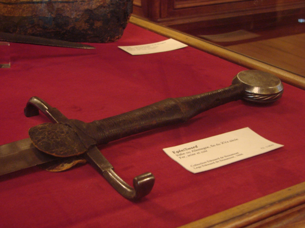

And the sword in Munich.
Best

sword of post #1
Total length cm/ blade length cm /cross cm/bladewidth@cross mm/grip mm
124/97.5/21.0/33/190
best,
Jasper

actually for a waterfind the surface of this sword is somewhat oxidized.
In General, subject that there was no contact with the organic material, swords are better preserved under water than in the soil.
some come "as new" from the water after hundreds of years, fe some of the viking swords found in the river Ouse/UK in Records of the mediëval sword/Oakeshott, and other Ouse finds which have been in contact with organic material totally excavated.
for a very good water preserved sword, see for example:
http://www.vikingsword.com/vb/showthread.php?t=9989
