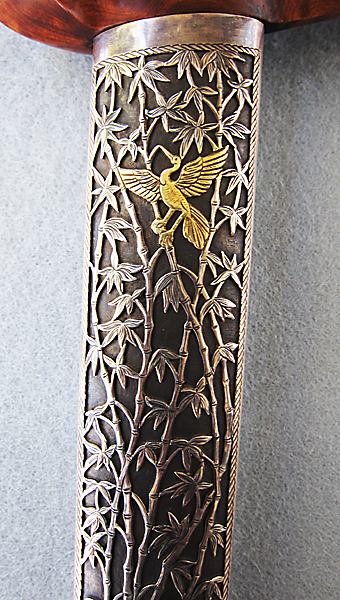

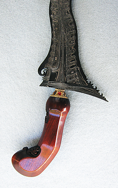

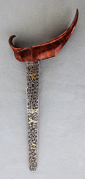

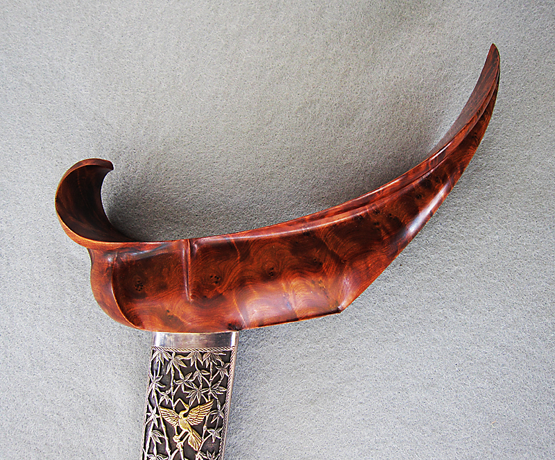

Old 29th May 2012, 11:55 PM   #40

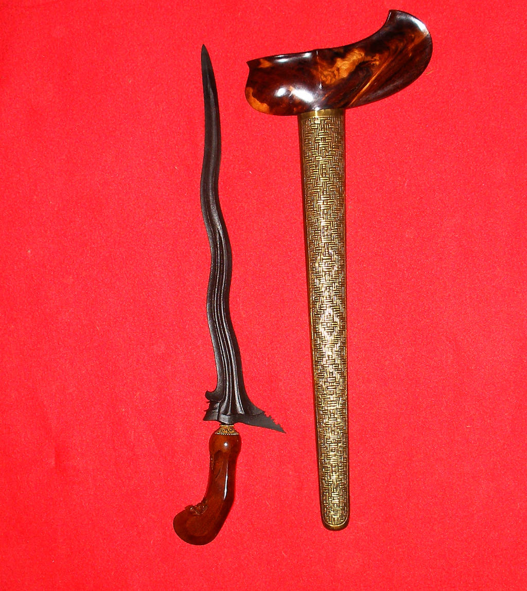

Posts: 7,228

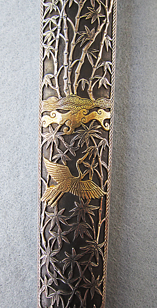

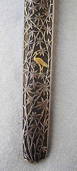

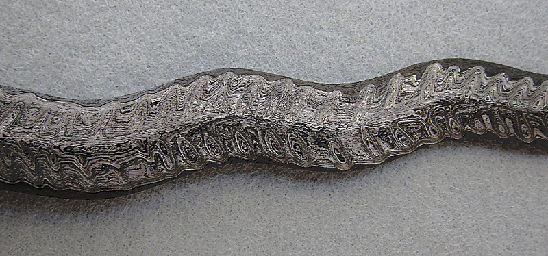

We've been talking a lot about quality, I thought it was about time we had a look at what I mean by quality.
This keris was made in Solo about 20 years ago. It is, I believe, the first keris made in modern times using meteoritic pamor
Old 30th May 2012, 03:21 AM   #41
Posts: 7,403
What a beautiful and impressive piece, thanks Alan for posting this.
Old 30th May 2012, 10:28 AM   #42
Jean
Join Date: Jun 2009
Posts: 1,740
Hello Alan,
Excellent kris indeed, can you tell us who was the maker?
Regarding meteoritic iron, I assume that the materials is now imported from abroad and when did the use of local meteoritic pamor disappear? (I mean except in the kratons).
Unless the subject was already raised in another thread, how do you identify meteoritic pamor? Besides the look and touch feeling, some Indonesians claim that they can feel a sort of electric wave by passing the hand just above the blade, what do you think about it? I tried it with a match but am not sure about the results although I am an amateur dowser.....
Best regards
Old 30th May 2012, 11:12 AM   #43
Posts: 7,228
Jean, I gave very careful consideration to the question of naming the maker, and I have decided that it is in the best interests of all that I do not. This man was for a while possibly the best pandai keris of conventional dhapur in the modern era, however, he has become somewhat disinterested in his work in recent years, and to avoid any annoyance to him, or backlash to myself, it is probably best to leave him unnamed.
However I can name the person who made the pamor material. It was me. That's how I can be certain that it is meteoritic pamor:- I made the block of meteoritic material that went into it.
In fact there is no absolutely guaranteed way to identify meteoritic material. In my opinion it probably has a slightly prickly feel, but who is to say that some other material does not have a similar feel?
We all know that the use of meteoritic material in Central Jawa was tied to the Prambanan meteorite. I seem to recall that Pak Djeno (Alm.) made a blade using meteoritic material, probably from the Prambanan meteorite, so it hasn't really stopped, its just a long time between drinks. Maybe it slowed down during the PBX era.It is probable that Jayasukadgo still made some meteoritic blades.
As far as I am aware, no meteoritic blades were ever made in Jawa Tengah except for people who were connected to either Surakarta or Jogjakarta karaton, and who had access to the karaton empus. All this business about meteorite has been gone over many, many times. Bronson is the best source.

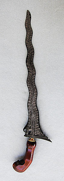

Old 31st May 2012, 02:08 AM   #49
Posts: 6,429
Smile Another Kelengan Baru
Since the thread started with one .
This work always gives me great pleasure when it is examined/studied.
The wrongko is like a thunderstorm portrayed in woodgrain .
I will call this a 'good keris' ; I'm proud to be its keeper in my lifetime .
My Son will receive it someday .

Jean
Join Date: Jun 2009
Posts: 1,740
Hi Rick,
I agree that this is a very good keris kamardikan, may be the work from Mpu Sukamdi?
