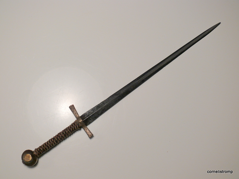

Type 1a
It resembles closely the shape of a sword, only smaller, but some examples have single edged blades. It was in use during the 14th and first half of the 15th century.

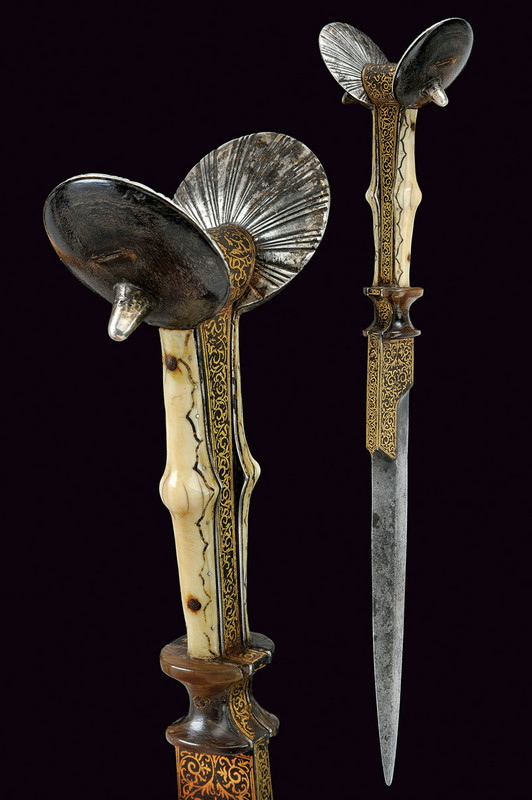

Type 1e
It has only a rudimentary guard, the pommel is formed of two large disks assembled in the form of ears. It is therefor called ear dagger. It was mainly used in Spain an Italy in the second half of the 14th and first half of the 16th century. A few examples may date earlier.

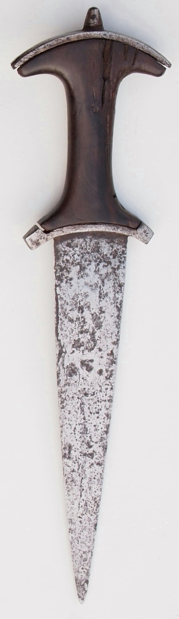

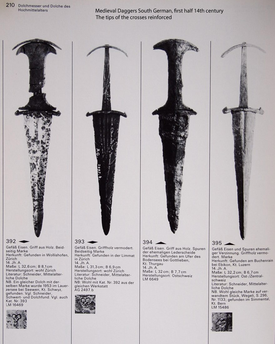

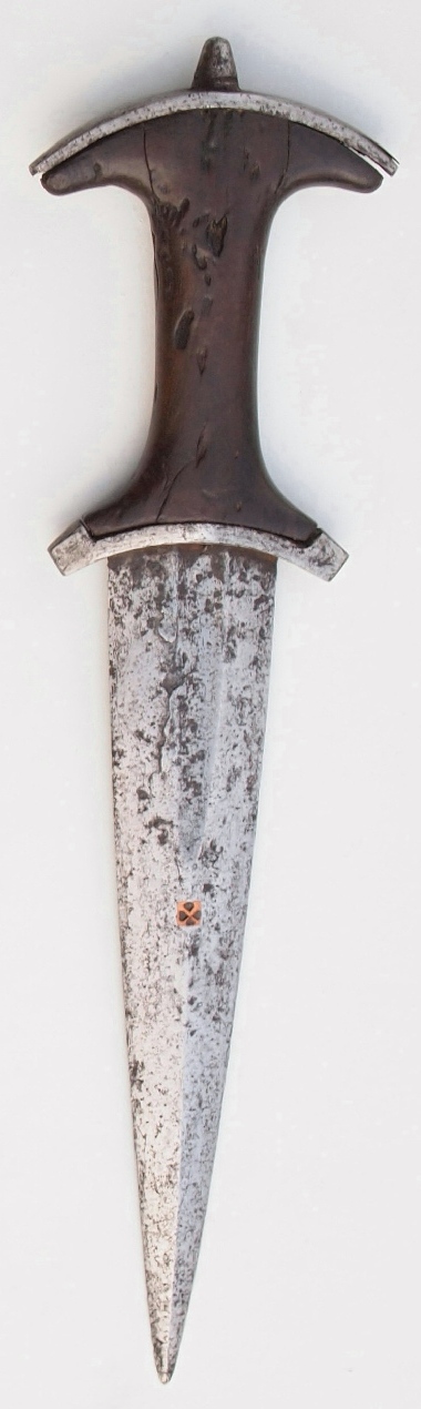

It has a sort bar as guard and pommel, both curved towards the blade. Most often the guard has reinforced and elevated ends. The blade is very broad at the hilt and of strong flattened diamond section, strongly tapering to the tip. Some blades have a roof shaped section, one side is quite flat, like a diamond section blade, cut in halves. The blade has most often a short fuller on its upper third. This type is most often, but wrongly called 'Schweizerdolch'. What we call today Switzerland was a part of the German Empire in the 13th and 14th century. The type was used all around today South Germany, Austria and Switzerland. Not even Hugo Schneider, the author of the book 'Der Schweizerdolch', called it like this. It is also often dated to the second half of the 15th and first half of the 16th century, which is clearly too late. The type was used during the second half of the 13th and the whole 14th century.
