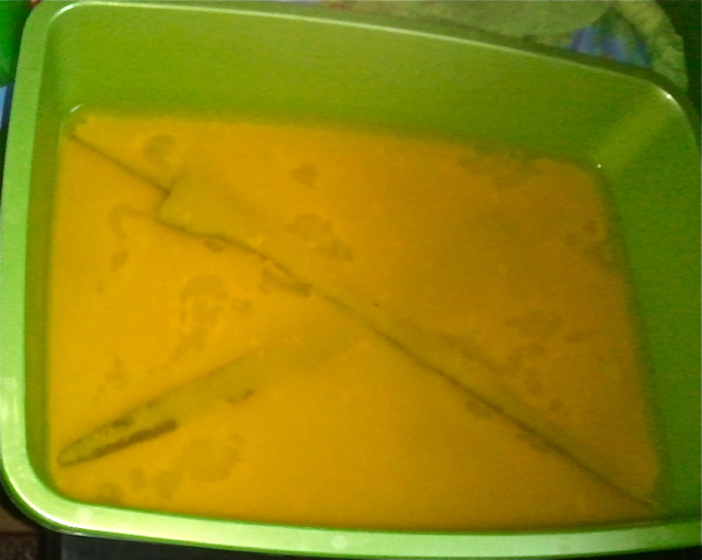

I usually use 1 l water and 4 dl vinegar, so the solution is not too aggressive.

Well, I read many posts on this forum regarding pineapple juice and saw for myself the great results from kerises soaked in it. So, right now, I have two of my kerises (one of which is the blade this thread features) soaking in pineapple juice. I will monitor closely and post pictures of the results when they are ready.

Unsweetened juice; correct ?

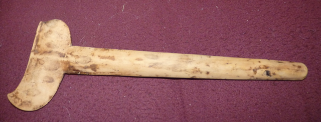

Okay, after two days in the pineapple juice the blade was free of rust! The other keris will be awhile. Now, the sheath is another story. I went to remove the pendok and found that someone had epoxied it onto the gandar - what a mess! I tried to remove it as gently as possible, but still some minor damage occured and getting the glue off of the wood was no fun. I ended up sanding the entire thing trying to get it to look half-way decent. Now I'll need to stain it - NOT my original intention. I'll include an early sanding picture. Now matter what - it'll be an improvement!

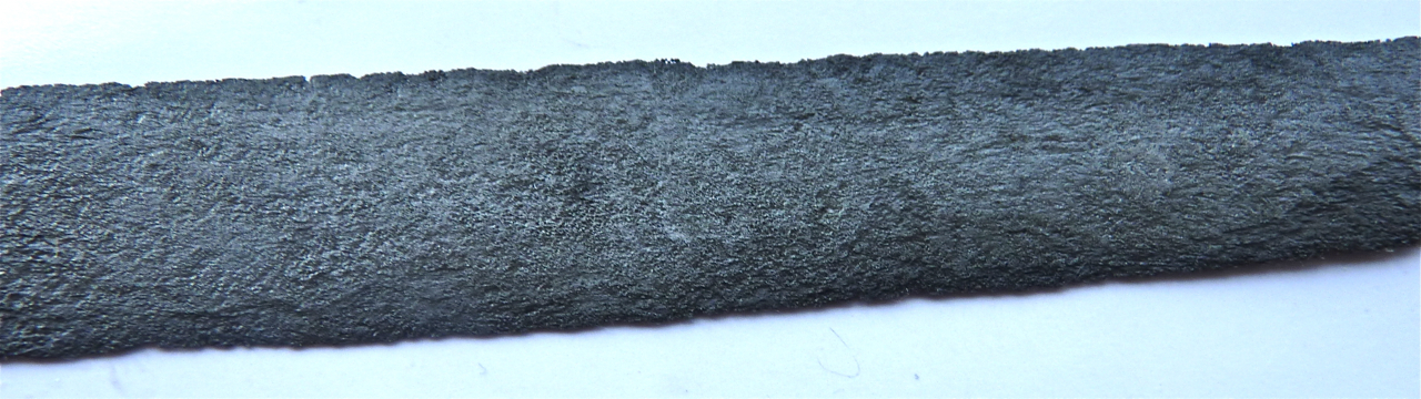

Looks like the blade has only residual pamor left .
I would suggest shellac for the final finish of the scabbard .

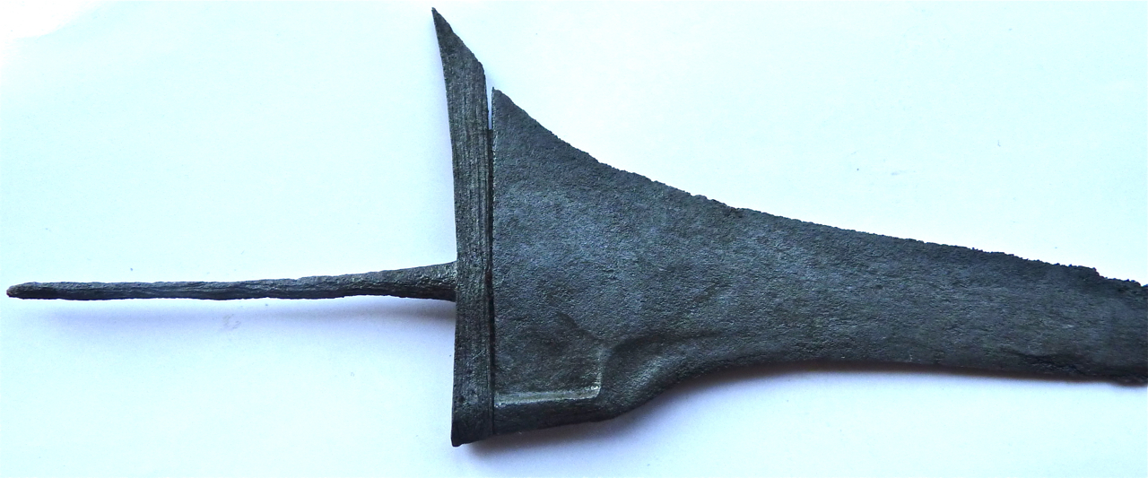

Posts: 335
In such situation I remove the ganja: there is always a lot of rust on the lower part of the tang and between ganja and blade.
After cleaning I apply an anti-rust product on all non -visible places.
Agree with you in both cases! This (the residual pamor) was the reason why I have written before that this keris is in my opinion not a "keeper" since I have thought that the pamor is gone.
Speaking only for myself, this is something I would never try .
Seems that we both have a lot of agreement for the moment!
The possibility that the ganja break by this old piece is very high! And I can't see many corrosion between ganja and blade.
