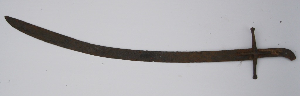

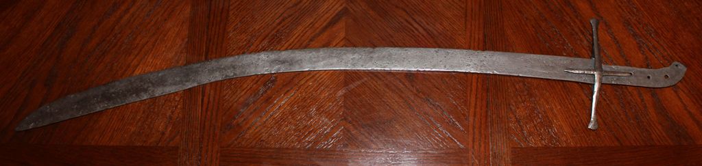

I've just remove mellowed rust after 3-4 weeks of soaking in the distilled water. Blade is not cleaned out to shiny naked metal (as it might seem from the photographs). I've leave some rust in the deep caverns. Next step is process the blade in the tannin solution.
Evgeny

Originally Posted by Evgeny_K
Hello Ibrahiim,
Blade was already damaged because saber was dug up.
Desaltination is a necessary procedure to prevent further corrosion of the metal.
I've just removed with dremel brush mellowed rust from the surface of the blade.
Deep caverns already were on the blade when I get it into my hands.
Salaams Evgeny_K~ Ok I sympathise because excavated metalwork is always a headache to restore. I can see by the first photos that this was never going to be easy though I hope you get a good result with the next phase...Just getting to the point of stabilising the rust will be a considerable step. Best of luck ya.
Regarding your next sword in similar condition ... This looks like another mission impossible ! What is tannin solution please ? I have not heard of it... I will search the web... is this acidic? How long to soak?.. can we see an after photograph please? Good luck !! ...ah wait I have searched the best library.. our own Forum search and now I understand tannin solution... very interesting indeed... Forum search Tannin Solution !!!
Ibrahiim al Balooshi.

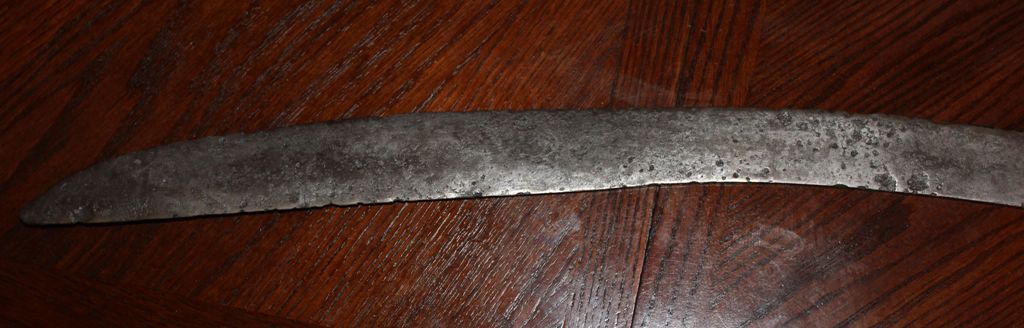

Jeff and dear all,
Evgeny

Hi Evgeny,
My personal opinion is "Less is More". This is a 400-500 year old weapon it should not look new. I know the temptation of using modern power tools, sandblasters, and chemicals, I have tried all of them on old rusty tools as experiments, the results have been less than optimal. You clearly have some knowledge of restoration, but I would implore you not to experiment with these sabers, they are too valuable (even in artifact condition).
All the Best
Jeff

Originally Posted by David
When i look at the before and after on this particular blade i can clearly see additional loss along the edge near the tip of the blade, damage which was not there before the restoration began.
David and dear all,
Previously posted photos were taken a year before I got this saber.
Metal loss is a result of the corrosion effect.
Evgeny_K is offline   Reply With Quote

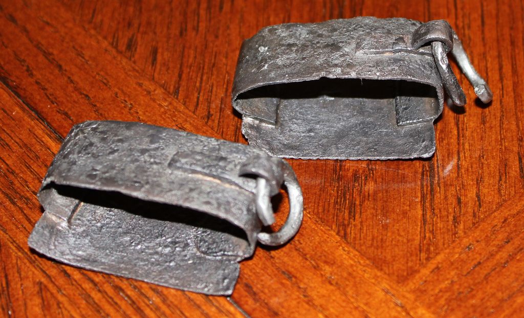

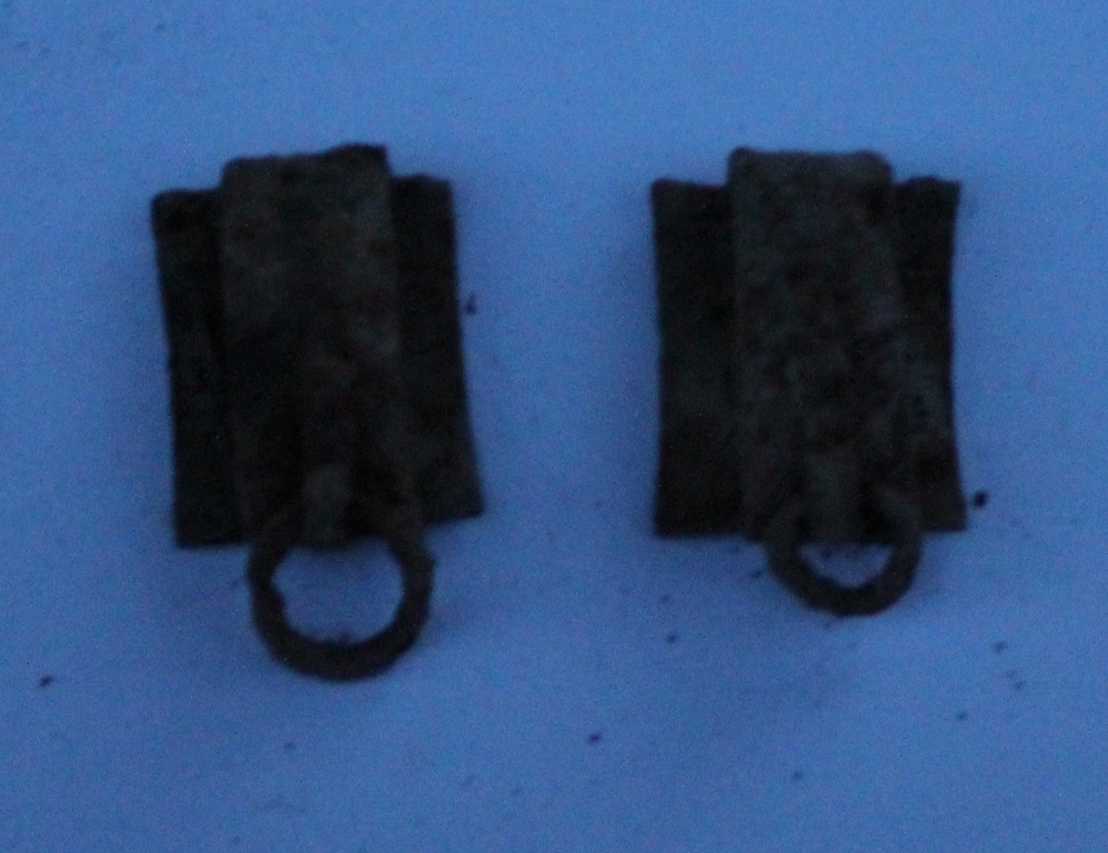

P.S. I've got another saber from Moscow region (Mozhaysk). Polish or Russian I'm not sure. Will be glad to get any advises from you how to deal with it.

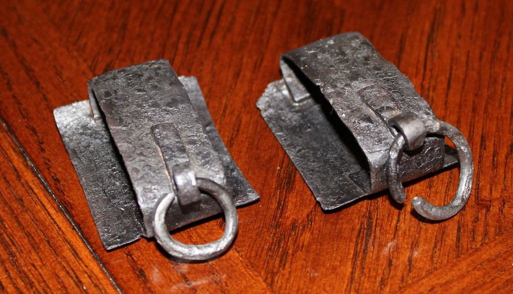

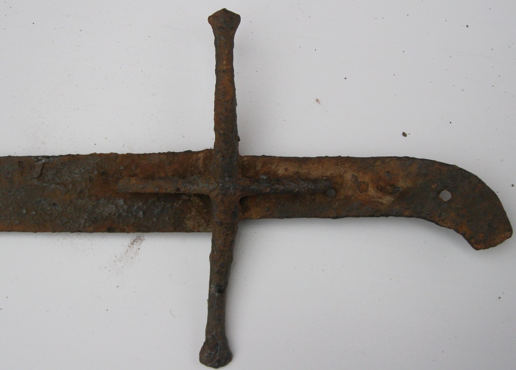

scabbard mounts in progress:
before (too much rusted)
Old 27th March 2012, 01:48 PM   #73
Evgeny_K
Evgeny_K's Avatar
Join Date: Mar 2011
Posts: 217

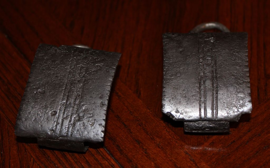

after (reactivation of the ferric oxide in the carbon environment):
Salaams Evgeny_K ~ I have to say that this is pioneering work !
Considering the state the items were in when you started I think that is an excellent result. I hope the rest of the restoration goes as well. Most museums wouldn't touch this because understandably the sword was on its last legs... Most of us would have given this sword the wax protection and left it at that... Perhaps we have here a viable resusitation technique on what many would have said was a lost cause... This is highly specialised work. Best of luck Evgeny_K. Very impressive..

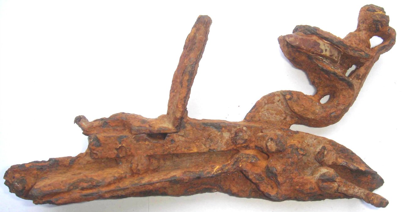

Here is another example of his work (excavated rifle flint lock):
before:

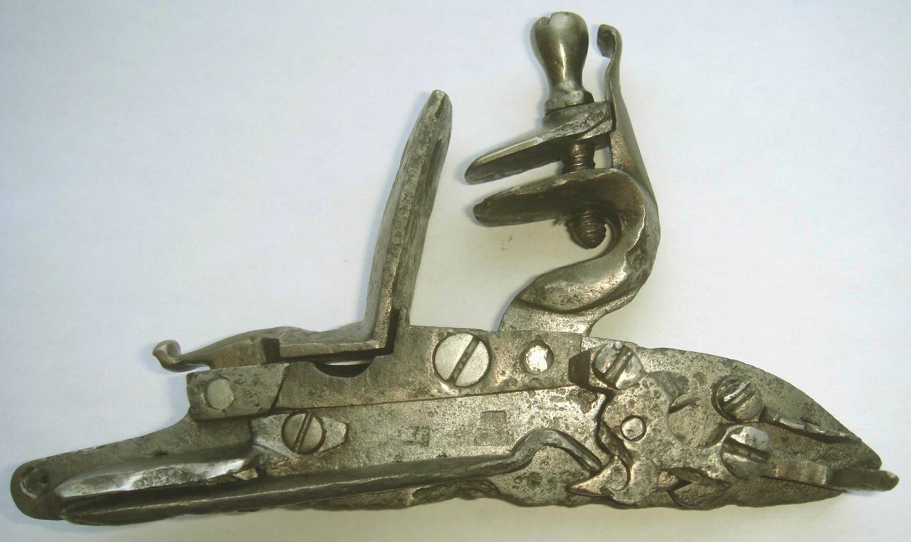

Old 27th March 2012, 06:50 PM   #76
Evgeny_K
Evgeny_K's Avatar
Join Date: Mar 2011
Posts: 217
after:

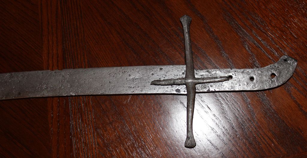

I wonder what the finished sword will look like?
Here is the sword...

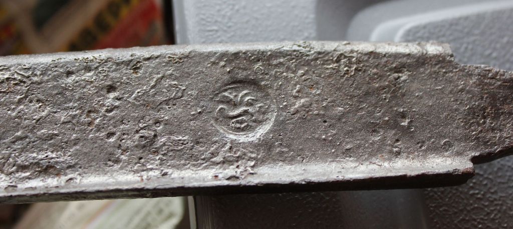

Gentelmen,
I would appreciate for any help in identifying this mark

Salaams Evgeny_K ~ I am very impressed with the result so far. This is highly specialised and advanced stuff... Now you have the blade stabilized and carbonized (will that prevent rust or is there a danger of rust continuing under the carbon? ) What is your programme of restoration for hilt and scabbard. Astonishing results so far...
I was searching for associated material and discovered a distant link to an important resource in the Forum Library on the Ethnographic that can be found by typing into search Polska szabla husarska by Wolviex .
Perhaps this can be brought onto the European for perusal please?
Thank you.
ps The stamp is upside down I think.

Evgeny_K's Avatar
Join Date: Mar 2011
Posts: 217
Originally Posted by ariel
I have already expressed my view on the extent of restoration.
Now, the question.
Heating rusted metal as described is obviously fine for the rust. But what about the metal hardening and tempering? Also, the blade acquired a dull, dead sheen. Is it correctable?
I think that this method can be applied to objects that are in very poor condition. In my case, a sword has not lost springiness (I'm not going to use a sword for cutting). The surface is dull because of usage of molten paraffin (for conservation).
