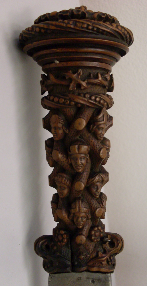

Originally Posted by e.a.Zainal
Numbers are
2579 2572 2582
2581 2578 2576
2579 2583 2577
i think it's like a magical numbers that help the user for some think like a magic script
اللهم لاذة الله
عين سبيق ودت الله
Oh God that Take you to the God
An eye faster than Kindness of God
that what i understand from the Writing
but the Second line I'm not sour about it
it may my translatiuon is meaning defrint that what it mean becuse the Scipt Mening is very deep
The Falchion or Malchus, the rarest medieval sword is a beautiful thread, there is a illustration posted with apparently a similar dot inlay.
best,

Sorry, it looks exactly like a mandau blade to me. I had the chance of holding dozens of them at Oriental-Arms. The golden dot work is typical and the scale pattern appears to be of severe thermic damage.
yes on behalf of the outline, my first impression was also directed towards the dayak head hunter swords.
also because some of them have inlays with larger dots or stars.(kalimantan)
of this track, I passed off, I mean
can you please post a picture of a Mandau like the blade under discussion, with a western type of ricasso and with double fullers?
best,
Old 10th March 2012, 04:21 PM   #27
broadaxe
Join Date: Nov 2008
Posts: 334
Well, since no two mandaus are exactly alike it is hard to find an exact twin. Off my field, I do not have access to a vast image bank of indonesian arms. It appears a double fullered mandau is quite a rarity and I understand this blade may look european. Double fuller mandau with lesser pronounced ricasso: http://www.oriental-arms.com/photos.php?id=2344
Old 10th March 2012, 05:36 PM   #28
cornelistromp
cornelistromp's Avatar
Join Date: Mar 2009
Posts: 1,071
I see what you mean, thanks for the link.
even though the differences are not so great at first glance, the differences in blade geometry are larger. This is truly oriental sword blade (south east asian) and the blade under discussion does look more western. (middle eastern)
Another very oriental looking Malchus was exhibited in the GNM in Nuremberg. it has been described as german 15thC.
I am not yet convinced but leave all options open, maybe there will be more clarity.
best,

I'm sorry, but this is pretty clearly a SEA blade from the last 1-200 years. It is a very nice blade. But not early, not middle eastern.
thank you for the pictures, I am familiar with the Mandau and its decoration.
it looks a little different though. Do you happen to have also examples of mandau blades with Naskhi inscription and magic squares that can be placed.
thanks+regards
