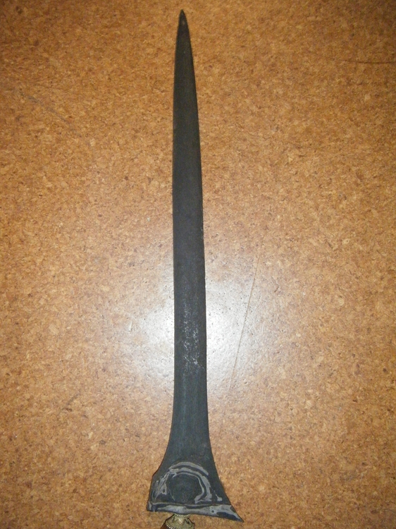

Just for sharing...Dapur Tilam Upih, pamor Ujung Gunung or any opinions are welcome. Can we call this pamor type as pamor luluhan or only pamor nyekrak (I do not know how to translate it in English)? If we touch the blade with finger, we will find that pamor layer is sharp with irregularly surface. I am wondering what is the different between pamor miring and pamor nyekrak, which one more difficult to be made? To my eye, this keris possesses features of Blambangan keris, but I think Madura made also can be accepted.

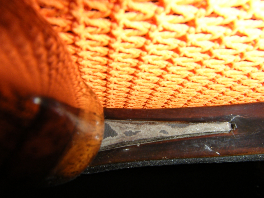

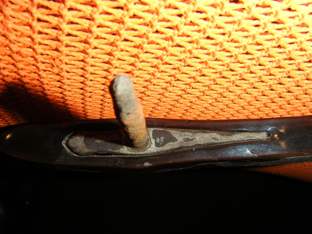

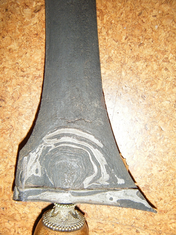

Pak Alan, probably these 2 photographs of ganja can satisfy your request athough not too obvious I think, sorry. Somebody told me that pamor nyekrak is a term of pamor miring type which refers to rough and sharp surface, seems like done by kamalan method (again, I do not know how to translate kamalan word in English). Frankly, I do not know about that Regarding pamor luluhan, actually no one has told me the meaning of that, but I ever read that pamor luluhan is related to pamor Pitrang Sorry I cannot explain anymore because I do not know..
Karttikeya is offline   Reply With Quote
Old 10th December 2011, 04:31 AM   #4
Posts: 7,255
Thanks for the pics Karttikeya.
From what I can see in the photos you've provided, I'm inclined towards classification of this blade as Tuban. The usual qualification:- if I held it in my hand, my opinion could easily change.

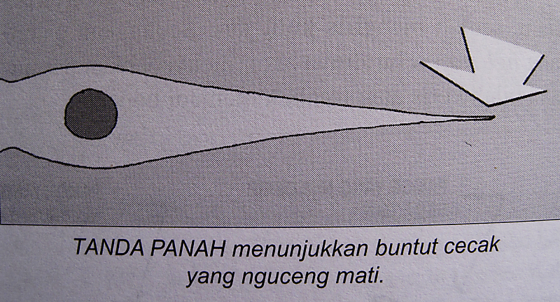

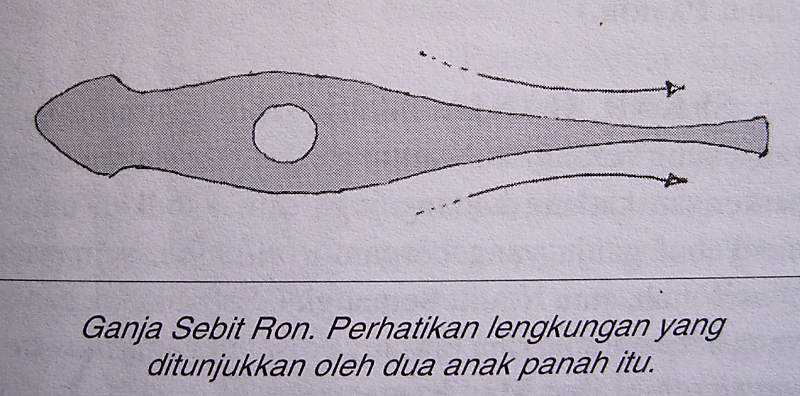

The images shown with this post come from Ensiklopedi Keris.
Sebit rontal gonjo have a "waist" between the wide part of the gonjo that the pesi penetrates (gendhok), and the narrow end of the gonjo (buntut urang).
The other major type of gonjo is the nguceng mati form, it has a buntut urang that comes to a point.
The classic Tuban gonjo is neither nguceng mati, nor sebit rontal, it looks like nguceng mati that has been cut off, so it has flat sides like nguceng mati, no waist, but the buntut urang is cut off more or less square.
There are sub-types of Tuban blades, :- Tuban -Mataram, Tuban -Pajajaran, even Tuban-Majapahit, and all these sub-types display minor differences from mainstream Tuban, these minor differences include variation in the form of the gonjo.
The Tuban gonjo is particularly recognizable because the sirah cecak is noticeably rounded, and of course, because of the shape of the rest of the gonjo, which is quite different to any other gonjo, except perhaps Segaluh, but Segaluh has the pesi placed differently, so it is easy to identify. This is the reason why experienced keris people are confident to name a blade as Tuban while it is still in the wrongko, and all they can see is the top of the gonjo.

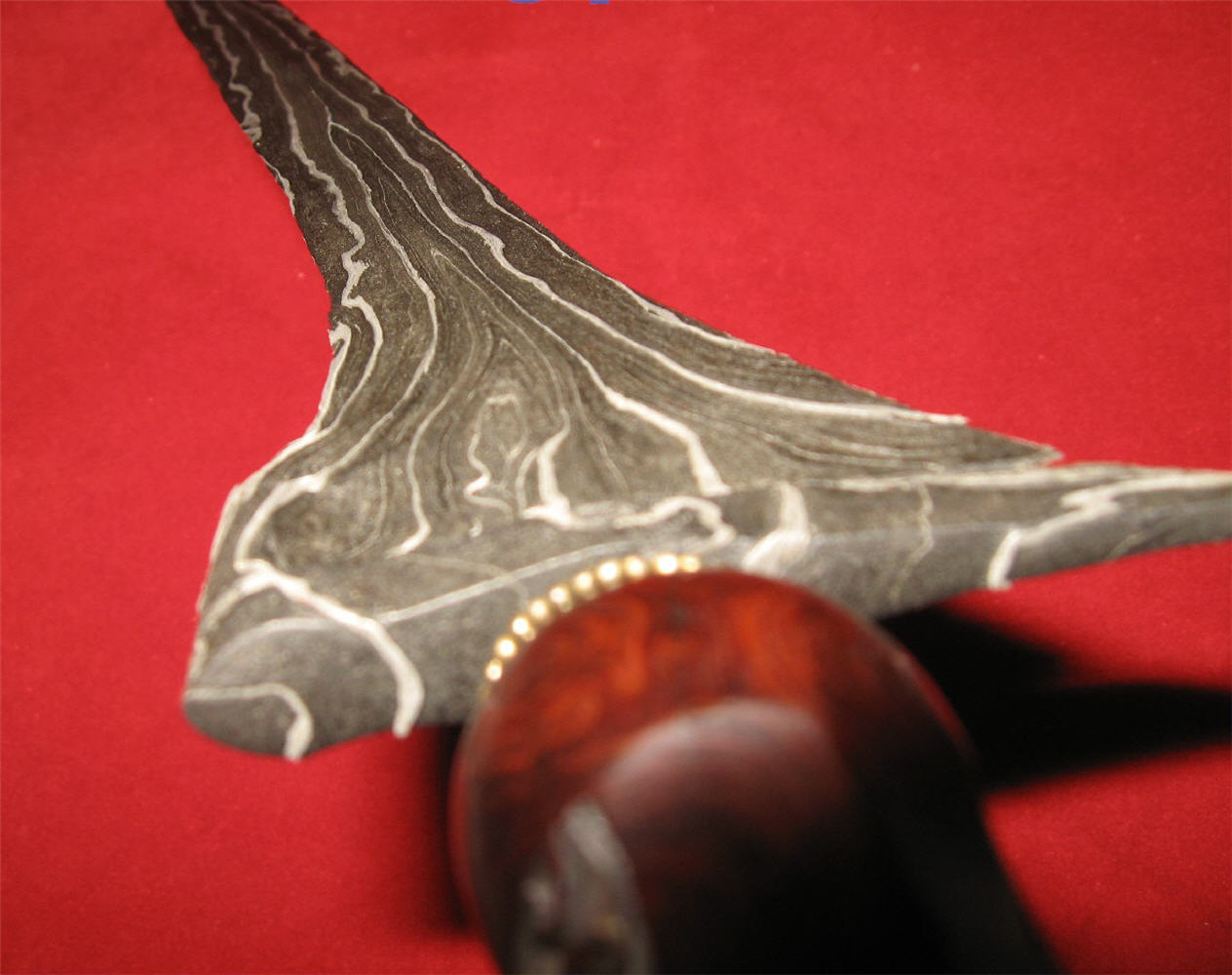

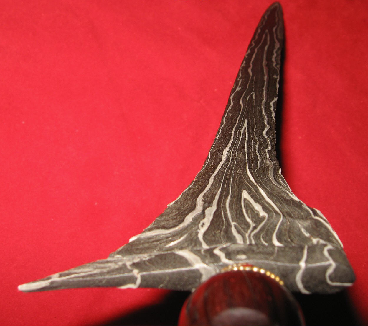

Hello Alan,
only for my better understanding, do you mean a shape like shown in my pictures? I don't want to say that this is a Tuban blade but think that this is the shape you referring about.
Old 13th December 2011, 10:42 PM   #19
Posts: 7,255
That is moving towards the shape, Detlef, but it still seems to have a slightly less than straight side between gendhok and buntut urang --- maybe its camera angle.
Also bear this in mind:- there are parameters within which the gonjo can fall, and still be classifiable as one form or another. This is the foundation of tangguh:- opinion.
My opinion, based upon what I can see in your photos is that this gonjo is not pure Tuban, but in the hand, it might be. One thing is certain, your gonjo is not sebit rontal, neither is it nguceng mati --- but is it Tuban? Maybe, maybe not. In the case of your gonjo I would want to see and handle the blade before I was certain.

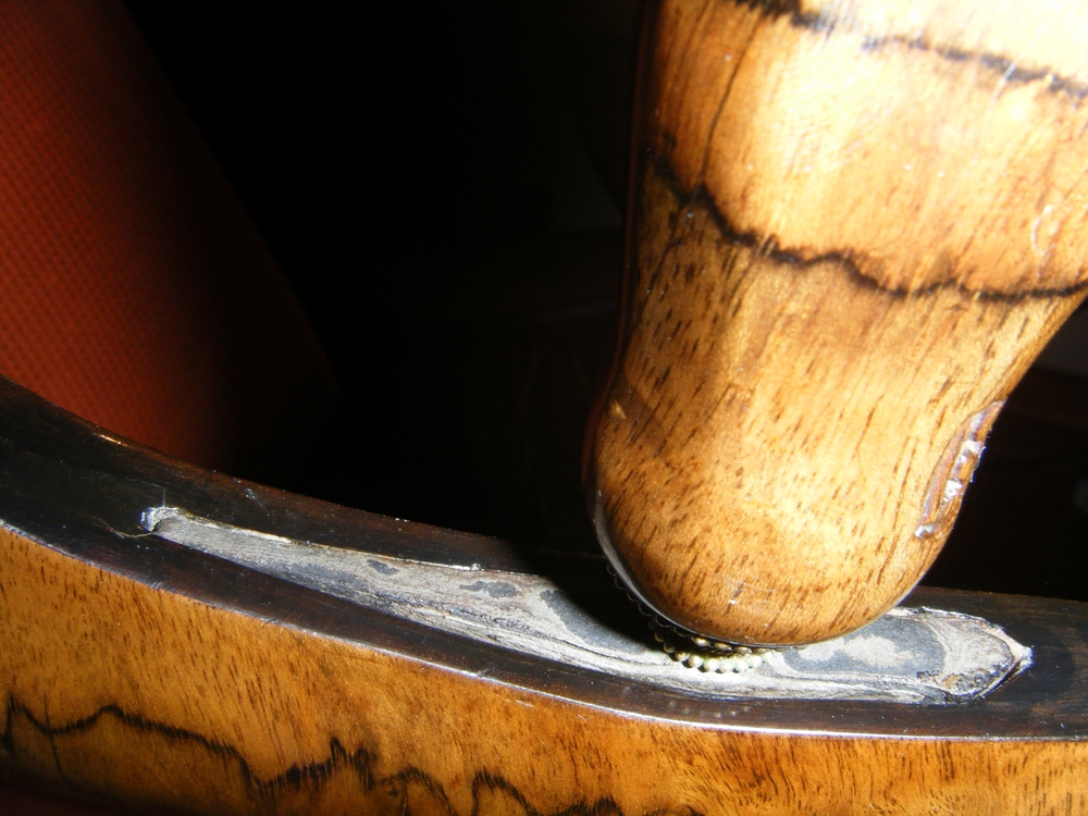

Like I have written was it my intention to know if I understand you correct. But here two pictures of the blade and a picture direct from up to the gonjo without handle.
Old 14th December 2011, 12:59 AM   #21
Posts: 7,255
Detlef, your photo is at an angle, I can't see any more from this than from the previous ones. What you are looking for is a straight line, without any inward curve, between gendhok and buntut urang. If you have that there is a very strong probability you're looking at Tuban, if do not have that, you might have Tuban, you might have something else.
All I can say is that you are moving towards the Tuban form.
A real life example is actually pretty useless for this game, because what we are trying to do is to set a standard and a standard is best set from a drawing. In an actual example there can a very great range of variation that can still fit within the parameters.
Clip the buntut urang square on a nguceng mati, and that is Tuban.It has the appearance of having been foreshortened.

Originally Posted by Karttikeya
In my opinion, we cannot strickly apply the features of ganja sebit rontal ideally like the above reference, probably empu intend to make ganja sebit rontal but final result is not like ideal ganja sebit rontal with significant waist between the wide part of the gonjo that the pesi penetrates, and the narrow end of the gonjo and looks like nguceng mati that has been cut off. Some people told me that this ganja can be classified as ganja sebit rontal, although the shape is not so ideal as ganja sebit rontal like your picture.
Sebit Ron versus Sebit Ron Tal
According to the EK (page 413), the term Sebit Ron designates a ganja with a "waist" on the back side when looked from the top and as shown by Alan, while the term Sebit Ron Tal designates a ganja which has a shape which curves downwards on the back side when looked from the front. So the 2 terms designate different features.
IMO the kris from Karttikeya has a gonjo wuwung (see EK page 537) in which the top and bottom lines are more or less parallel when looked from the front.
Thank you Alan for your explanation. BTW, there is a very slight inward curve between gendhok and buntut urang. But again, my intention was to understand and learn, not to know which tanguh have this blade.
Old 14th December 2011, 08:43 PM   #30
Posts: 7,255
Yes, I understand your intention Detlef, but real life examples are much less satisfactory than drawings to understand the parameters of tangguh classifications. The reason for this is that the interpretation of a feature can vary within a fairly wide range, and the blade can still be given one tangguh or another.
Neither your gonjo, nor Karttikeya's gonjo are pure Tuban, but if they are not Tuban , you then need to ask what they are. There are only so many classifications to choose from --- well, legitimate classifications. Once that rounded sirah cecak comes into the picture, you've virtually got nowhere else to go, other than Tuban.
If all that can be seen is the sirah cecak, you can consider Segaluh, but true Segaluh is nguceng mati, so when the buntut urang does not come to a point, you simply have nowhere else to go, other than Tuban.
But there can be variation, because only the smiths who were central to the classification would maintain that central standard. Unlike most other tangguh, Tuban was a trading center, not a kraton nor an administrative center, and the blades that we classify as Tuban would have been produced over a wide area , along the north coast, and for a little way into the hinterland, then brought to Tuban city to trade.Additionally, Tuban covered an extended time period. But the constant indicators seem to be the gonjo of a particular form, and the cross section of the blade, which is rounded, like rotan.
Within Tuban major classification there are a number of sub-classifications, and the indicators can vary through a very wide range for these.
Very, very seldom do we get a blade that is a textbook example of any tangguh, it is virtually always a matter of looking at all the indicators and forming an opinion based on those indicators. For instance, to carry out a full appraisal of a blade that on primary examination appears to be Tuban, I would need to closely examine and consider a minimum of 13 indicators. From a photograph I can only do a partial evaluation of perhaps 3 or 4 indicators.
Apart from legitimate tangguh classifications there are thousands, probably millions of blades out there that should never be given a tangguh at all. These blades are the product of smiths of greater or lesser talent who were working away from the direct influence of a major center that had a distinct style. Thus we get strange combinations and muddled interpretations. In fact, if we stick with the original concept of tangguh classification, 99.9% of all blades that we encounter probably could not be blessed with a tangguh.
