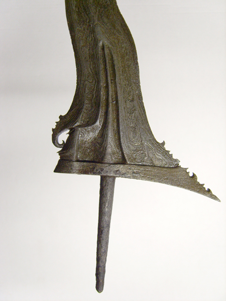

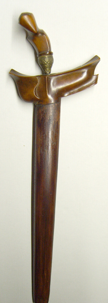

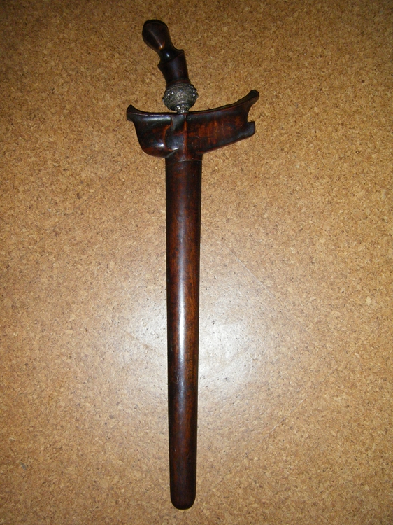

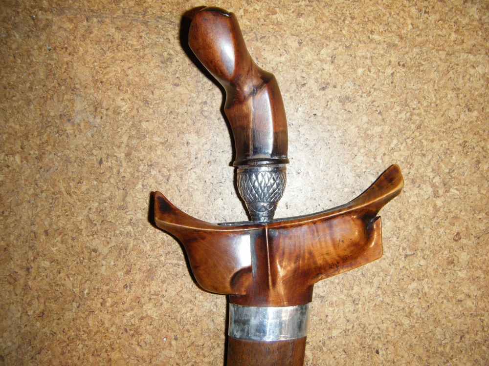

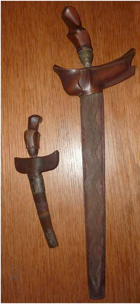

Just picked this up: nice old Palembang I think.
The scabbard needed some restoration, unfortunately there was only one half.

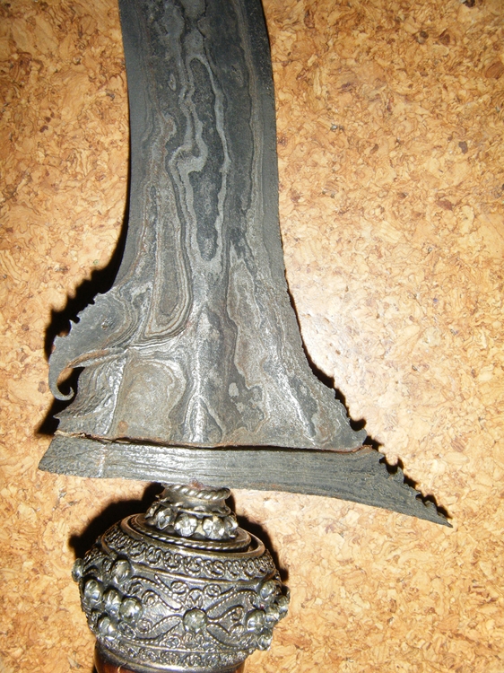

I hope there is someone who can tell me more about it, is it an original Palembang blade? It seems to me an original composition, the pendoko looks it’s gilt silver, but the gold has almost all disappeared, leaving a faint golden tinge.
The veiled durga hilt has no cracks (but was stuck very tightly) the total length of the blade is: 45cm/17.7inches, length of the pesi: 6cm/2.4inches.

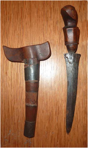

The little one is 24cm/9.4 inches in total, I do not know if it is a patrem, or is it talismanic?
Thanks in advance for your comment,

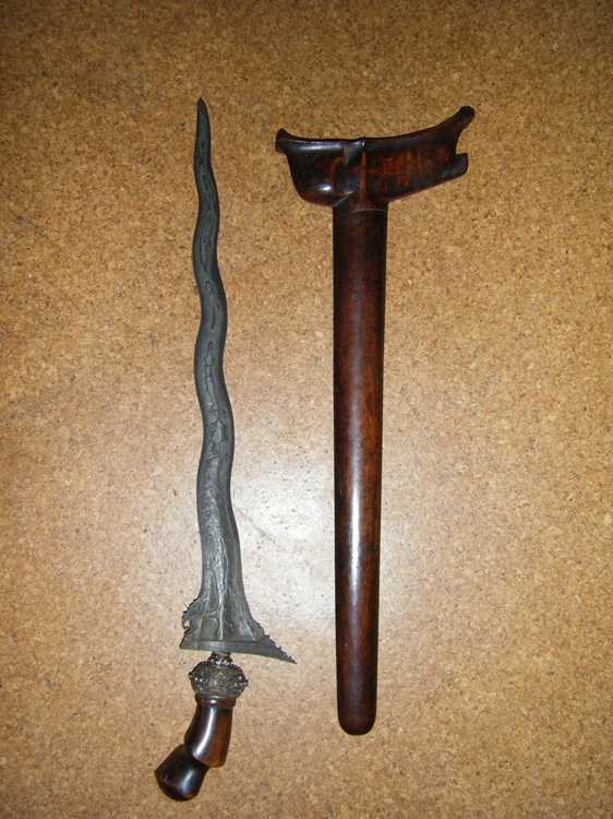

and another picture of the little one

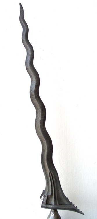

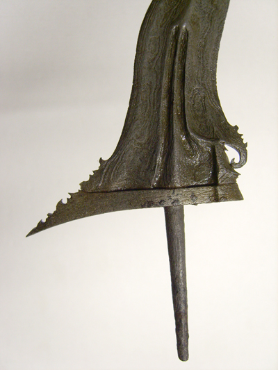

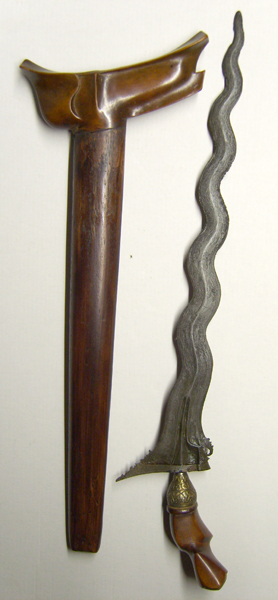

Hello Sirek,
yes, in my humble opinion it is a Palembang blade. Look for comparison to the blade of my Palembang keris. I have a second example with nearly the same features.
Nice catch!
Old 24th October 2011, 10:14 PM   #4
Posts: 9,757

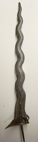

And here both side by side. Of course have your blade sogokan and my not but I think that you can see the affinity.

Posts: 1,180

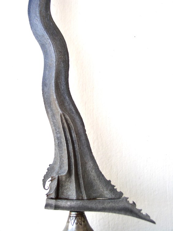

Certainly looks Palembang to me. The greneng style is consistent with what I see on my Palembang pieces.
The interesting thing is that this blade looks more 'beefy', with much more accentuated luk than most other Palembang blades of similar style. Here's one of mine for comparison.

I agree that this is a nice old Palembang kris, but i do not think that this hilt is durga...
I used the name veiled-Durga, simply because I know no other name for this hilt shape.
If I see a picture somewhere, he is described as veiled-Durga
(I saw this name already discussed in previous discussions,but without
result only known as Palembang hilt or batman hilt )
or has someone already found the correct name for it?

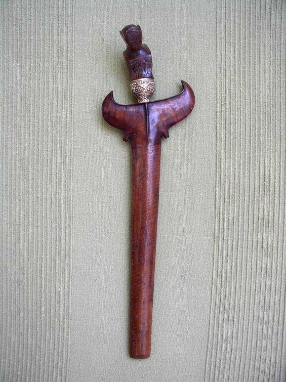

I think it was again Martin Kerner who used first time "Veiled-Durga" for this type of hilt in his book "Keris-Griffe Aus Museen Und Privatsammlungen" (look page 139) and others take this unproofed. It is said on other place that this hilts are common in a region neighbouring to Palembang, Bengkulu, what seems verisimilar since all examples I have seen coming with a typical Palembang sheath.
Here a second example with this hilt from my collection.

Nice catch!

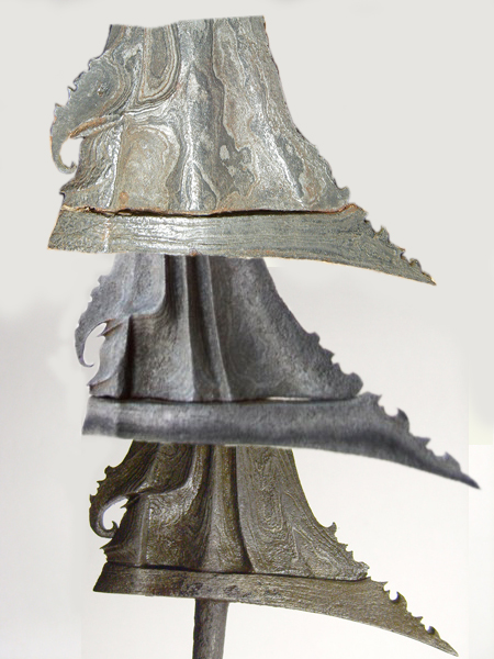

Hi Sirek, your long keris seems to be a nice example of a Palembang keris. The shorther keris, although looks crude.. it's a type that can be found around that region.
Sajen, your keris is also nice, but the selut and mendak do not match, imho looking and post #3 and #4. Looking at the blade, the kembang kacang area seems disturbed especially the pamor works, which suggests a repair, perhaps.

Hello Alam,
yes, I know that mendhak and selut are wrong but I get this keris in this way. Blade was corroded and the hilt in the same form was split. So the blade was washed and etched and I replaced the handle. Until now I don't found a matching selut. I don't think that the kembang kacang is repaired but I agree that it look on the picture like this. BTW gandik area and the top of the gonjo was at some time before gilded.
