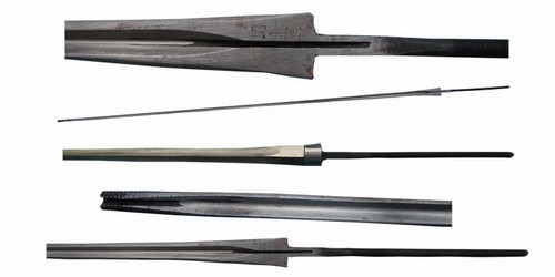

Any comments on the provenance and age of this would be appreciated. I'm going to guess European, 1880-1910, only because I can't think of a time when this may have been more common.
Overall length is 26"
Blade is 18"
Two views of the cruciform blade. The point is very sharp:
Close up of the head. I'm unsure what kind of wood it is, but my fingernail doesn't leave a mark in it:
The leather cord and Turk's head knots appear to be later additions:
Another view of the blade. It has a nice patina:
I'm certain the wood of the shaft is mahogany, having worked with it many times before:
Thank you in advance.

Hi Queequeg,
I would hazard a guess and say that this is either African or African colonial. Sword sticks are still available in Africa today for self protection whilst in the bush. Finding the 'source' of the blade would be a great help ....any markings ?
Regards David

All a very modern put together in my opinion.
It would be more a swagger stick at the length.

That blade looks like a modified fencing epee, which would make it western and probably modern-ish. Not sure where the head came from.

I think it's 30-50 years old, if that helps.

I would have said 1980-now

Okay, Gav, 20-50 years. I can go with that. I think it's had time for the leather to get worn and the wood to get a bit of a patina, at least.

The blade appears to be a French M1886 Epee Bayonet, cruciform blade with a slightly re-profiled tip. I have seen these in various canes of various ages from various regions.
Catherine Dike in Cane Curiosa show a couple of examples, one with the edges filed in decoration, figure 29/58 and and another in figure 29/67. Both appear to be the size and taper of these bayonets.

I dont think the tip is right for an epee, I suspect Gav is on the right track

I too think Gav is on the right track, a French bayonet that continued to be used in WW1 and later would certainly have been used in North Africa. Many European bayonets ended up reprofiled and mounted locally.
No great age to the fittings but the blade is likely much older and remounted....as I said before these are still carried in some parts of Africa. This could have been carried as a short sword, thrust through a belt.

I'm going to have to disagree, speaking as the former kid who actually ground down a broken epee blade. To me, it's chevron-shaped in cross section, but I agree that the pictures are less than informative
In any case, Queequeg will have to answer what the cross-section is, especially near the base.
Here's a modern epee (image source) for comparison. Unfortunately it doesn't show the critical part where this blade was sharpened down.
F

I could well have misread the images as cruciform where it might be triform.
