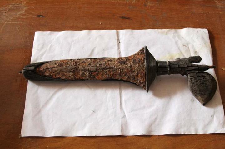

1)--- geographic origin of this blade
in my opinion it is not Javanese nor Balinese ( I group these two places together because for much of the period under consideration they can be considered as closely related, if not part of the same area of political influence)
I have never seen an early Javanese keris that had been forged without a gonjo.
I have never seen any Javanese keris from any period that had a tang similar to the tang on the blade under discussion. Early Javanese tangs were more or less square in cross section; this tang has an oblong cross section.
I have never seen a Jawa/Bali blade with a similar treatment to the sorsoran. Yes, in profile the notches in the sorsoran could perhaps be likened to a puthut, but likened only. I can see no suggestion of a puthut, only notches that would form an effective blade trap.
The flat sided tang and forward weighted blade indicate that this blade was used primarily as a cutting weapon, not a thrusting weapon. Early Javanese keris were used as over-hand stabbing weapons, and developed into weapons used as short rapiers.
In short, this blade simply does not look like a Javanese blade, early or otherwise.
