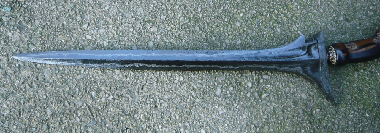

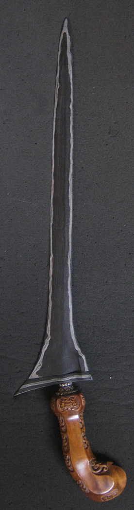

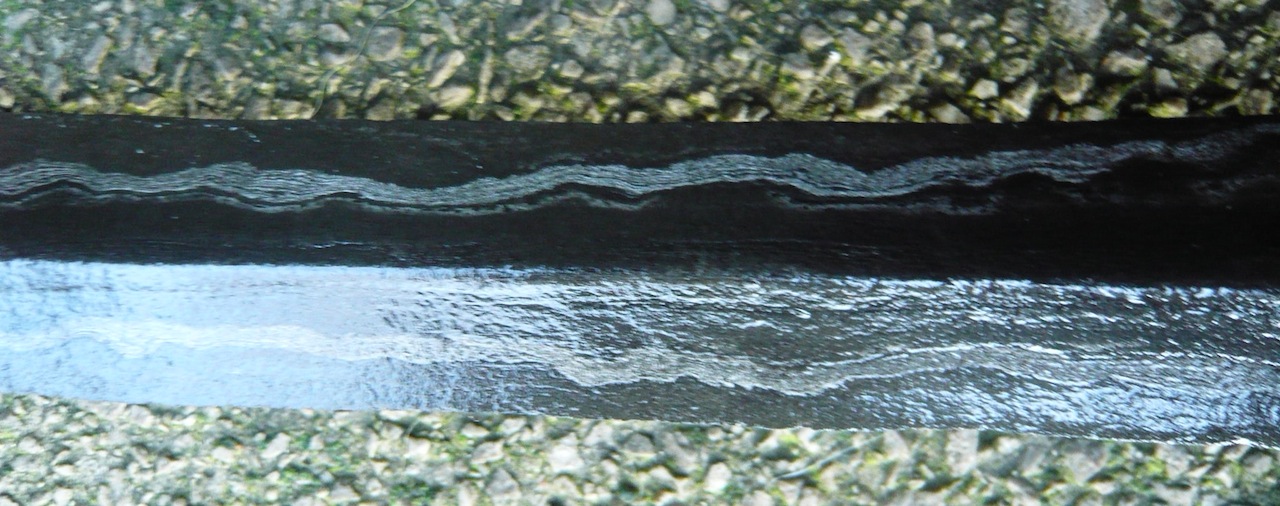

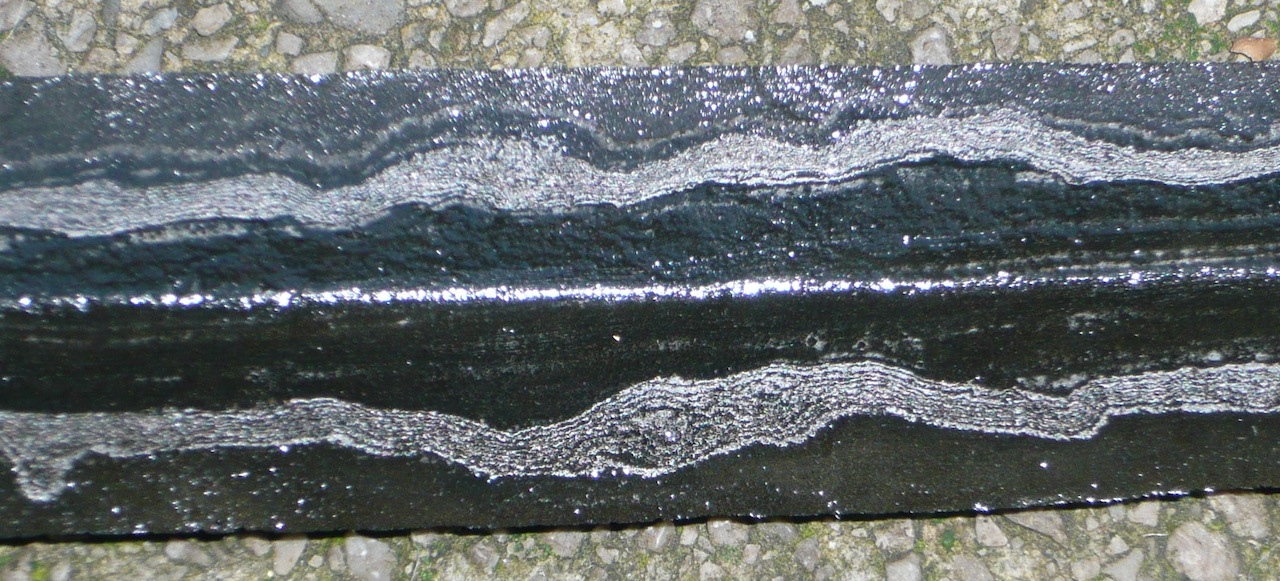

Default pamor wengkon

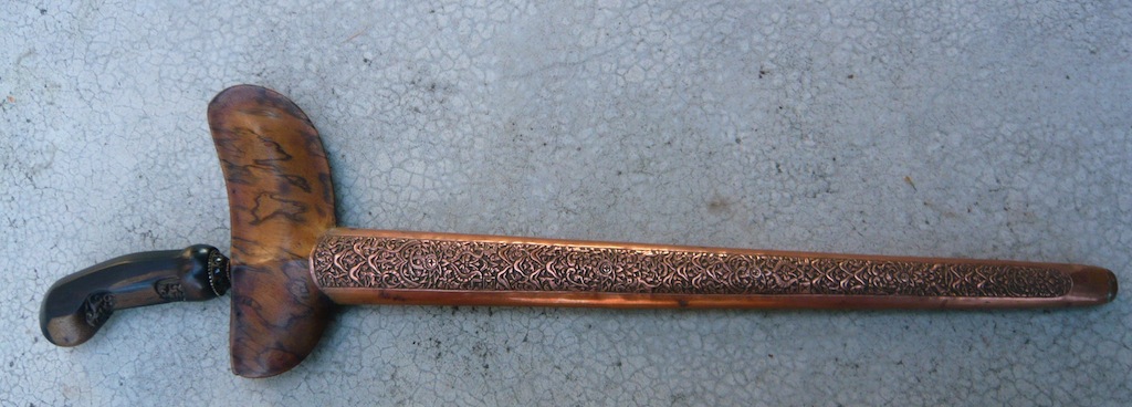

This is my last Yogya keris. Sorry for the light of pics but now in my cowntry the sun is not so good and very blat (winter )
Old 4th December 2010, 02:31 PM   #2
Marcokeris
Marcokeris's Avatar
Location: Italy
Posts: 928

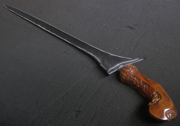

other pics

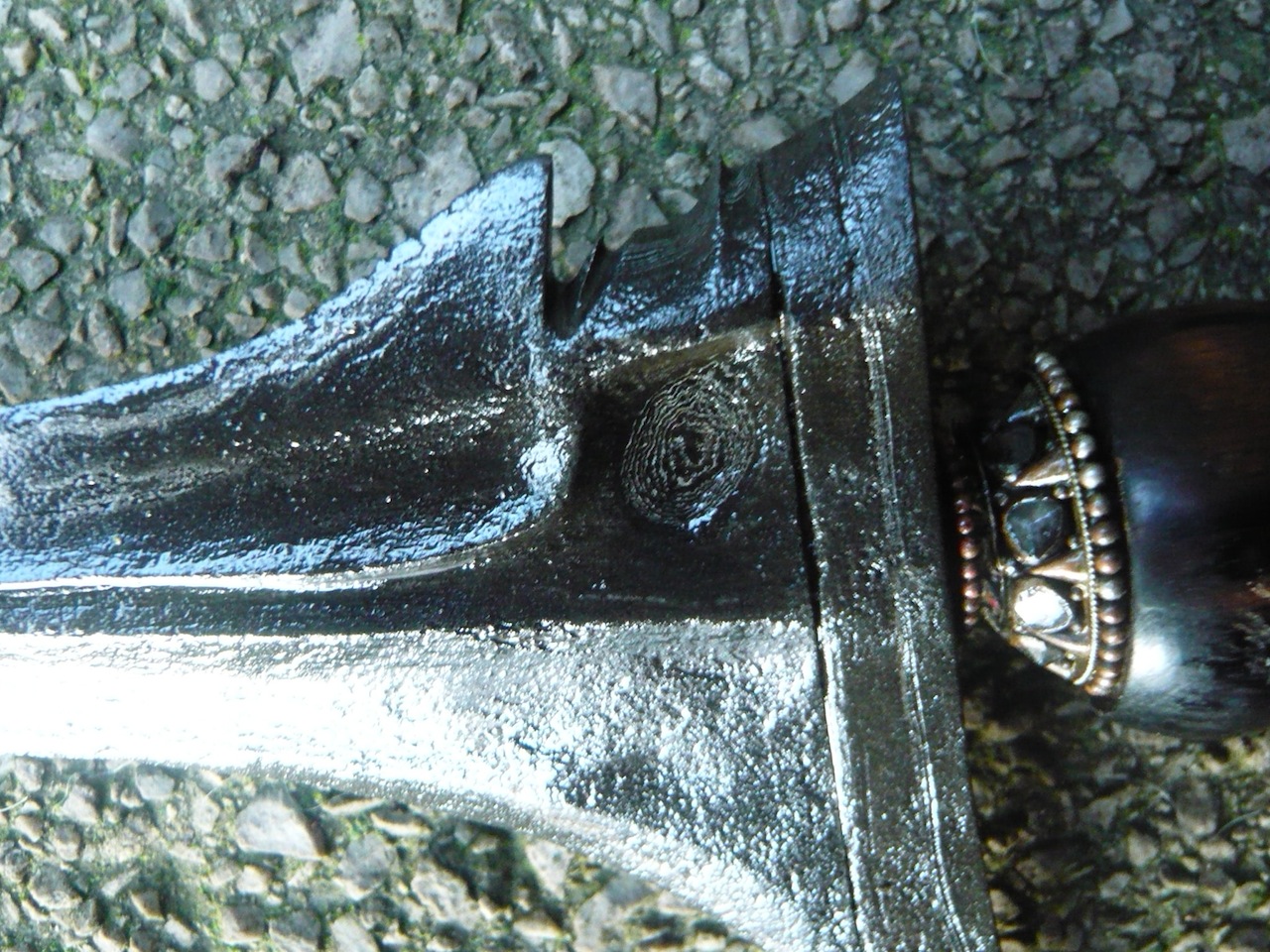

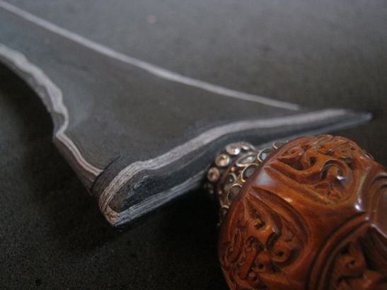

Sorry i missed this first time around. Not only pamor wengkon but also either a Kul Buntet or perhaps Lintang Mas in the sorsoran and a kendit on the gonjo. I like it, even if the sekar kacang has been compromised.

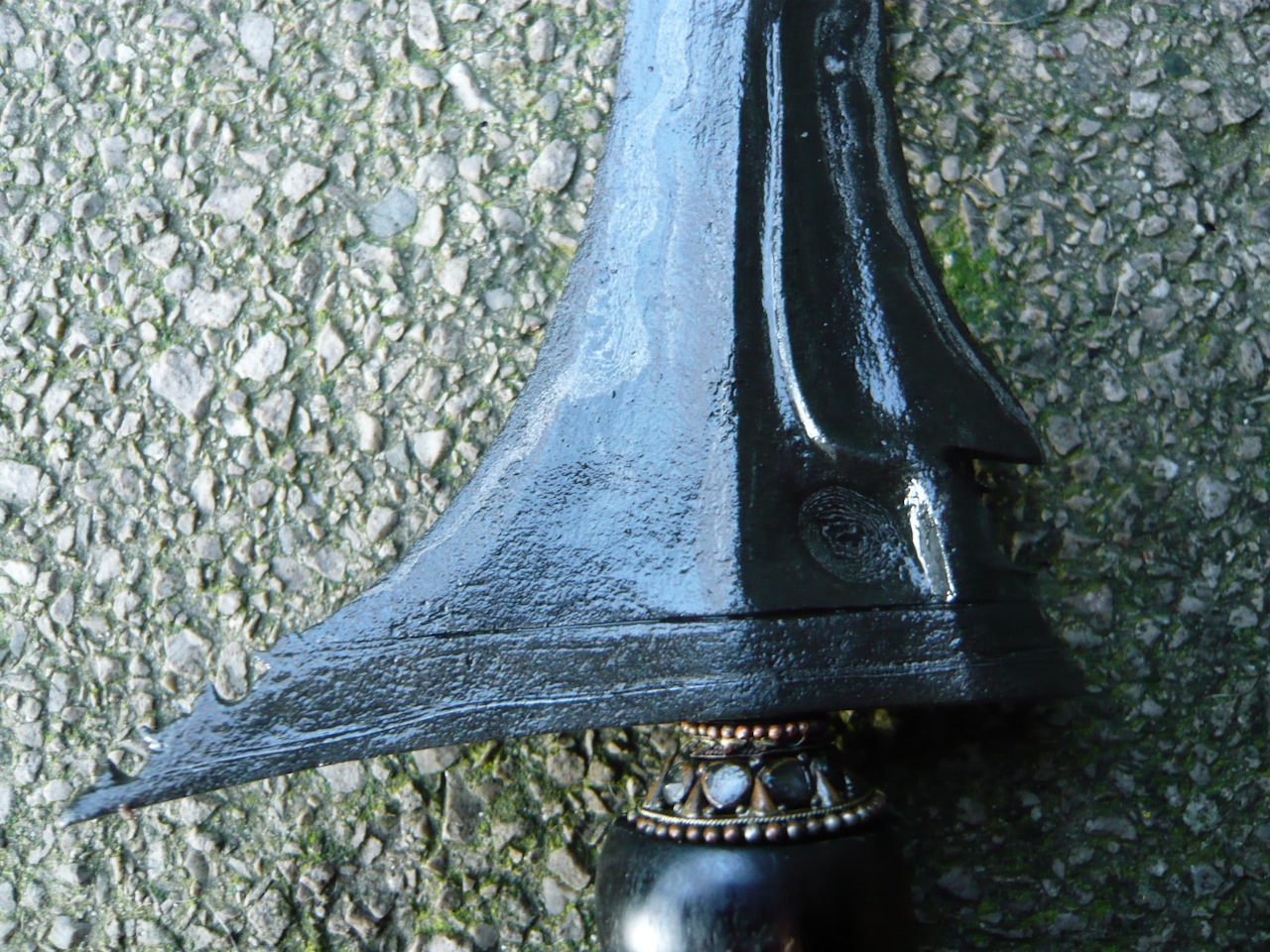

the blade has a mendarang dapur

Nicely controlled Wengkon! Is the kul buntet intentional, or a consequence of the picetan reaching the depth of the white pamor level?

Kai Wee, i would image it is intentional because i have seen a few examples of the combination of kul buntet with wengkon.

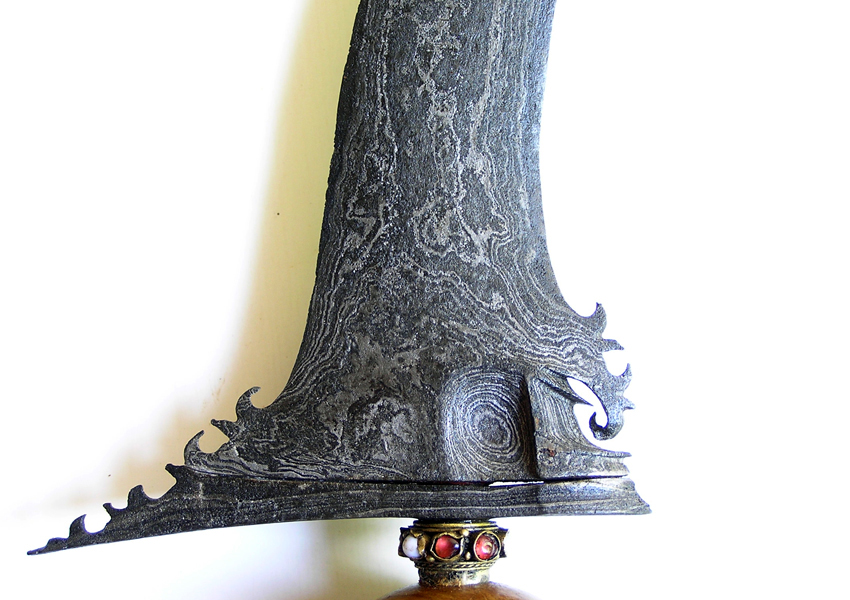

I have strong doubts we can call this feature kul buntet. In "Keris di Lombok" this is described as Rembulan or Wulan Gangsal, or Mata Kolo. Never have seen this on a Javanese keris before.

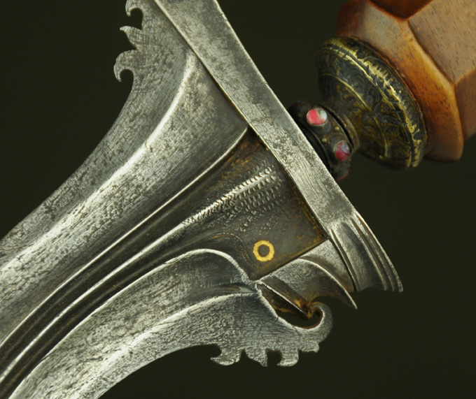

One time as pamor, one as kinatah (or remnants of it):

on the other side the same kul buntel but, IMO,... i LIKE to think ...not intentional!
Really Gustav? I have one. Also Yogyakarta, also with wengkon and also with kendit on the gonjo...

I've seen this effect in the blumbangan in a few keris, I don't know how many, I haven't kept score, but the best example I know of is in a Peninsula keris that is in a friend's collection.
I don't think we can call it a kul buntet, because the kul buntet is a separately forged coil of material that is applied to the blade, this effect shown here in the blumbangan appears to have been created by cutting through layers of pamor, which in itself demonstrates a high degree of skill and beautiful forge control.
If in fact it is a coil of pamor material that has been inserted as a plug into the blumbangan, it would be more correct to call it a puser. Examination under magnification should allow determination of one or the other.

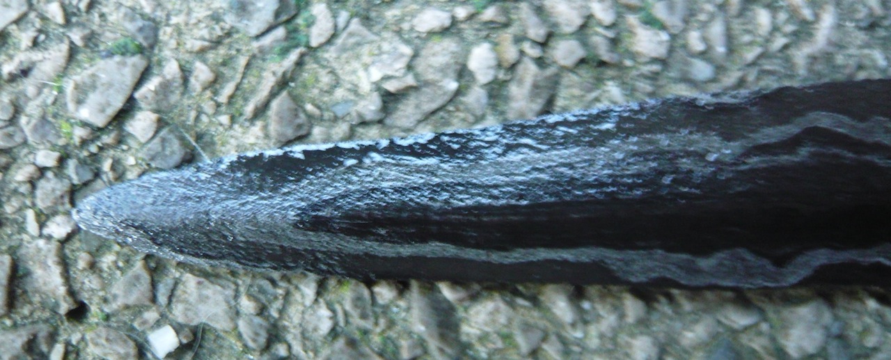

The wengkon is a seemingly simple pamor, but in fact it is one of the most difficult pamors to forge. It is only very, very recently that a couple of current era makers have mastered the production of this pamor. The example shown here is a nice one.
Marco, does the gonjo have a central line of pamor on its top face, as well as its side faces?

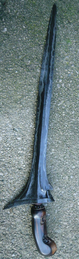

I have a brojol keris with wengkon pamor ..... I hope, can useful to all

As I know it here in Java, this kind of pamor in blumbangan called 'tlaga membeng'. "Tlaga" means lake, (much bigger than "blumbang"= pond/fishing pond), "membeng" is rippling water, the effect you get if you throw a stone in the middle of a lake/pond.
It is a very positive pamor. Some are intentionally made, as Marco's, and some aren't. Those who aren't usually came in Beras Wutah or Pedharingan Kebak pamor.
On Marco's keris, it's made by the precise cutting of blumbangan through the wengkon line. It also need a precise forging so the wengkon line laid where it should.
The best I've seen is a keris with Adeg Wengkon and Tlaga Membeng. Black and shining iron, grey-greenish edge/steel, sharp, white pamor. A pamor lines on each side of ganja. As perfect as if you draw it with a scriber.
Simple pamor, but not simple to make.

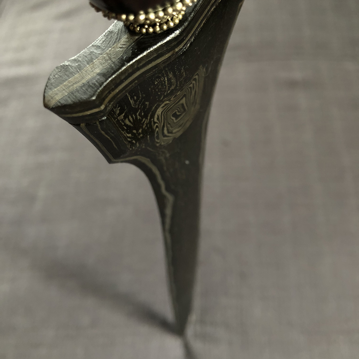

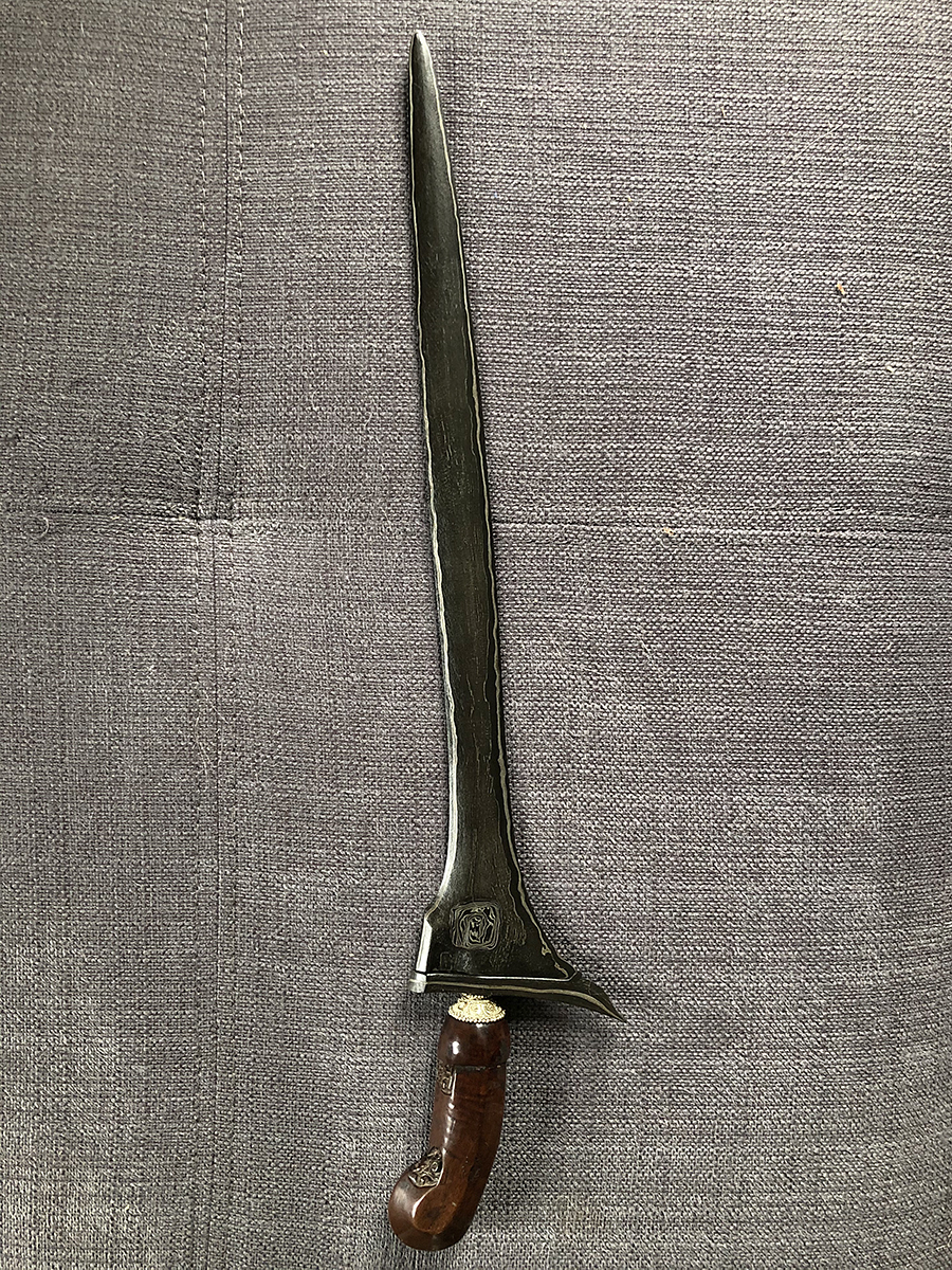

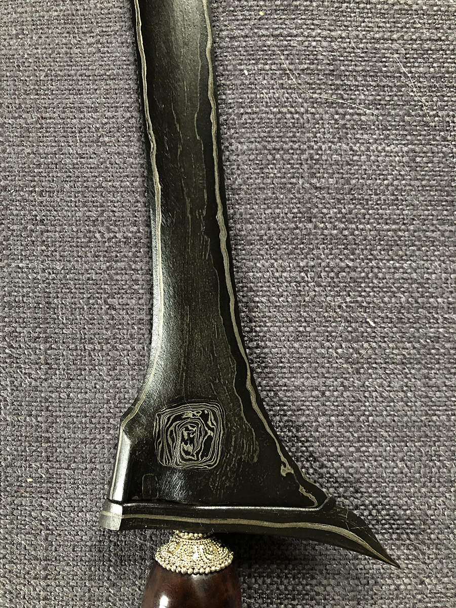

Sorry to revive this old thread, but i was searching for something else and happened upon it and it raised the question in my head. If this pamor motif on this keris is not kul buntet, what would folks be calling it? Thanks!

David, I read this as a square, or at least as intended to be a square, thus it is Kuto Mesir, or Kutu Masir.
In terms of talismanic value it can be regarded as being similar to Kul Buntet, but as having a stronger force.

That is a superb looking keris at #26! Do you have the full image?
SidJ is offline   Reply With Quote
Old 4th January 2023, 05:27 PM   #30
Posts: 7,288
Here you go Sid.
