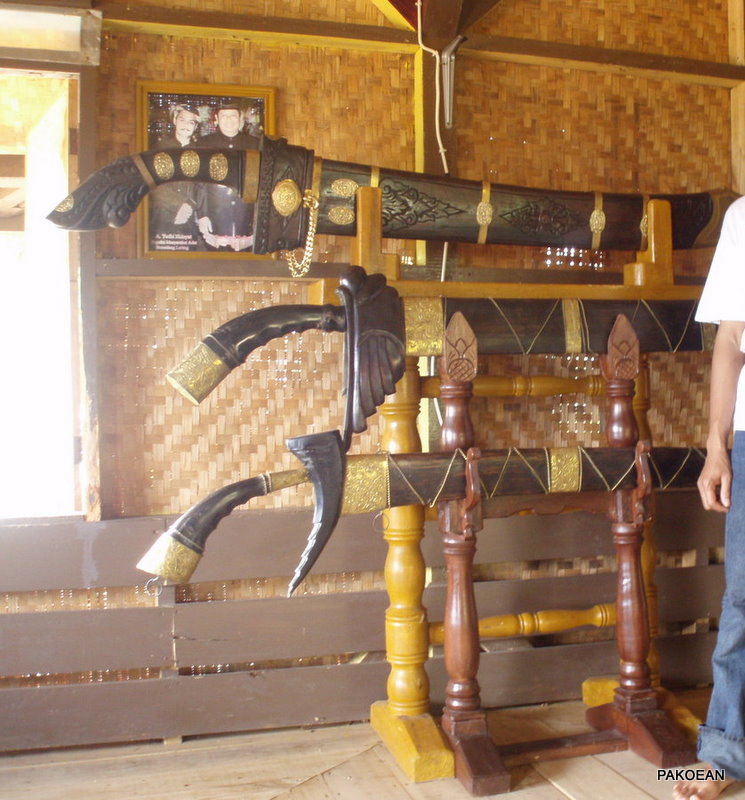

Hullo again Gene,
If the lines are generally slightly jagged and wavy (wanders) like the graph of a recorder, then it's still Soelangkar (as I mentioned previously, history has blurred and today there is a wider definition of the term).
I am assuming that by ripples you mean 'blobs'/'droplets' (even a few concentric ones): as long as the lines are otherwise continuous from base-to-tip of the blade, being only broken in places by these ripples, then it is still a Soelangkar. Only in this case, it's a Soelangkar Toetoel.
Someone may have etched it to ascertain that it was indeed one (usually strong sunlight is enough to do this).
Since the throat is horn, I wouldn't bother with the ferrule.
As for size, have a look at my picture; that's only a five-foot-something standing next to the goloks.
'Soemedangan' means in the style of Soemedang, which is the name of a city, the capital of a Regency of the same name and the name of a previous kingdom, deemed by many as the de facto inheritor of the old Soenda-Galoeh kingdom.
