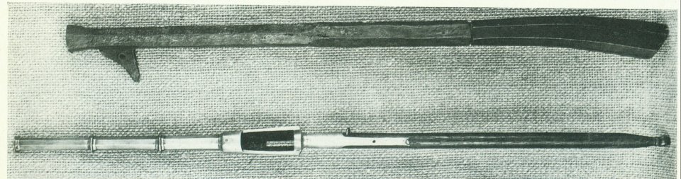

Old 15th November 2010, 08:41 AM   #74
Spiridonov
Spiridonov's Avatar
Join Date: Nov 2008
Location: Russia, Leningrad
Posts: 355

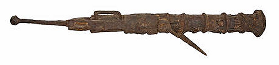

Does anybody have photos of these breech-loading handgonne?
"breech loading handgonne, chamber missing, late 1400's. length 1,460 mm, cal 18 mm "
from
http://homepages.tig.com.au/~dispater/handgonnes.htm
Spiridonov is offline   Reply With Quote

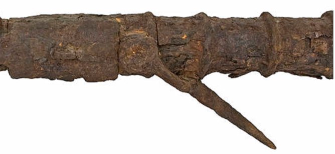

Hi Alexander.
Is this the same thing?
This is included in a PDF document with 186 pages, that i can send you by e-mail, if you are interested.

Old 15th November 2010, 08:55 PM   #78
Matchlock
Matchlock's Avatar
Join Date: Sep 2008
Posts: 4,310
No, 'Nando,
It's another but very similiar item, and your scans are great, thank you so much!
I attach a better image of the gun Alexender meant.
Michl

Old 1st December 2010, 05:37 PM   #85
Spiridonov
Spiridonov's Avatar
Join Date: Nov 2008
Posts: 355

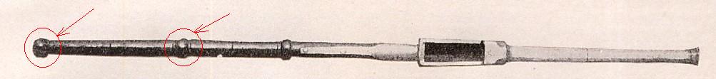

We may see the thickening in the form of balls on these stock. It is a very common element of staffs in XV century.

Perfectly right, Alexander,
Your input clearly confirms the theory I formlerly posted stating that all contemporary works of arts and crafts unanimously reflected the style common to the respective period - in short: Gothic gun barrels generally looked like contemporary architectural towers and columns!
Michael

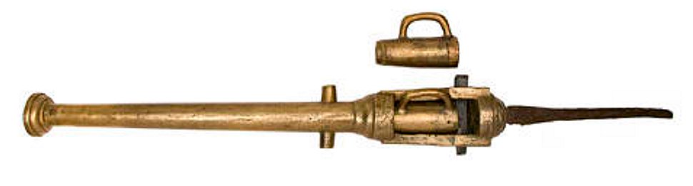

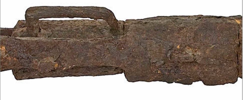

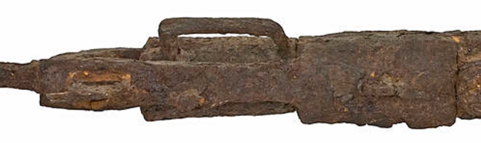

Posts: 4,310

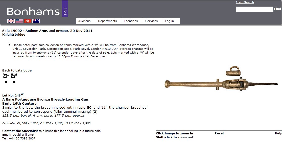

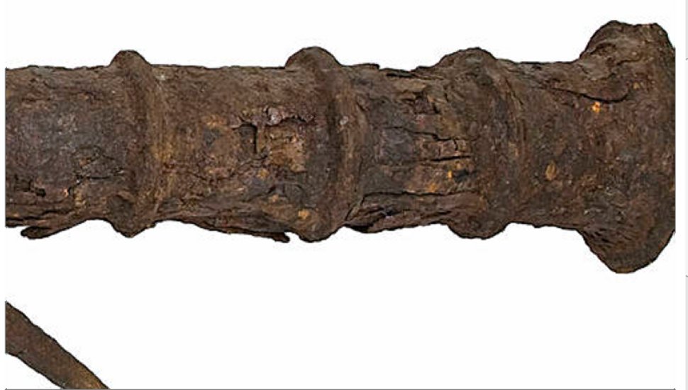

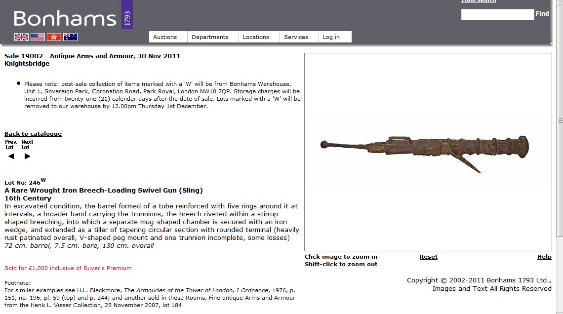

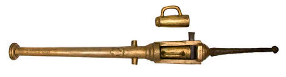

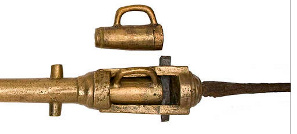

A wrought-iron breech-loading ship cannon, ca. 1480-1500.
m
Old 3rd December 2011, 01:18 AM   #89
Matchlock
Matchlock's Avatar
Join Date: Sep 2008

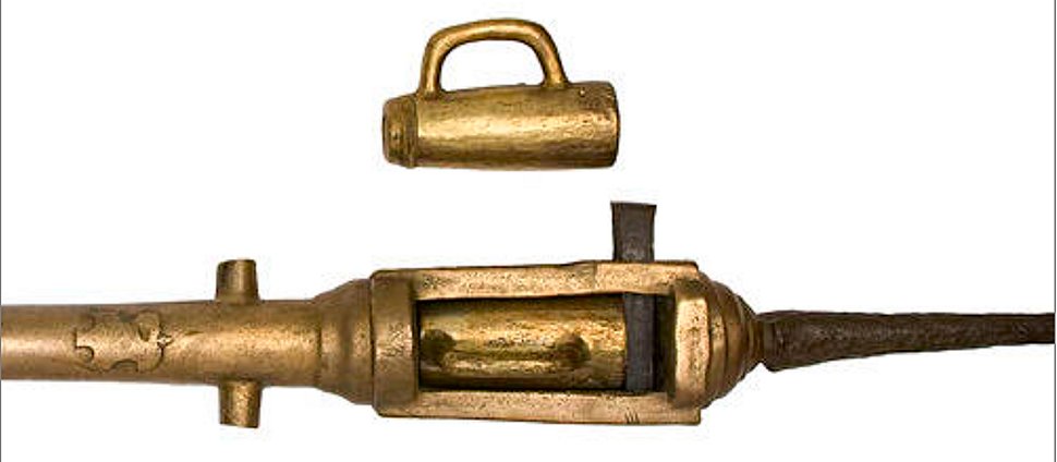

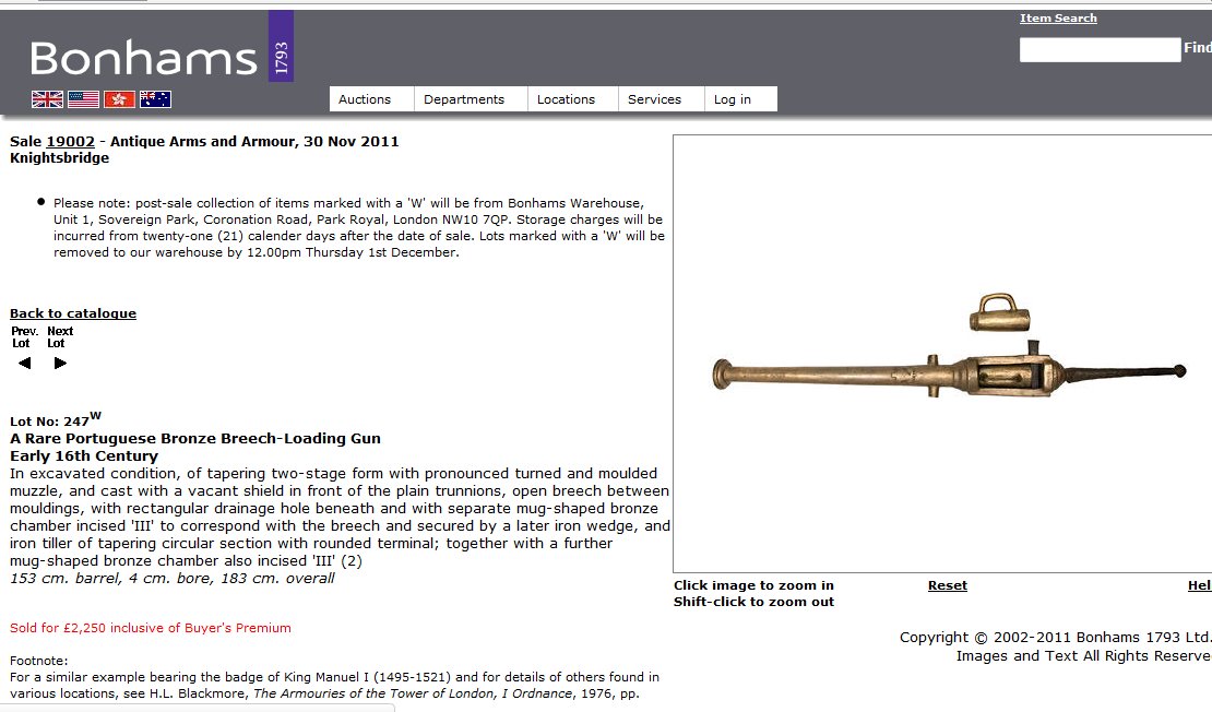

Posts: 4,310
Two Portuguese bronze breech-loading cannon pieces, early 16th c. each, and obviously two from a series.
m

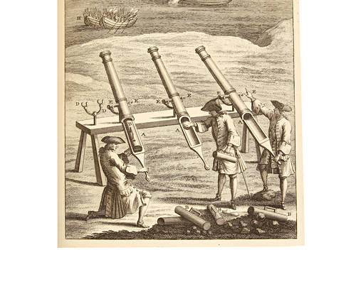

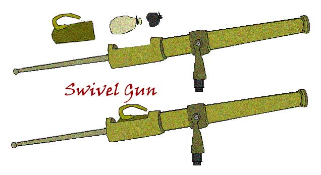

Old 3rd December 2011, 06:02 AM   #90
HERE ARE A FEW MORE PICTURES, HOPEFULLY NOT POSTED ALREADY., TWO PICTURES OF A OLD PRINT. AND DRAWING SHOWING LOAD FOR GUN.
