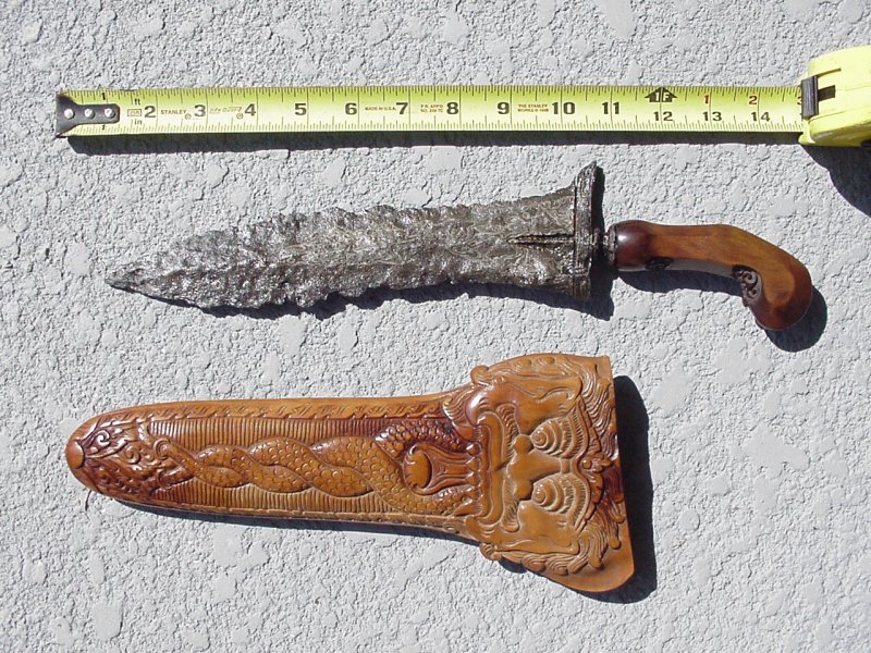

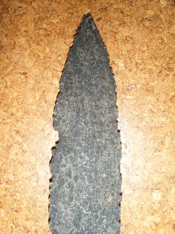

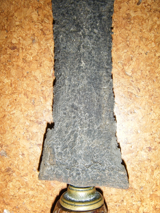

Jean
Here is basicly what they look like. There has been a market for reproductions of this pieces for a long time. Based on the sheath that was provided for this piece I imagine that this was assembled in the 1930's. Normally there was no pamor on the real pieces. This is a giveaway on this one.
Mick is offline   Reply With Quote

Originally Posted by Mick
Jean
Hello Mick,
Thanks, your piece is shorter and sturdier than mine, but it looks "processed" indeed. Some of the pieces included in the book "Keris untuk Dunia" also have pamor, but are still classified as from tangguh Singosari....
Best regards
Jean

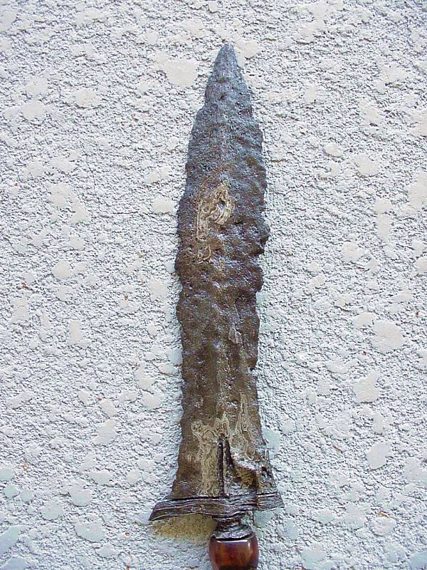

Here is an image of a genuine keris budho.
Mick's image also gives a good impression of what they look like. This example is just under 12" long from blade tip to pesi tip.
However, it is necessary to allow a reasonable degree of latitude in assessing whether a blade is genuinely a KB or not.

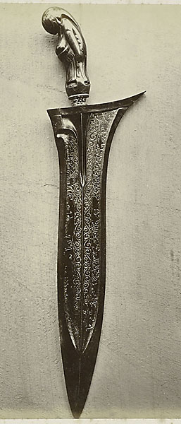

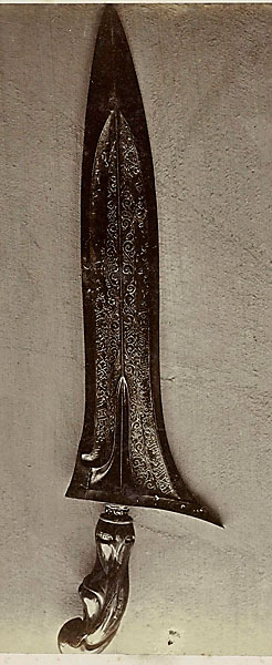

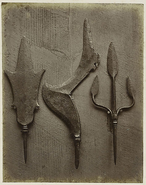

Additionally, I am of the opinion that production of blades in the budho form continued well past the Early Classical Period, and probably they were still being produced into the 16th-17th centuries, a period far too early for production to occur for reason of the deception of "tourists" and collectors.

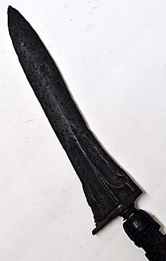

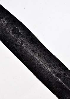

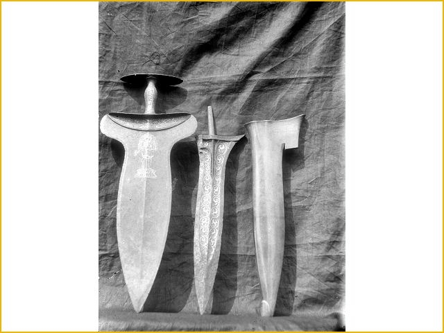

Here are pictures of an islamic era Keris Jalak Budho. They were taken by one of the most important early photographers in Dutch East Indies, Isidore van Kinsbergen, in 1863/1864. The description says "A kris with arabic inscription (steel and gold) from Garut" (West Java). It seems to have a polished surface, like many keris in old european collections.There is also a picture of lanceheads, which probably look recent (for 1863), which means they were still produced in such forms at this time.
High resolution pictures are to be find here:
http://www.geheugenvannederland.nl/?...:1403-3790-37B
http://www.geheugenvannederland.nl/?...unt=1&wst=kris
http://www.geheugenvannederland.nl/?...wst=lanspunten
You really can go into the details blowing them up.

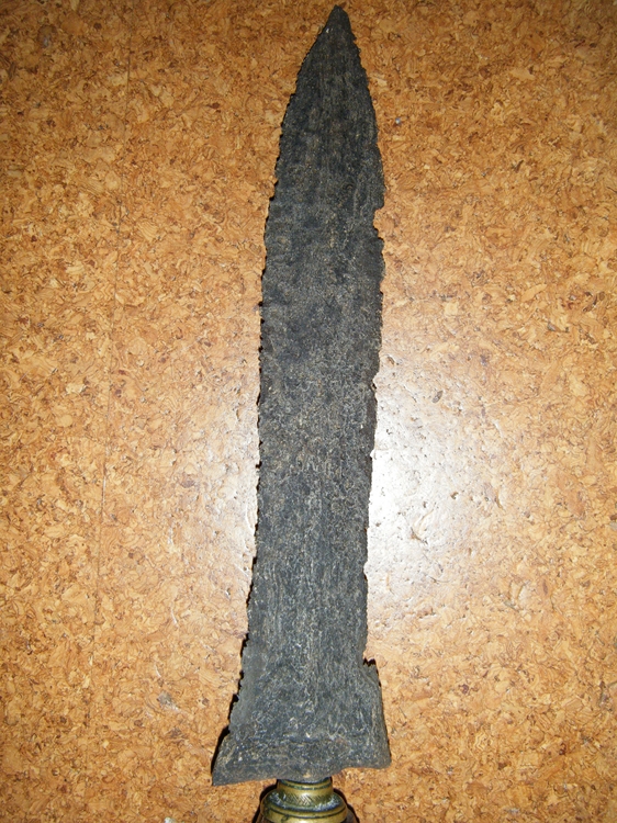

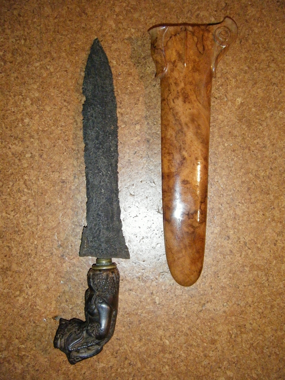

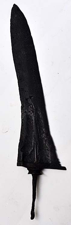

What do you think about this one?

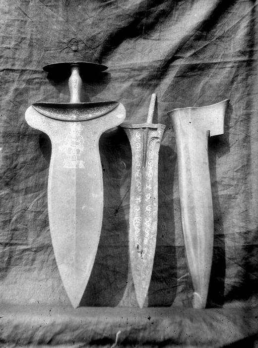

Tunggulametung, thank you very much for the interesting picture. I have darkened it a little bit to see better the details. It comes from Pagerrujung, half way between Semarang and Pekalongan, Central Java.

Gustav, I think it is belong to Pagaruyung palace of West Sumatra, if I remember correctly there's another version of the keris photo taken in a ceremony but I can't find it.
I attach another similar example below

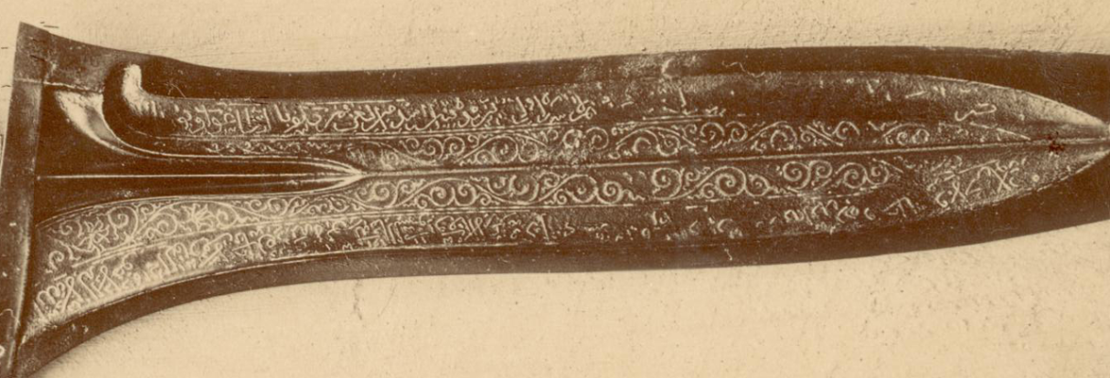

Hi Amuk,

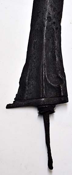

Here's the close-up of that particular blade. I'm not sure if it says La Iqraha Fiddin on the blade..

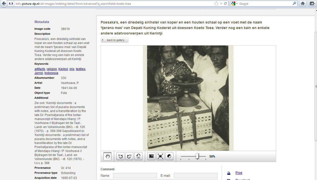

Tunggulametung, the description from Tropenmuseum says Java Tengah. Thank you very much for the other picture!
http://collectie.tropenmuseum.nl/Def...px?ccid=322401

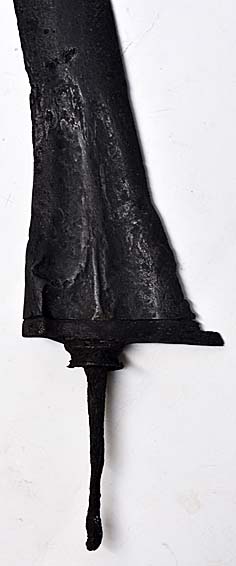

There is also a picture of the other side of the blade:

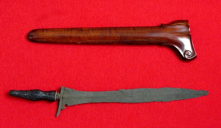

I seem to immediately recognise the first picture as part of my family's heirloom collection,which are still looked after in our Ciburuy, Garut compound.
As for the keris, it very much reminds me of another heirloom looked after at our Cinunuk, Garut compund. If the inscription in Arabic reads (Latinized): "Laa Iqroha Fiddien", then I am sure of it.
Amuk Murugul, may I ask you a question regarding the heirloom of your family please:
is it passed on as Warisan (inheritance), or is it a Pusaka?
