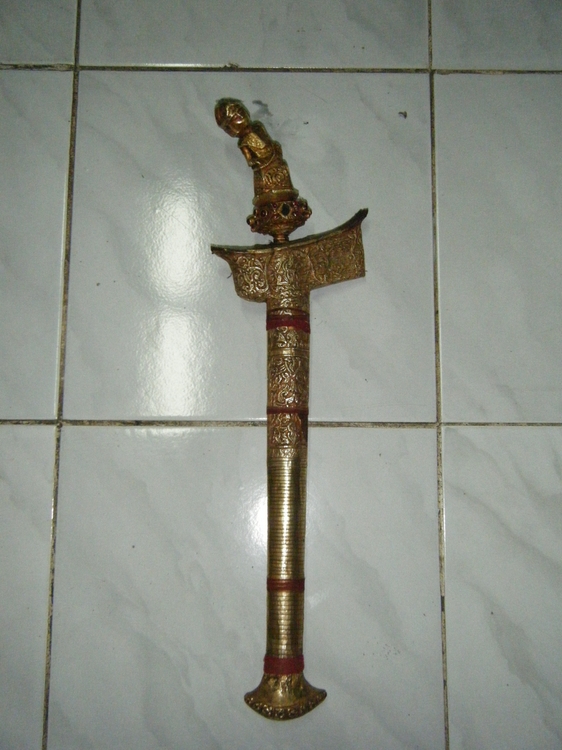

Old 7th December 2010, 09:43 PM   #43
Marcokeris
Marcokeris's Avatar
Location: Italy
Posts: 928
In my post i wrote (toraja ?) not (toraja).
The keris of my post is a keris that, I SUPPOSE, could have been used (sorry for my bad english)in CEREMONiES . For ceremony i think: great moments in the life of a person.
I liked the keris only for the dress/hit of the blade... not for the blade that is ,of course, very very simple.
About the blade i saw, in my past, other similar keris with, really, beautifull gold saronsg/hits but... the blades were always very very simple .
Maybe in Sulawesi there are very good sarong workers but not so good keris makers...i don't know.
About the pic from the book i scannered i put here a similar tau tau pic

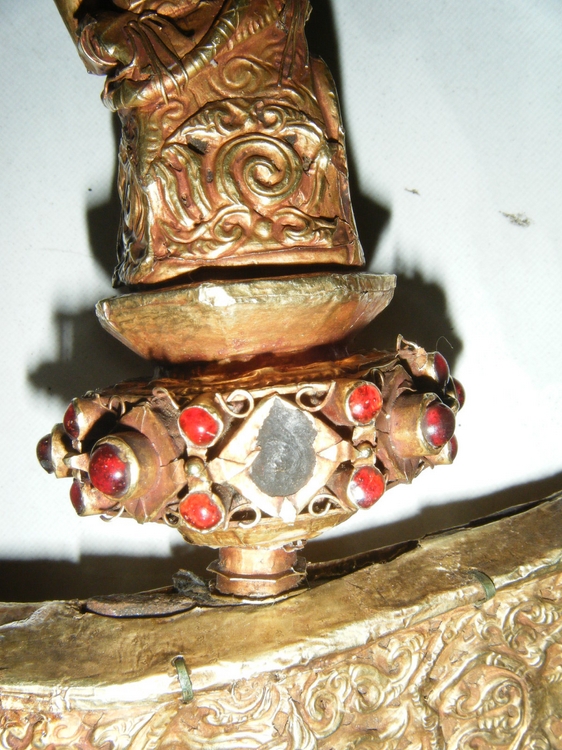

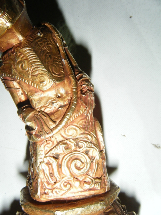

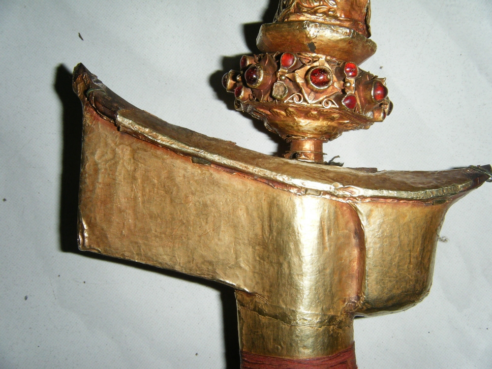

Old 30th March 2011, 07:31 AM   #49
Posts: 7,230
This morning my wife and I visited the friend I mentioned in post # 38.
I asked her why it was that when we see pictures of Toraja gatherings and a keris is present, it is now almost always with a woman, rather than with a man.
Does this mean that for Toraja people the keris is not now a male symbol and if so, was it ever a male symbol for Toraja people?
I did not know it before this morning, but apparently this woman comes from minor royalty, so I am assuming, I hope correctly, that what she has told me has some element of accuracy in it.
The full conversation used a couple of hours and we were given lots and lots of irrelevant information, but the essence of her answer in respect of keris was this:-
1) In times past, perhaps in her great grandparent's time, the keris was identified with men, because men were the hunters and the warriors.
2) In the present day the keris is recognized as a part of cultural inheritance, but it is no longer the specific preserve of men, no longer associated directly with men, but where it is an heirloom, a pusaka, it is associated with the family. Within a family it might fall to a man, or to his wife to look after the keris, and if it is worn, it is mostly worn by the woman as a dress ornament that is associated with culture. Nothing more.
3) In her own family, and in most other families that she knows, the last two generations have not passed on any of the knowledge of culture and family history. She is of the opinion that WWII destroyed the continuation of culture and that independence and the entry to modern times helped, because the old people saw that the younger generations were not interested in what had come before, so they did not try to teach them, but if a question was asked, only then would they answer.
4) As things stand right now, the only people who truly understand the culture are specialists and people in universities. In a normal family the family keris has become just an ornament that is used sometimes in traditional dress.
This woman has lived in Australia for about 20 years, but she spends three months every year back with her family in Torajaland. She appears to be completely in touch with the present day situation there.
She knew absolutely nothing of the esoteric side of the keris as it applies in Jawa and Bali
Old 14th October 2011, 08:07 PM   #50
Come across by my last trip to Indonesia again a Toraja/Gowa keris of lower quality but obviously very old or at last heavy used. I wasn't able to buy it (what I would like to do ) but I get the permission to take photos and to show them here. Enjoy!

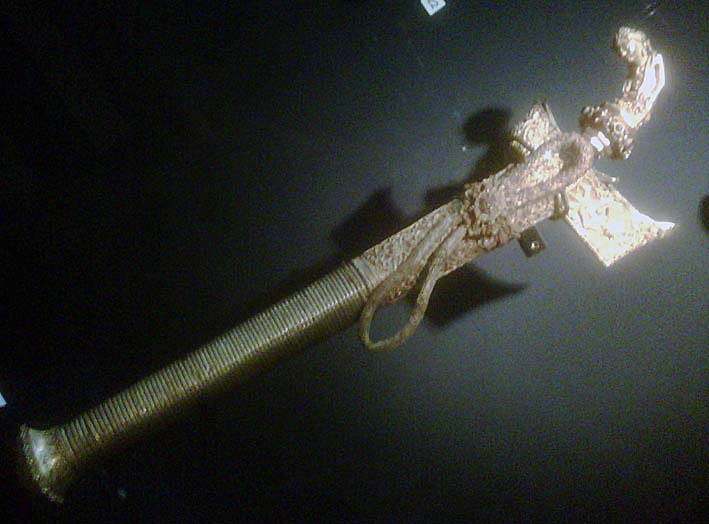

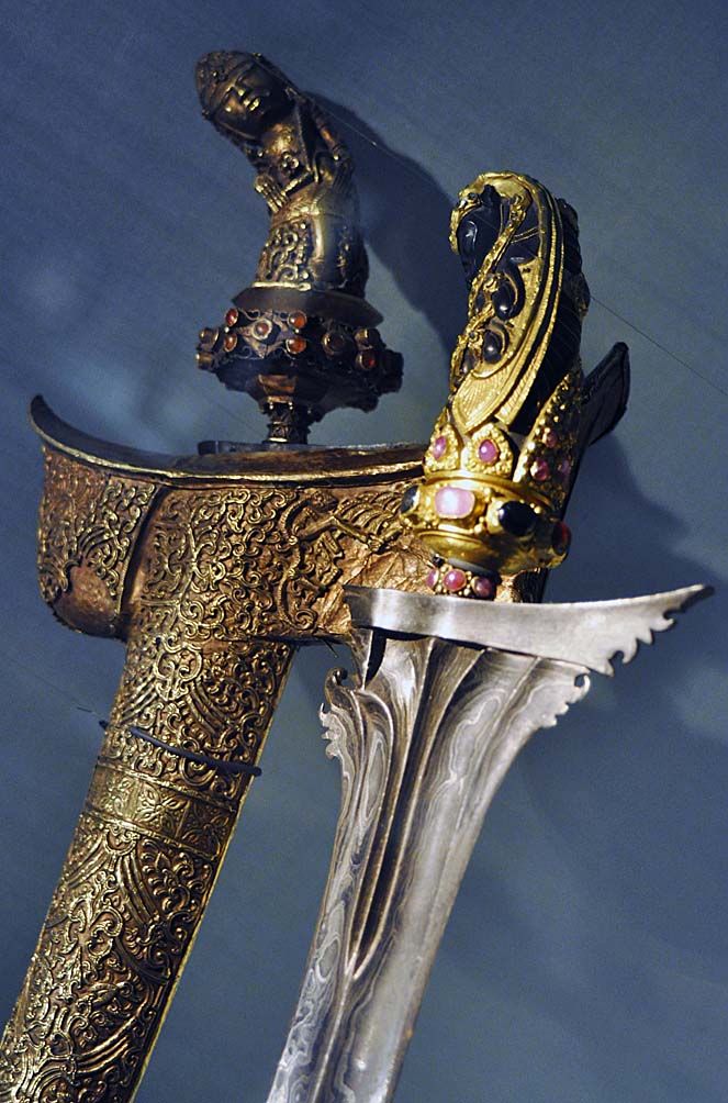

Late sharing on Marco's thread. I have some pictures of kerises from Kesultanan Bone of South Sulawesi or known popularly as Kesultanan Bugis too. You may compare the style of these images on Bone keris, with "pangulu tau tau" (human head hilt). These were the Museum Gajah's collection, the National Museum of Jakarta...
GANJAWULUNG
Old 17th October 2011, 04:29 AM   #54
ganjawulung
ganjawulung's Avatar
Join Date: May 2007
Location: J a k a r t a
Posts: 991
This is also Museum Gajah's Collection on Kesultanan Bone's keris, taken from BlackBerry cellphone...
