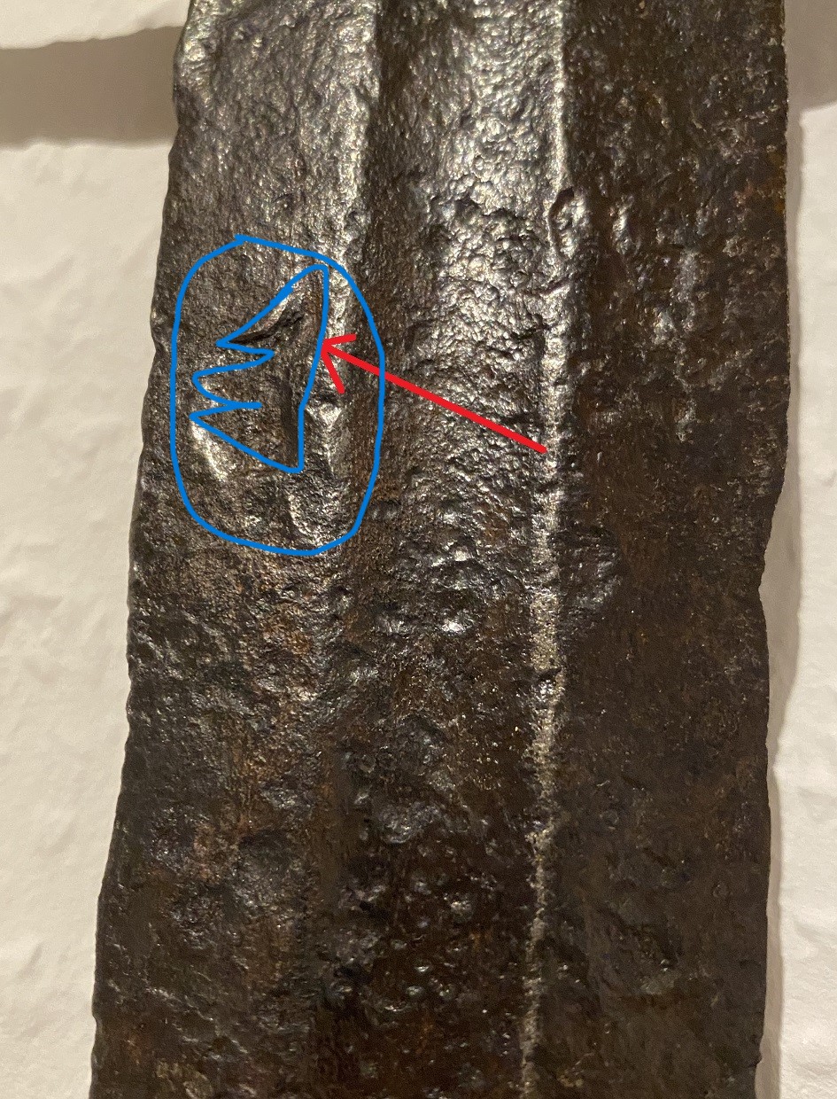

Hello Andreas,
Regarding the less dense inclusions inside the pommel: You forgot to flip your red markings when viewing the other side of the pommel. Could you post corrected pics, please?
Old 9th March 2024, 07:55 PM   #32
AHorsa
AHorsa's Avatar
Join Date: May 2014
Location: Rhineland
Posts: 393
Hello Andreas,
Hi Kai,
I reflected / flipped (hope that is the correct translation) the picture of the other side of the pommel. So it should be fitting correctly.
Kind regards
Andreas

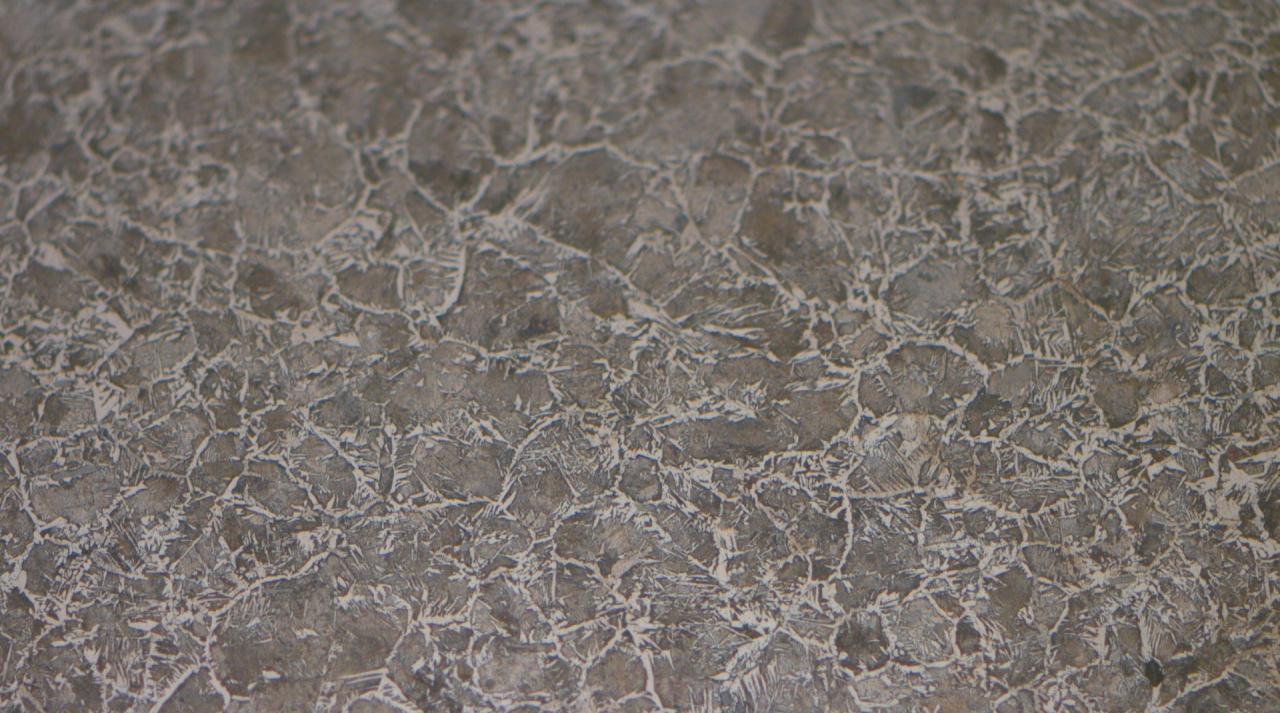

Metallographic examination:
A section of the surface was cut (polished and etched) and examined micrographically. It is bloomery steel with a medium carbon content. The number of slag inclusions is rather low -> high-quality steel was used. No evidence of hardening could be found at the examined site. This is the rule rather than the exception for medieval swords. The Widmannstättsche structures indicate overheating during forging

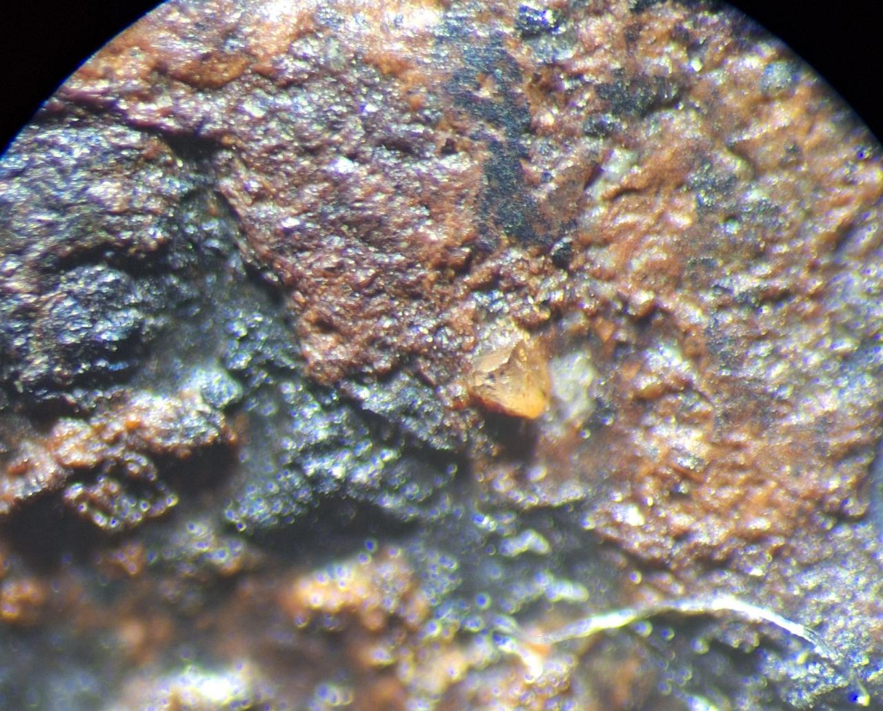

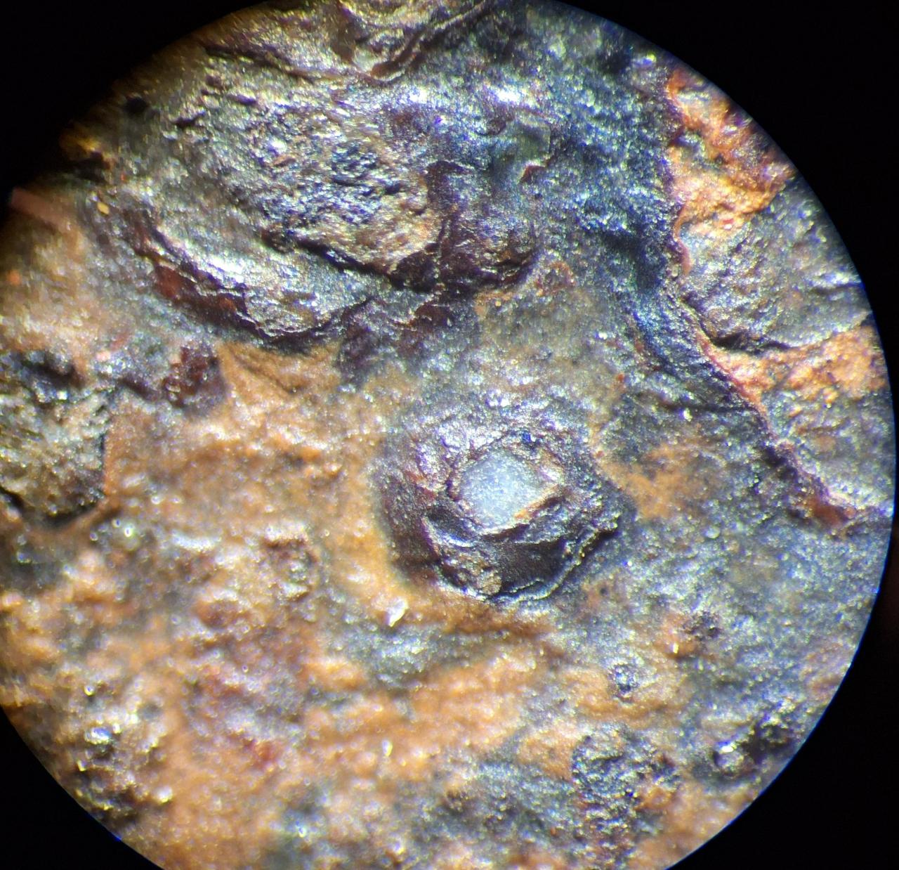

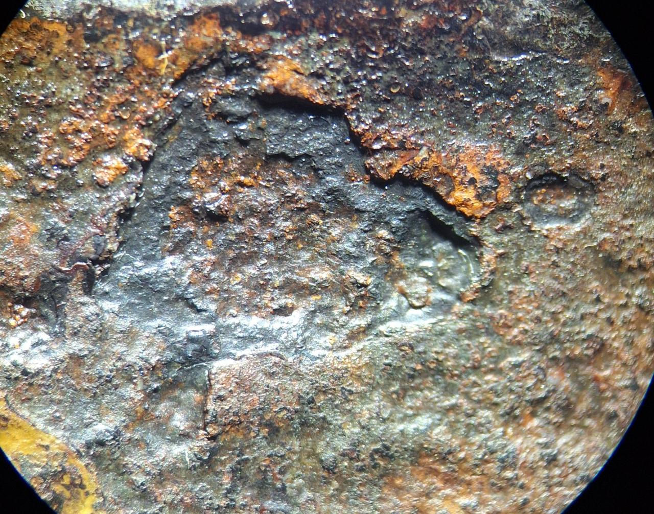

Microscopic examination of the corrosion layers:
Optical microscopic examination of the corrosion surface reveals clearly defined, multi-phase iron mineralisation, which is characteristic of wrought iron artefacts that have been stored in the ground for a long time. The structures observed consist of a complex composite of different iron oxide and iron oxyhydroxide phases. These phases occur in a heterogeneous, clod-like and laminated texture, which was created by repeated oxidation and reduction cycles within the corrosion crust.

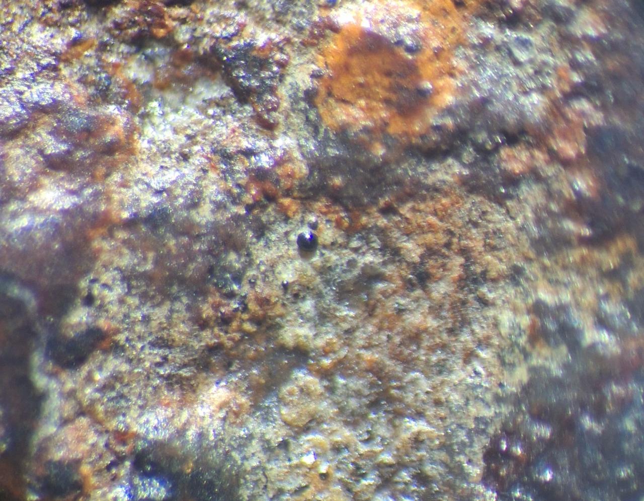

In some deeper areas, mineral deposits in the form of tiny grains of sand were found.

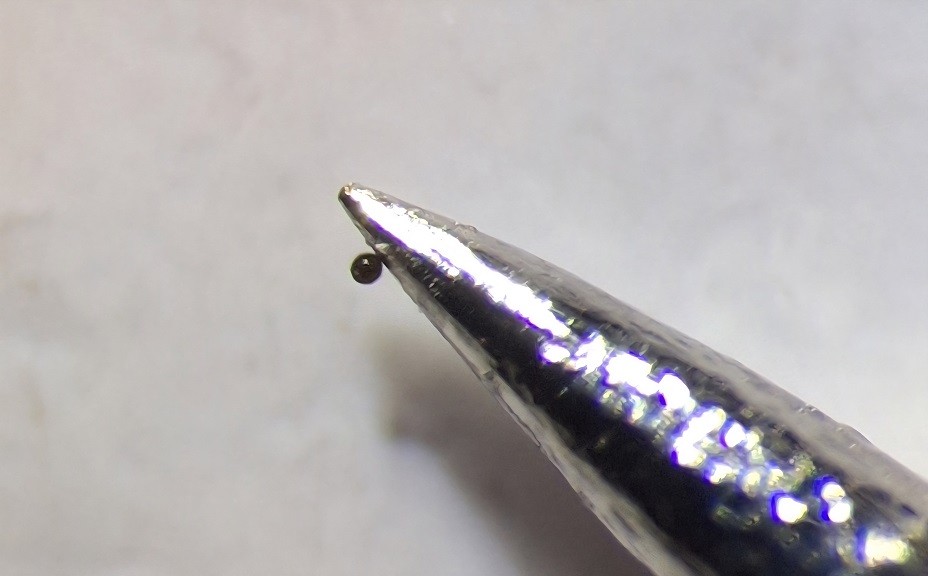

Occasionally, microscopic black, glass-like beads could be identified. They are located in rust craters and are not magnetic. These are most likely molten slag inclusions that have been exposed by the corrosion of the surrounding material.
The corrosion layer(s) and their structure differ significantly between the blade, tang, pommel and crossguard.
Attached are some pictures of the findings described above.

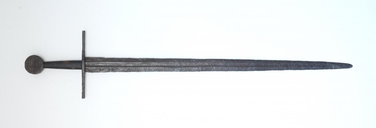

Inspired by Lee´s sword, I attached a (removable) grip to give it back a bit of its originally appearance. Atteched an image.

Ewart Oakeshott would surely have approved of your grip reconstruction! It looks nice and also lets you "feel" the sword in your hand as a sword.
