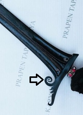

Default Meaning in a Balinese keris
Hi fellow members, anyone knows what does this symbolize where the arrow is pointing? Is this consider keris Ligan and who usually owns such keris daphur? Priest?
photo copyrighted of the owner.

According to the book "Keris Bali bersejarah" page 74, this is supposed to depict a cock comb? However your specimen is much more spiralling than in the book picture.

I thought i remembered either reading or being told that this form of gonjo was indeed reserved for priests, but i cannot find the reference point at this moment.

Keris ligan is also known as "Keris Pedang", it is a form of keris with a warrior association.

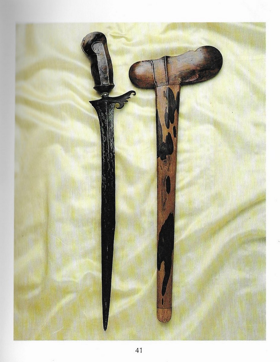

The first time I saw a similar treatment of the greneng to this one was in Mario & Vanna Ghiringhelli's Little Red Book --- the original "Invincible Keris". This keris was a cengkrong style and the caption stated that keris with this blade style, ie, cengkrong, was worn by preachers & scholars of religion & theology.
Note:- blade type, not gonjo type
The first time I saw a keris with this extremely exuberant spiral ornamentation to the greneng was in the courtyard of a very well known Balinese m'ranggi and keris dealer, it was a recently made Madura keris, and it was hanging from the exposed framework of a small pavilion. When I asked why it was hanging there, along with a large number of other newly made keris I was told that all these keris were there to permit them to age naturally.
I have not seen this type of gonjo ornamentation in an old keris, only in recently made ones.

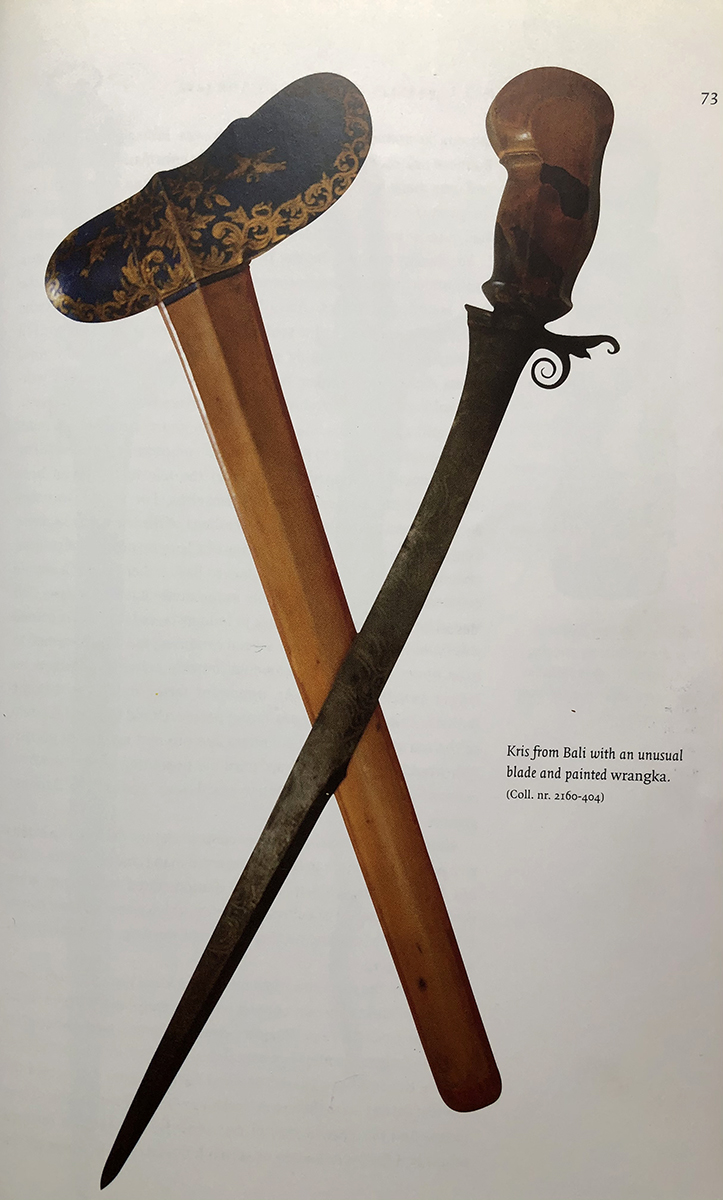

Thank you Alan, and I attach the pic of the kris in question from Mario & Vanna G.
Ha ha, RIP Wayan Ritug! I agree with you that the kris from Anthony is most probably a recent creation.

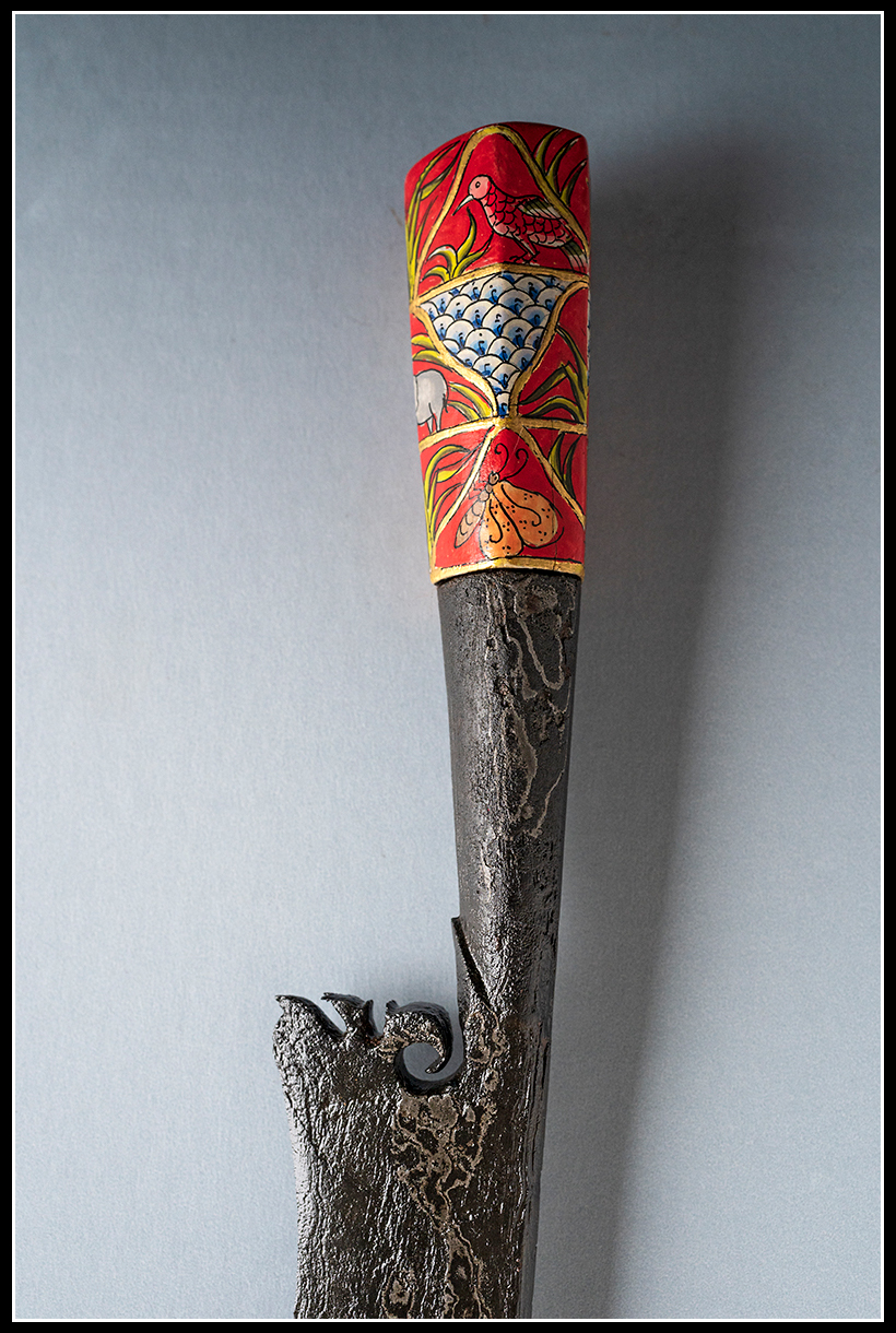

The first time I saw a similar treatment of the greneng to this one was in Mario & Vanna Ghiringhelli's Little Red Book --- the original "Invincible Keris". This keris was a cengkrong style and the caption stated that keris with this blade style, ie, cengkrong, was worn by preachers & scholars of religion & theology....
Alan, i suspect you may indeed have seen this greneng treatment before that and forgotten, on page 73 in David van Duuren's book The Kris. I suspect you have this book and i am fairly certain it came out well before the Little Red Book.
While it is difficult to be sure of a single image printed in a text it seem most likely that the keris shown in van Duuren's book is indeed at least 19th century.

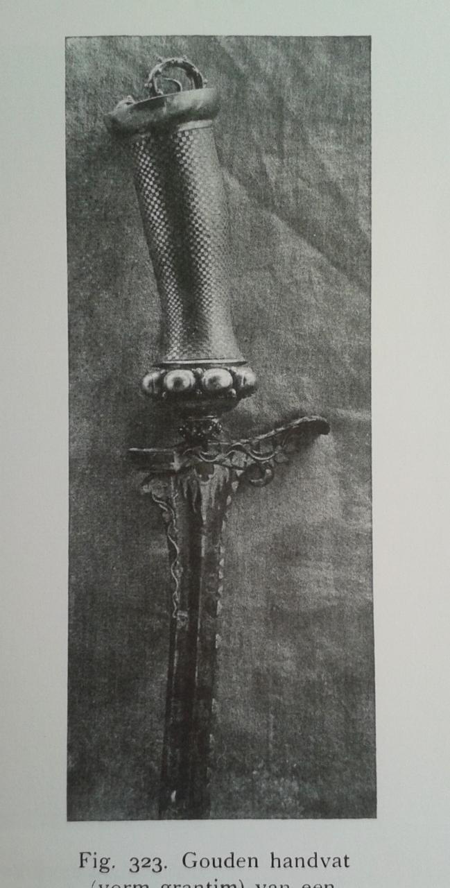

Here is the example from van Duuren's book The Kris.

It was donated to the Tropenmuseum in 1952.
There is a Balinese Keris with the same type of Gonjo depicted on Jasper&Mas Pirngadie, Vol. V, p. 229, Fig. 323. The Volume was published in 1930, but the materials for it were collected already before 1920.
We encounter the idea of such Gonjo also on a Javanese Pedang with Gonjo, which is certainly antique and a heirloom.
