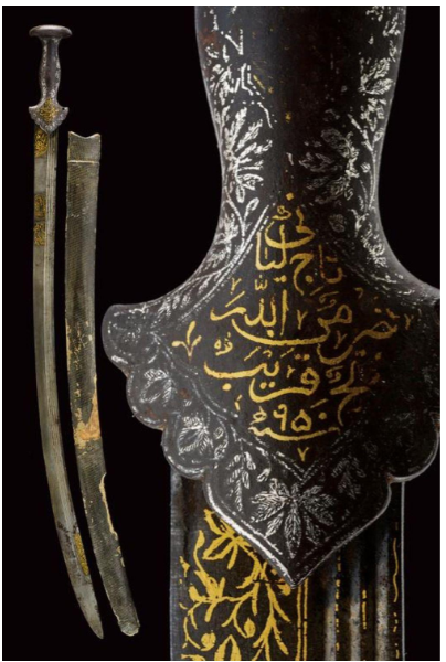

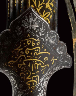

Usually, there is a major difficulty to attribute bladed weapons to Deccan Sultanates.
But here is an unquestionably Deccani tulwar, also sold by Czerny's for 3400 euro + the usual 30% fee etc.
The inscription clearly identifies Jamsheed Quli Qutb Shah of Golkonda and the date 1095H ( 1543) is exactly the year of his coronation.
The quillon block is strange: I tentatively think about Chinese influence. Any opinions?

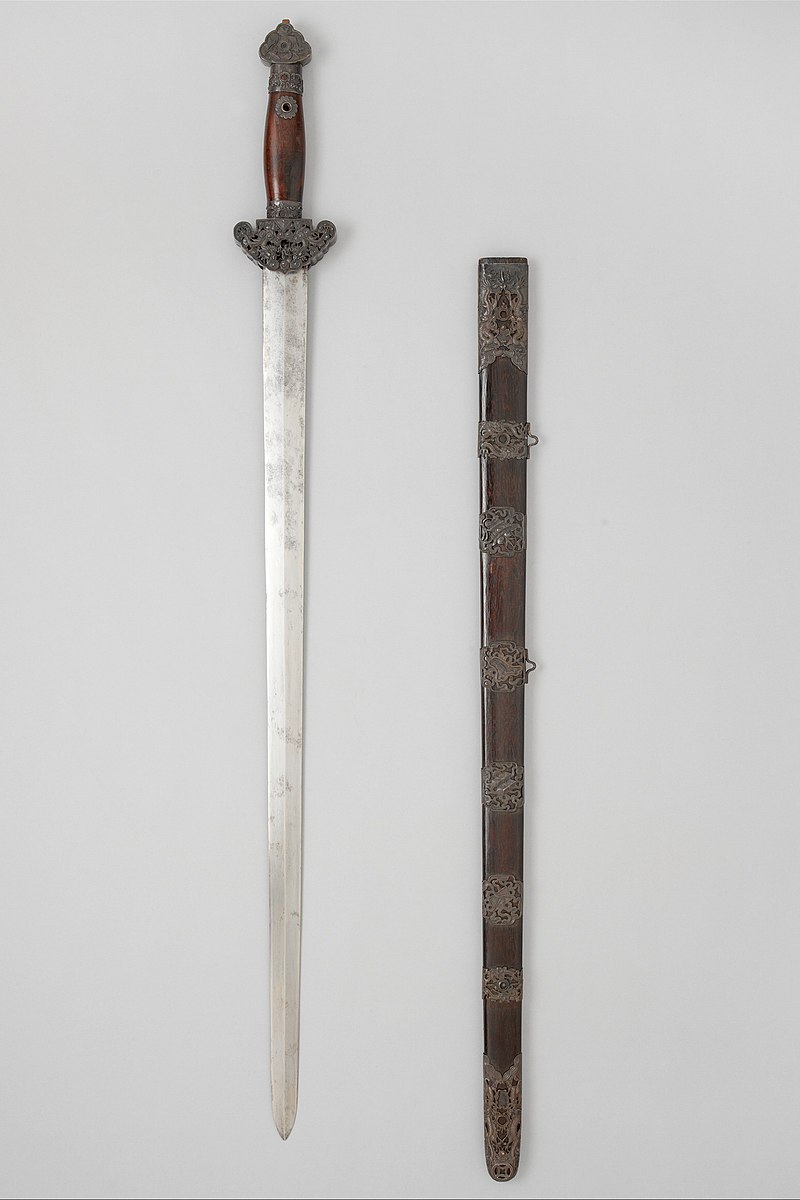

While there is a degree of similarity or feel of the Chinese jian, it seems more to align with the khanjhar dagger in the same manner many full size swords have resemblances to dagger forms in similar contexts.

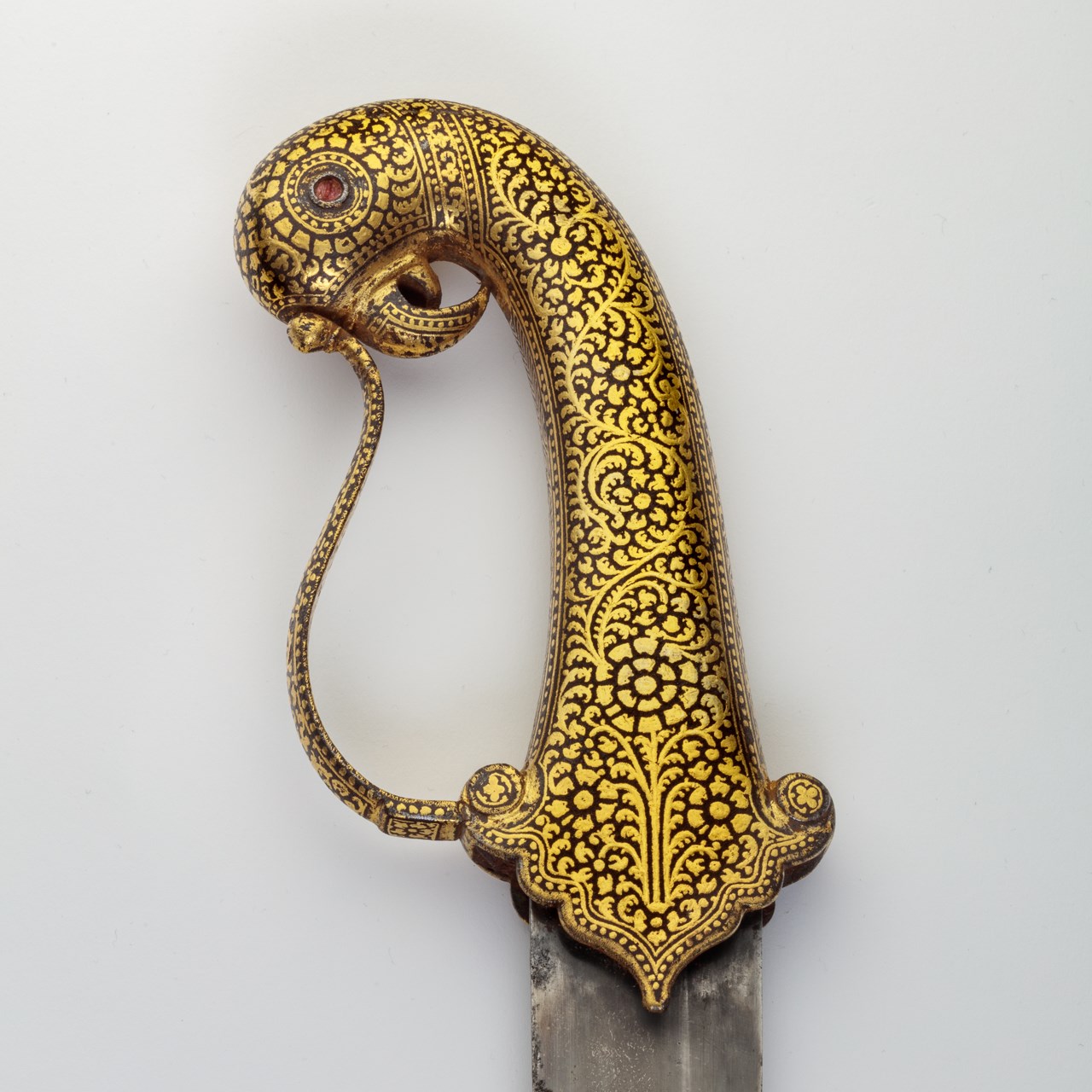

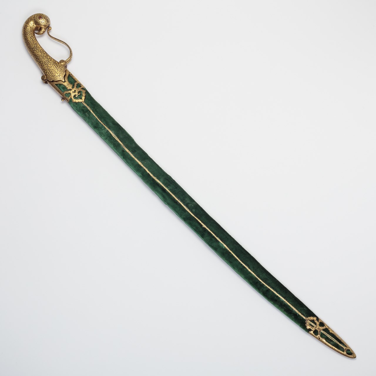

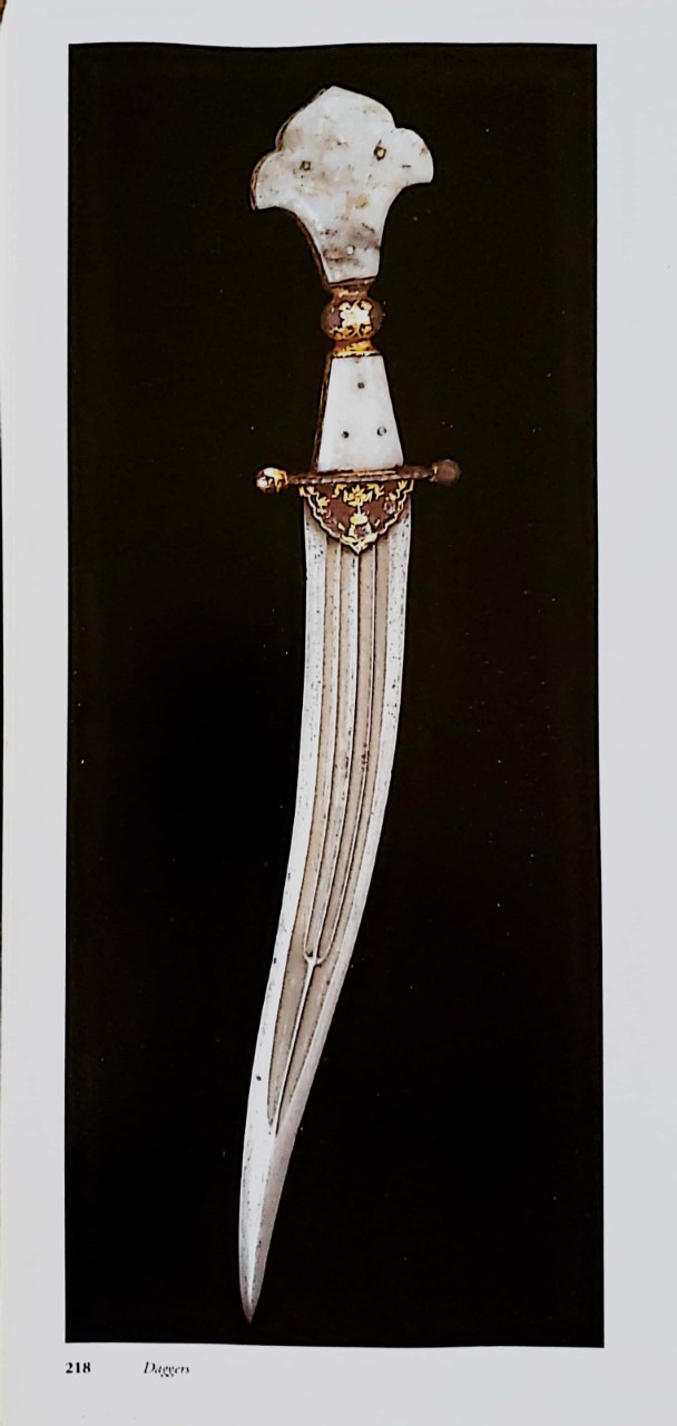

Attached Deccani khanjhar : from "Arts of the Muslim knight",(2008) #209
late 16th c.
Chinese jian, online Wiki
Tulwar, personal coll. attributed to Deccan, shamshir form hilt
blade British M1788 light cavalry, poss. EIC.
Koftgari added .

Conversely,

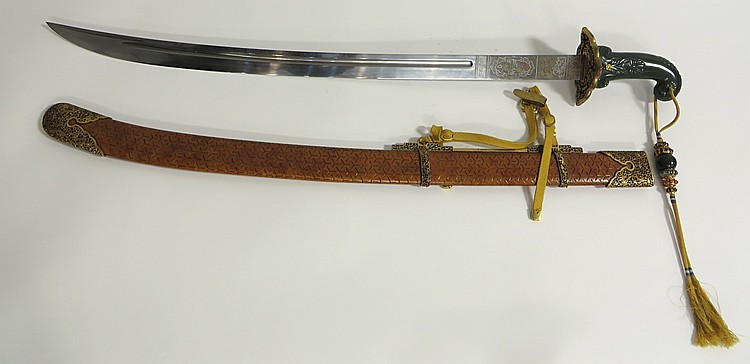

Here is a Chinese sword with 'parrot head' style hilt in jade,;late 18th c. The Qianlong emperor (1735-1796) had an affinity for 'foreign' styling etc.

There was no direct influence of Chinese culture to Indian one in the 16th century, only indirectly through Iran and Central Asia. If something of Chinese appeared in the Deccan, it first had to appeared in Iran.
In the 18th century, jade hilts were sent from India to China as court gifts. In China also tried to copy them, but such items were very different from the Indian originals.

Posts: 379
As a result of the war of 1791-92, Nepal became a vassal of China and was obliged to pay an annual tribute. Trophies captured in Nepal form an important part of the Qianlong Emperor's collection. It also includes Indian-made items.
