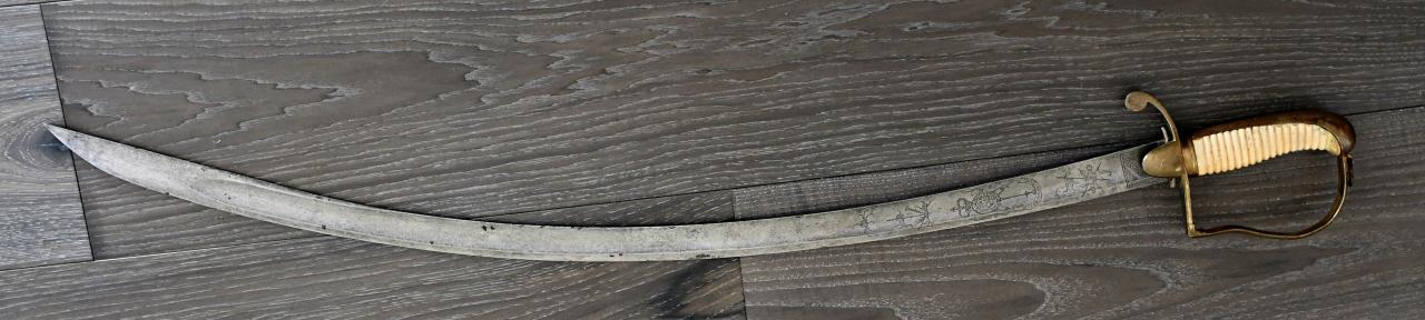

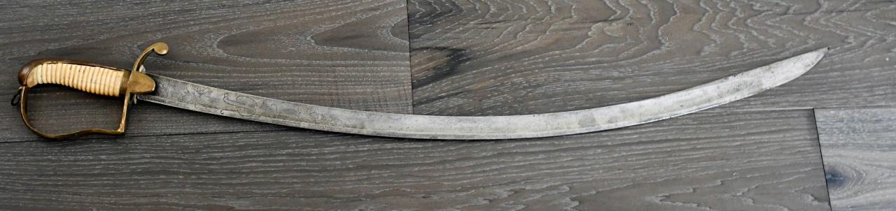

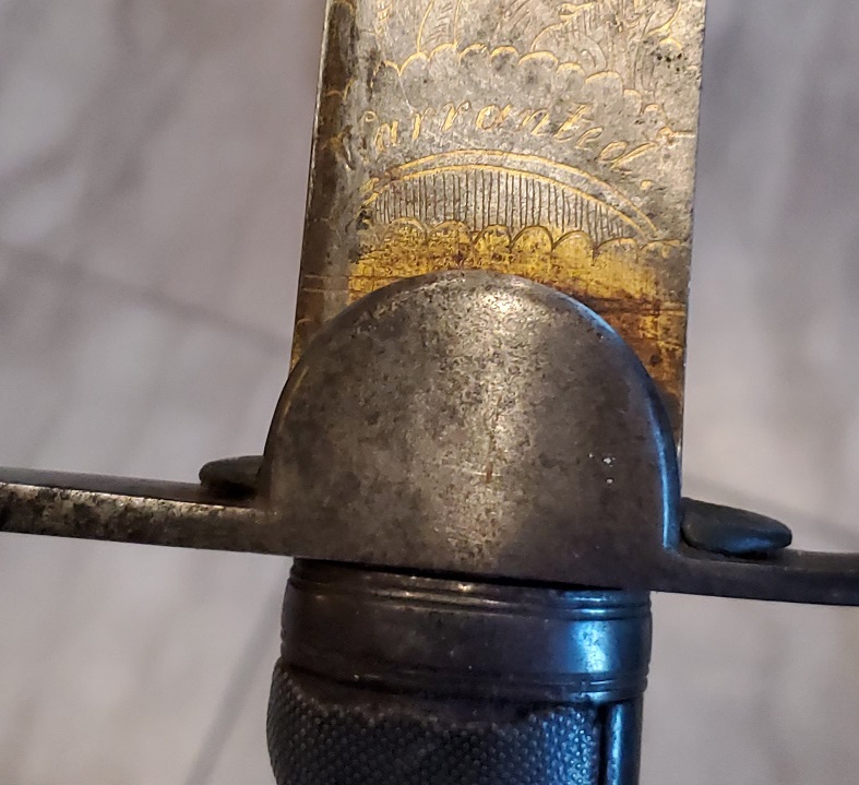

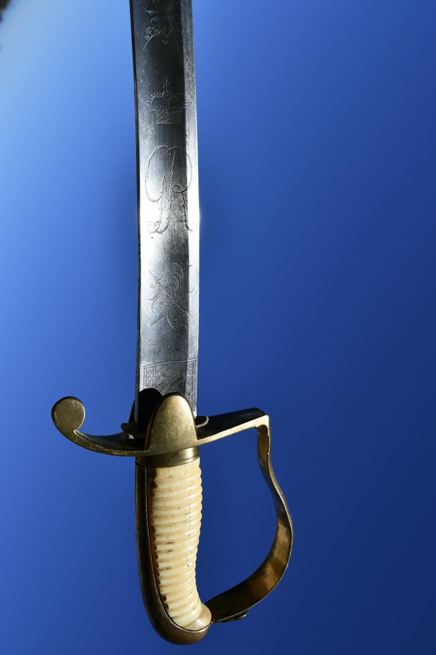

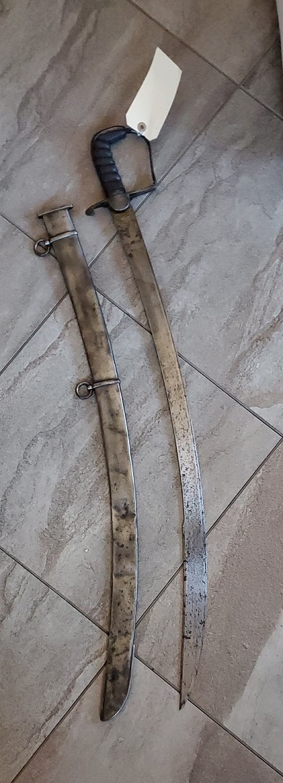

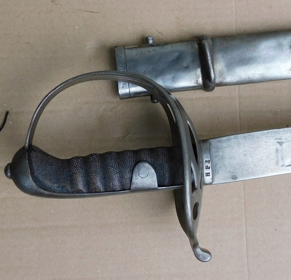

This saber of M1796 light cavalry form seems British of course, but it seems unusual in having been gilt bronze, ivory grip, and a strange fixture on the guard which seems to be to hold a sword knot.
When I see hilts of this character in this period I think of naval officers, knowing that often they favored cavalry sabers, though there is no evidence of the fouled anchor anywhere.
What do you guys think?

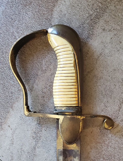

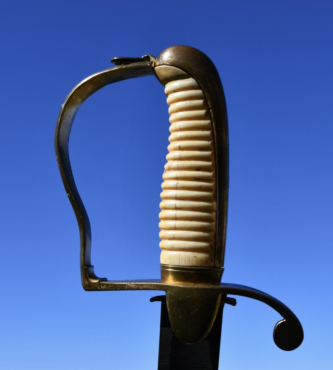

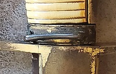

...the (quote) "strange fixture on the guard, which seems to be to hold a sword knot" .
he did, but it's not obvious. It's a 'staple'-like fitting on the bolster in the grip photo.
...and yes, better in your Euro forum.
Gold plating and white grip w/o the stirrups, presumably from a large grey African mammal, which for our purposes I will call a 'Walrus tooth', leads me towards a custom private purchase officer's model. I guess he didn't like using the slot near the pommel for some reason. Possibly fashion, or maybe it flopped about less if knocked out of his hand (Aboard ship? )

This is an officers saber of the stirrup hilt M1796 style and appears British, though the squared sword knot fixture on the guard apparently for sword knot seems unusual.
It seems to have been gilt bronze hilt with ivory grip which always seems to suggest naval to me, though there are no fouled anchors apparent anywhere.
This does not automatically exclude naval use, and naval officers often seem to have followed cavalry patterns in fighting swords.

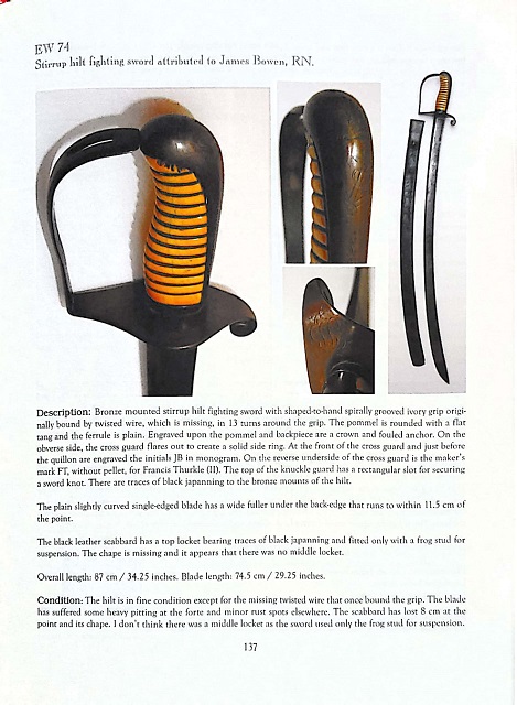

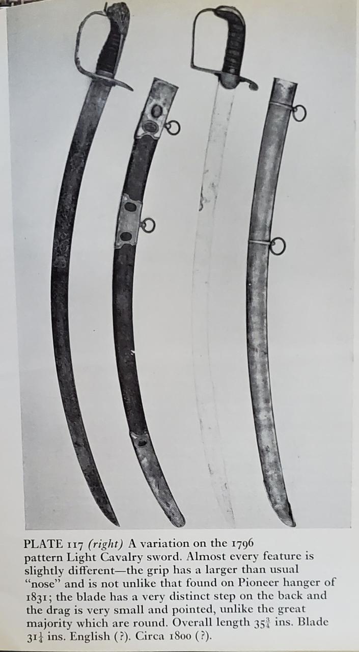

I have attached a similar example from "Naval Swords & Dirks", Sim Comfort, 2008.
I would very much appreciate comments, especially on this curious fixture for sword knot which is different than anything I have seen. The gilt is mostly gone, as is the bluing and gilt motif on the blade.
In "Naval Swords", P.G.W.Annis, 1970, on p.43 (#24) is another similar example, which shows the typical manner of showing the sword knot,in the traditional manner.
As these had become decorative and in many ways status oriented, possible this 'side mount' made for better display of the often highly embellished knots Note that gilt brass was keenly preferred by officers, and they preferred longer blades than the usual hangers or small swords as noted in 'Annis'.
In remarks on this example he notes that when the M1796 cavalry saber was introduced, these were quickly copied by naval officers, and by 1805 a regulation pattern of the type was introduced.
These types with the 'birds head' pommel same as cavalry were likely the early and privately commissioned officers sabers prior to the 1805 pattern.
A nice, high-grade, standard Georgian British officer's sabre is about all that can be said of it. Some general rules of thumb can be followed, such as the gilt hilt is more likely to be infantry/naval than cavalry, and curved sabres are more likely to have been carried by the 'Flank officers'.
But ultimately, with the prevalence of all the militia, volunteer and yeomanry units at the time, plus, with the habit of officers to 'do their own thing', without a solid province or identifying engravings, it is impossible to know what branch of service the original owner came from.
The lanyard 'ring' on the furrel is a common variant seen on 1796 Pattern light cavalry officers' sabres, with other another type being an integral part of the guard, extending out next to the langet.

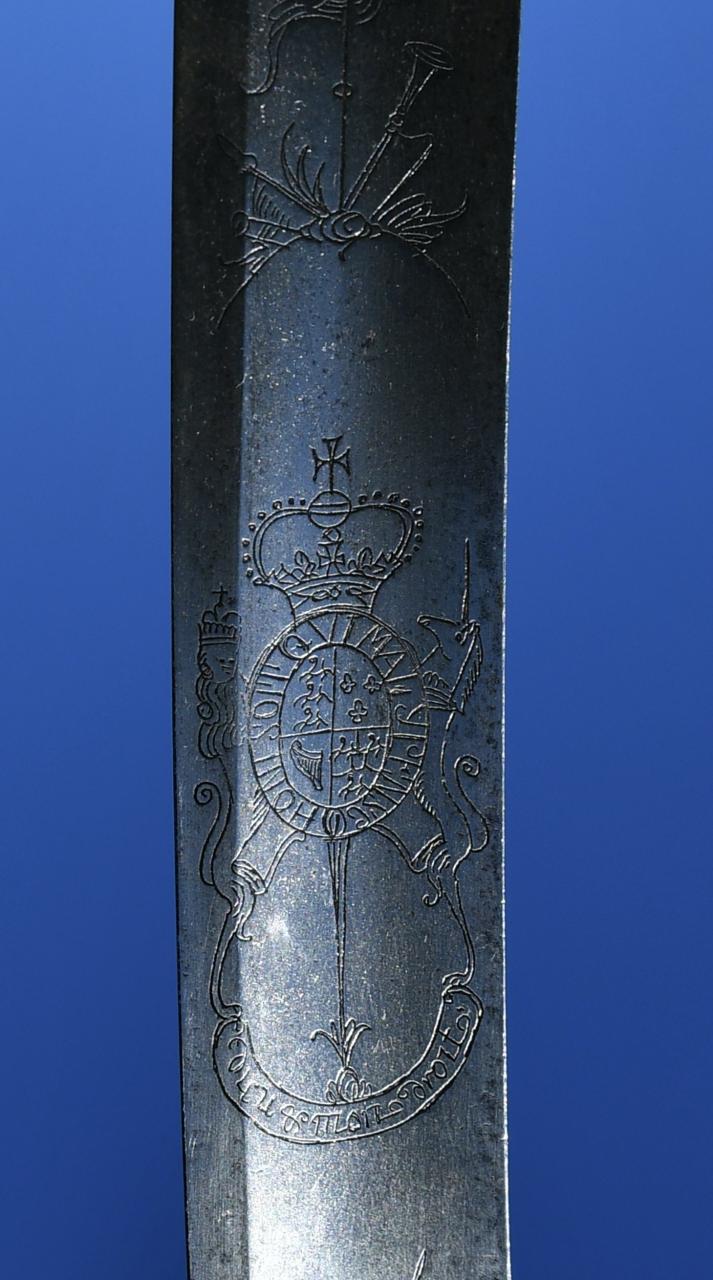

It would be nice to see more of the blade markings from Jim's sabre, but from what I can see, they look similar to the ones supplied by J J Runkel. If true, this would date it to pre-1808.
This is one of my 1796 Pattern light cavalry Officers sabres, by Orsborn dated to pre-1800, with the same lanyard loop.

1796p swords with brass hilts are commonly described as yeomanry officers swords. The sword knot loop is not uncommon. I would not go so far as to say it's naval though could have been used by that branch on an individual basis.
I think the ivory = navy notion is just another of those misconceptions created by early collectors and then spread by less-than-scrupulous dealers looking to cash in on a "navy premium".
It's a nice sword Jim. Is it still in your collection? Do you have the scabbard, and are there any manufacturer's marks on it?
I agree, there are many 'notions' in the collecting game, and the dealers poured gas on those fires to cash in just as you say. As with most cases of items whose provenance has been compromised, and we can only speculate the true character of the weapon, that status must remain standing, speculative.
As agreed, officers had carte blanche in the swords they commissioned, and fashion was extremely competitive so anything was possible. From what little I recall when I got this back in the 70s, I thought it was probably yeomanry as it was so different from most cavalry forms, but honestly cannot recall details.
I still have it, but not handy to examine presently, these photos are it for now. It did not have a scabbard. When I can I will get to it unless there are more photos.
I am hoping with this thread we might see 'cavalry' sabers of the M1796 form with ivory hilts. Clearly ivory was used on the mameluke sabers but cannot recall any of these stirrup hilts with it. Also, that curious sword knot fixture on other examples......that example on your Osborn is most telling.

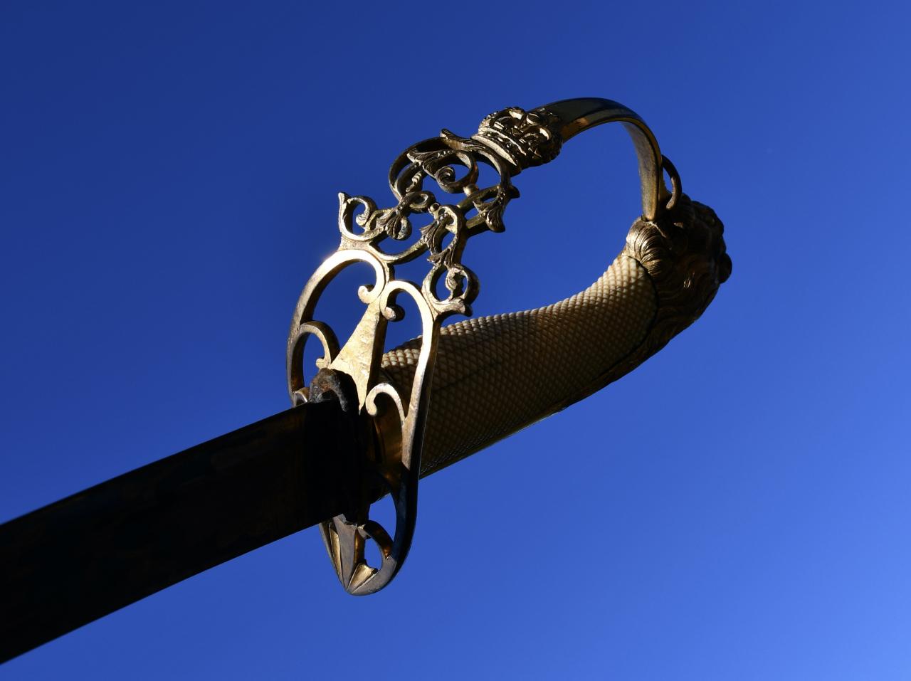

I had one once with the lion head instead of having the flowing mane, had an Egyptian sphinx like headdress, probably of course signifying service in the the campaigns in Egypt. There again is another field of presentation or commemorative sword examples.

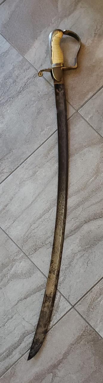

The one with the deeply curved blade, rifle company?
Old 1st December 2022, 03:48 AM   #21
Radboud
Join Date: Sep 2021
Location: New Zealand
Posts: 303
This is one of those grey areas. The steel scabbard would be more typical for a cavalry officer as it is harder wearing for when mounted. Leather is lighter and makes less noise when walking about. The blade is short at 71cm (28 inches), not suited to mounted combat. But I've seen dress swords with steel scabbards as well.
But then an officer that could afford an ivory-hilted sword is equally likely to be mounted regardless of service, it's anyone's guess really.
Given that the British had only three (four?) Rifles Regiments in the regular army at the time, I would say on the balance of probabilities that it belonged to a Cavalry Officer.

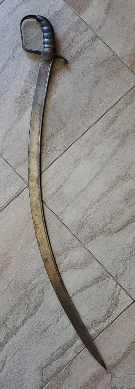

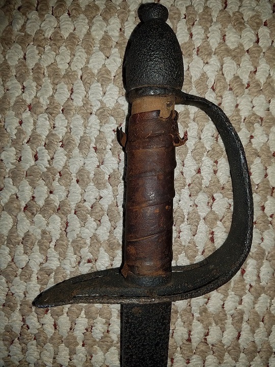

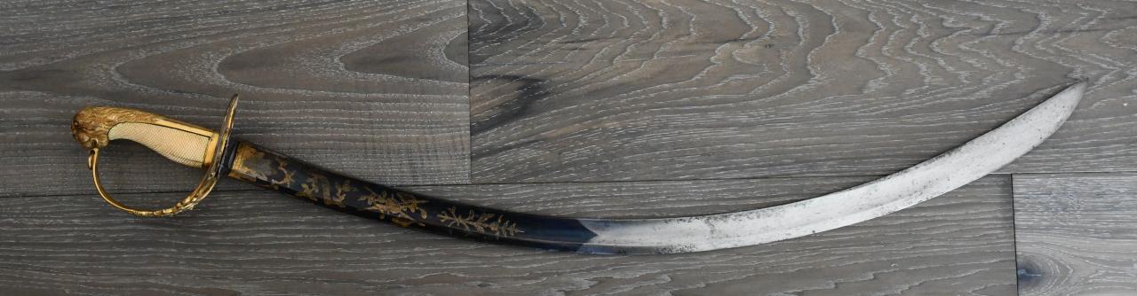

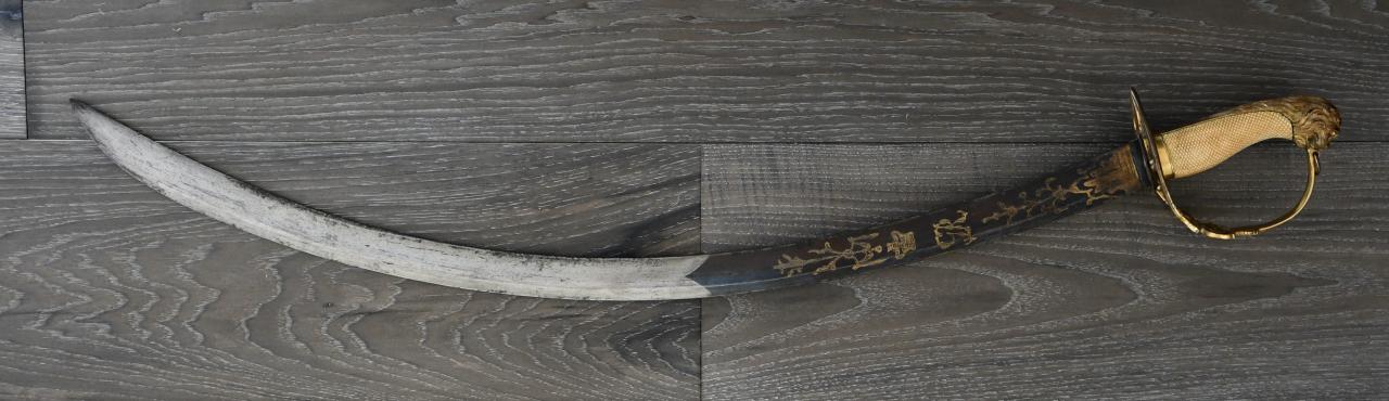

So with that example with dramatic curved blade, then this one which is of course not with ivory grip etc, I have always thought was an officers, is likely cavalry ?
I got this back in those days trying to assemble M1796 anomalies, and it was actually included in an article by the Danish Arms & Armor Society on that topic over 20 years ago. I need to find that article in old notes.
I had seen rifle company or flank company M1803 sabers with these kinds of dramatically curved blades so thought perhaps this was one of that category.
I'd rather it was cavalry per my own fields of 'collecting' though.
But again....who knows?
What was interesting with this one is the pipe back on what is essentially a Persian 'shamshir' type blade. I know that when Osborn was considering options in developing the M1796, he was looking at various types of swords and features which included Indian tulwars and others according to some references. Also what I thought was odd, is the strangely canted hilt, a feature which brought to mind certain Caucasian sabers, to add to the 'exotic' features that seem to have been applied to the sabers of this period.
In the latter 18th into 19th c. it seems there were a number of anomalous British cavalry swords, if I recall one had a yataghan type blade; and some (which I think were East India Company associated) had a blade with stepped point (yelman) as seen on Indian tulwars often.
Old 1st December 2022, 01:19 PM   #23
Posts: 10,858
Default 18th Century British dragoon swords-pommel ring
I posted this mid 18th century British dragoon sword a while back, and have had the opinion this may be an early version of the 'four slot guard' which became so well known on British cavalry swords of 1760s into 80s.,
It seems that examples of these, some by Jeffries, London, which are typically described as 1760-70 are seen as having the knuckle guard joining the side of the pommel. This one with the same tall olive type pommel however, has the distinct 'pommel' ring to which the guard elements are attached, and the ring rests just under the pommel.
This feature seems to be in accord with most British dragoon sword hilts of the 18th century with the many variations of basket, half basket guards, but seems to have ceased being used by about 1760.
Any ideas on just when this hilt element ceased, and is it a worthy factor in determining date on these British dragoon sword hilts?
Old 8th February 2023, 11:00 PM   #24
SwordLover79
Join Date: Jun 2022
Location: San Diego
Posts: 59
Default white hilted saber
here are three photos of an almost identical sword to Jim's in my collection. The sword knot ring is at the pommel. Well marked with George III cipher and coat of arms on the blade (which is German -by J.J. Runkel of Solingen). I assumed that it was an Officer's private purchase modeled on the 1796 cavalry saber, though the blade is not as heavy.

That’s a lovely sword. How long is the blade? Do you have an image of the whole sword?
Having a small lanyard ring like that is an interesting choice. I have to wonder how well such an arrangement would stand up the the rigours of mounted combat. Of course there are practical alternatives that can be used while still retaining the ring.
The at of arms is the pre-1801 type, so while not exactly a precise measure it does help identify this as an early sabre. My observation has been that sabere blades supplied by Runkel tend to be on the larger size for dismounted or purely dress use.
Old 9th February 2023, 06:05 PM   #26
Posts: 10,858
Very nice!! Note that in the coat of arms, the three fluer de lis in upper right quadrant are present.....this theoretically changed in 1801, so presumably this is pre that 1801 date. However it is quite possible that technicality was not readily observed, and that blades on hand with cutlers and outfiitters might have been used later.
Old 9th February 2023, 07:25 PM   #27
In 1801, when George III renounced his title as King of France under the Treaty of Paris, the French Fleur de Lis quartering was removed,and replaced with the Scottish Lion.
Old 9th February 2023, 10:28 PM   #28
SwordLover79
Join Date: Jun 2022
Location: San Diego
Posts: 59
Default late 18th Century British Sabers
As requested, here are photos of the whole sword. the blade is 32.5" and the overall length is 37.5" This sword has a milder curve than a similar lion headed saber it sits next to on my shelf (blade 30", overall 35.25"). I added photos in case you are interested in seeing both. The second sword is blued with gold for half the length of the blade, and has a very fancy brass guard.
SwordLover79 is offline   Reply With Quote
Old 10th February 2023, 07:29 AM   #29
Radboud
Join Date: Sep 2021
Posts: 303
Thank you for the additional photos, at 32.5 inches thats the standard length for the 1796 Pattern LC. So your’s is most certainly a cavalry officers, most likely from the Yeomanry, given the guilding.
Your other sword is the 1803 Pattern ‘Flank Officers’ sword. The flank companies were the Grenadiers and the Light Company that marched on the flank of the regiment. These were seen as the regiments’ elites with the Grenadiers often at the front and in the thick of battle while the Light Company ranged out, scouting ahead and skirmishing with the enemy before full engagement by the regiment. From 1800 the officers of these companies were given permission to carry sabres (a habit they had already acquired) in place of the 1796 Pattern infantry officers sword. Drawing on the ones that were popular in 1803 an official pattern was declared with a lions head pommel and GR cypher for the guard.
Lots of variation exists in the grips, with leather and shagrin being most common, but ivory and wire grips are also found. Because the hilt is the pattern, there is a lot of variation in the length and shape of the blade in these.
Of course, over time others chose to carry these swords, so it is not impossible that your’s belonged to a high ranking general officer, rather than a ‘Flank officer’.
