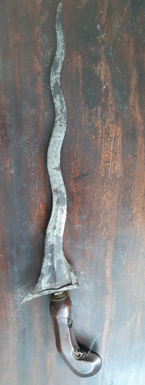

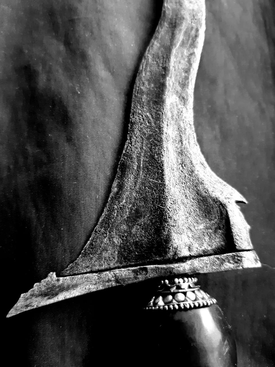

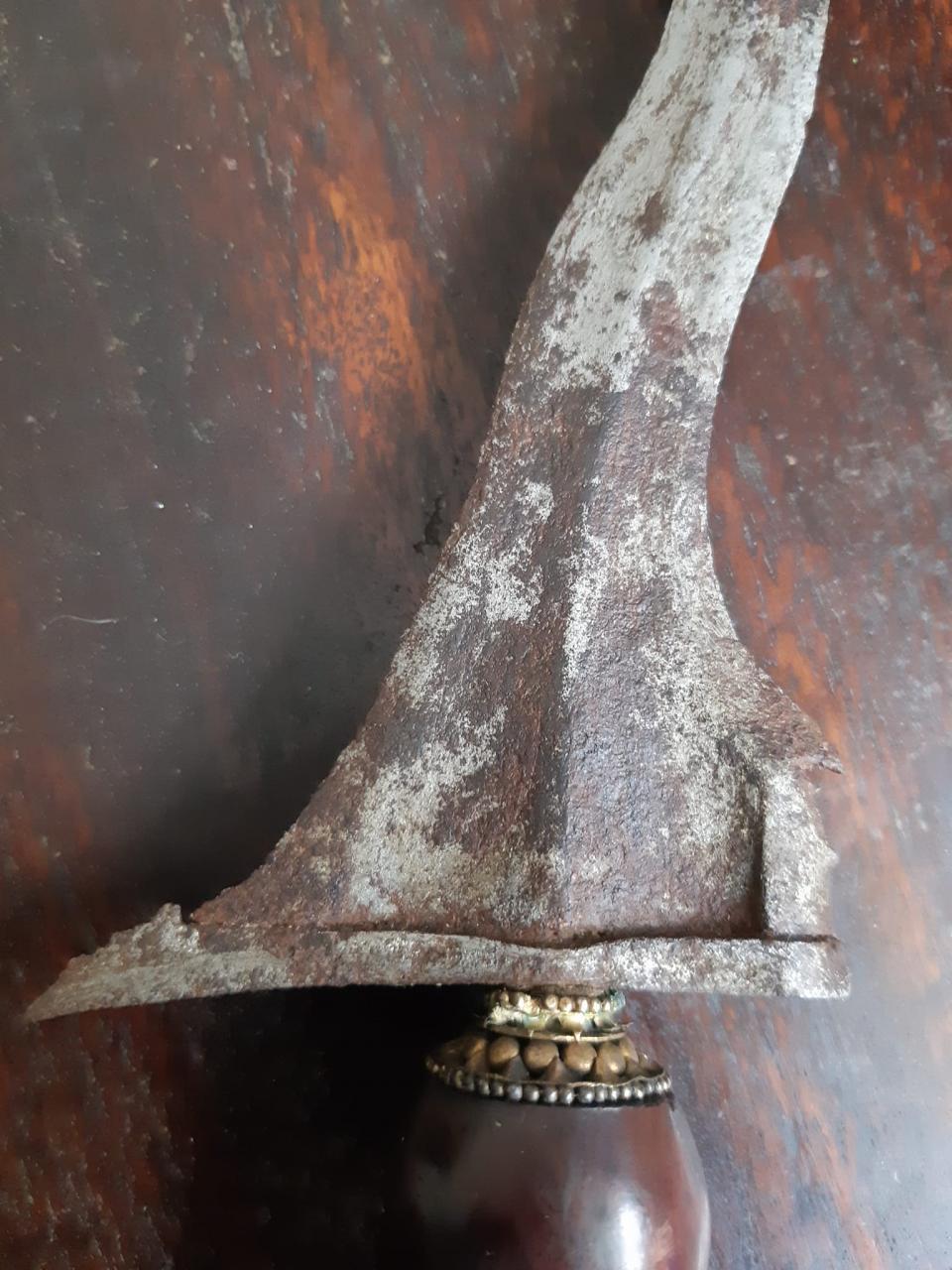

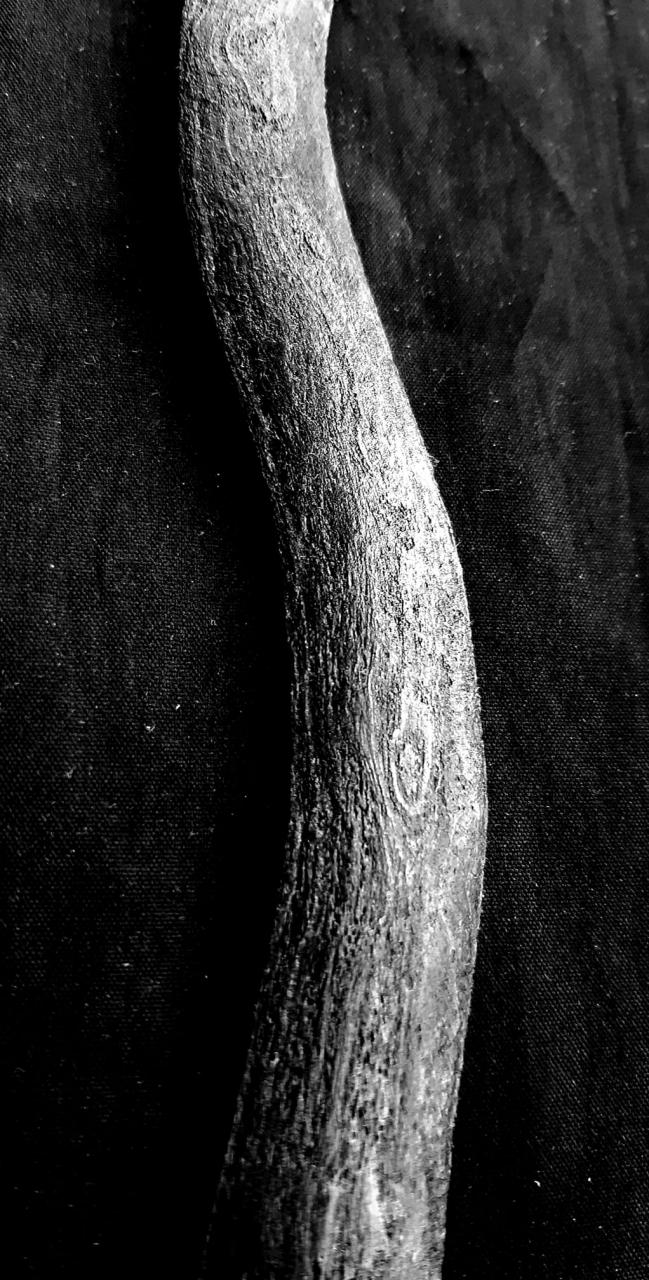

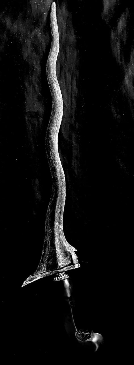

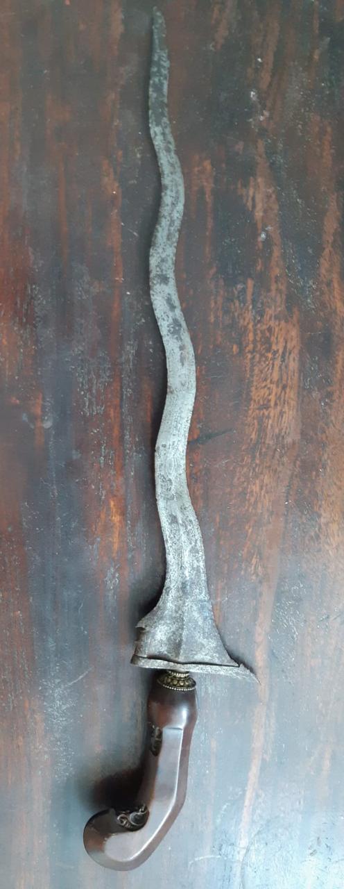

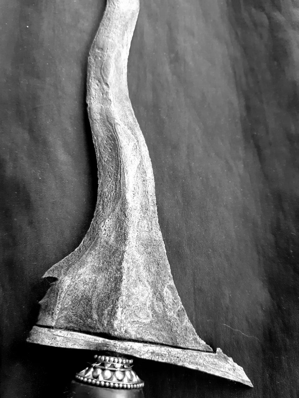

Hello
Here is an old keris I picked up in Australia. It was in a neglected state as the pictures show. I cleaned it and then applied a traditional warangan in the old manner. I would be very grateful for your thoughts on this keris. I am told it has some age to it.
Many Thanks

I should add for what it is worth that the mendak turned out to be gold on this one.

Not bad Sid, not bad at all.
You've done well.
Pajajaran I think.

Thanks Alan. Does this equate to around the 1600s?
SidJ is offline   Reply With Quote
Old 19th October 2022, 10:08 PM   #6
Posts: 7,228
Sid, when we are talking about older tangguh classifications we cannot adopt a time related frame of reference to fit with these classifications.
The Solonese initiated tangguh reference system was designed for a necessity that had nothing at all to do with the whims & desires of collectors and present day dealers. The present day market place has corrupted the tangguh system to something that I personally regard as having very little relevance to reality.
That said, if you are looking at age of this piece, I would place it as pre-1850 and from West Jawa. It could go back into the 1600's, but I do tend to be very conservative with age estimates, it is very easy to be wrong.

Thanks Alan
This tangguh system is incredibly opaque. I am not at all clear if it helps or hinders a typical westerner to understand keris age. Thanks for advising on the age Im happy with around 1850. Fair bit of age to it which is great.

Sid, the tangguh system is really not all that difficult to come to terms with if we just regard it as a system of classification.
For relatively recent classifications, such as Surakarta, we can use it as an approximate guide to age, but the further back in time we go, the less we can think of it in terms of age.
I feel that for Sultan Agung forward it is probably a more or less reliable way to get a ballpark approximation of age, but back before this I tend to regard it as a system that is more likely to indicate place of origin, rather than time of origin.
I'm using words like "tend" & "feel", this is because what I have written is a statement of my personal belief, which is probably as good as anybody else's personal belief.
Bear in mind that tangguh is a value indicator that is tied to perceived honour, it was never intended to satisfy the curiosity of collectors, it was intended to help Javanese noblemen with their investment decisions.
However --- at the present time it is used by many people who do not really understand it, to jack up prices. Koripan almost always becomes Mataram Sultan Agung, Tuban Majapahit gets presented as Majapahit, & so on.
Just stick with it as a classification system and you won't go far wrong.
