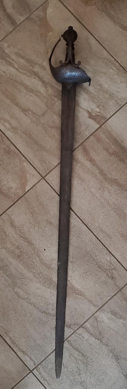

Does anyone recognise this distinctive 'tree with roots' stamp from a Solingen-made blade on a mortuary sword?
The blade is marked:
ME FECIT Running wolf Tree SAHAGVM
SOLINGEN SAHAGVM
From what I can tell ME FECIT SOLINGEN is Latin for "Made in Solingen" and SAHAGVM is a forgery of the signature for the 16th Century sword maker Alonso de Sahagun
It appears that the SAHAGVM (also SAHAGUM or SHAGVOM) name is for Walloon swords, what the Andrea Ferarra name is for Scottish Baskethilts. A search on the name turns up many Walloon swords but only a few English ones.
With its central trunk and exposed roots, I had hoped such a clear mark would be fairly easy to identify; alas, I can't find it in the reference works I have. Has anyone encountered it before?
These photos are from the vendor; the sword is currently on its way to me, so will be able to take more when I have it in hand.

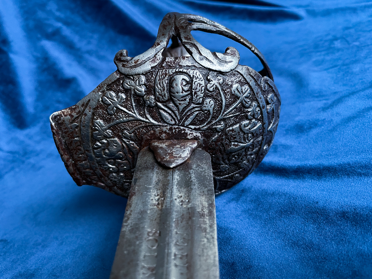

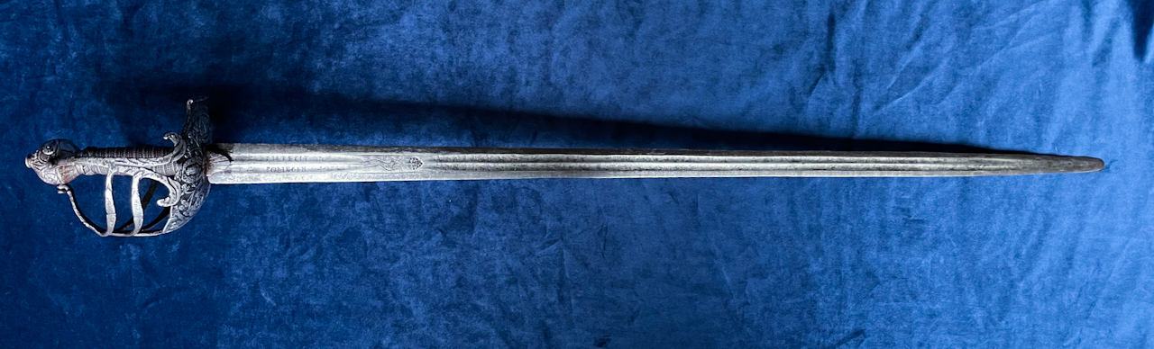

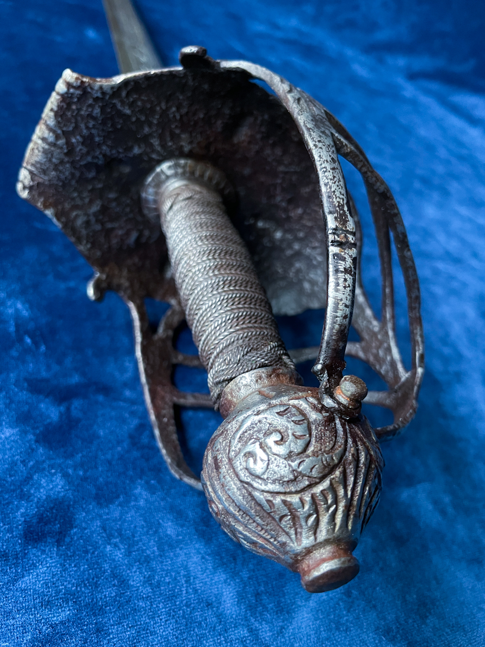

The sword arrived yesterday, so can put up some more photos. My first impression is that it's a lot lighter than I expected, at 860 grams. The blade is 830mm long, but has lost a bit off the point.
It's also quite thin: (Profile / Distal taper)
  • Ricasso: 35.3mm / 5.6mm
  • 200mm: 30.5mm / 4.1mm
  • 400mm: 26.1mm / 3.4mm
  • 600mm: 23.8mm / 2.5mm
  • 800mm: 15.3mm / 1.4mm
Although this profile is similar to the backsword blade on my 1796 HC dress sword:
  • Ricasso: 32.0mm / 6.1mm
  • 200mm: 28.9mm / 4.5mm
  • 400mm: 27.7mm / 3.2mm
  • 600mm: 25.2mm / 2.7mm
  • 800mm: 16.5mm / 1.3mm
I'm guessing that the grip wire was redone at some point, possibly in the 1800s? Although the Turkshead knot looks good so it might be older but that seems unlikely.
All in all an interesting piece, even with the peculiar 'panel' on the blade. Will need to keep an eye open for similar blade profiles to compare.

* Drool *

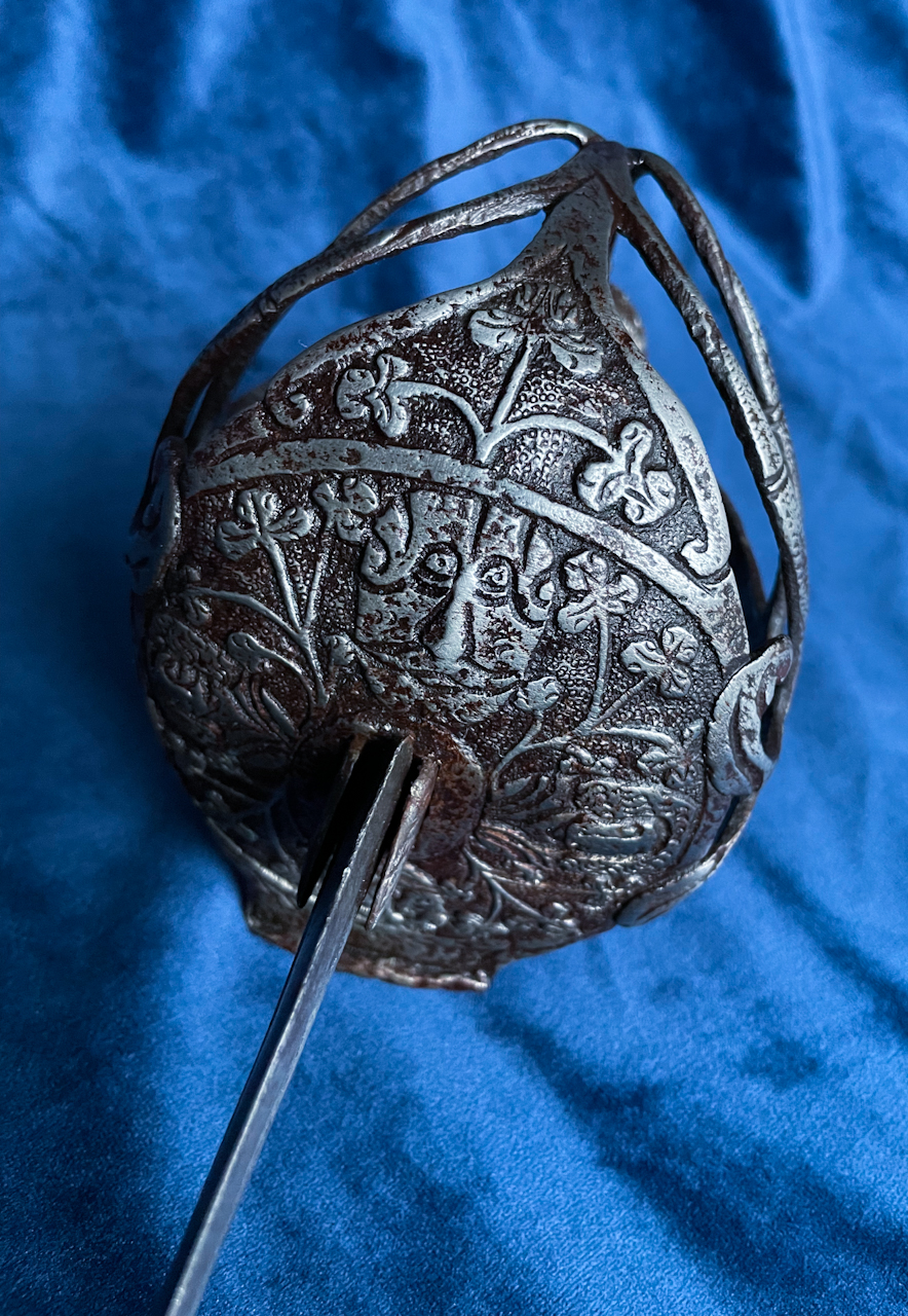

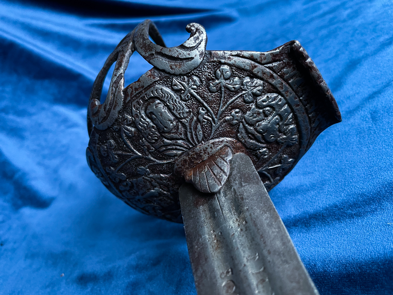

The engraving on the rear of the guard is a green man I assume, but what is engraved on the sides? It almost looks like a flower wearing a wig.
werecow is online now   Reply With Quote
Old 12th October 2022, 11:08 PM   #11
Radboud
Join Date: Sep 2021
Location: New Zealand
Posts: 303
Originally Posted by werecow View Post
* Drool *
It's another head, just the face is a bit worn. These faces are a prominent feature of these hilts and where the name 'Mortuary' sword comes from. Late Victorian collectors theorised that the face was the martyred King Charles II.
But as swords with these decorations were carried by both sides of the English Civil War, and there exist examples that can be dated to before the death of Charles II, this is an unlikely explanation. Possibly another one of those mysteries that can only be resolved with a time machine

It's a Green Man... or a variation on the theme.
As was said, Charles the first was beheaded as a result of the civil war.
I have Shotley Bridge swords, and have seen others, with that same face... often where the leaves, that are pertinent to the imagery, have worn away with just the face left behind.
BTW, it is a magnificent sword.

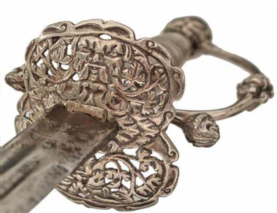

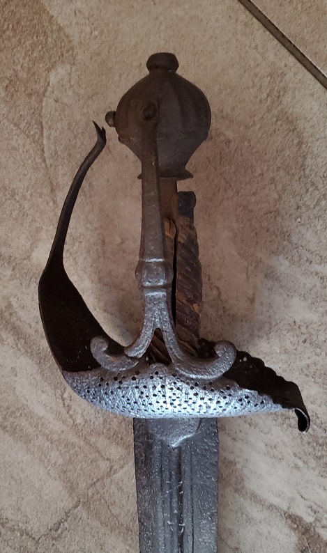

Another found online:
Old 13th October 2022, 08:32 PM   #14
Radboud
Join Date: Sep 2021
Posts: 303
Thank you all for the feedback and the additional examples Jim and Kronckew.
Jim, I'd be interested to hear how the dimensions of the blade on your example compare to mine.
