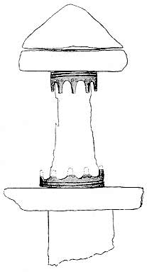

Type H., fig. 79 (R 494; Montelius: Svenska fornsaker 507).
Fig. 79.  Torshov, Gjerdrum, Akh. 1/2. [91]
This type holds an exceptional position due to the broad time period it extends across, and it will therefore be discussed in a chapter by itself. It is also the most numerous of all the sword types from the Viking Age. I know it in this country in no less than 213 specimens. The type seems to have developed within itself, as will be shown more closely below, and it even extends [~89] into a subtype that will be discussed as an individual type. But we shall first define the characteristics of the one main type:
The handle consists of wide guards with an elliptic cross section. The upper guard is especially wide; the greatest width that any of the upper guards from the Viking Age attained (3.6 cm.). The guards have most often slightly curved, or in the older specimens, clearly ridged upper sides. They are seldom entirely flat. The pommel has three sides, so it has a wide base. It can also be somewhat tall; its height ranging from 2.5 - 4.5 cm., while the most common is 3 cm. Oftentimes however, the pommel has fallen off and is missing in the find, but the type is never the less evident in the wide upper guard and the striped ornamentation that we shall discuss shortly. It has, however, occurred that it has been confused with R 489 during the cataloging of swords of this type; [R 489] is an entirely different type in that, among other things, the guards have quite a different cross-section. Especially the older swords of the type make a heavy and massive impression and are to a certain degree related to [~90] other types that appear in the earliest Viking Age (B - E). Finally it should be noted that the pommel in the most usual type is always connected to the upper guard by rivets.
Both the guards and the pommel are covered with thin silver or bronze (or copper) plates, and once every so often with brass which has the appearance of gold. In many instances there are different types of metal on the same sword, in the sense that, for example, silver and copper are interwoven into simple geometrical figures. The metal is connected to the iron [base] by forming close-set horizontal furrows and thereafter hammering the other [covering] metal into these. This has resulted in the present grooved or knurled surface appearance. This is, as previously stated, not its original appearance, but has been caused by wear. Originally, the surface was apparently quite smooth. The patterns on this type are extremely simple, and where there are different metals or interchanging vertical bands, they create a checkered pattern or a more intricate stair shaped pattern[1].
Usually the coating is of bronze and copper, but also often even of silver. A more detailed statistic will not be written up here since the relationship in most cases is unclear. One can only see stripes and merely suspect the type of metal coating. It is possible that several cases could be determined by chemical analysis but this has, however, been difficult to execute, and it has moreover no great significance. [91]

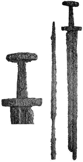

Fig. 80.  Eide, Gloppen, N. B. 1/2.

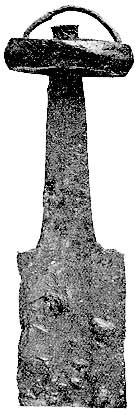

Fig. 81.  Krokstad, Melhus, S. T. 1/2.
In a couple of cases there is smooth bronze sheeting on the over and under side of the upper guard[2]. In one single case there are remnants after silver sheeting with figure-ornamentation[3]. In four cases there are, between the upper guard and the pommel, a raised band of bronze, often pearled (fig. 80)[4], hereof also sword guard and pommel C 8598 from Holbø, Vaage of the E-type (fig. 64). In two cases the guard and the pommel are entirely of bronze[5] (fig. 80). Likewise, the upper hilt is of bronze on sword T 1441 from Krokstad, Melhus, S.T. (fig.81), [~92] and its guard moreover has quite the same shape as the two others: tall, wide and ridged. We shall soon discuss it in more detail. In one case from Trøndelagen, the upper guard is of type C and the lower guard of type H[6]. It is, however, true that the handle shaft [tang] is broken, but the two parts fit perfectly together at the fracture point. Something similar seems to have been the case with a Swedish sword (Statens hist. mus. Inv.-nr.6011, Uppland), where there is also a lower guard of the H-type, but where the upper guard has been of the B-type, since the pommel is absent. In one specimen there are »véttrim« [ferrules] of bronze, with a compact rim of animal heads pointing upwards and downwards respectively (fig. 82). In this way it is just like an individual specimen of the D-type or almost like the sword of the C-type from Orkney Island (look under this type)[7]. Otherwise I know such »véttrim« only in two other finds, namely C 16107 from Fredrikshald and C 1194 from Dybe by Mandal. In Hovedkatalogen O.Rygh considers both to belong to the Middle Ages. The first he even considers to be a sword pommel in the shape of a compressed crown.

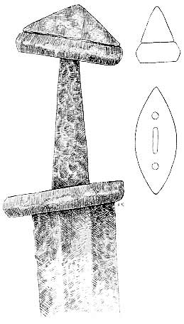

Fig. 82.  Vig, Rennesø, Stav. 1/2.
Within this type there are a couple of subtypes of handles that we shall discuss here. They are evidently related to the H-type but they are too few to be discussed as separate types.

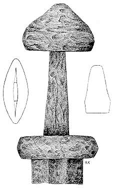

Fig. 83.  Farmen, Hedrum, J. L. 1/2. [95]
First we shall take note of a small group of three specimens [8], that have not had the usual striped ornamentation on the hilts. Two of these specimens, from Dynna, Gran and S.Farmen, Hedrum, show an upper guard and pommel fused together. It is that same development that has created a whole separate type: the C-type out of the B-type, but that in this case was not tried or duplicated in more than these two cases. A third sword from Kluke in Biri seems not to have had a pommel in that we cannot find holes after any rivets on the lower guard and moreover, the handle shaft [tang] is merely flattened on top. One sword C 21704 (fig. 84) has [~93] lost its pommel, and it has been replaced by the same kind as that on the sword in fig. 72. All these swords have handles of the most massive kind with ridged guards.

Moreover, there is a single sword, the previously mentioned T 1441 from Krokstad, Melhus [fig. 81], where, of the guards, only the upper guard has been preserved. This guard is of bronze and is lacking a pommel. Instead there is fastened, in the rivet-holes on the upper hilt, a simple iron hoop made of one single rod flattened on both ends. The same is the case with a Swedish sword from Dalarne (Uppsala, Inv. -nr. 1043). However, the guards are narrower and more slender here, which in many respects makes it similar to sword C 4979 from Homerstad, Stange, Hedemarken (fig. 135). It will be discussed in a separate entry.
