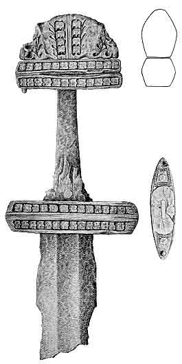

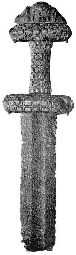

Fig. 59. Ophus, Vang, Hed. 1/2. [72]
The hilts are massive and ridged, and have a tapering cross-section. The pommel is divided into three sections and the middle section is the tallest. Both the pommel and the guards are richly ornamented with inlaid sections of alternating recessed and raised areas. The recessed areas were inlaid with bronze or copper, the elevated areas with silver. Otherwise the patterns could differ. A separate group is furnished with rows of raised small bronze knobs with a silver coating. They shall apparently depict small animal heads (fig. 60). Others have rows of cruciform figures (fig.59). Again others have small raised knobs in the shape of squares. Different patterns also exist (consult the picture references in the inventory over types). Frequently there are rivet heads, often large ones, on the upper and lower sides of the lower guard. Likewise, the pommel is attached [to the upper guard] with rivets. The tang [grip] is also often covered with the same kind of metal coating, which in many instances is quite well preserved. Below the upper guard and above the lower guard there is often a véttrim [ferrule] of bronze, created by closely placed animal heads or imitations thereof, just like those we heard of under the previous type in the sword from Orkney.

Fig. 60. Ved Moss, Smaal. 1/2. [73]
In this country I know these swords now in eleven specimens. The blades are in most cases very poorly preserved. They are all double-edged, but damascening is only seen in one specimen. Two were put down without a blade.
