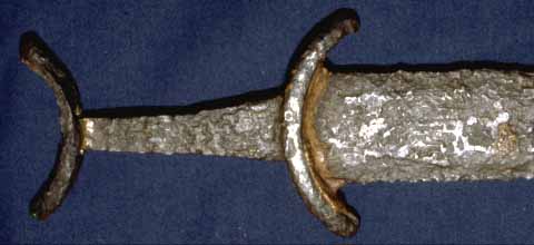

The photograph above is of the less cleaned side of this sword. The hilt retains only the unadorned iron upper and lower guards characteristic of Petersen's type L; the pommel has been lost. The upper guard is in the form a curved elongated elliptical slotted plate. The slot is longer on the side of the upper guard facing the pommel. The tang passes through the center of the slot and has been upset (widened) at its end to fix the upper guard in place. The pommel would have been attached to the upper guard as a cap, either by means of rivets or adhesives. The crossguard (lower guard) is similarly curved, toward rather than away from the blade, and is somewhat wider than the upper guard.

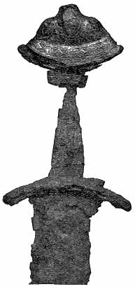

The illustration to the left is fig. 94 from Petersen (1919), showing an example of a type L sword found in Norway, where the most documented type L swords have been found. The pommels generally have three lobes, though examples with five lobes are known, with the central lobe being the most prominent. The pommel and grip ferrules characteristically have silver or silver and niello decoration. In some examples, the nature of this decoration, referred to as the Trewhiddle style, is favored to be of British Anglo-Saxon origin rather than Scandinavian, with many examples found in Norway thus being regarded as of British origin.

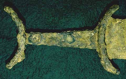

A further example of a sword of this type, illustrated to the right, similar to our present example in that the pommel and all decoration have perished, was found near Bruton, Somerset, England in the early 1980s and is presently in the Somerset County Museum. This sword sold at Christie's London as lot 70 on July 25, 1984 for £1,944.
