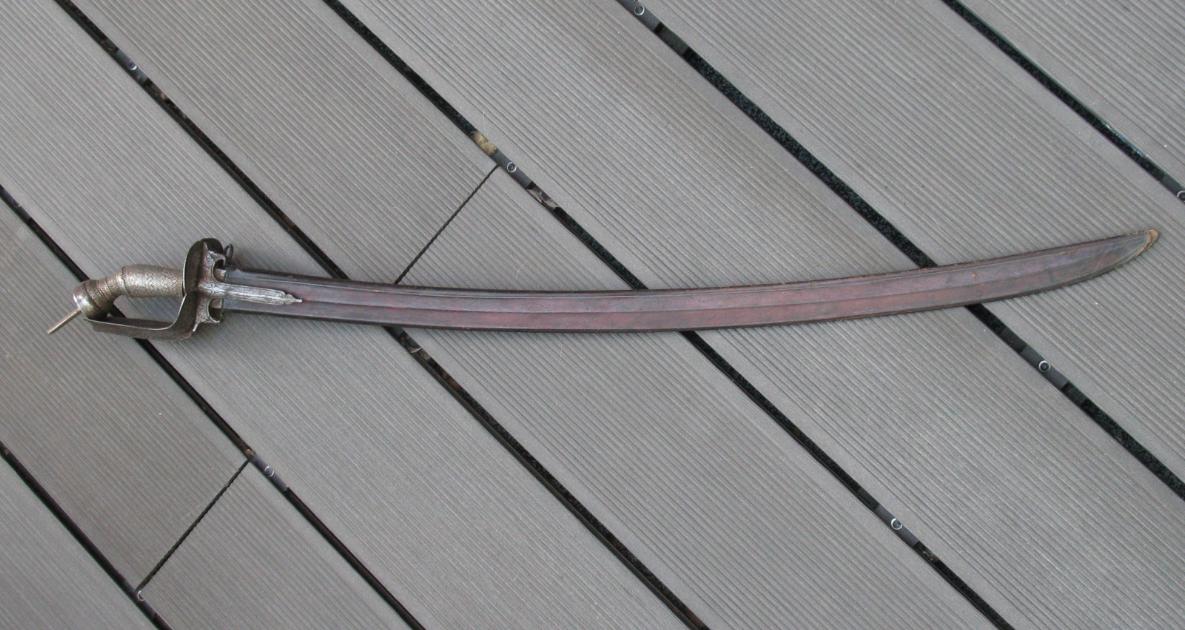

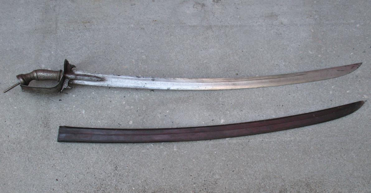

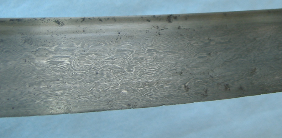

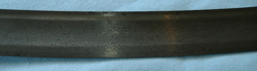

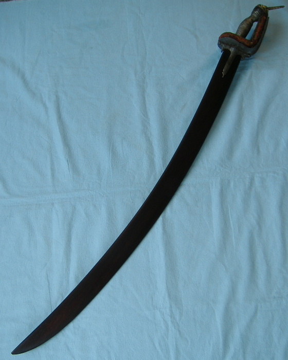

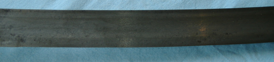

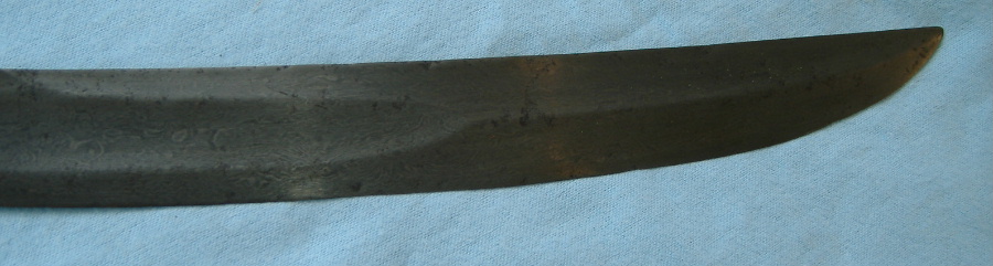

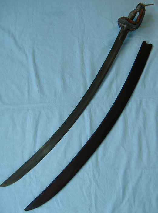

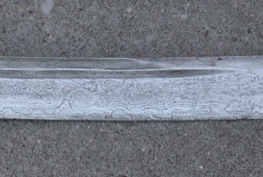

I was fortunate enough to purchase this sword from a forum member a couple of months ago. The blade was a little spotty with some areas of deep pitting, so I sent it out to Philip Tom to see if he could improve the appearance of the blade.
When he began to polish and etch, he was astounded and contacted me immediately...."this thing's got a wootz blade...and a good wootz blade." I could not believe it as I have never seen a peudueng with a wootz blade. All the other features of the blade are quite the norm including its fullering and fexibility, though it is by no means flimsy. It also has the typical false edge of approximately 10in.
The wootz steel blade brought up and lot of questions between Phil and I, most notably "how did this sword come together"? My immediate theory was that one of the talented craftsmen from all over Asia they could be found in the Indonesian archipelago likely had made it.
But Phil brought up an excellent point...if that is case then why haven't we seen more similar blades of wootz from that area? Could it have been from a wootz ingot traded from India or Persian and then forged in Sumatra???...likely not keeping in mind the delicacy involved in forging a blade from a wootz ingot and not ruining the pattern in the process.
So now I tend to agree with Phil, with this likely being a "made to specifications order" blade requested from either Persia or India, and making it's way back to Sumatra. This is yet another sword that falls into my interest of the trade done in weapons in "dar al Islam". It's another example of a piece that I really wish "could talk" to us!
If this is the case, can you imagine the patience and care given to exact specifications, not to mention the "waiting time" for the buyer...likely at least two years!!!
Please share your thoughts on anything about the sword...its origins, construction, or otherwise.

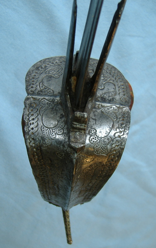

This peudeung is nicely mounted with a better than usual hilt that has decorative motifs to he guard, a silver wire wrapped grip, and a magnificent pommel with brass mounts holding small(likely low grade) diamonds, and decorated in type Aceh enamel motifs. The hilt pad is quite nice as well, and is in great condition.
The sword came with its original leather scabbard, but there was so much grit and sand in the scabbard, it would have ruined the finished etch over time, so I asked Phil to make a wooden core scabbard for me.
I would be most interested in seeing examples of other original peudeung scabbards to give me some ideas to go by in completing this wooden one. Thanks for any pics here.
Thanks again for any input!
Dimensions:
Overall length: 42in.
Blade length: 36.5in
Widest point of the blade: 1.5in.

I'm afraid my comment is going to be reduced to just saying, what a beautiful sword! A pleasure to view it.

Don't you think that most of the blades for this form of peudueng were sourced from India ?

Don't you think that most of the blades for this form of peudueng were sourced from India ?[/QUOTE]
Phil and I both assumed that was the most logical place of origin.

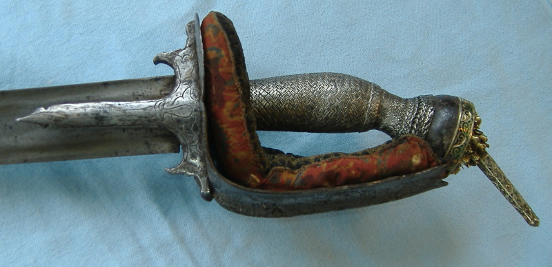

Dear Charles,
A very nice example.
I believe you already give a lot of details about the origin and construction.
I agree with the theory that this blade was bought from outside Atjeh.
There are also examples with english factory made trade blades.
So why not trade a wootz blade from India ?
The spike like protrusion is quite bend. Maybe that can be restored / straitened ?

Ps, the original scabbard that came with your example, is it not wood covered with leather ? I would try to get the inside of the original scabbard cleaned in order to maintain the original scabbard.

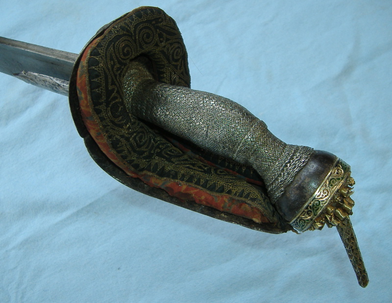

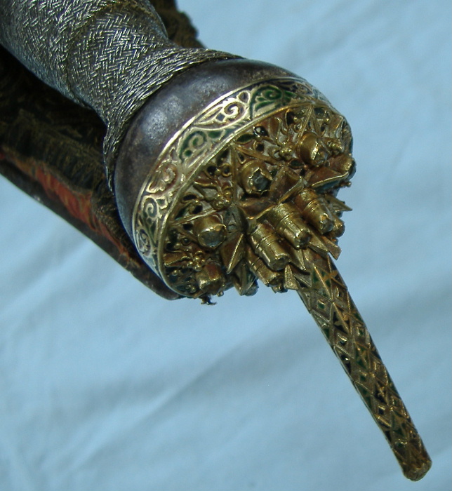

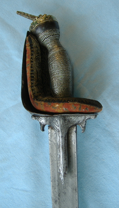

I'm mesmerized by the hilt. Fantastic and meticulous decoration. Yes, I love the steel too, but the hilt is a work of art.

Excellent Indian blade lovely hilt as well!

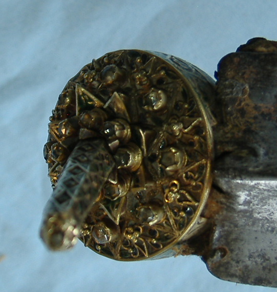

Could the pommel mount be gold, rather than brass? Not that it matters much, with such fine workmanship.
The pommel mounts are gold...not really sure why I said brass. I knew better. You have a good eye!

The use of a leather scabbard here(with the peudueng) really surprises me. I have always understood that leather does not hold up well in tropical conditions.
Perhaps someone else knows more about this???

Wootz in Sumatra is a study that I think would be worth while as personally I think your wootz blade was formed in Sumatra, not traded.

Charles, IIRC I have seen a couple of these scabbards and they were both leather .

Hi Charles,
all peudeuangs I have seen and/or owned had leathered scabbards.
The Dutch marechaussees used klewangs in tropical conditions which also had leathered scabbards......
Kind regards,
Maurice

Maurice,
I believe these scabbards are of very light wood with a thin layer of leather.

Hi Maurice,
I am a a little surprised by leather or leather covered scabbards on native made blades. I had understood that leather does not hold up well in such climates...but I may be totally wrong.
As for this one's original leather scabbard, I still have it and keep it with the sword, but there is so much sand or grit so deep in the scabbard that I dare not use it for fear of ruining the finish to the blade and the exposed wootz.

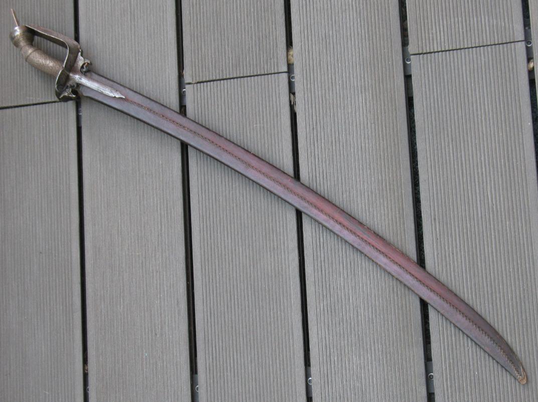

Finally took some pictures with acceptable daylight of a peudeung from my own collection. Scabbard leather over wood.
Blade is laminated, What would you call this blade ?
Willem
Old 15th June 2015, 10:31 PM   #25
Willem
Hello Willem,
I would call it a pamor blade. Nice sword!

Really attractive patter welding there Willem...consistent and good contrast. Is this the original etch or a later one?
