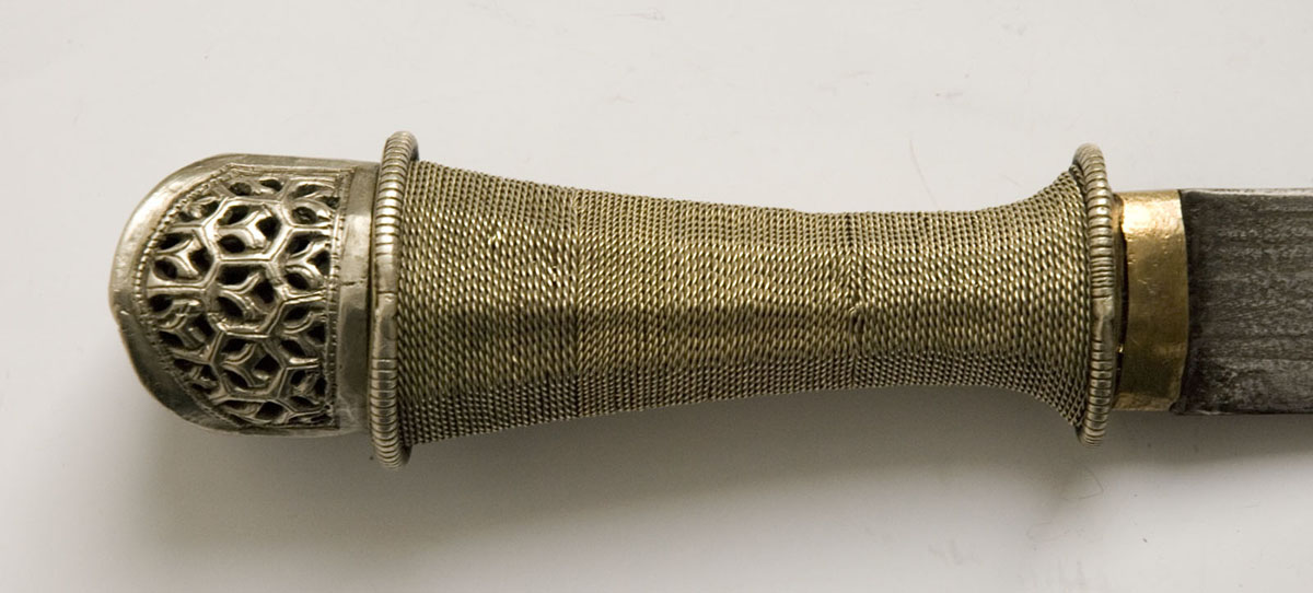

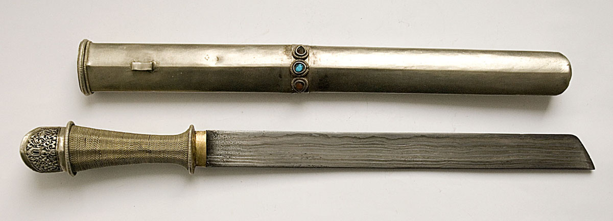

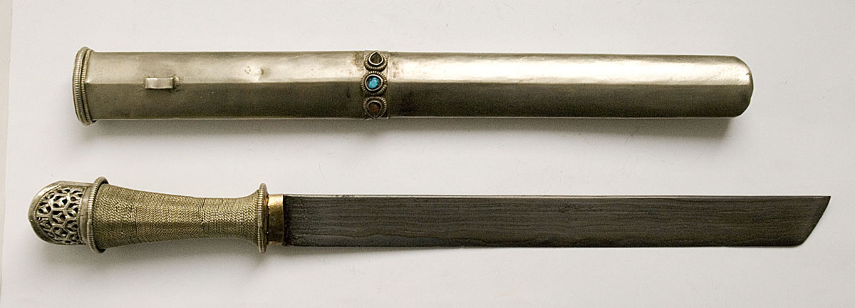

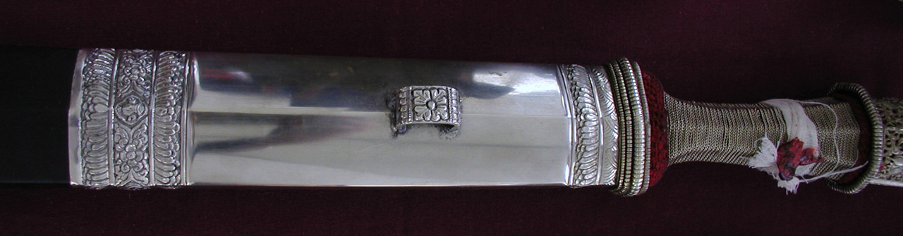

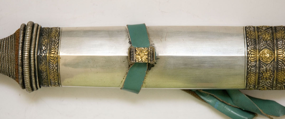

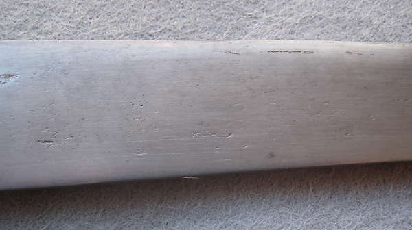

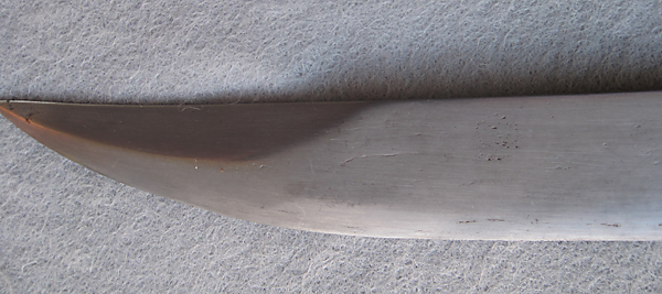

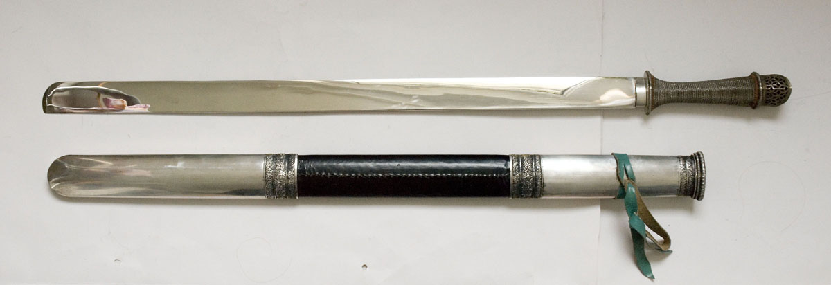

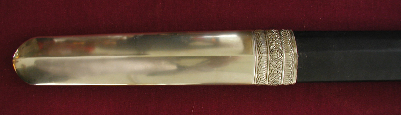

I have bought recently a beautiful Bhutan sword. The fittings are made from massive silver (tested) and nicely decorated.
The problem is that the blade is chromed, although it is thick, has a nice geometry and is razor sharp. The scabbard wood and the leather look pretty new (I mean second half of 20th century). The silver scabbard fittings have a milky white appearance inside and no brown patina (I have removed them for cleaning). They are also in a very good condition; there are no scratches, damage, etc… The red fabrics on the hilt look also recent.
So, the whole sword is of really good quality and looks like it was brought with the time machine :-) Is it possible that the complete sword was made recently? Maybe it explains the chromed blade? Then the chrome finish is original and shouldn’t be removed... What do you think?
Tatyana Dianova is online now   Reply With Quote

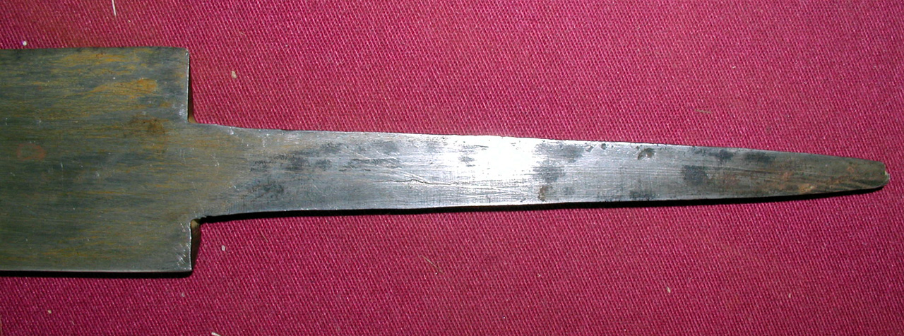

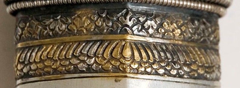

More pictures:
Old 3rd May 2011, 08:33 PM   #3
Posts: 6,025

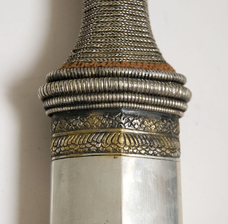

Tatyana, you clearly have doubts. I wonder if that is silver plated and masked off so you have silver and brass showing on the decorative metal work? It seems clean on the handle in a way that causes doubts and the leather. Dare you sratch the silvery scabbard. That chrome is very clean like a new motor cycle exhaust back in the day when they were chromed?
Old 3rd May 2011, 08:49 PM   #4
Tatyana Dianova
Posts: 793
No Tim, it is a solid silver everywhere, although not sterling - I'd say pretty low grade. I have tested it with a jeweller's file and silver acid. I am collecting oriental silver jewelry and silver plating is not news for me The yellow accents may be gold, but I do not have a gold testing acid...

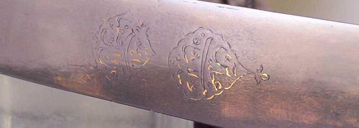

Old 3rd May 2011, 09:06 PM   #5
Posts: 6,025
So could it be fire gilding on the silver? It has a haphazard look and there is a lot of oxidiziation there, that also seems to be on the gold? I am just curious. It is still a nice sword.

Hello Tatyana,
the comlete sword have a good quality but I have no clue if it is recent or old. Maybe someone have done a "over-restauration" by the leather, red fabric and the chrome?
How to remove chrome from a blade Jose have described here:
http://www.vikingsword.com/vb/showthread.php?t=13662

A lot of new stuff on it, chrome, and clean silver. The silver doesn't bother me but the rest does.
Old 4th May 2011, 02:32 AM   #8
dennee
Location: College Park, MD
Posts: 186

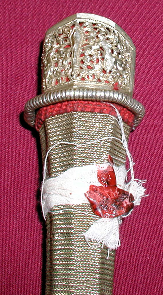

The Bhutanese are again making swords, including with traditional blades, and I have seen some up close (when I get a chance, I can get some photos off my other computer). The most difficult thing to produce and get right is the pierced work of the pommel. The modern ones I have seen seem to have sharper edges than the old ones. The reverse side, with the hexagons, is actually more regular than most old ones I have seen.
In all, this is likely all new work, but quite good and interesting and worth having.

Thanks everybody for the replies and opinions!
Tim: I have no clue what the yellow colour is and how was it made, sorry...
Detlef: I know it is quite a pain to remove the chrome, and in case of this sword it seems to be unnecessary.
Dennee: thank you for the expert opinion; I came to the same conclusion logically. It means that I can leave the blade as it is, and save me some heavy work It would be interesting to to see other modern swords examples. I am glad to hear that the traditional skills are still alive in Bhutan!

Hi Tatyana,
I believe I had a quick look at this sword a while ago here in England.
I was and am of the opinion that it is recently made (entirely).
Even so, it seems to be rather well made and is certainly unusual.
I wouldn't change it at all, I wouldn't remove the plating or anything. I think it's worthy of a place in any collection as a finely made modern continuation of a traditional form.
Despite the plating, the other elements are very traditional and well executed.
Were it mine, I would concentrate on trying to identify (if possible) where these are being made and by whom.

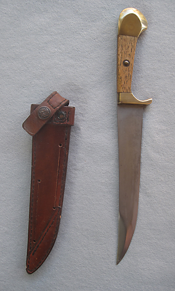

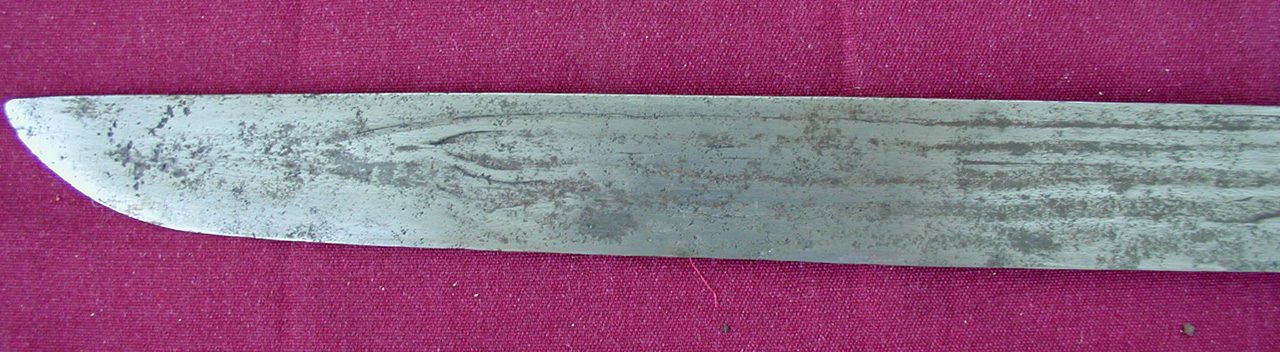

I do not know anything about Bhutan arms, but the fittings look very fine. With total lack of knowledge in the area I admit I was fooled into thinking they're old.

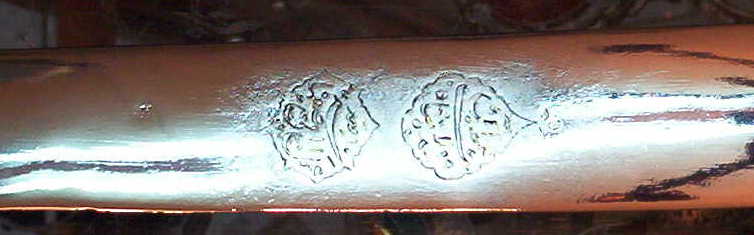

As for chrome-plated blade... I found chrome-plated shamshir blade once. Why was it chromed, no idea. It was looking totally shiny brand new, what gave is the cartouche:-) otherwise it'd be lost forever:-) see before and after pics.
Old 4th May 2011, 02:14 PM   #14
Posts: 7,255
Over the years I have had a number of different blades with plating, usually chrome plating, but on a couple of occasions I seem to recall it was nickel.
In all cases I dismounted the blade and gave it to a plater to reverse the process and remove the plating.
In all cases the removal was totally satisfactory.
After the plating had been removed I did a light polish with wet and dry paper and etched.
The results of the etching were not always all that pleasing. On a couple of occasions I finished up with truly excellent blades of mechanical damascus and another of wootz; some khukris had blades that were composed of haphazardly welded bits and pieces; a couple of blades were mild steel or iron with no pattern at all. One jambiya was revealed as total junk--- the rib down the middle of the blade was a line of electric welding.
If the plating on this Bhutan blade were to be removed it could be a win, or it could be a loss.

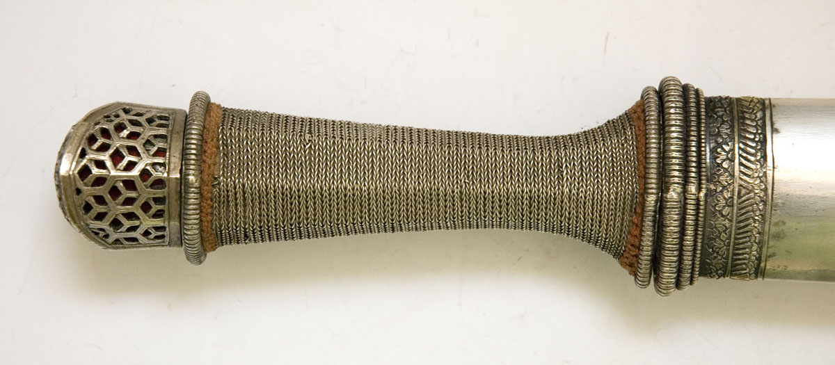

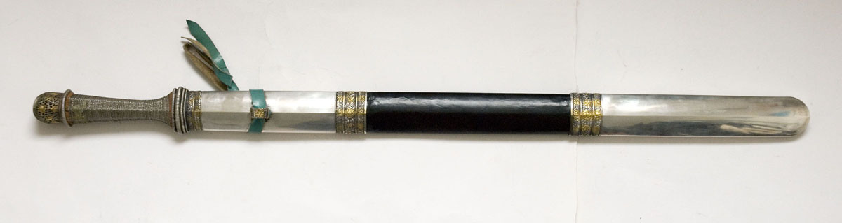

Posts: 793

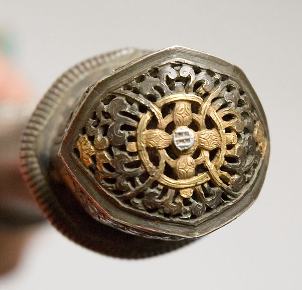

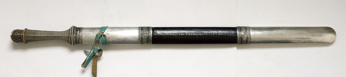

Alex: thanks for sharing the pictures; they illustrate very well what Alan says. I believe you've used electrolytic method? It looks promising but I would better find a specialist...
Alan: I was almost sure I should leave the blade as it is, but now...

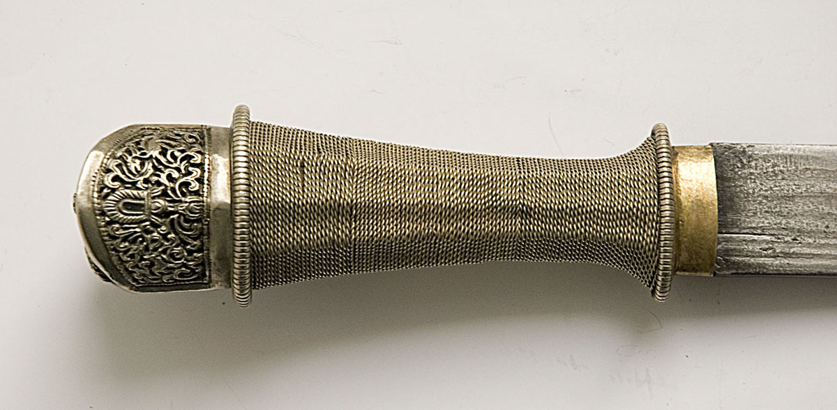

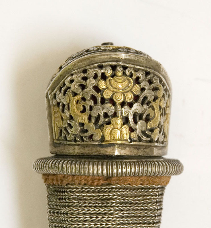

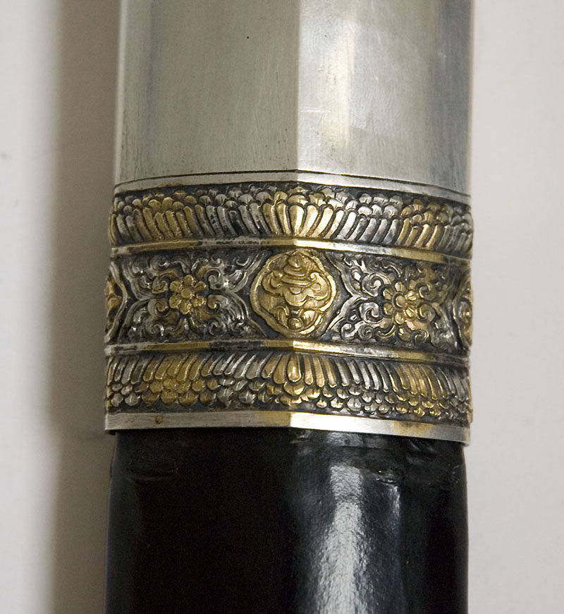

And to illustrate the Dennee's point about the pommel decoration a couple of pictures of the older piece. White metal mounts, recycled sword blade

Here are pics of a knife that came to me more than 40 years ago as a piece of junk --- no hilt plates, no guard, no pommel, badly chromed blade.
I got rid of the chrome by giving it to a plater as described.
I gave it a rough polish , rehilted, gave it a sheath, and used it to kill pigs that we ran down up in the Moree lignum.
It is not wootz, nor mechanical damascus, but it does have a folded and welded blade that holds a very good edge and has high tensile strength.

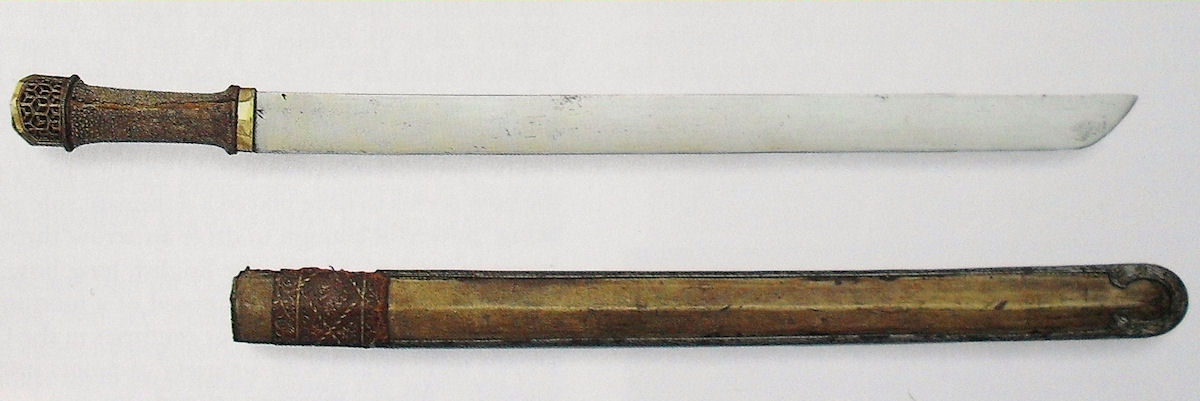

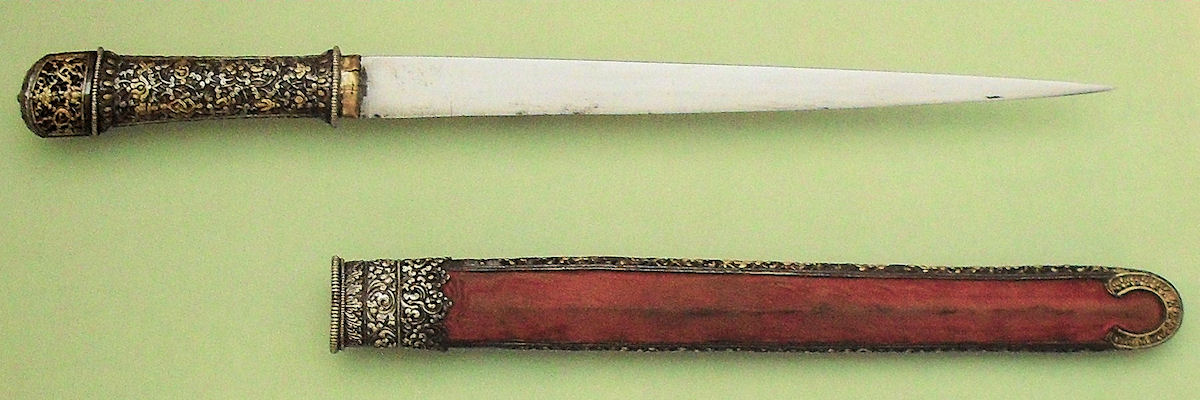

I thought these might interest you, notice in particular the gold areas on the silver parts of the dagger hilt:
Page 185 swords and Hilt weapons.
'Eighteenth century dagger and scabbard, possibly Bhutanese, and a sword and scabbard possibly of eighteenth century date. The latter are decorated in the Tibetan 'plain style'; the Bhutanese attribution is purely conventional.'

Contrary to "Swords and Hilt Weapons," I've never bought that the attribution is "purely conventional." Nor would I necessarily call those "Tibetan plain style," whatever that might be (and it might be a lot of things), especially since one is not plain. But while the plainer one has a Bhutanese-style hilt, overall its form does look similar to knives that were common in Lhoka, the Tibetan province north of the Bhutan border.
Sure, the two may not be provenanced, but I think there's pretty clearly a Bhutanese style distinct from styles of central Kham, southern Kham, and Amdo. Without settling or being able to settle whether "Bhutanese"-style swords, knives and scabbards were ever produced in Tibet proper (and they were certainly imported), it's pretty clear that they were produced in Bhutan.
Those two examples have scabbards or sheaths similar to most Tibetan scabbards in that they consist of an outside U frame within which a couple of thin slats of wood, covered with fabric usually, form the sides. But the C-shaped scroll at the toe of the scabbard shows up in these kind of Bhutanese dagger scabbards all the time, typically accompanying a profusion of pierced work. And I don't think that, without evidence to the contrary, these pommels could be called anything other than Bhutanese. Bhutanese pommels themselves were a valuable item.

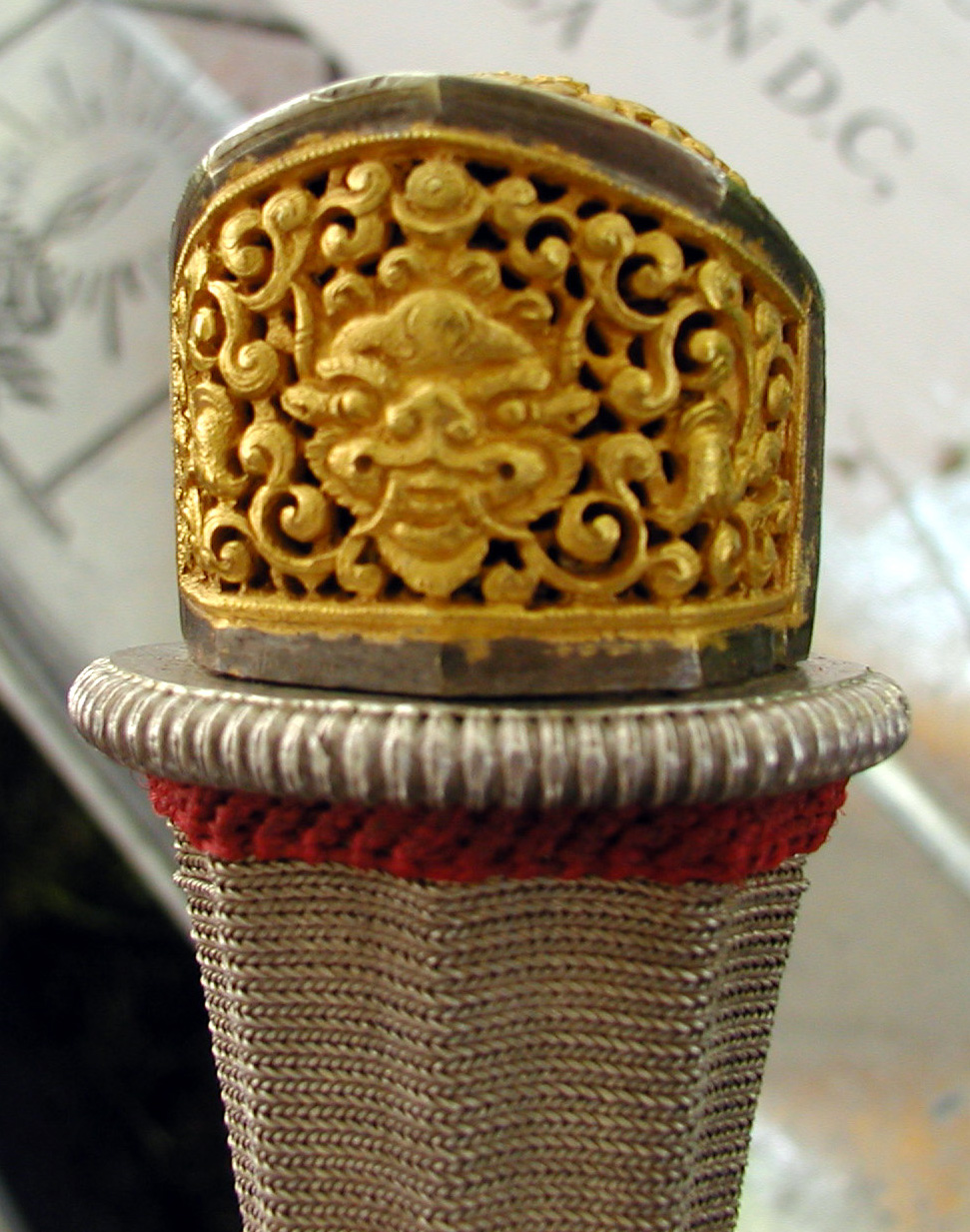

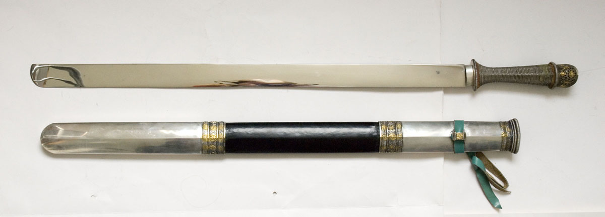

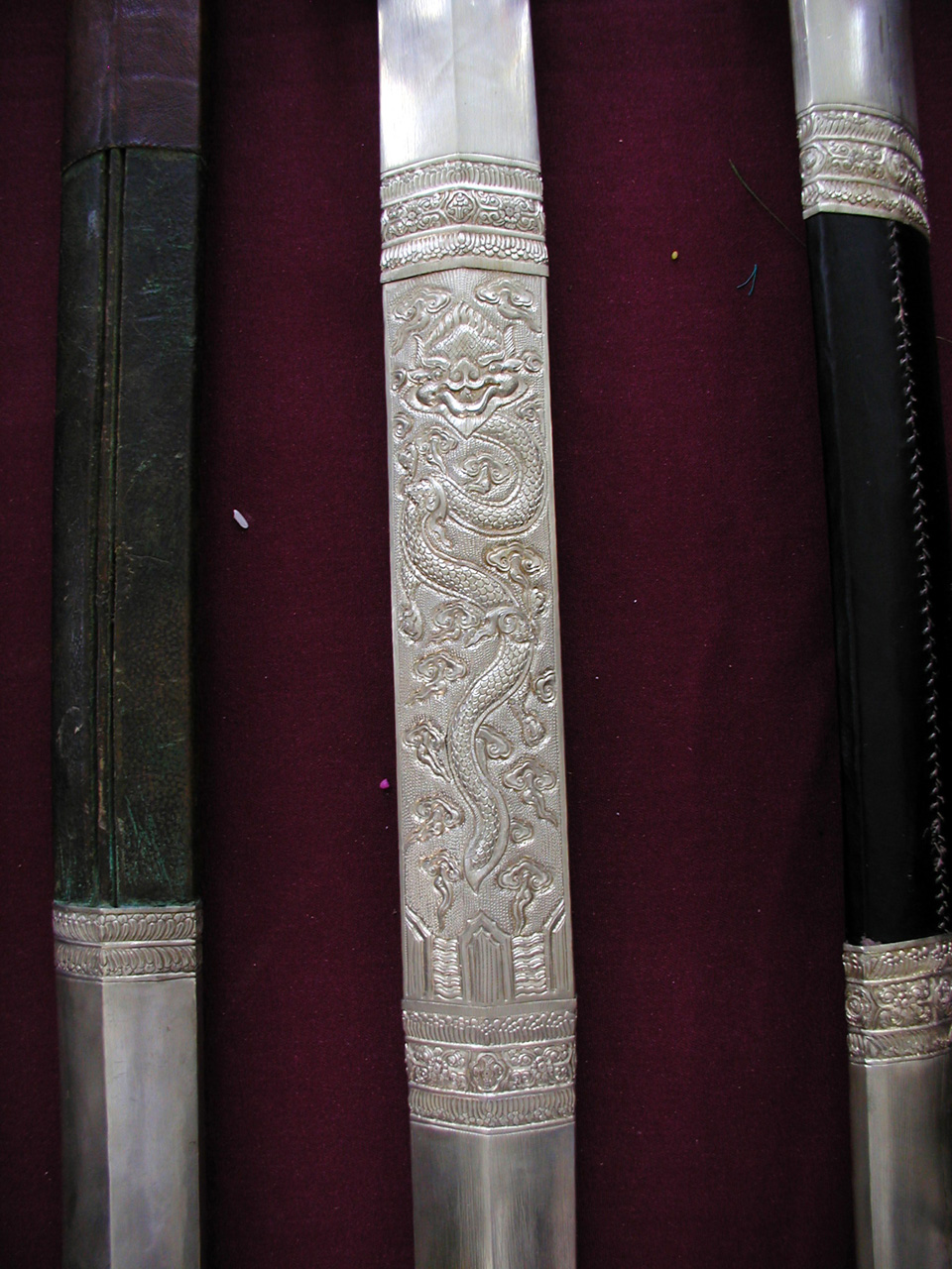

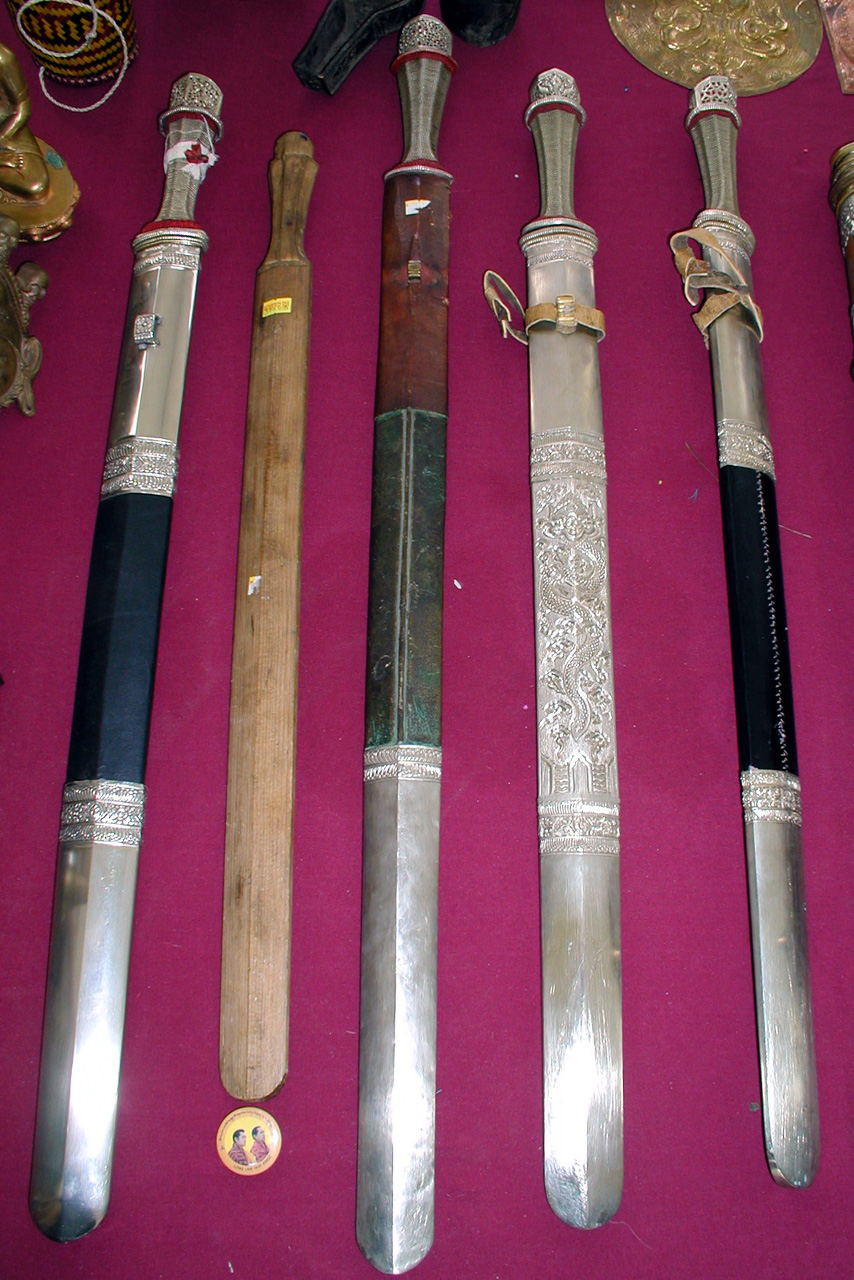

I think that Phuntsho Rapten may have relied a great deal on the expertise of one of his informants, a man that is said to have a considerable sword collection (I have spoken to his son).
Below are some new swords, including a couple of shots of a laminated blade.
The smiths are working a lot with silver, so my observation that the pierced floriate work is not as nicely rounded and delicate as on some of the older (iron) pommels is just a function of the softer material, which must consequently be thicker.
dennee is offline   Reply With Quote

Some hilts and a new laminated blade...
