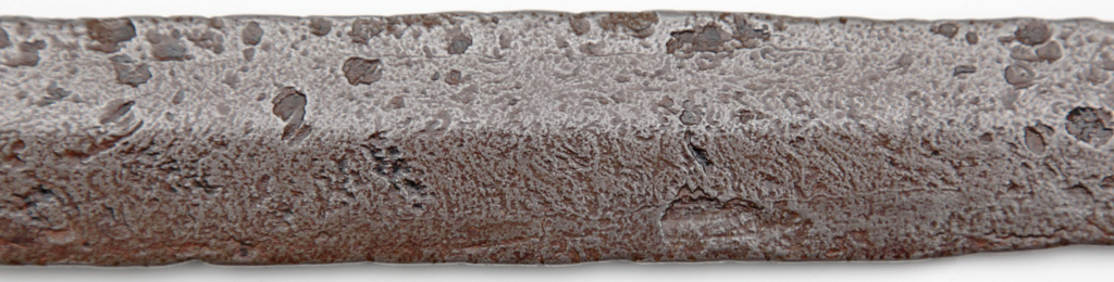

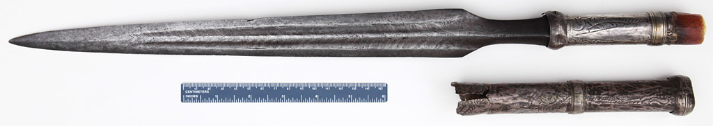

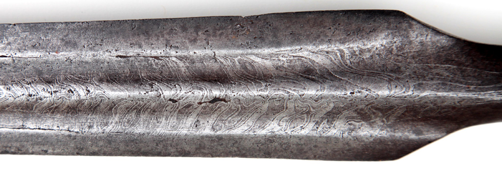

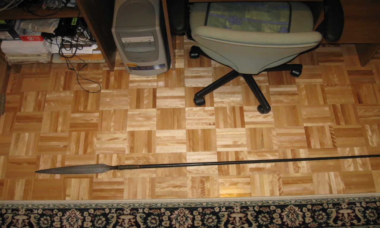

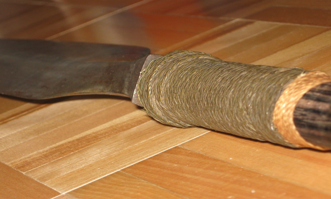

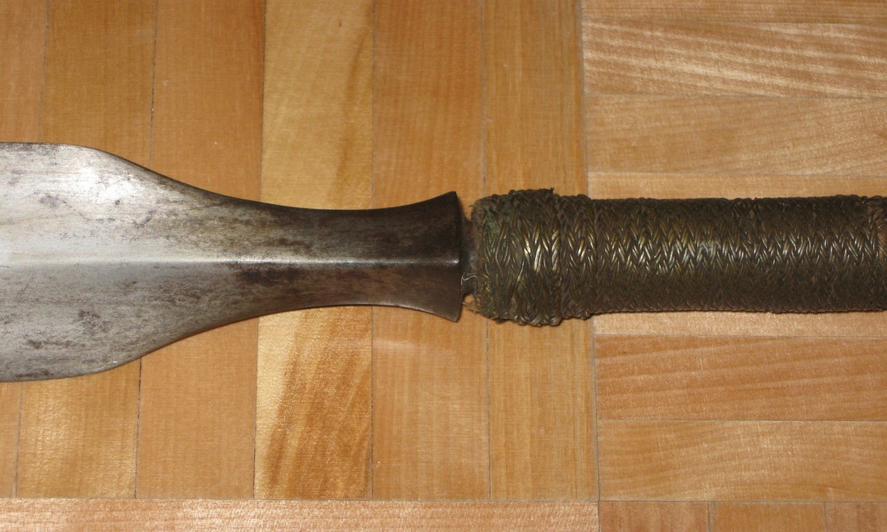

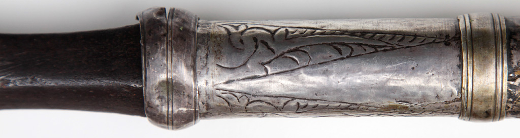

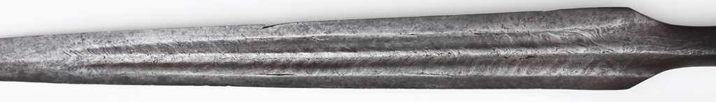

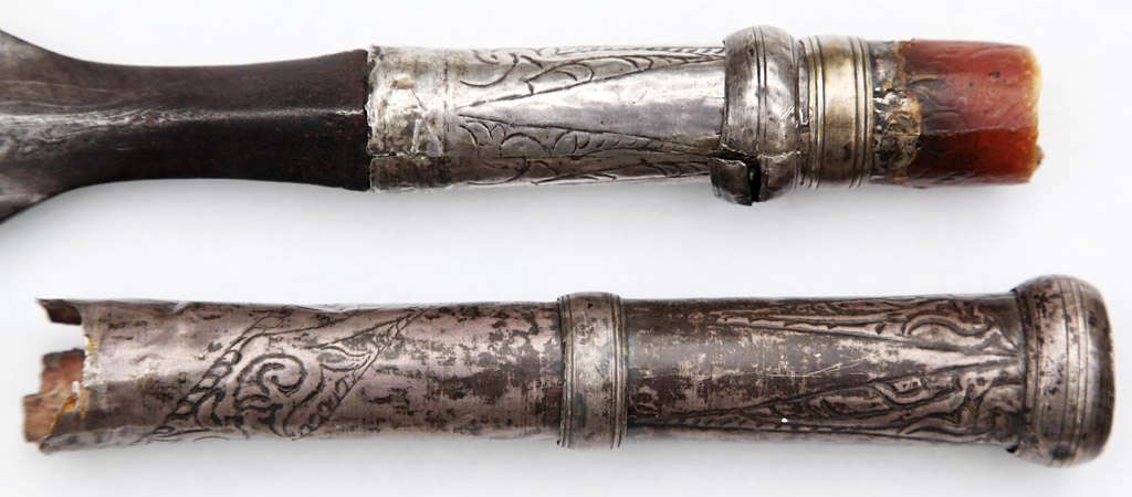

The discussion on Maurice's gorgeous budiak with a Sulu provenance got me to thinking about an old pattern-welded spearhead I have had for many years.
The pole was gone before I encountered the spear, which also included a very thin and fragile silver cylinder. Someone had tried to repair this with epoxy, but that had already failed. Clearly this would have been most stunning when intact and mounted.
The cross-section of the neck of this spear is very much a square on end and the neck of Maurice's spear reminded me of this one.
Does the form of this spearhead and the decoration on the ferrule reveal where this spear is from and allow any of you to enlighten me?

Could one imagine a base under that silver like the left hand spear shown ?
No one ever really nailed this one down to a particular tribe IIRC .
The ferrule style is quite different from yours .

Very handsome budiak Lee!
It must have been a status piece, looking at the silverwork, and it must have had an awesome look when compleet with pole...
I guess to track the origine, we must hope to find similar pieces like this in a museum with provenance.

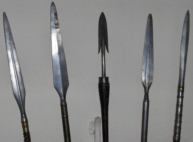

Hello Rick,
I only can post this image of these spears in a spanish museum.
Unfortunately I have no description of the spears, but maybe a spanish collector can tell more about the tags or what they are saying in the museum....
I only have this image!
Depicted are several spears, some with very plain silver ferrule (but with other bands/rings like yours).
Especially the second one of the left....the base looks very similar to me in comparison with yours, although your blade is a bit slimmer.
Maurice

Interesting form of budiak. Not seen this length of blade before. Love the twistcore.

Thank you Maurice .
I don't see any that are similar; I think the one you mention goes to round at the base .
I see no rings on the ferrules that match .
Anyway, if the base of Lee's example is angular this might be something to work with ...... or just coincidence .
I see a resemblance :

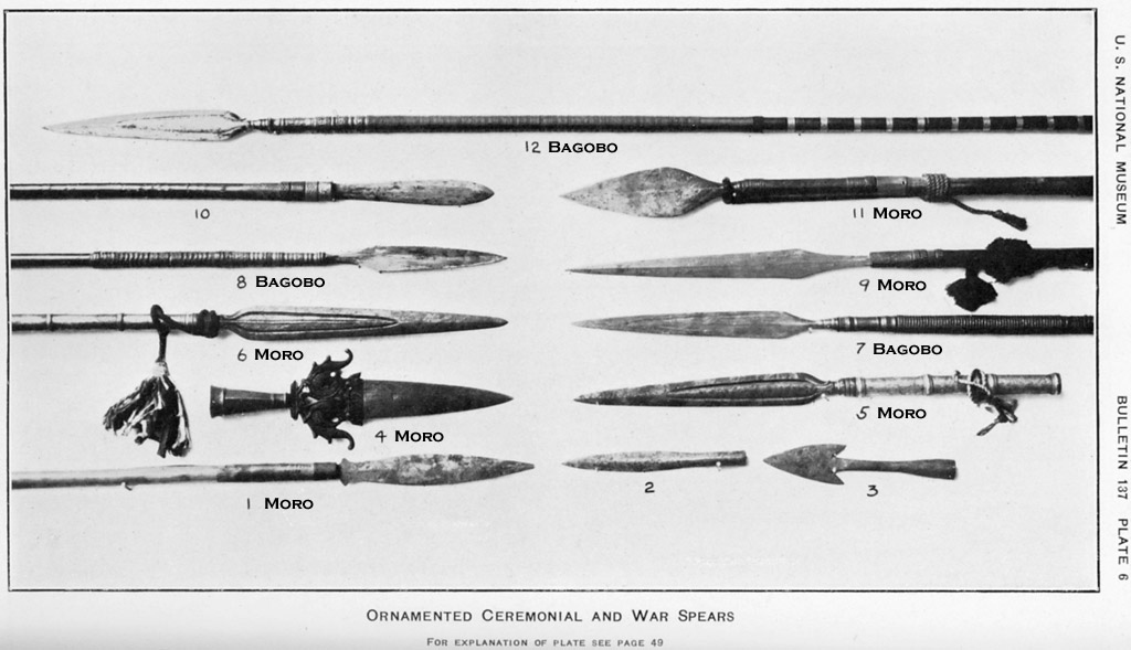

Rick, the base is much like the one you picture on the left, but a little less robust. As to both of your examples - drool...nice...drool...
Maurice, I have scanned in one of the plates from Krieger (1926) below and have labeled the spears with the tribal associations given in the text. Numbers 8 & 9 appear to have a square neck, but are Bagabo & Moro, respectively. Similarly, the etched panels on the blade faces are present and absent with both associations. The text describes the ferrules of these examples as being of brass or iron.
I suppose that these Malaysian spearheads would have spread throughout the region by trade and capture and so can no more be precisely placed geographically than a European winged spearhead of the 9th - 10th century (socketed instead of tanged, but of about the same size and with sometimes with similar pattern-welding!) Mountings would clearly help, when present, in the rare cases where examples of known provenance are available for comparison. Hopefully, some day the chronology and regional variations will be worked out for these most impressive artifacts.
Lee, thank you for the scanned Krieger plate. I do have the Krieger images on my computer, but in a smaller format, so it is more clear to see now.

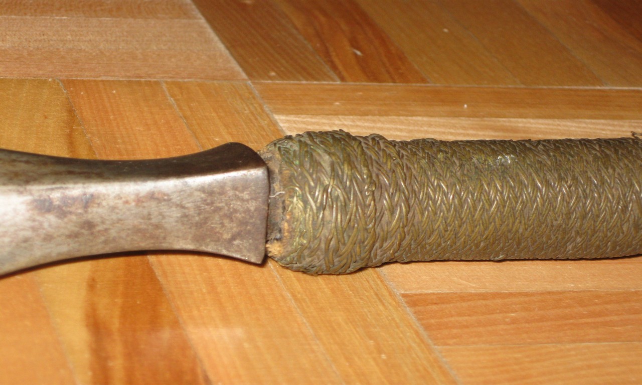

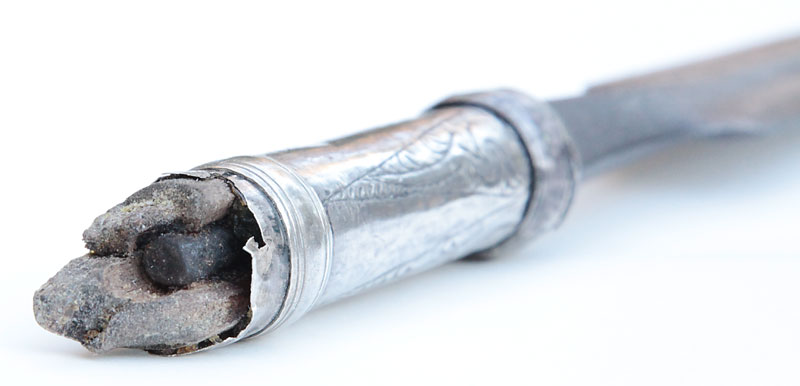

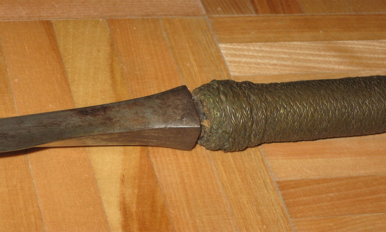

Rick - It turned out to be simple and harmless to expose the base of the neck of my spearhead and it remains a simple square. Asomotif - I believe that, despite the tears and dents, very little silver is missing from the ferrule and that you are correct that it remains very restorable and deserves restoration. (If I can find copper pipe of the correct diameter, that might provide a definitive underlying support.) Battara - I have tried to give a better view of the okir below:

I hesitate to call it a true budiak since it does not have the usual chiseling for a budiak.
However the twistcore and the way it is done as well as the okir still indicates to me so far that this is an early Sulu spear.

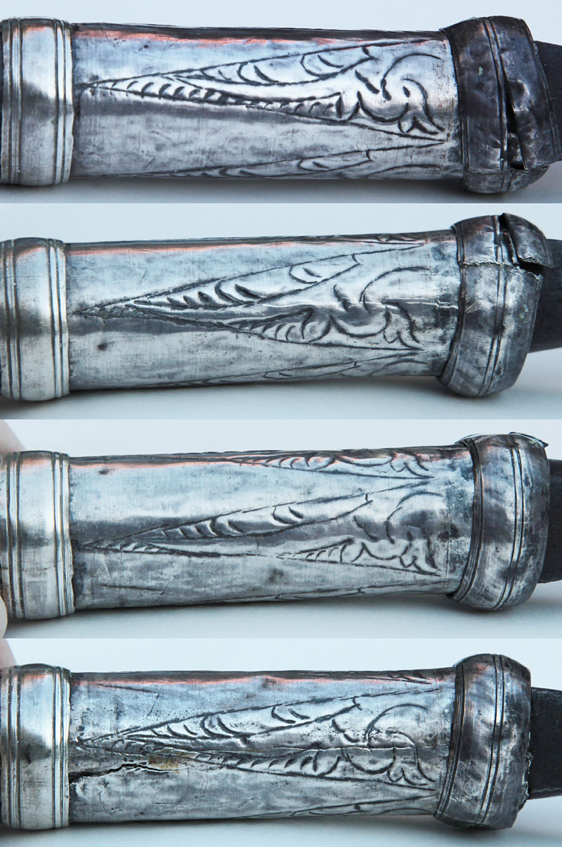

I have built a composite picture below - not to precise scale and digitally bleached to bring up more detail in the bases - in order of similarity of features. Our protobudiak is fullered and has no elaboration at its base; the blade tapers into a square cross section. (Maurice's splendid provenanced Sulu spear would come next in this sequence.) The second spear from the left below has a shallow chiseled panel which carries into a square neck as a line before an abrupt, but slight expansion into a round base. The two on the right are proper budiaks with a well developed chiseled panel and the thicker edges terminating in a classic floral? curve. These have rings around a round neck and re-expand substantially to meet the ferrule (or be partially covered by it in the right example).
Krieger's plate 6 does strongly suggest both forms (chiseled with complex base and non-chiseled with square base) remained in use by both the Moro and Bagobo until the early 20th century. So chronology versus geography (of manufacture) or more likely a bit of both.

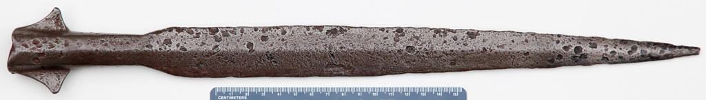

Wink Just for kicks: Compare this with a mid to late Viking Age (Carolingian) winged spear
This protobudiak was my very first 'Malaysian' spear. I bought it in a small (now sadly perished) private arms and armour museum in Kutztown, Pennsylvania in the late 1990s. I collected it as a superb example of pattern-welding for a small group of comparative ethnographic examples I was building. It was so out of place in the museum's small coop shop and it cost me less than a hundred dollars. I still delight in my memory of finding it. I have over the years mislaid that delicate silver ferrule cylinder on more than one occasion, but shall be careful not to again lose it, and I indeed look forward to seeing it put back together again.
So, ironically, the protobudiak gets to be the reference point as I pull something from the opposite side of the globe and a millennium further back out of the armoury to compare with it, namely a mid to late Viking Age (Carolingian) winged spearhead. The big, obvious differences are that the winged spearhead is socketed (with two small protrusions or 'wings' arising from the socket) and the tanged protobudiak has more pronounced fullering. In functional impact, however, these two spearheads are nearly identical in length (protobudiak 355 mm; winged spearhead 345 mm - measuring from where each blade begins to expand out from neck to the tip) and in mass (protobudiak as pictured including partial mounts and epoxy 469 grams; winged spearhead 409 grams with some losses from the socket on the opposite side).

Thanks Rick, I think that is about all one could hope for in terms of a missing link ... now is it time or geography or both.
I had missed that detail in the wealth of that museum photo tour, but worse I had totally missed Bill M's fabulous examples resurrected in Freebooter's thread - just look at the combination of features in the first pictured spear as well as the intact silver ferrule. Gorgeous!
Anyway, my protobudiak is about to head out the door for restoration and preparatory to this I have dissolved away the failed epoxy repair and revealed the end of the tang and fractured remain of the pole.
And just a trace of fall foliage reflected in the silver.

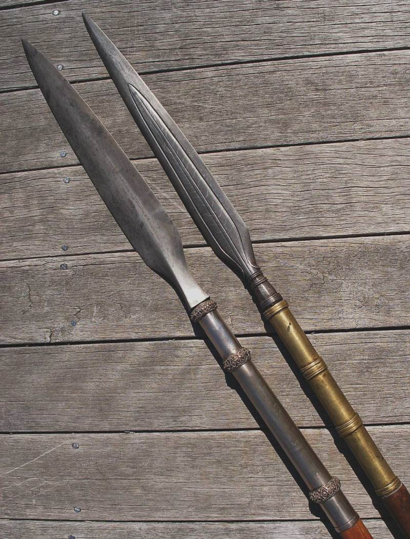

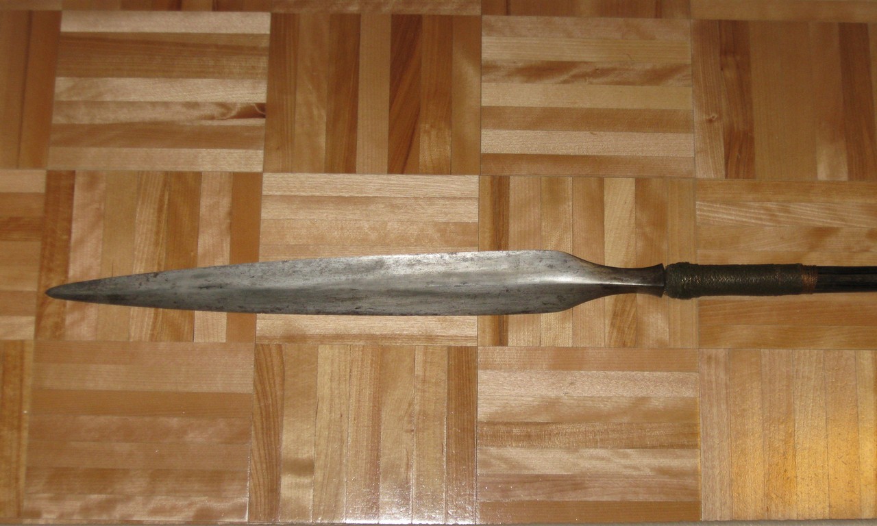

Hi everyone,

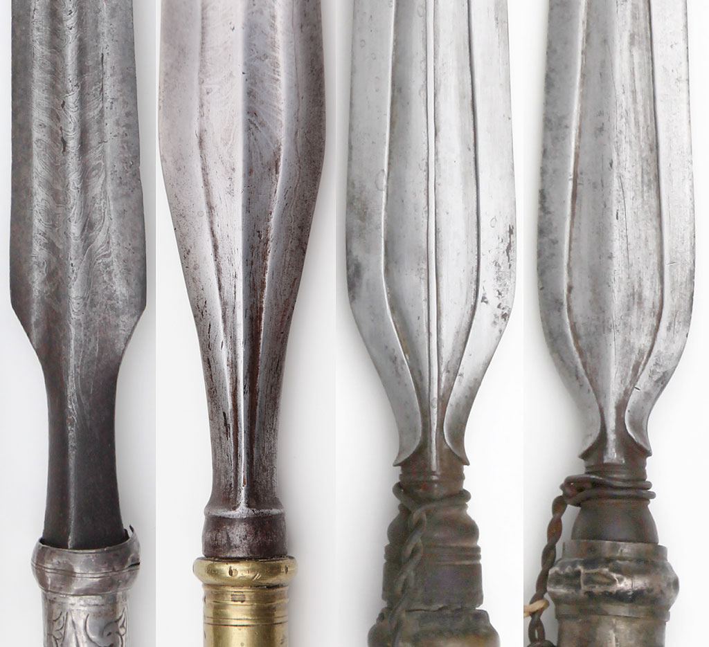

Here is a Moro or Bagobo spear with similar lozenge flaring at the base. The blade is pattern-welded but not twist-core. I find the braided wire work quite interesting.
Emanuel
Old 1st November 2010, 03:08 PM   #23
Posts: 6,441
The head seems almost identical to the left one shown in post #2 .
